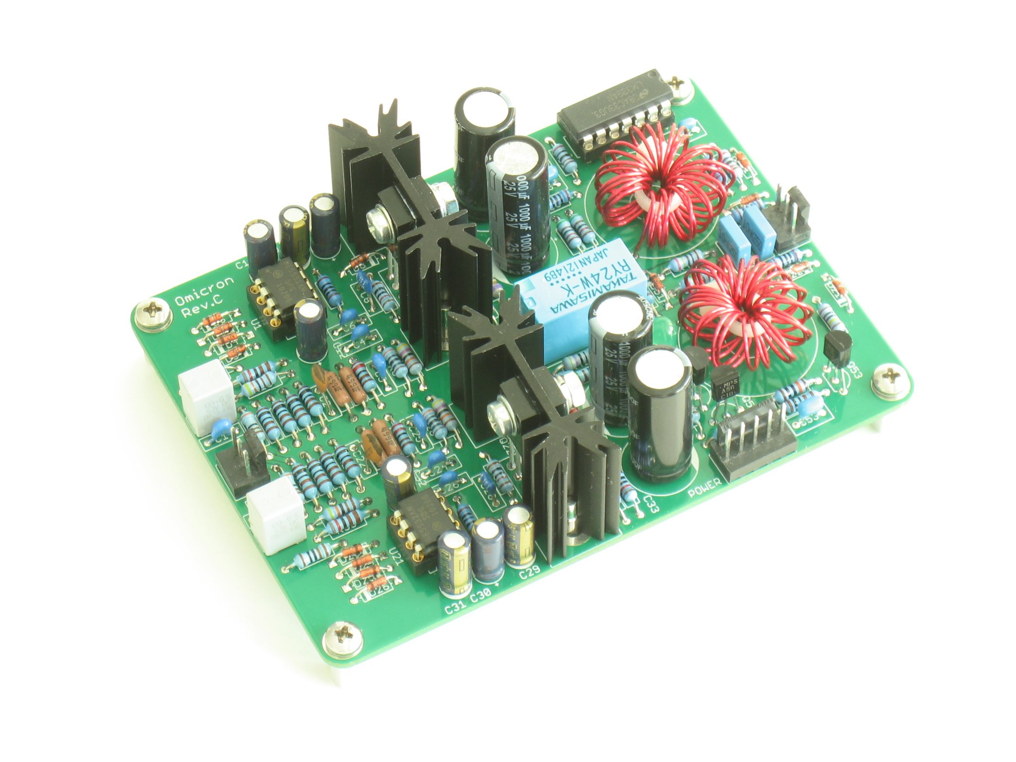

Omicron is:
- A compact, ultra-low distortion headphone amplifier that we developed jointly with @Rus2000 from the RCL-electro.ru forum
- Designed to work with 32 to 600 ohm headphones and tested with a range of over-the-ear and on-the-ear cans from AKG, Beyerdynamic, Grado, Klipsch, and Sennheiser but proved to be equally at ease with lower impedance 16 and 8 ohm headphones, such as AKG's K3003 3-way in-ear monitors; the ubiquitous white Apple EarPods (tethered ones, both 1st and 2nd generation) sound great with Omicron, too!
- Very musical, with pure, clean, liquid sound and perfect clarity even in the most harmonically complex pieces.
The sound immediately fascinated me so much that I began listening without adjusting the quiescent current. You want to turn up the volume, no mess, even the quietest sounds are clearly heard, but at the same time the sound is very comfortable, not harsh, a beautiful three-dimensional scene. Very nice bass. In short, top notch!
... sounds flawless and works equally well. [...] The claimed <140db probably holds true because this design sounds cleaner and smoother than anything ive built and that includes single opamp setups and well known discretes.
This amp is fantastic, I've been listening away and taking notes for a better review, spent a few hours last night playing games with it, worked wonderfully. It really blows all of my other headphone amps and line amps out of the water. The clarity is surreal.
Last night compared Omicron with my composite LT1210 based headamp. At first, it seemed that the LT1210 sounds softer and more beautiful, but after listening to Omicron for about an hour, I switched back and realized that now I want an Omicron for myself! With the same tonal balance, it gives an accurate, fast, assertive bass and better conveys space. Sounds great on good recordings.
Features:...the sound really is fantastic. [...] It's a huge step up from [...] bottlehead crack with the speedball upgrade.
The soundstage is really amazing with my hifiman cans and there's a wonderful amount of detail. Very liquid sounding and the amp just seems to do everything right. The amp runs very cold too, the case never even gets warm.
- Vanishingly low distortion: with THD and IMD better than -140dB (0.000 01% - that's only 100 parts-per-billion), Omicron is orders of magnitude more linear than other "high-performance" and "ultra-high performance" amplifiers
- Compact: Just one IC and two transistors per channel
- Inexpensive, commonly available parts (NE5532, BD139, BD140; under $40 at Mouser for the whole BOM)

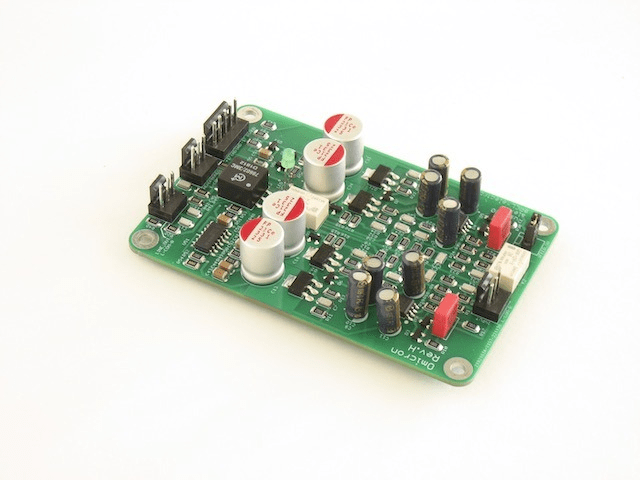

- Easy through-hole construction (NEW: a smaller board with easy-to-hand-solder SMT parts has been developed, see its photo above)
- Functionally complete: One 80×110mm (60×90mm for the SMT version) board carries two amplifier channels, a sensitive DC protection for your headphones and an optional (switchable in the SMT version) cross-feed circuit, which helps create a realistic soundstage in headphones

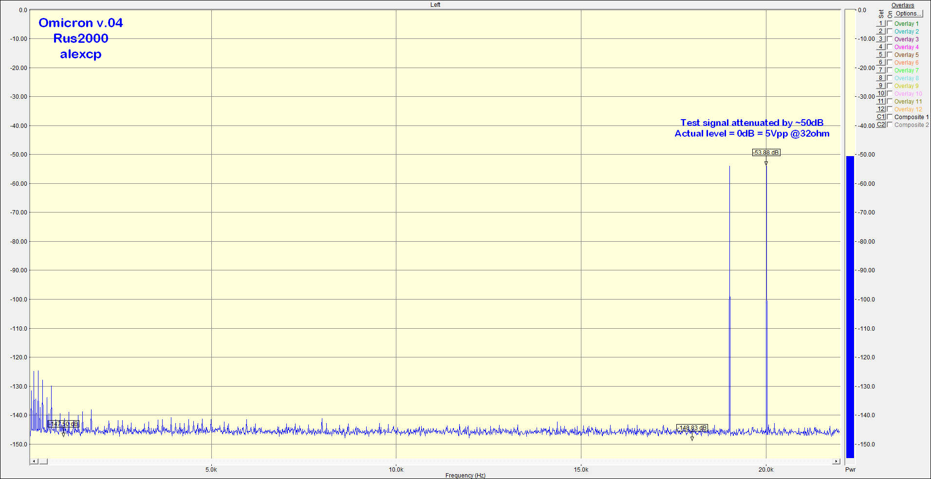

IMD 19+20kHz, 5Vpp @32ohm (see post #11 for more measurements):

- Through hole Omicron board
- Schematic: post #295
- Board outline: post #142 - includes a discussion of how to fit Omicron into 1U enclosure
- Part list: post #155
- Winding the output inductor: post #71
- Mod: crossfeed switch board by @gajira: post #334
- Mouser shared project - order all parts for this board in one click

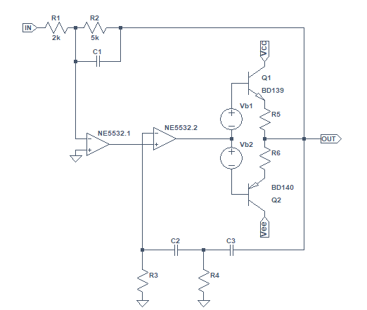

Actual amplifier schematic (one channel shown):
Each channel of Omicron is a composite amplifier built with two halves of an NE5532 and a two-transistor complementary emitter follower (EF) as a current booster. There are two feedback loops - one global and one for the second opamp and the EF. This configuration was selected after comparing a number of alternatives, including a single opamp with a current booster, a Yewen style composite, a Samuel-Groner-super-opamp-style composite, and a few others.
- R1R3R5C1C2 is the global feedback loop.
- R1C1 is the input LPF. The amplifier is relatively wideband, with -3dB point of its frequency response at several 100's kHz (measurements will follow).
- C2 provides lead compensation, improving phase margin.
- D3-D6 and R10 adjust the loop gain in case of clipping or slewing, helping recovery.
- R7R8R9C4C5C6 is a local feedback loop with two-pole compensation.
- Q1Q2 and associated parts are the output current booster. R13 and R14 set the quiescent current, D7 and D8 provide thermal compensation.
Gain is x2.5, which works for both low- and high-impedance headphones. Input impedance is relatively low at 2kOhm - modern sources will handle it easily. The amplifier does not include a volume control in order not to be tied to a specific part; a 10kOhm pot with linear characteristic can be used - together with the input impedance and the effect on gain, it produces a control characteristic which is closer to true logarithmic than many audio pots.
Simulation results, actual performance measurements, the DC protection schematic and construction details will follow.

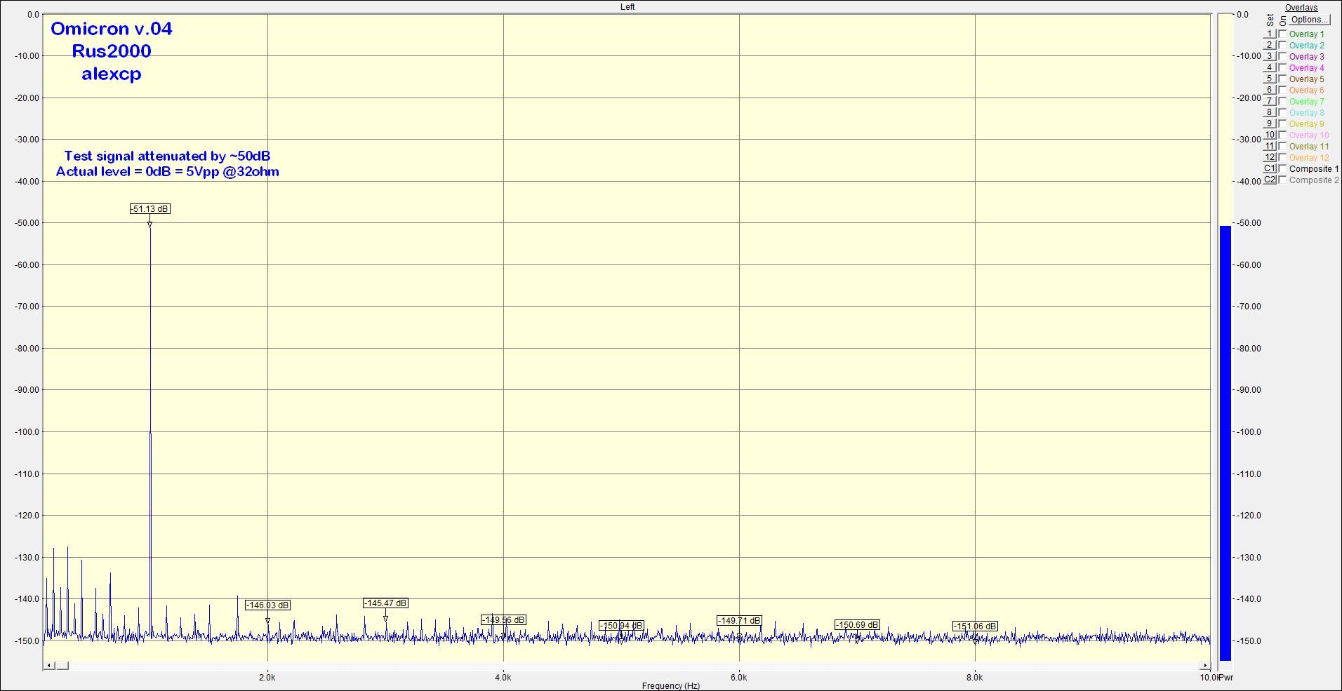

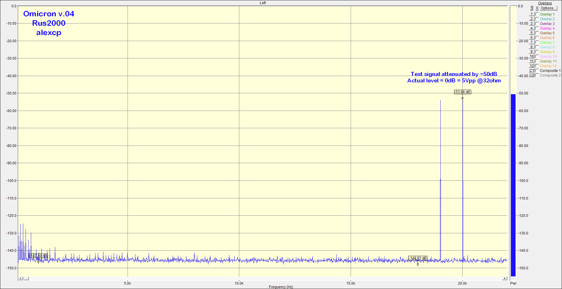

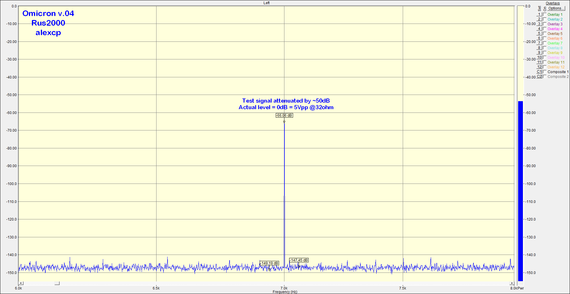

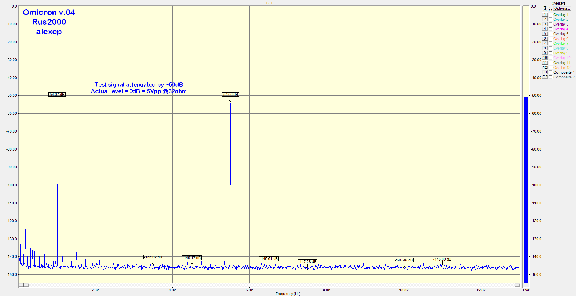

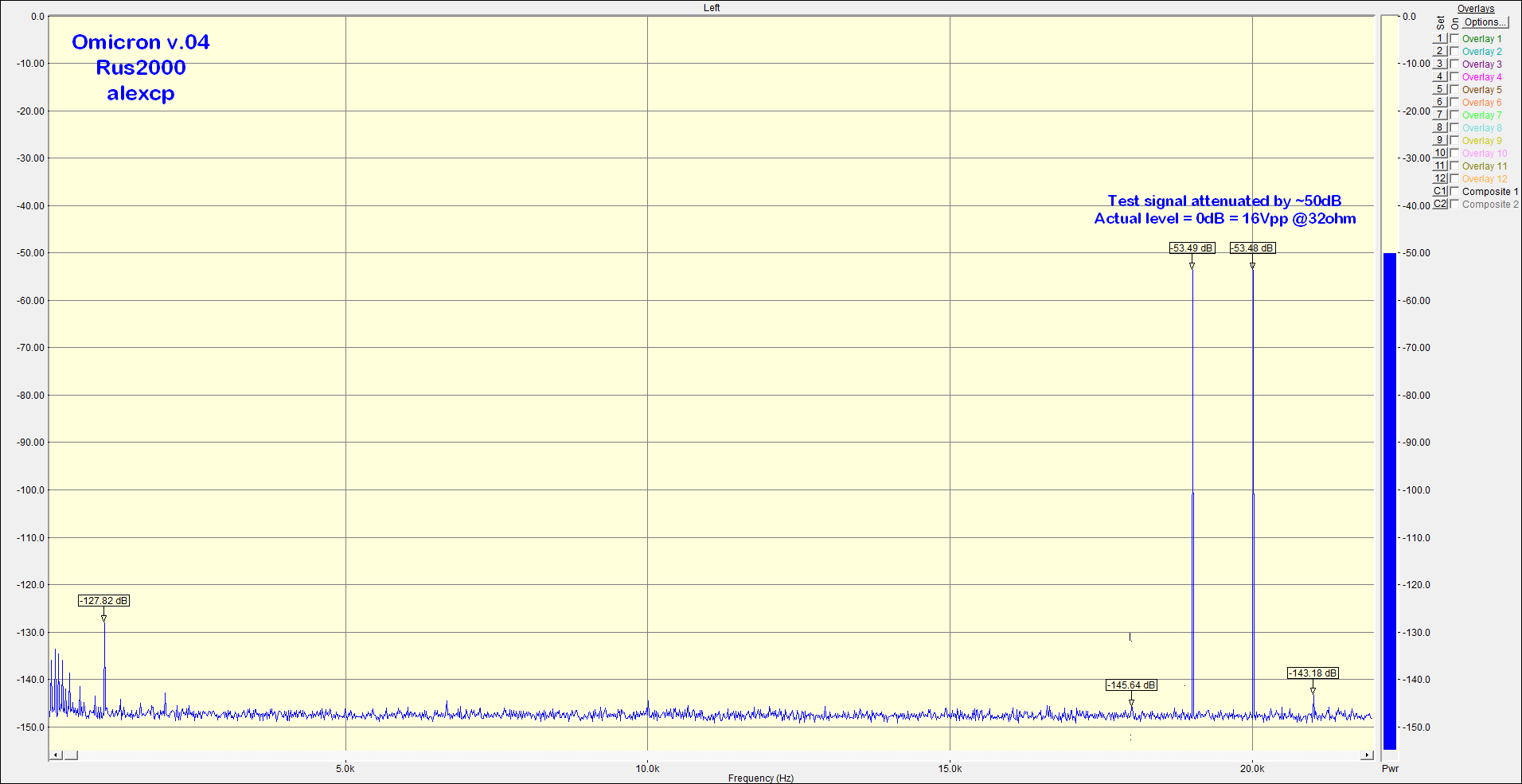

Before we drift off to a discussion suitable for The Lounge, here are some (pretty boring) measurements:
THD 1kHz, 5Vpp @32ohm:
IMD 19+20kHz 1:1, 5Vpp @32ohm:
SMPTE 60Hz+7kHz 4:1, 5Vpp @32ohm:
IMD 1+5.5kHz 1:1 (proposed by Siegfried Linkwitz because its intermodulation products fall into the frequency range where the human ear is most sensitive):

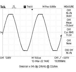

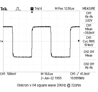

You can get a little more interesting pictures with a much higher output level into a low impedance load, where the limitations of the simple output stage show up. Here is 16Vpp into 32 ohm - that's 2 watts of peak power that would likely damage your hearing 🦻 and/or set the headphones on fire 🔥. Omicron is not designed for this, but nothing terrible happens, it is still very linear:
Omicron clips cleanly:
and doesn't squirm at fast square waves:

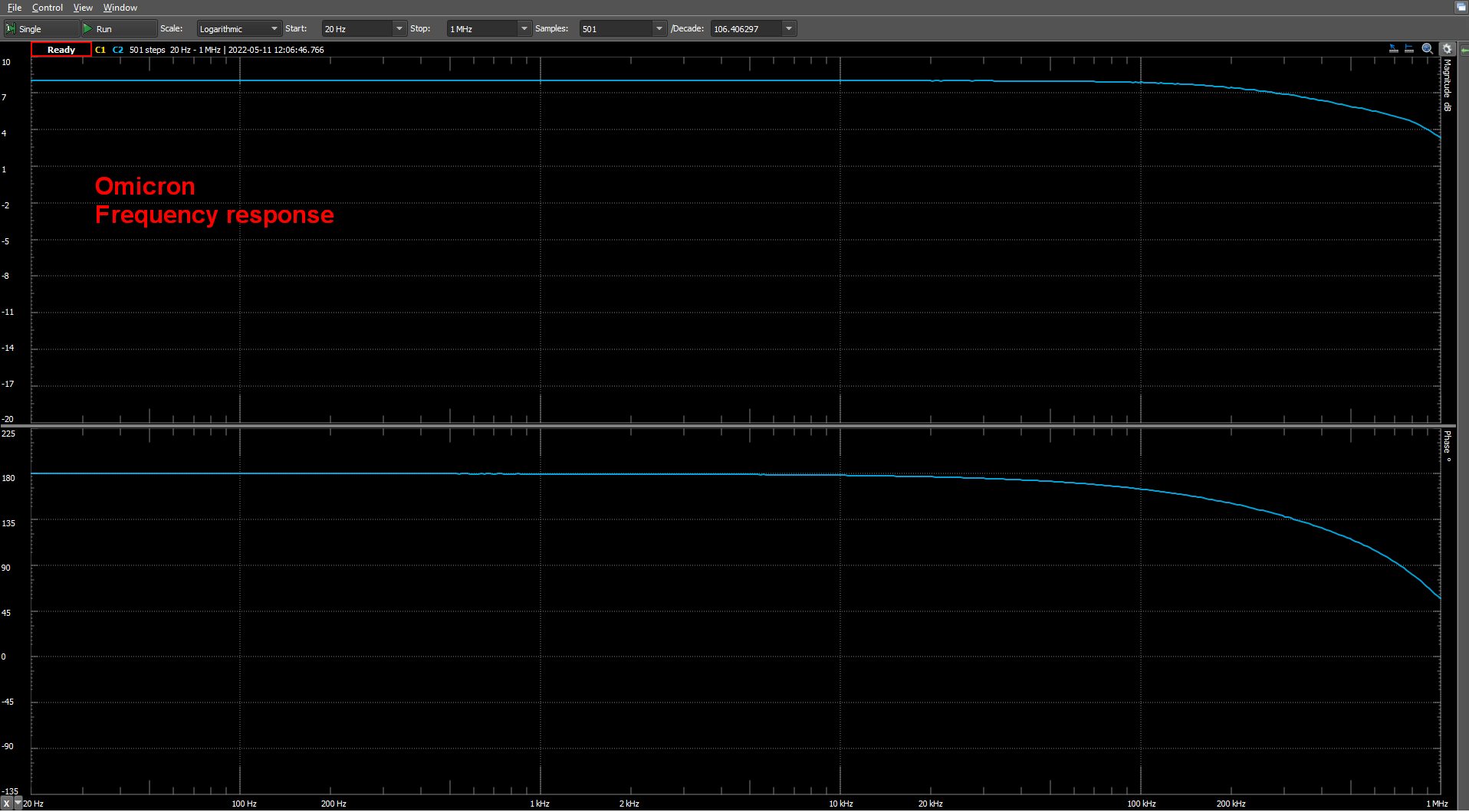

As stated above, Omicron is rather wideband and will not twist phase in the audio band:
