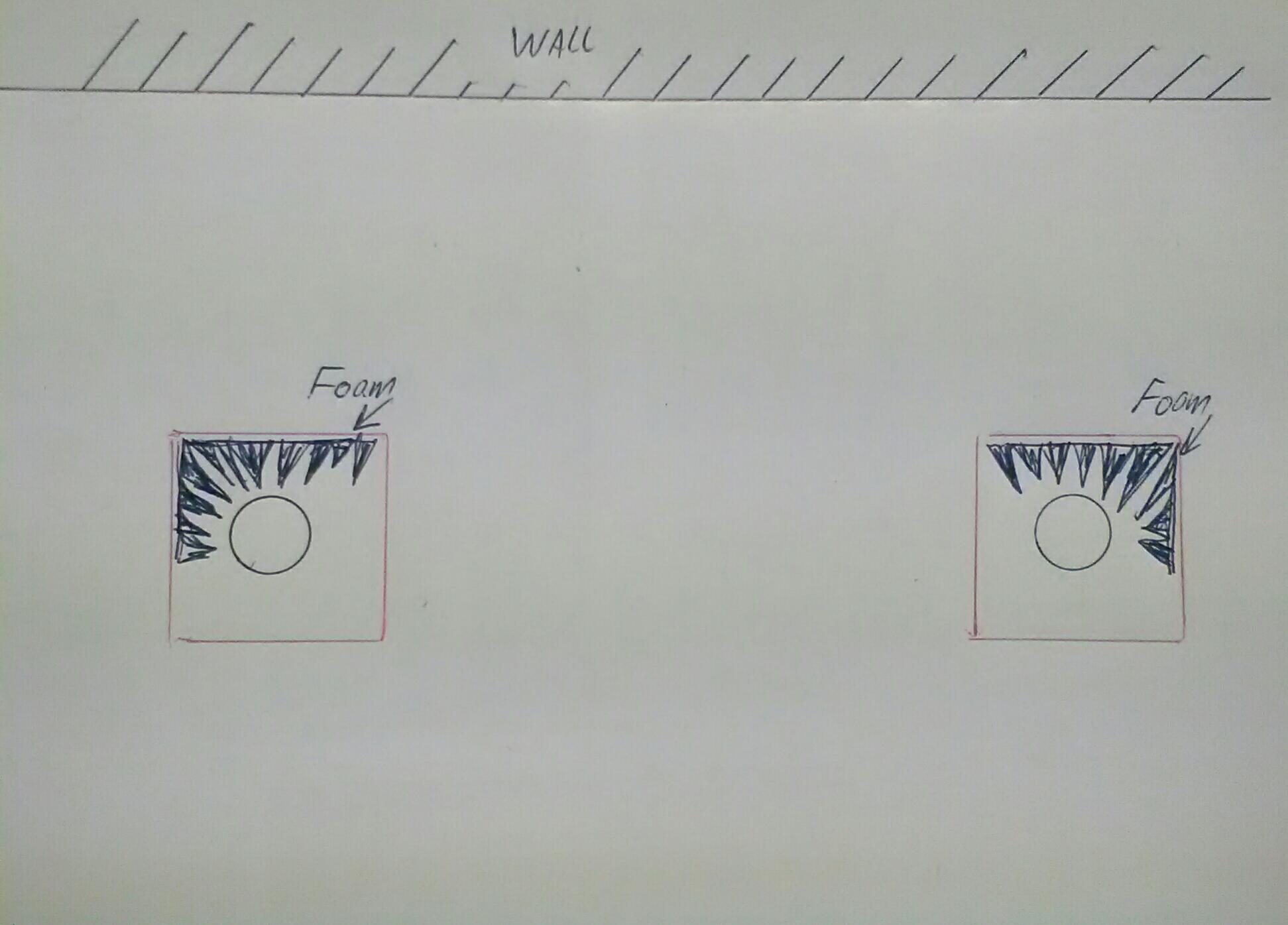

You can experiment with an omni-like effect by placing a shallow boxed speaker on it's back on the floor. Many of the designs similar to the one you posted have little radiation upwards, so not really omni.

The speakers were essentially omnidirectional in the horizontal plane, which made background music very tolerant of listening position. They weren't so good for critical listening, unfortunately, because ultimately omnidirectional loudspeakers sound unnatural in real rooms. There will be reflections of sibilance from all walls, for example; this is quite contrary to real acoustic performances where the sibilance from a trumpet or vocal only goes in one direction, and that's usually towards the listener, not away.

With the omnis that I'm currently using I have them as far from the rear wall as I ( at least my ears ) am from the speakers, also the speakers have slightly reduced treble, so I don't have any problems with reflections. Also my listening room is rather cluttered ( a bit of an understatement ). If I did have problems I'd stick so foam absorbers on the speakers ( as illustrated in the above diagram ) to turn them into " half omnis ", or perhaps more precisely half radials - I'd consider them omnidirectional in the bass, hemispherical in the upper midrange, and radial in the highs.
