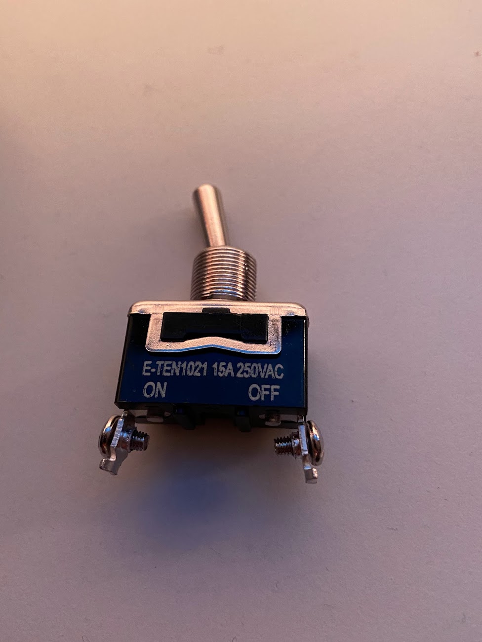

I bought a couple of these on/off switches:
I use one in an amplifier build as on/off switch. I wire the hot wire from the 220V mains to this switch. After a couple of on/off cycles, the switch breaks and remains 'on' regardless of its position (there is current flowing even when the switch is on 'off' position). Now this might be a single defective switch, but I have replaced it 3 times already and every time the same problem occurs - after a couple of cycles, the switch remains always 'on'.
Am I using this switch correctly?

It must be a piece of junk. This can be very dangerous.
Throw away any remaining of those switches and buy something different.

Even with a legitimate product, there might be issues related to the type of load: typically, some types of high-inrush loads will weld together some contact materials.
When a detailed datasheet is available, you can figure out the best contact option for a given duty (AC1, etc.)

I agree; a switch rated for 250V probably should withstand that. Nevertheless, one version of that switch had a 15A limit, which could easily be exceeded when closing the contacts.

Wire a snubber capacitor (an X2 rated part) across the switch contacts... and you'll probably find they last longer. The problem will be arcing when the switch is toggled, due to the inductive load of the transformer primary coupled with the high inrush current of the supply capacitors charging.

I don´t think you have an electrical problem but a mechanical one, suspect you are overtightening the mounting nut.
That is a 15A switch!!!!! and you are NOT turning ON-OFF, say, a 15 HP motor in an elevator or a similar brutal load.
And solder those wires, avoid those terminal screws like the pest they are.
That, or yours belong to a very poorly assembled batch.

Possibly Chinese, and those may be wildly rated, don't trust them more than 3 Amps.
Buy a good brand, solder (or use crimped lugs), the wires, and put a snubber.
MOVs work as snubbers too.

IF SMPS powered, which I am most certain you have, turning that unprotected unsnubbered wall switch will create quite the spark.
While built-in SMPS power switches expect that and are snubbered , MOVed, etc. at Factory.

There are only two possibilities really.
1/ The switch is unsuitable for the load you are trying to switch. Failure within 2 on/off cycles that you mention suggest something else. A 15A switch should survive switching pretty much anything we discuss in these pages for many more cycles than that, even if it is unsuitable.
2/ The switch is not what it appears in terms of quality and/or is a fake.
What are you switching with it?

I wouldn't recommend any snubber / capacitor / MOV etc. as these would increase the off-state leakage of the switch. If the load is heavy, use an MCB for ON/OFF, as has been done in the equipment (picture) below.

I disassembled one of the defective switches and did not find any visible trace of welding on the contacts at least.
As member JMFahey guessed, there is indeed a 300W SMPS power supply connected (and a 3e TPA3255 amplifier board downstream).
I placed another similar switch from another batch and made sure the nut was not overtightened. It's still working so far but I am definitely looking into either snubbering properly that switch after reading all your comments.
Would an MCB in this case satisfy the snubbering requirements of the SMPS power supply?
