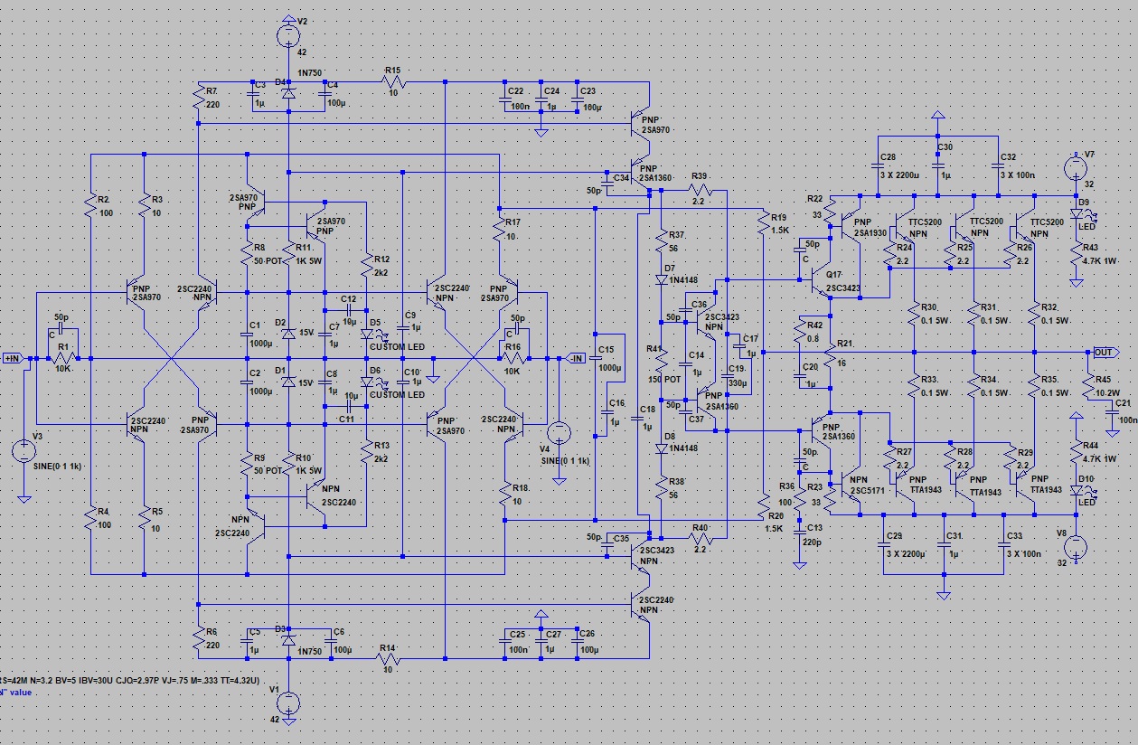

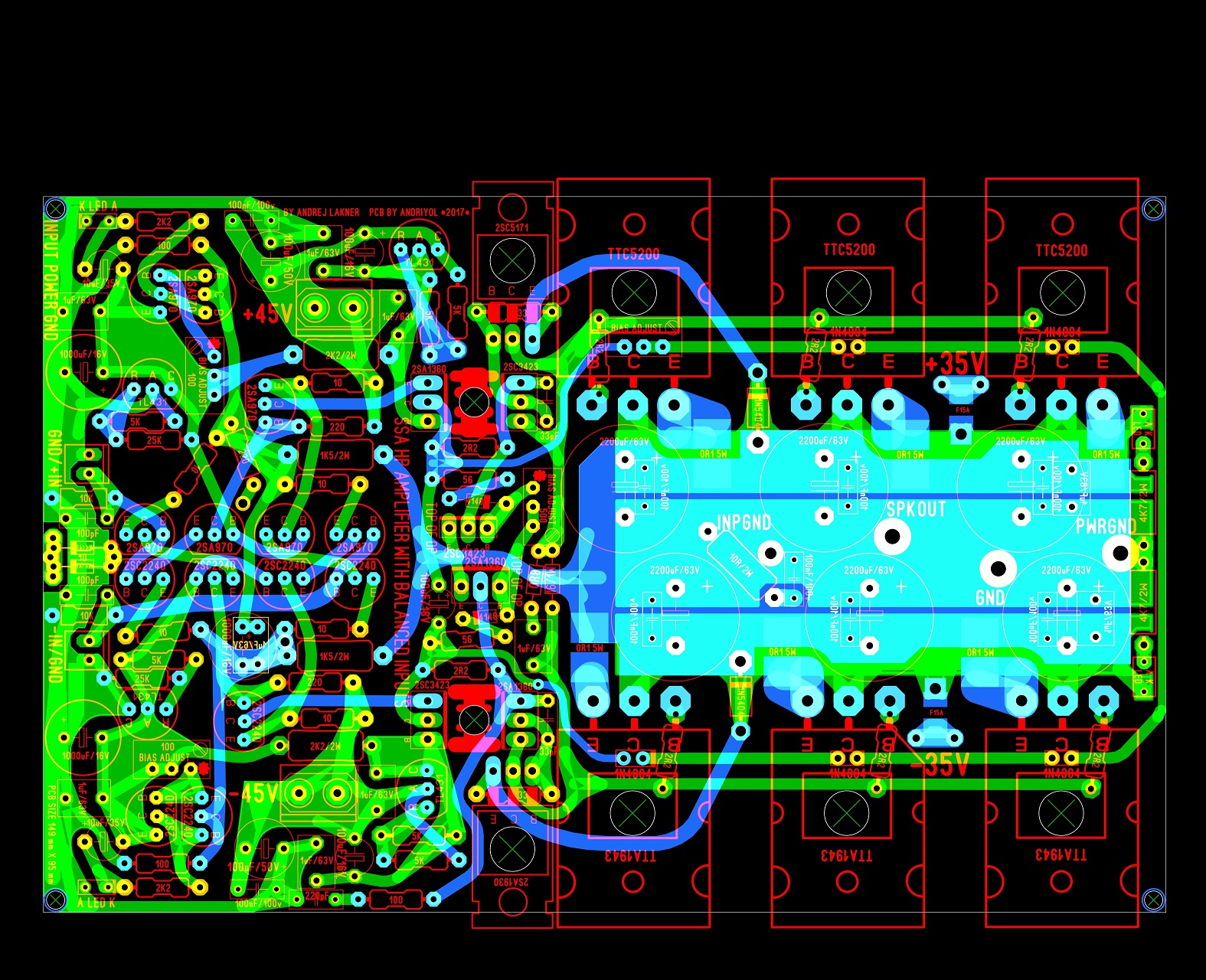

As for the current oscillation problem I'm interested in is a following CFP audio amplifier project.
Current layout without silkscreen errors:
SSA.JPG - Google Drive
Current Schematic:
SSA-HP-BAL.jpg - Google Drive

Maybe ferrite beads in the bases of the TTC5200 and TTA1943 may cure the oscillation tendency ?
Not in my experience. Have never known ferrite beads help anything.
Why not to rise up the emitter resistors of the TTC and TTA from 0.1 ohm to 0.33 ohm ?
On the other hand, why? Do you think that will increase stability? If this was an emitter-follower output stage that Re change would greatly increase the crossover distortion. That may not be true for this triple output stage, but the point needs checking carefully.
Or maybe a bigger quiescent current of the output stage to stabilise the B-E capacitance.
I think you're just guessing.
In a Class-B output stage the quiescent current is critical and has one optimum value for minimal distortion.

My experience of oscillation is the output changes quicker than the feedback signal can reach the LTP. This causes over shoot and oscillation.
I usually tame it with a CB capacitor at the VAS.
I have also had trouble with emitter follower drivers and these needed a base resistor to slow down the signal.

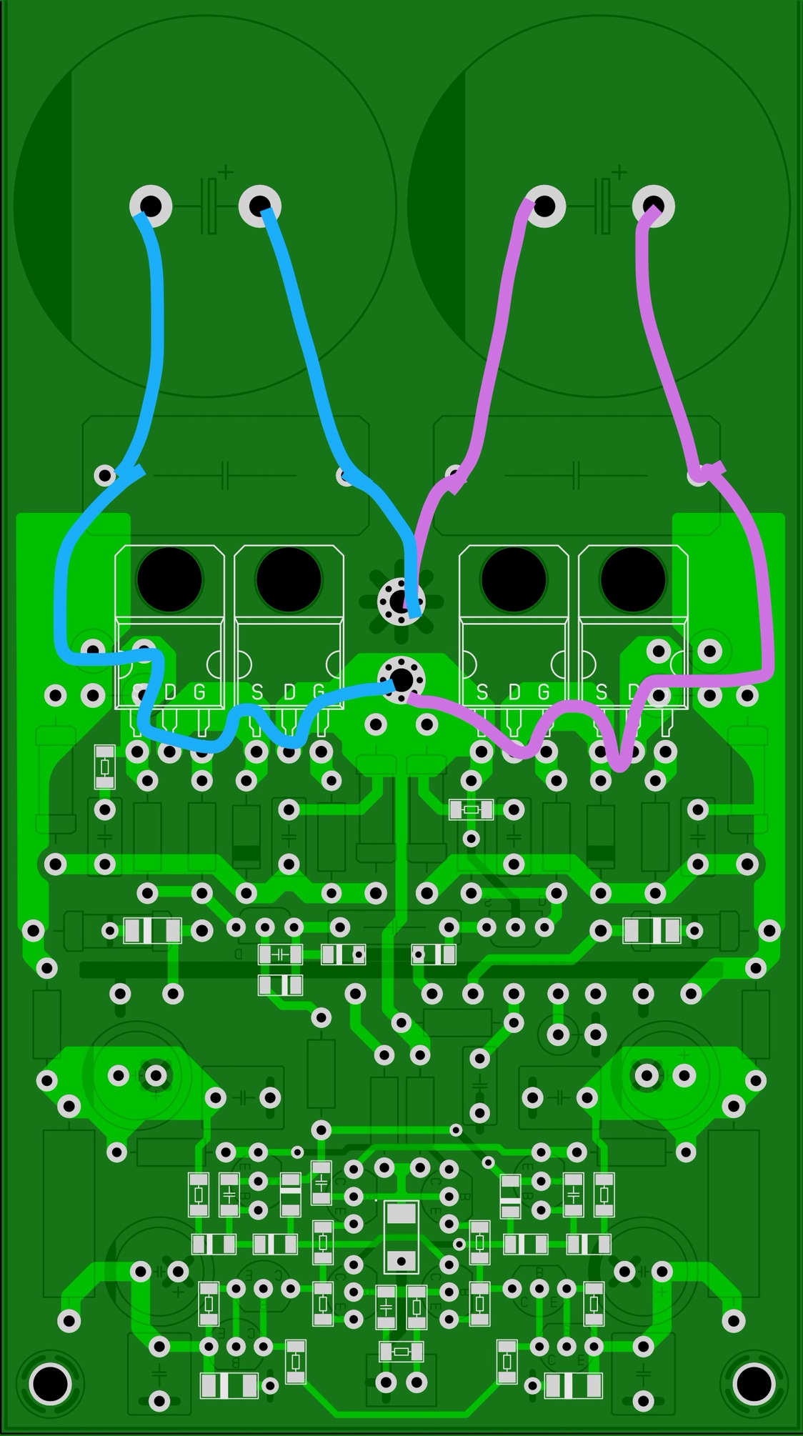

Oh, no, Douglas, you break my heart!
What about this king of absolutely improper layout:
Green and magenta shows load current path at positive and negative halves.
This OPS must be routed like this:
Even improper placing of decoupling caps could drop us in the instability, especially with high-GBW devices.
![IMG_5638.JPG IMG_5638.JPG](https://www.diyaudio.com/community/data/attachments/582/582530-21576a40bea33216c254666b173836de.jpg)
![IMG_5611.JPG IMG_5611.JPG](https://www.diyaudio.com/community/data/attachments/582/582532-9246f81add91e4dde1a010b7a35d48ad.jpg)
![IMG_5639.JPG IMG_5639.JPG](https://www.diyaudio.com/community/data/attachments/582/582537-2b473975751a5820a86723ee092adba8.jpg)

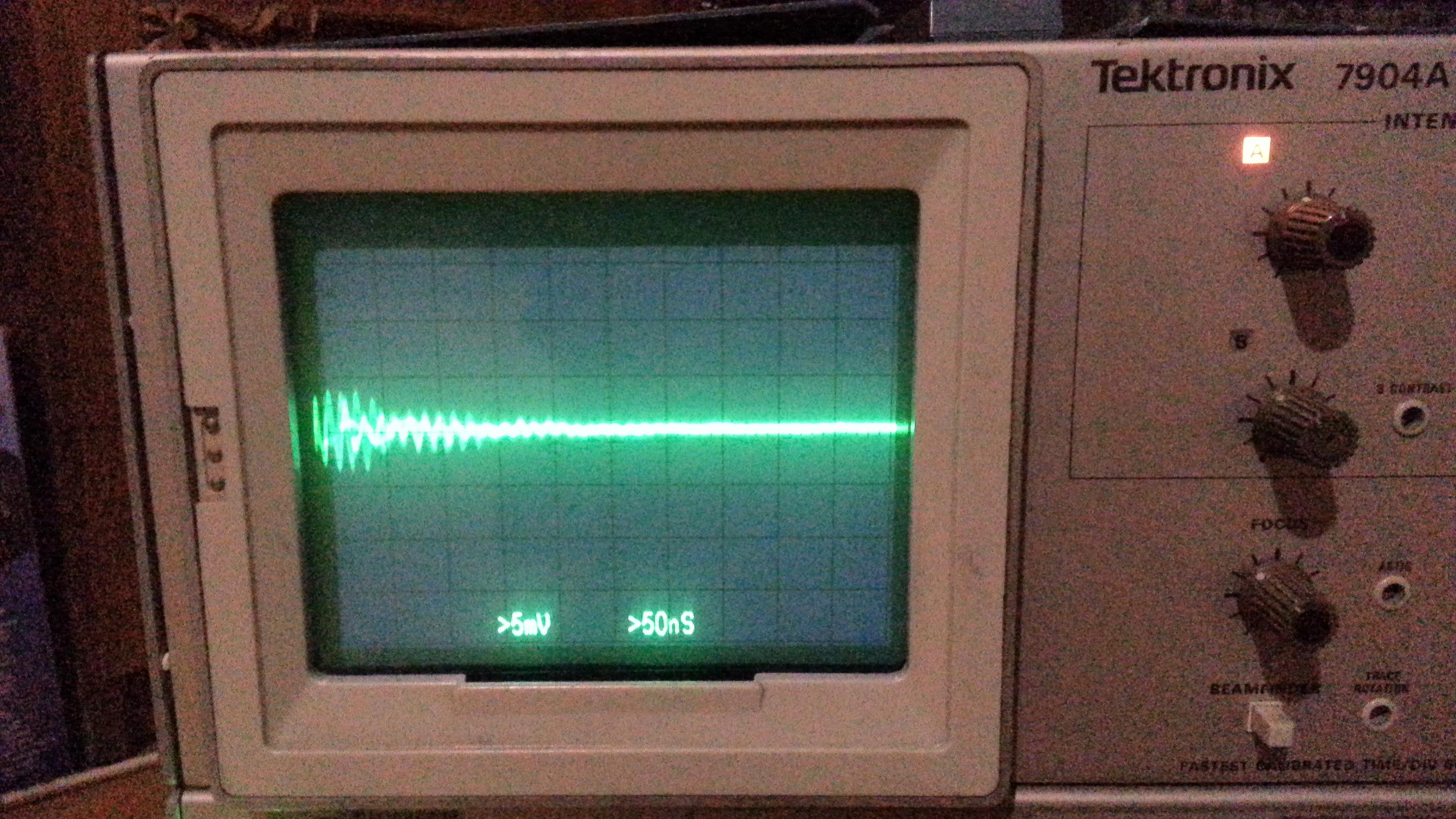

I have Wi-Fi adapter 1m close

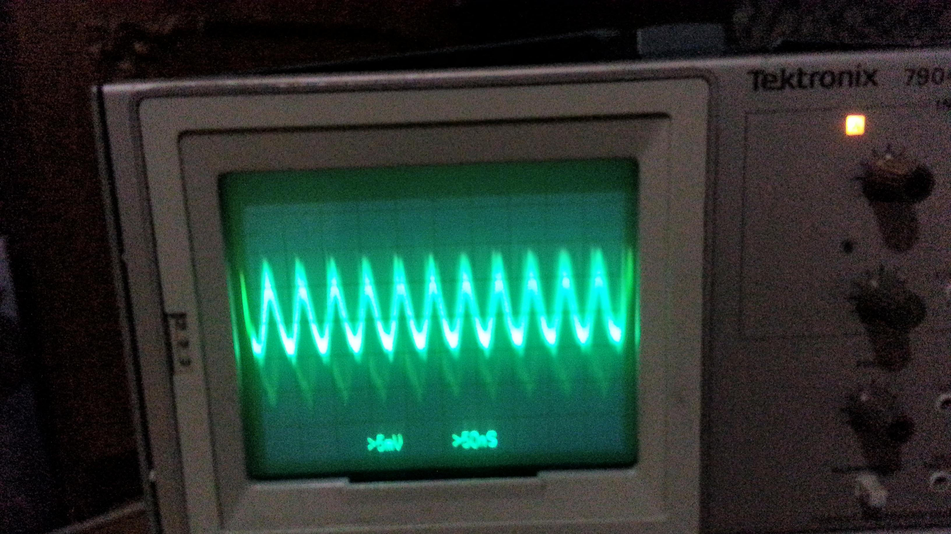

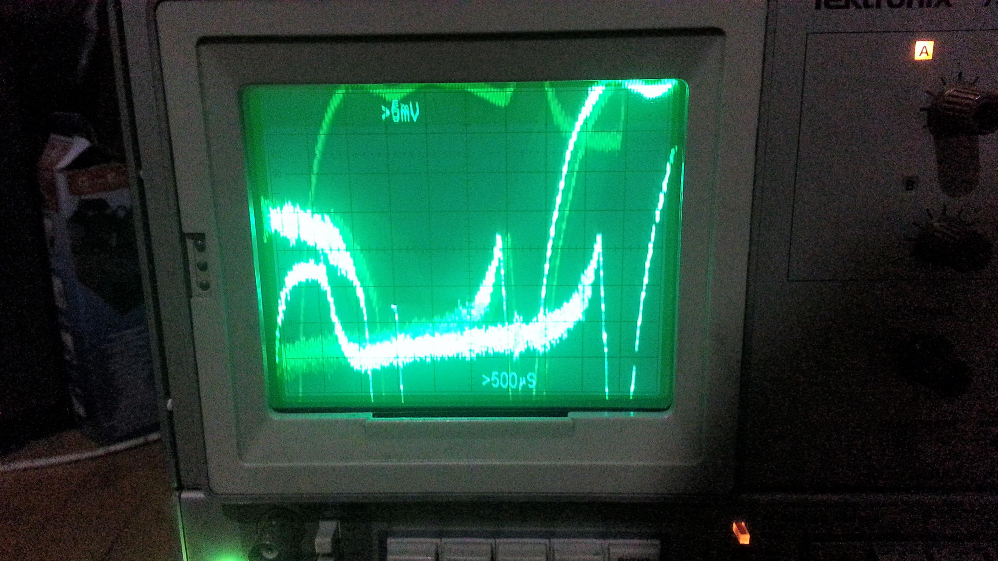

For RF ingress. Attach a short wire to your scope probe. Crank the sensitivity of the scope amplifier up 1mV/div or better. Turn you amp off and see if you see any oscillations. If not then it's likely not an issue.
RF can trigger small oscillatory condition in an amplifier as well. Still it's amp at fault.
With the scope at the same setting turn the amp back on and move the prob about the circuit but not touching anything. As you move closer to the source of a local oscillation it may appear larger on the scope. This doesn't always work but you can give a try. Then try to figure out what the cause is.

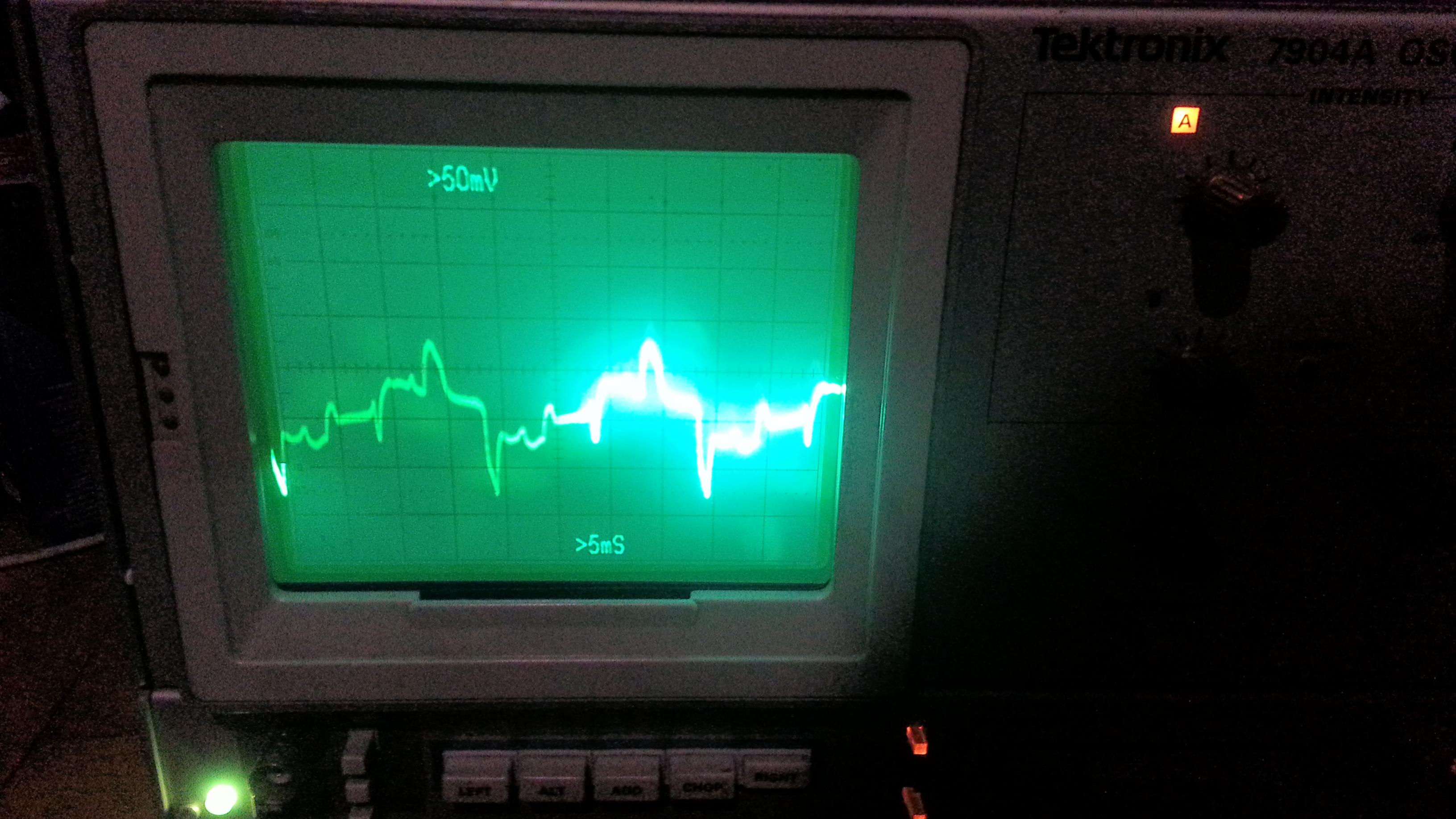

You are right, I have oscillation shown even when amp is off. This is without any wire, just the probe on the output of the amplifier.
This one with input signal connected.

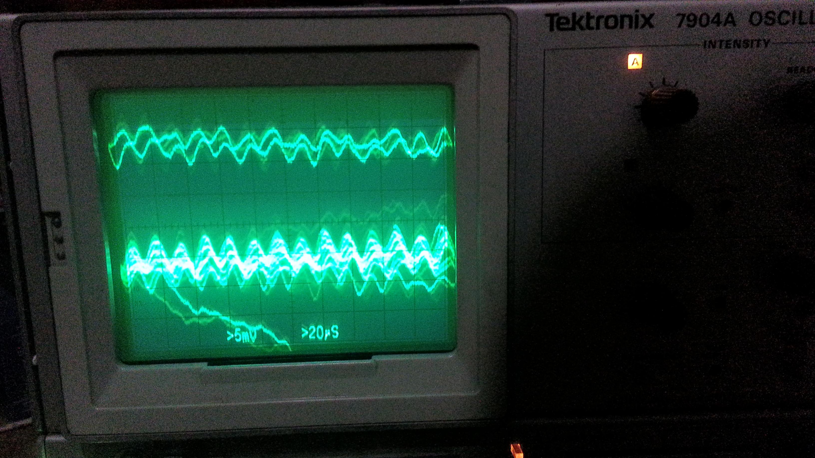

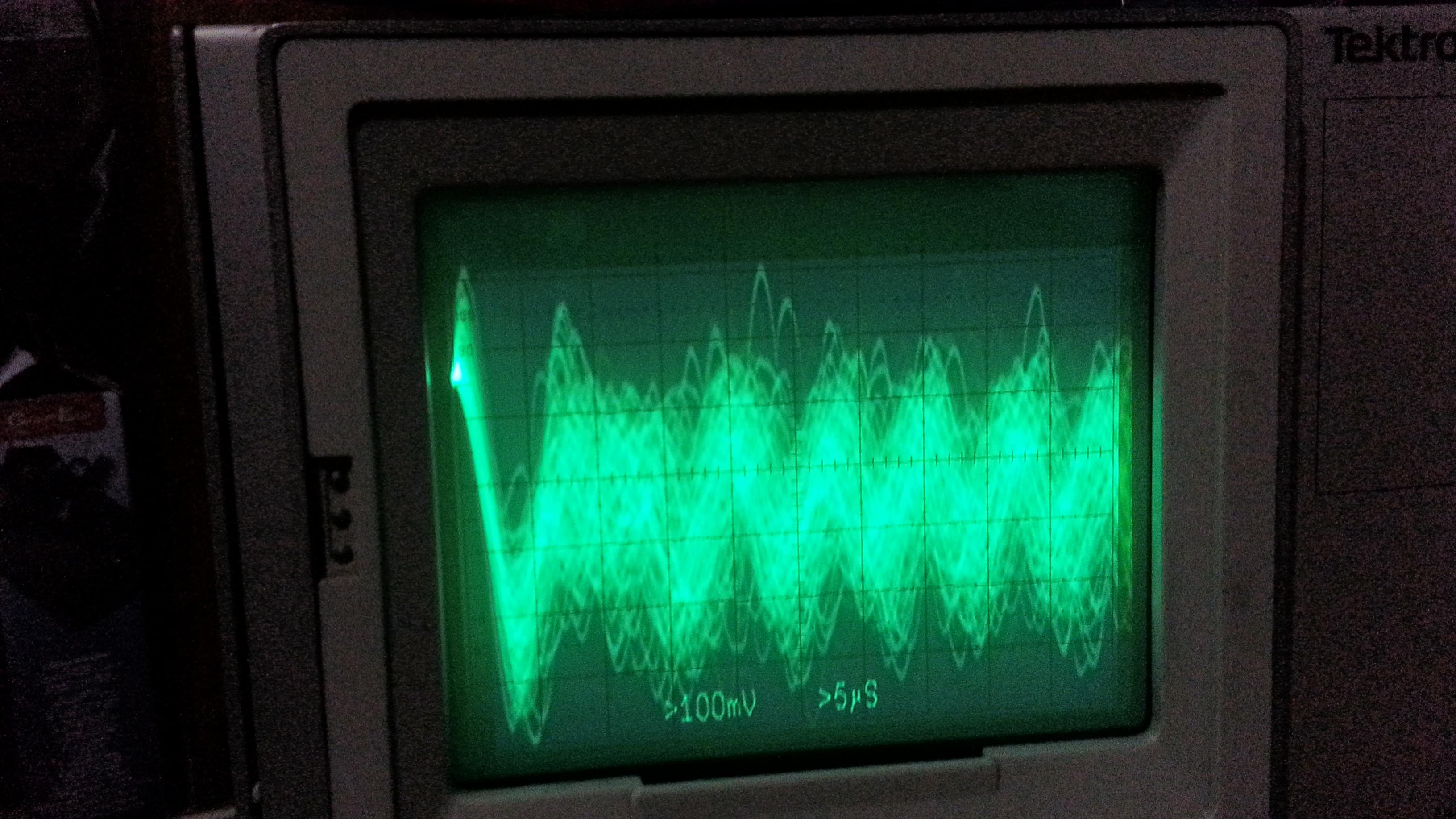

I'm sorry, I don't understand what do you mean. 50pF isn't appropriate compensation value?

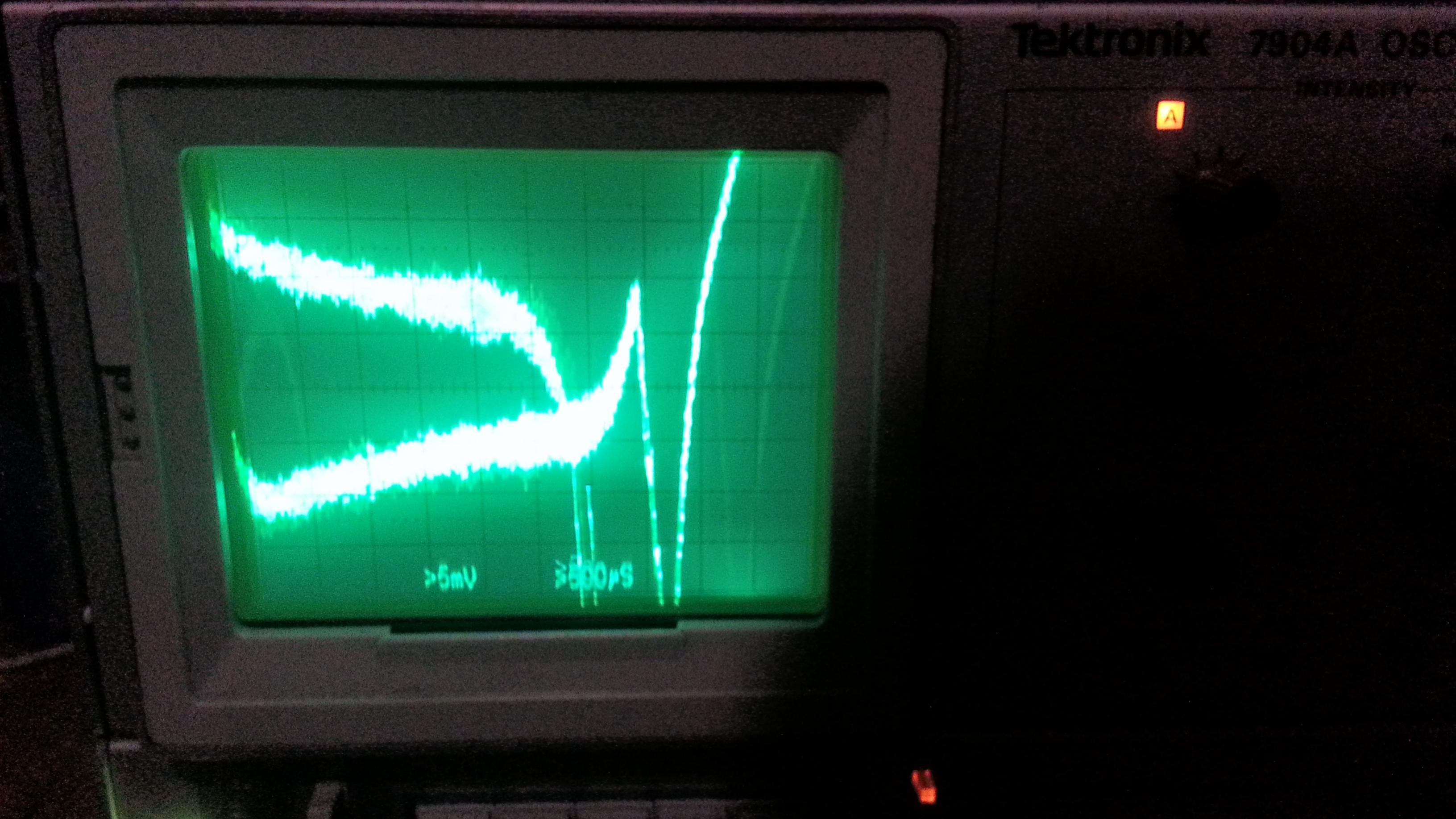

These are the probe with the piece of wire attached. The highest sensitivity of my scope only 5mV. Seems like my ambient is very polluted
Right. So what your seeing at the output of your amplifier might not be the amplifier. You have to isolate from what you see on the scope.
Is your amplifier in a case or just trapped to a heat sink sitting on your bench.
Try to find the source of the RF and shut it down.
