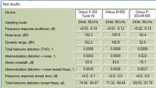

I have two of these (as part of the full Onkyo set - P-303/E-30/U-30/M-505) - one as a main amplifier in living room and one as spare.
Both of these:
Both of these:
- fully recapped except the big lytics (Panasonic FM/FC);
- input board lytics replaced with film capacitors;
- input board switch disassembled and cleaned;
- speaker protection relay replaced (contacts deteriorated visibly);
- IMPORTANT! unsolder and clean the adjustment trimpots if you do not want to risk frying the amp (do not ask how I know).

They do not "sound" at all and regarding people who write that this or that brand of capacitors is "grainy" or "musical" - I really do not waste my time on that.
In very general view - in signal path I have replaced lytics with film caps, in power sections I have tried to use 105-degrees rated lytics.
M-505 is very "generous" for your task - you can do one half at a time and measure/listen to the results.
You will hear what you hear...
