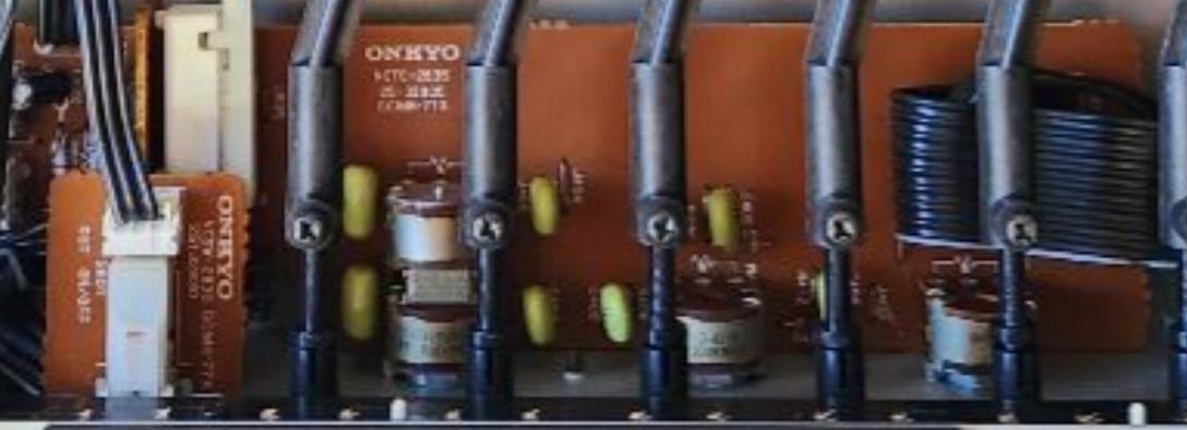

My Onkyo P304 treble potentiometer is becoming unresponsive and I am considering my options.
Undertake a diy replacement, (if a suitable alternative component is available)
Remove, strip and attempt a diy repair of the potentiometer if at all possible.

I have attempted removing the front panel but after removing the knobs,something is preventing the front panel from being removed. I am not able to identify the obstacle so might need to have another go at it.
Thank you Hugo for the link.
Some screws from top and below?,something is preventing the front panel from being removed.
Take you time.I am not able to identify the obstacle
Tiny plastic 'grips' that act as a kind of hook sometimes make fronts difficult to remove.

I sprayed both pots with contact cleaner and rotated them back and forth repeatedly, then followed up with more of the same. After a short drying period I powered the system up and did notice and improvement in both potentiometers performance, with audible differences in treble and bass.
I also decided to give other switches some attention including the MC/MM (moving magnet/moving coil) switches.

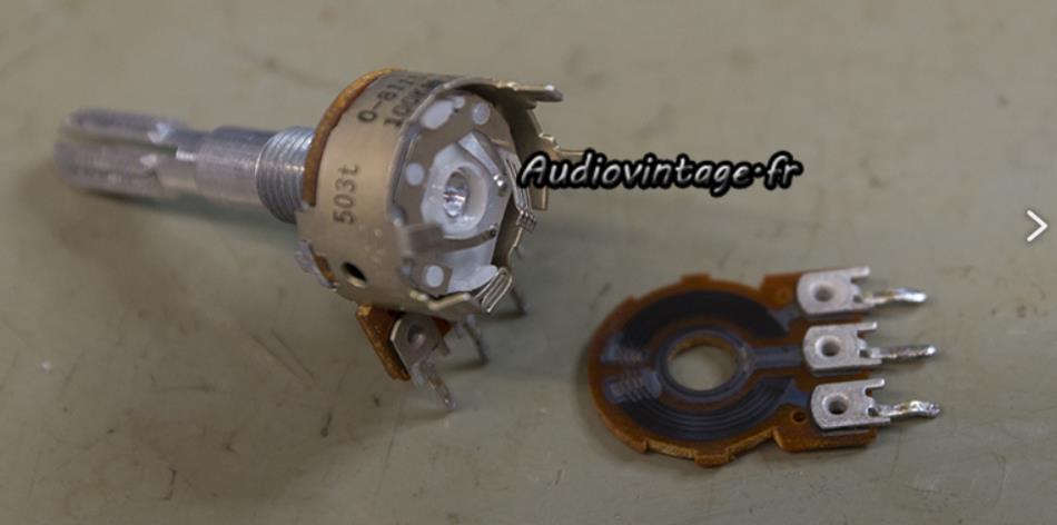

I have seen intermittent pots and switches for several reasons:
1) dirty contacts, as you have already addressed
2) cracked solder connections to the main pcb - easy to fix but access may require removal of the entire main board. Some units have a removable bottom plate.
3) loose terminals within the pot, where the terminals are riveted to the little board with the resistive tracks (as shown in the photo). This can be checked by measuring the resistance between terminals with a multimeter. Open circuit means no connection.
For # 3 you can replace the pot, or remove the pot and try to "re-crimp" the rivet connection with pliers, but be careful as too much force may break the brown phenolic board. The re-crimp has worked for me.
