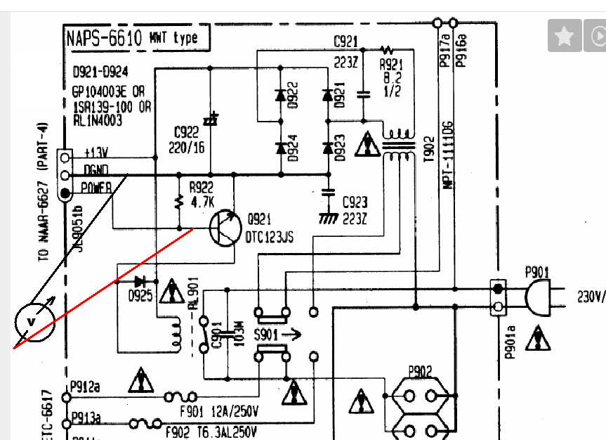

Next step, check for presence of full relay coil supply voltage. Usually it is applied to one end of the coil, the other end is then pulled to ground via the relay driver circuit. If the driver circuit is doing nothing, check its input. Sometimes you find a bad transistor in there. Generally keep an eye on bad solder joints around the relay, relay driver and its power supply.
Hi!
I checked for a voltage level toggling on the base of the transistor that powers the relay coil but there was nothing. I suspect that it is the microcontroller itself that doesn't send the command for some reason...
Then you'll have to trace back this signal. Either it gets lost or the µC really does nothing.

Is there a big dropper capacitor on the primary mains side for the standby circuit? Replace that if so. Take some pics.

If it isn't any voltage here,check if another transistor or a resistor is between microcon. and Q921.
If a transistor check the transistor.If a resistor,disconnect and measure for voltage.
If nothing is, desolder Q901 and measure again,or heat the Q901 .
Are you sure that protection circuit does not affect the same circuit?

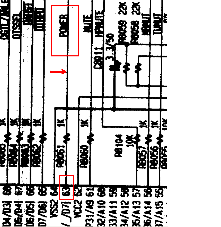

Power on, comes from Q8003,PIN 63.
Shematic diagram 4. NAAR 6627.
Are the stand by voltages ok near or direct on microp.pins?
Unfortunately we don't know what the microprocessor takes in account to permit the on.
Do you see the micropr, what the case still?
Are TQFP32? See for bad solder points or any type of missing connections from pin 63 up to the base of Q921

Hi thimios!
I already took measurements on the BJT that enables the relay, but there was no command coming from the microcontroller.
I assume that messing around the 13V / 5.6V produced some effect since the amplifier worked for a week and I believe that something is out of specification in the following schematic:
On that circuitry come unregulated 13V and regulated 5.6V. I highlighted the connection that goes to an interrupt pin of the microcontroller that has a suspicious label "power-off".
Unfortunately all the components that starts with "8" on the refdes are mounted on the bottom side and I have not managed to take all the PCBs out of the chassis...
I will try to figure out what the ucontroller expects on that "power-off"pin...
Any idea?
