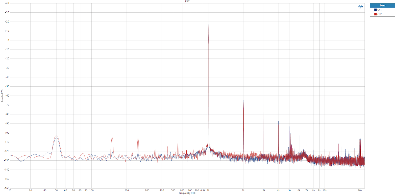

Harmonic Distortion
User @Martigane tested Burson op amps in his Whammy in 2020 and provided some useful measurements. In particular, check out the harmonic distortion profile of the Burson V6 Vivid:
![burson v6 harmonic distortion.png burson v6 harmonic distortion.png](https://www.diyaudio.com/community/data/attachments/922/922658-602b371aeac26b5e6ad4e52e99f79efb.jpg)
Here: https://martigane.blogspot.com/2020/02/objective-benchmark-part-1-op-amps.html
This looks similar to the distortions in many of Nelson Pass’s JFET circuits. I am assuming that most people on this forum are familiar with his amplifiers. In particular the SIT amplifiers and the H2 buffers feature 2nd and 3rd order harmonics as a major feature in the sound of the amplifier. I ran tube amplifiers in my home for a long time, including a JE Labs 2a3 stage, and felt that they often threw huge sound stages. Perhaps the Bursons will nudge my rig in that direction.

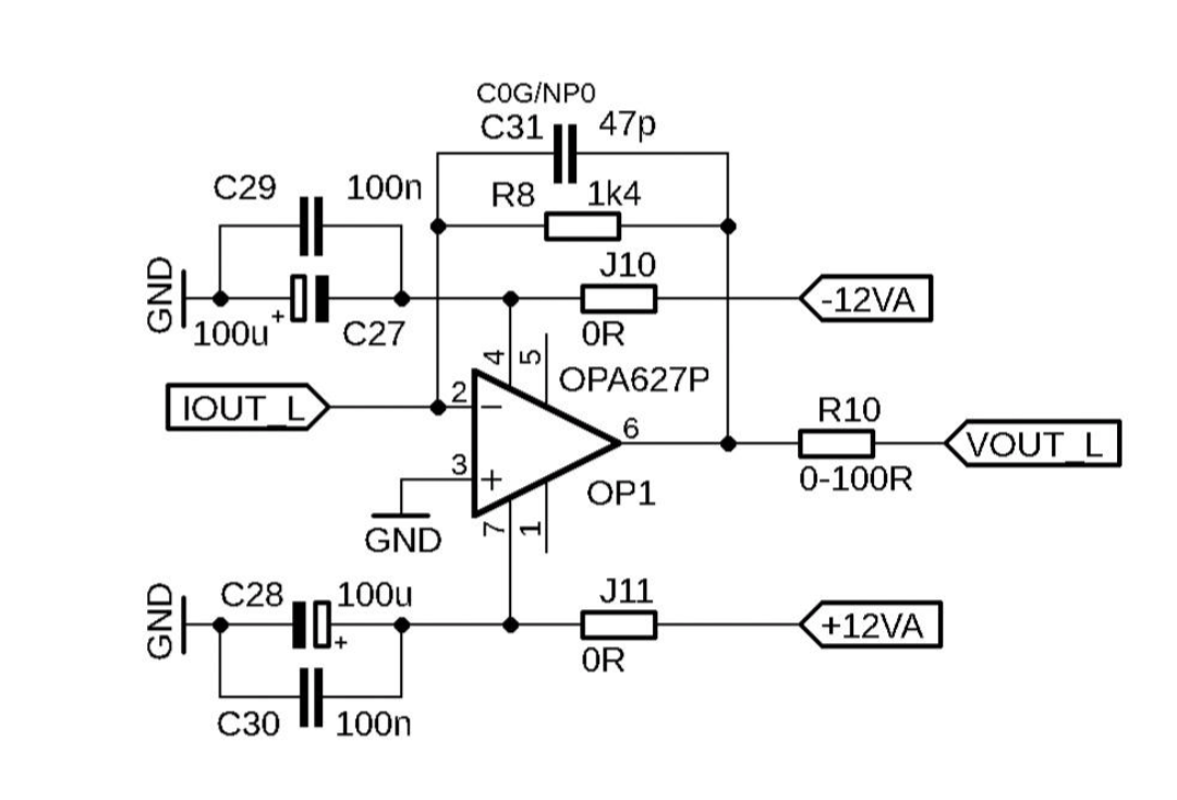

Also keep in mind that the NE5534 single-opamp chip is decompensated, and is only stable for gains of 3 or higher, unlike the NE5532 dual-opamp chip. The 5532 is unity gain stable.
OPA1611
ADA4898-1
OPA1655
M2x daughter cards began life as easy-to-source alternatives that don't use obsolete & hard to find Toshiba JFETs. Also as ways to explore the sonic virtues or drawbacks of different circuit approaches: pure single ended ("Mountain View"), composite amplifier ("Norwood"), diamond buffer ("Austin"), transconductors ("IPS6"), bootstrapped power rails ("IPS7"), etc. I did intentionally make IPS7 very friendly to opamp swappers / experimenters: it even had two DIP sockets on the board, one for single opamps like the LT1122, and another for duals like the NE5532. Because some interesting opamps are ONLY available as duals, and other interesting opamps are only available as singles. I wanted people to have the ability to try all of them.
Checked the datasheet, you are correct - but it also says the 5534 can be unity gain stable with external compensation. If I understand correctly, this IV stage features a compensating capacitor (C31), so I think a 5534 should be fineAlso keep in mind that the NE5534 single-opamp chip is decompensated, and is only stable for gains of 3 or higher, unlike the NE5532 dual-opamp chip. The 5532 is unity gain stable.
![Screenshot_20220113-171647.png Screenshot_20220113-171647.png](https://www.diyaudio.com/community/data/attachments/922/922741-b9e6013f219e63ed32bced731fd30801.jpg)
I am still trying to figure out if this sallen-key reconstruction filter features compensation or where I would add it. I am running config 1
No, the authors of the 5534 datasheet think "external compensation" is what they say it is, in their datasheet. They say "external compensation" is a capacitor connected between pin5 and pin8 of the NE5534. See second plot on page 6 and first schematic on page 7 of the Philips datasheet attached here. Philips designed the TDA1034 and let their American subsidiary Signetics sell it. Signetics renamed it the NE5534. Then TI copied the 5534 and sold their copy for considerably less. Which eventually helped convince Philips and Signetics to stop making it themselves.

Even in the "uncompensated" version, there's still a 12pF capacitor connected internally
between pins #5 and #8. See the schematic on page 9 of the NE5534 data sheet.
https://www.ti.com/lit/ds/slos070d/...86368&ref_url=https%3A%2F%2Fwww.google.com%2F
22pf is referred to as the "Typical value". Is it safe to say that should be the value I use between pins 5-8? I am reading data sheets most days now but it's a steep learning curve so any input is appreciatedSee second plot on page 6 and first schematic on page 7 of the Philips datasheet attached here.
Config 1's resistor values are rather too high to suit an NE5534, they're better suited to a TL071. I suggest 2k4 for R1,2,5 & 6 and 330pF for C1-4. The lower R values reduce the noise.
