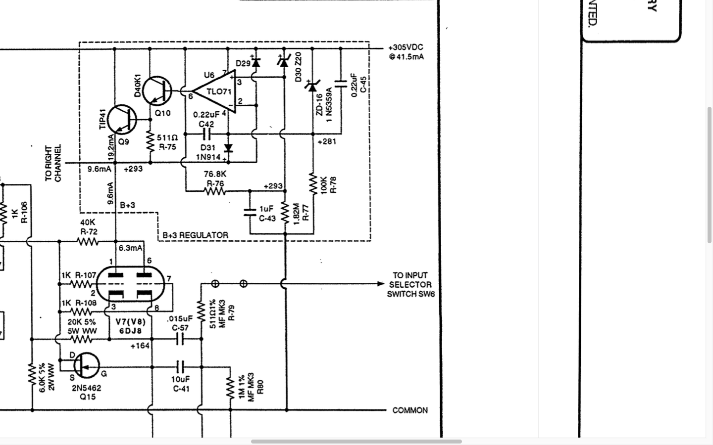

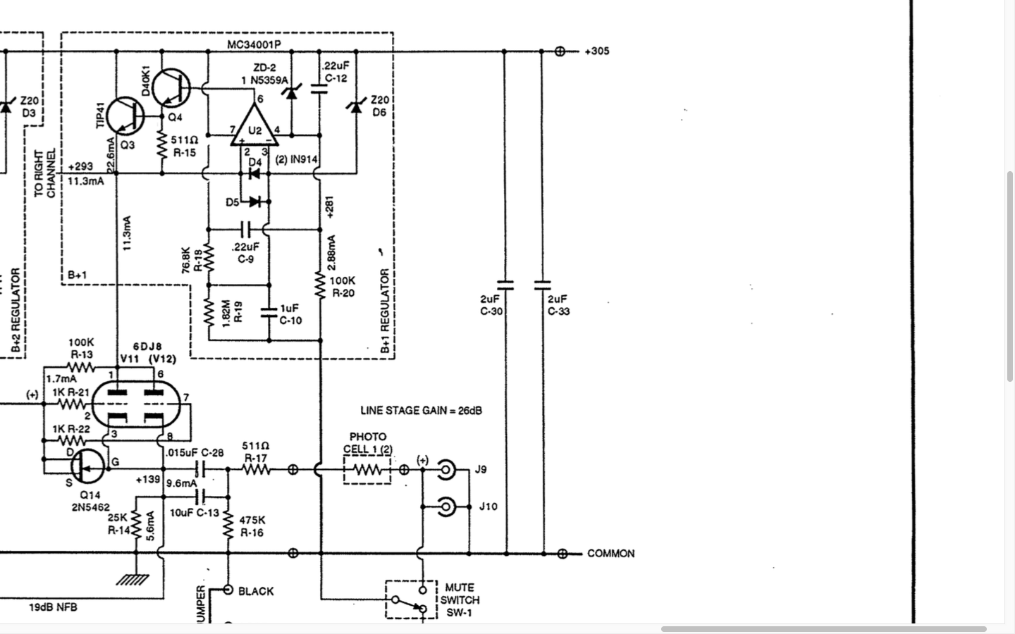

I'm still working on building this preamp.
I just can't figure out why TL071's inverting input is protected by D29 & D31
while MC34001's inputs is by D4,D5 and Z20.
Are they equivalent tricks or the does the reason is the op-amps different characteristics ?

The +in and -in of the MC is the wrong way, but the pin nrs. are ok.
Mona
I yet noticed that. No big deal.

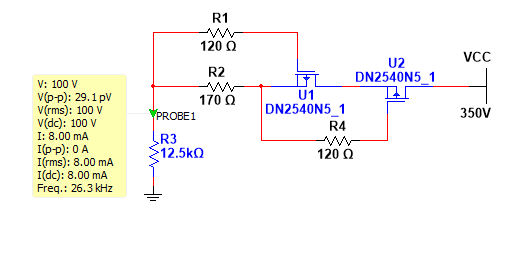

For example, this one, from AudioXpress.
This is the one which SY propagates (Impasse preamp, His Master's Noise phono preamp) :
The current is set by R2, the other two resistors prevent oscillation.

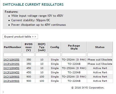

BTW, 10M45S and 10M90S are discontinued by ISYS (unfortunately).
Unlike conventional depleted mode MOSFETS, they have all kind of protection.
Are they? I see plenty of 10M90S in stock at both Mouser and Digi-Key and no indication that they are discontinued or slated to be in the future. Where did you get this information?
Directly from IXYS technical support in Europe.
Thy are sold because some stock still available.
I wish they reconsider this decision.

I my project (ARC SP10), what current should I use in B+1 regulator (2 x 11.3mA) and B+2 (2 X .4mA) and with what Rset resistor ?
And why do we have to adjust CCS ? I thought that current is set by the circuit impedance.

DN2470 would seem to be a good choice (700V rating). There are a lot of designs on this and other tube amp forums which specify the DN2450 (500V rating)
The ARC SP10 is using the current source as a load (for very high AC impedance but low DC drop across it) not as a source of current as such.

Use LTSpice simulation to adjust resistor values, its best tool in this case.

It is just strange that neither Mouser or Digi-Key shows them as obsolete or even NRND if this is true.
Also, I see the following at the IXYS website:

The inputs must not go outside the supply voltages of the op-amp.In one case an input is protected with two diodes at the supply and the other input with another two diodes connected to the first input.The second case has each input protected separately with respect to the supply with diodes.Not much difference.I started my post asking about op-amp inputs protection.

No, it is a current source but not a constant one 😕Should I replace op-amp current source by a mosfet one like AudioXpress' one or whatever ?
It is a stabilised voltage supply with max.current limit.It seems that the R? you mension determins the max.current.But the schematic on entry 1 doesn't show that R.

Thank's Mona. This time your answers suit me fine.
The resistor I mentioned (Rset) yesterday 03:07 PM is part of DN2540 ccs schematic given by linuksguru in 15th January 07:56 PM post.
Effectively it sets the current value up.
So I'll keep building this preamp without modification.
