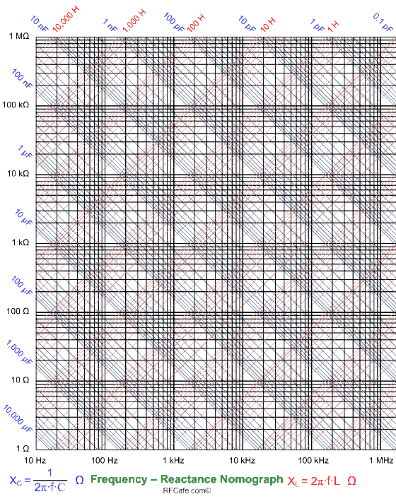

It is not just resistance. What is the Reactance of C4 10nFd?i find 1260...
160k ohms at 100Hz, 16k at 1kHz, 1,600 ohms at 10kHz. So just C4 and R2 define a gain of like 16,000/390 or 41 at 1kHz. I have grossly over-simplified but the trend is like EdGr says: sloping over the whole audio band with a wiggle in the middle. The so-called "RIAA curve" (RCA's New Orthophonic).

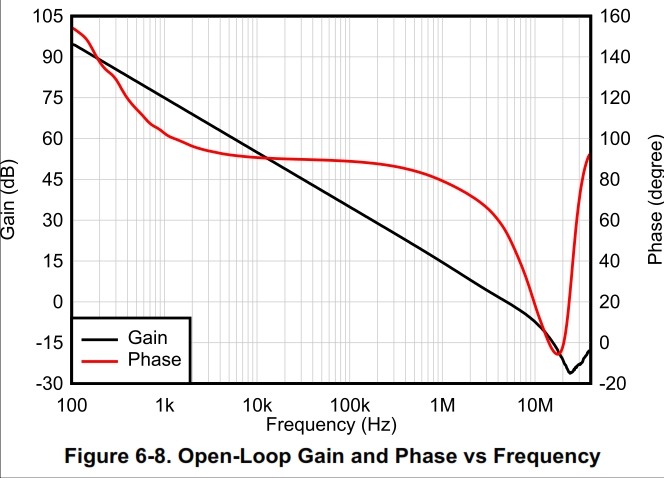

Calculating the network with reactances of the caps at 100Hz, 1kHz & 10kHz:
A (100) = 360x (51dB)
A (1k) = 78x (37dB)
A (10k) = 14x (23dB)
Given the MM specification of approx 2.0mV @ 1kHz (thus 0.2mV @ 100Hz & 20mV @ 10kHz):
100Hz: 0.2mV * 360 = 72mV
1kHz: 2.0mV * 78x = 156mV
10kHz: 20mV * 14x = 280mV
This may look strange, but the actual time constants in the RIAA network are 3180μsec, 318μsec and 75μsec.
Hence the assumptions of 0.2 @100 and 20 @ 10k are a bit off, a factor 2 approximately (rule of my thumb).
Then:
100Hz: 0.2mV * 360x * 2= 144mV
10kHz: 20mV * 14x : 2= 140mV
The TL072 should have an open loop gain of well over 360x at 100Hz, it is 95dB => 56000x, so the gain margin is 95 - 51 = 44dB (160x)
Better do a simulation for more accurate results, I leave that to the simu-enthusiasts.
Attached the datasheet of the TL072, open loop gain and phase at page 20 upper right corner.
