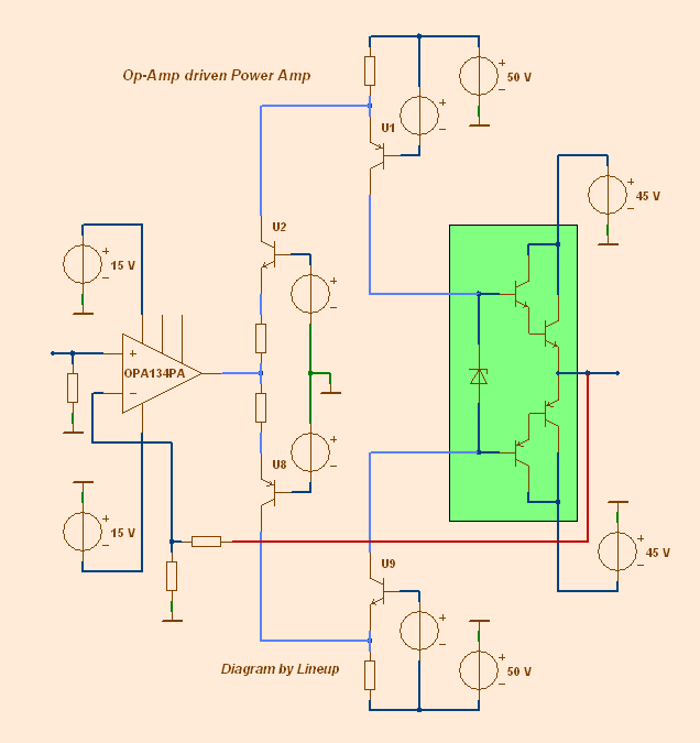

Hello!
Op-Amps would be perfect to drive and control power amplifiers
if it wasn't for one thing:
- they work at too low voltage when it comes to higher power.
With the method I will show you, you can drive a power amp
even from an opamp working from +5/-5 Volt supply.
First, opamps can often put out 20-40 mA.
OPA134, which I have used for my SPICE, puts out 35-40 mA.
This is more than enough to drive one power output stage.
A triple Darlington needs no more than like 0.1 mA for plenty of Watt out.
One ordinary Darlington (driver + power transistor)
should do well on a couple of mA. Maybe max 5 mA in worst case.
This tells us, that there is no need to amplify the current from Op Amp.
We can let the output current, as it is, drive the power amplifier output.
If you look at my diagram, you see the opamp output is split in 2 halves
and via foldback transistors fed to the output.
The blue lines show the path.
I have done SPICE for 100 W/8 Ohm 200W/4 Ohm with great results and performance.
OPA134 is good enough for this job.
I think you should have a look att this method if you are intesrested.
Regards Lineup

Nothing new about a power amp with more voltage gain after the VAS stage. Dan Meyer of SWTPC used that technique in the Universal Tiger back in the '70s. It did not use an IC opamp like yours but a discrete one. It had an annoying tendency to blow up.

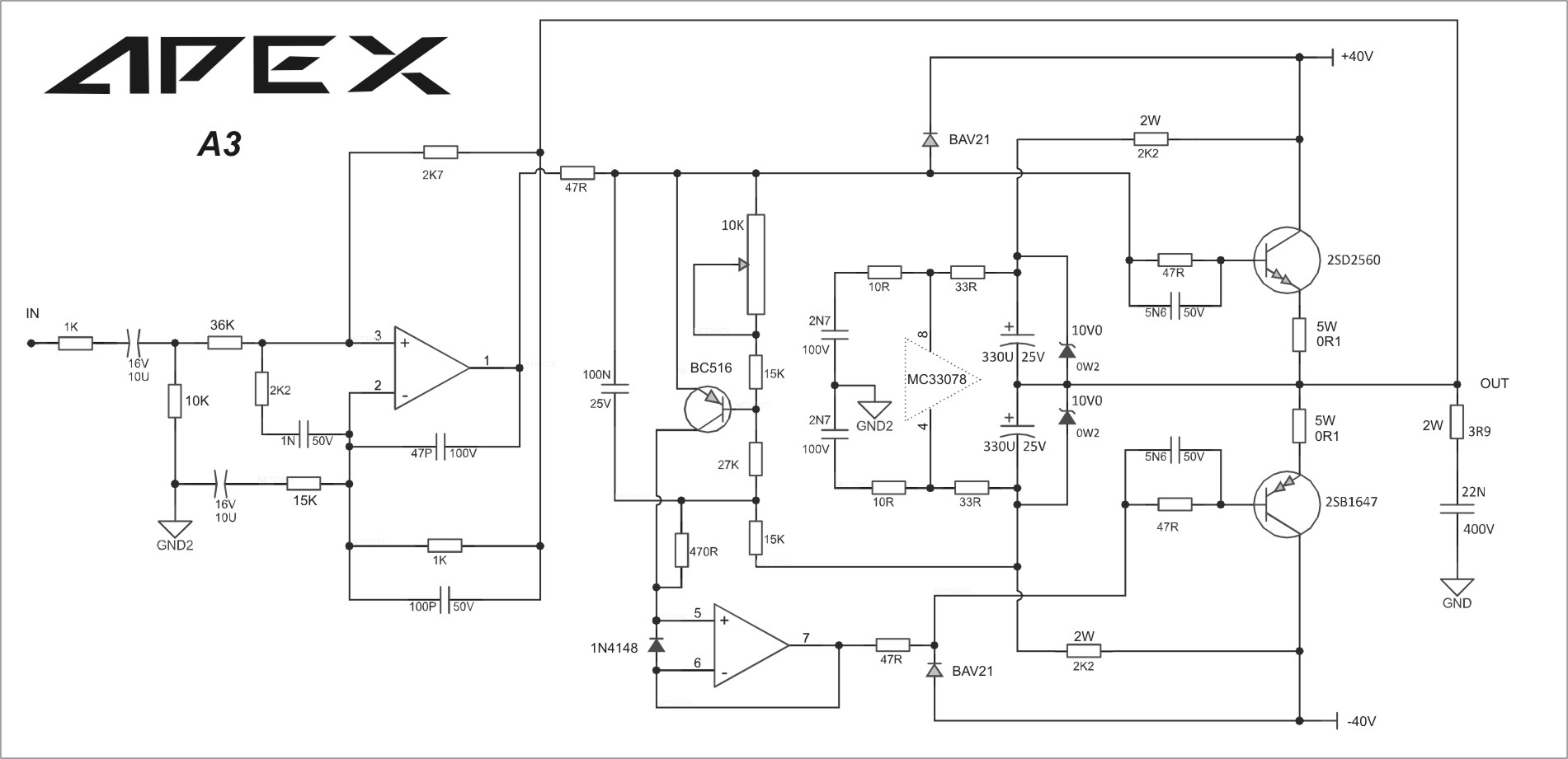

There are a number of variations of the op-amp-front-end circuit you designed in use out there in the real world. Carver uses a similar topology in most of their amps with a TL072 front-end, but the rest of the circuit is fairly complex implementing their class-G/low heat design. Alesis also uses a similar design using an NE5532, but the output stage is inverting, so the negative feedback is fed into the non-inverting input.
Attached is a simple op-amp/power amp circuit using an NE5532 and darlington outputs. It's very basic, but offers great sound and good stability into varying loads.

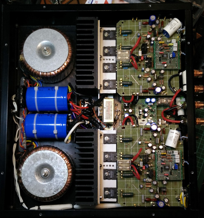

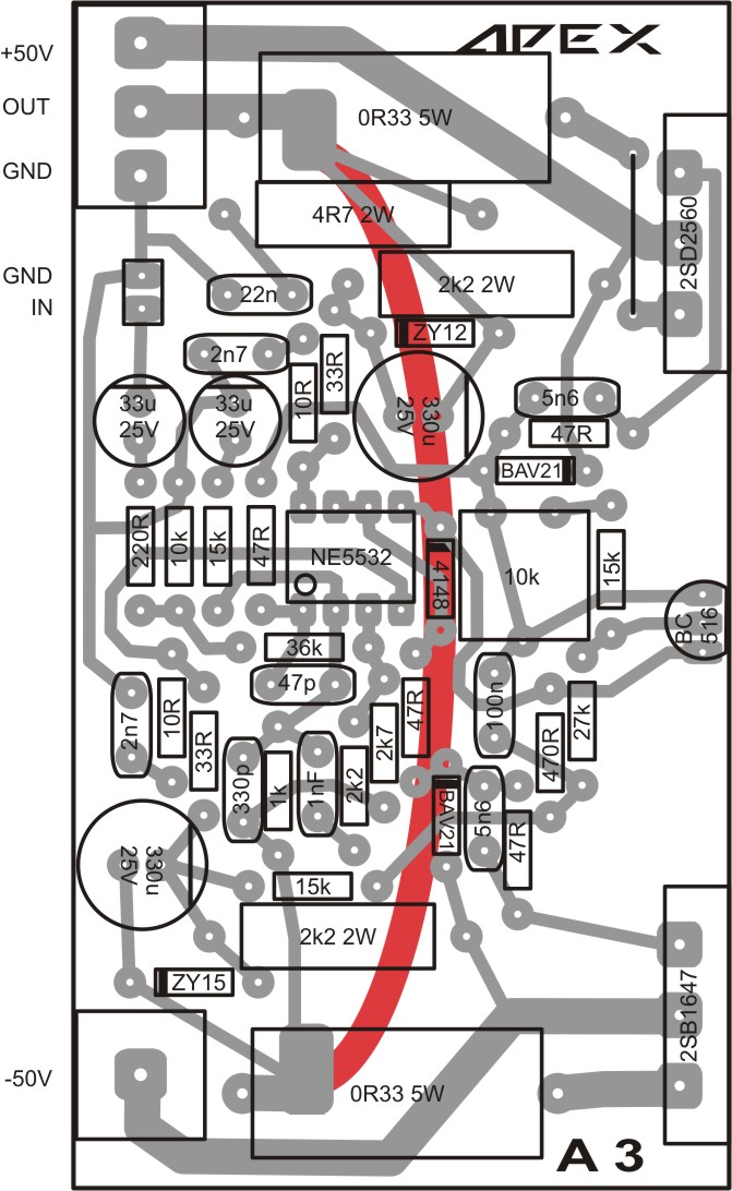

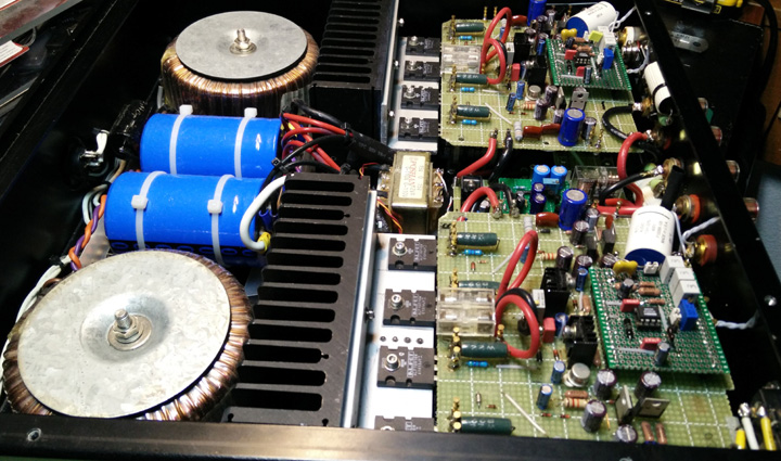

While trying to realize a high power diamond buffer design, I stumbled upon this tread. It has inspired me to create a stable and working version a Op-amp driven power amp. The performance of it is extremely satisfying.

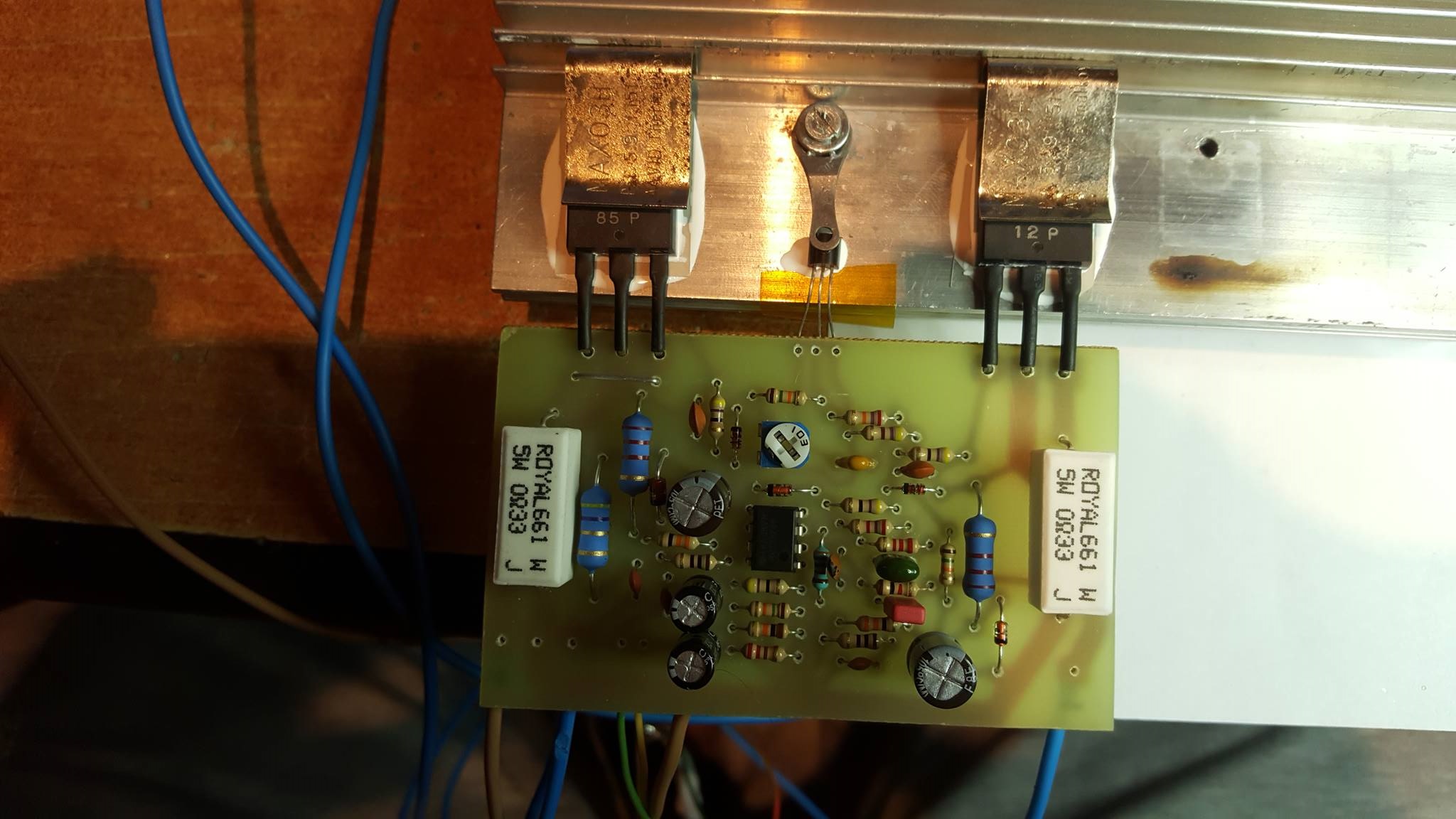

Not quite. I used similar circuit as suggested by Lineup. With some old parts from my parts bin and no capability of etching board, I made something like this.

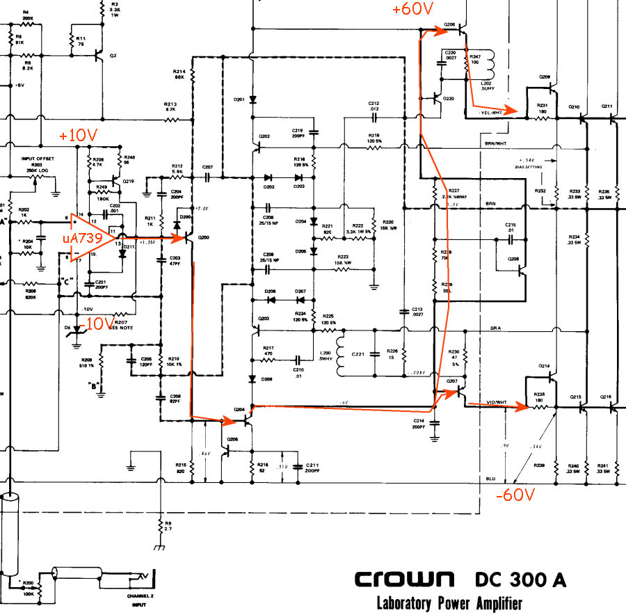

Around 1967 (49 years ago)--
Crown DC300, 200WPC, input uA739 (chip opamp) working on +/-10V power.
elektrotanya.com/crown_dc-300a_instruction_sch.pdf/download.html
There are dozens of other examples of boosted chips, some elegant, some messy.
Using a chip is a small short-cut in the long road to a good stable power amp. If you really understand the Power stages, the front end is a small (but important) detail. Looking at commercial designs it may come down to what saves a penny with the specific parts the company has standardized on.
Oh, maybe I really don't understand the Power stages, but then I did went through a lot of failures before I completed this build, and I have learnt a lot from it.
I find OPA627 is relatively stable and well behave Op-amp. A well placed capacitor was all it took to stabilize the whole circuit.
There is a convenient benefit with op amps that saves a DIY builder the hassle of sourcing NOS or obsolete thru-hole monolithic pairs, sorting a bag of low noise TO92s for a fair match or making awkward thermal coupling arrangements on the PCB. With JFET inputs, its a no-brainer. For the price and convenience of using an opamp from the spare parts bin, you can be on your way to a high performance front end, FWIW.
At least it's a good way to find out what a good match can do for/to your audio 😉
