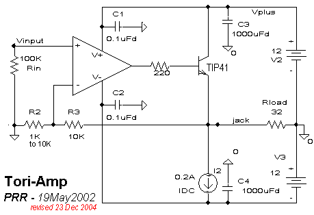

I've finished constructing a simple SE SS amplifier, see attached schematic, from here: A Failed Successful Experiment.
Powered it up, checked voltages, all looked good. When listening to it I heard a high pitched whine which made me think it was oscillating. Put it on the scope and yes, oscillations. With NE5534 in place oscillations are at 1MHz, with a TL071 350kHz, and with a OPA227 1.4MHz.
Supply decoupling is good (100nF right at the power pin and 100uF a centimeter away). What should the next troubleshooting step be? A small cap across the feedback resistor?

Try a base resistor on the TIP, 10R to 47R.
If that isn't enough, also add a series RC between the +/- inputs of the LT1363.

The NE5534 must have a GAIN of 3x min to be stable. You have a GAIN of 2x. The TL071 is unity GAIN stable. There are several other things that you have not specified and they can cause in stabilities.

Try disconnecting the signal feeding the TIP31C base. Scope the op-amp output for the presence of oscillation. If the output is clean (which it should be), the output transistor circuit may be the problem. Perhaps, the base input circuit of the transistor features too much parasitic capacitance, I don't know. Try could replacing the TIP31C with another NPN power device, or perhaps a power darlington NPN device.
Alternatively, you could try adding a small amount of capacitance between the op-amp's output and inverting input pins to try and compensate for any phase shift that may be stemming from driving the output circuit. Should it still oscillate, even with the power TIP31C removed from the circuit, the layout of the feedback signal path may need to be shortened or possibly rerouted.
The op amp is driving a large capacitive load thru the base-emitter junction, this load can be a source of oscillation. Certainly makes any op amp struggle. Needs a base resistor to isolate it and probably compensation across Rf. The NE5534 has compensation pins, use them.
Connecting Rf to the op amp output in this type of circuit worries me - perhaps it should connect to the transistor emitter and include it in the feedback loop. Also the 1meg bias resistor on the non-inverting input is far too large for the typical input bias current - reduce it to the parallel combination of Rf and Rg to minimise bias voltage errors and especially capacitive coupling to the output (another cause of oscillation).
I can only second (or third) the probable need for some base resistance and a few pFs across the feedback resistor. BJTs are not fond of inductive source impedance.

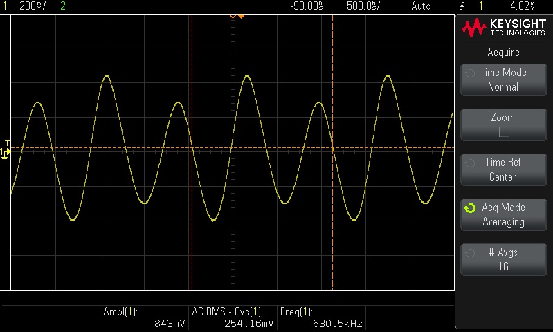

I soldered in a 22ohm base resistor which cleared up the oscillations on NE5534 completely. Unfortunately it still happens with a OPA134, TL071 and OPA227. 33pF on Rf doesn't help, not does 10k 220pF RC across +/- inputs. I'll continue to try some of the other suggestions made here.
Attached is scope shot from OPA134
try 100r base resistor.
That sorted it out, thank you! 🙂
