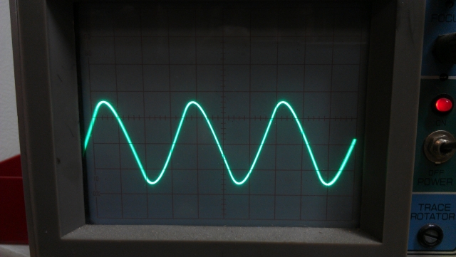

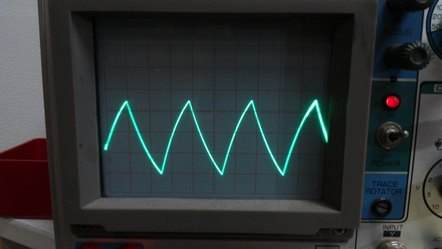

I want to make a better sine wave than the below circuit produces. I know very little about OP amp design.... a capacitor or an inductor somewhere, or a whole different circuit? Or chip? Frequency range and amplitude are fine, but I can hear a "slapping" that I think are the points on the wave? Thanks!

Thanks, but I've already been changing the frequency with the C off pin 2. I need to smooth out the wave.....
That's the point: your circuit by design doesn't make a sine wave. If you really want something that comes close to a sine wave, you need to throw away your circuit and build something else, for example one of those TI circuits (though some of them don't have a well-defined amplitude).
On the other hand, if you just want a smooth waveform without sharp corners, it may be sufficient to just add a capacitor from pin 5 to ground. Try something of the order of 1 uF, depending on how smooth it needs to be.

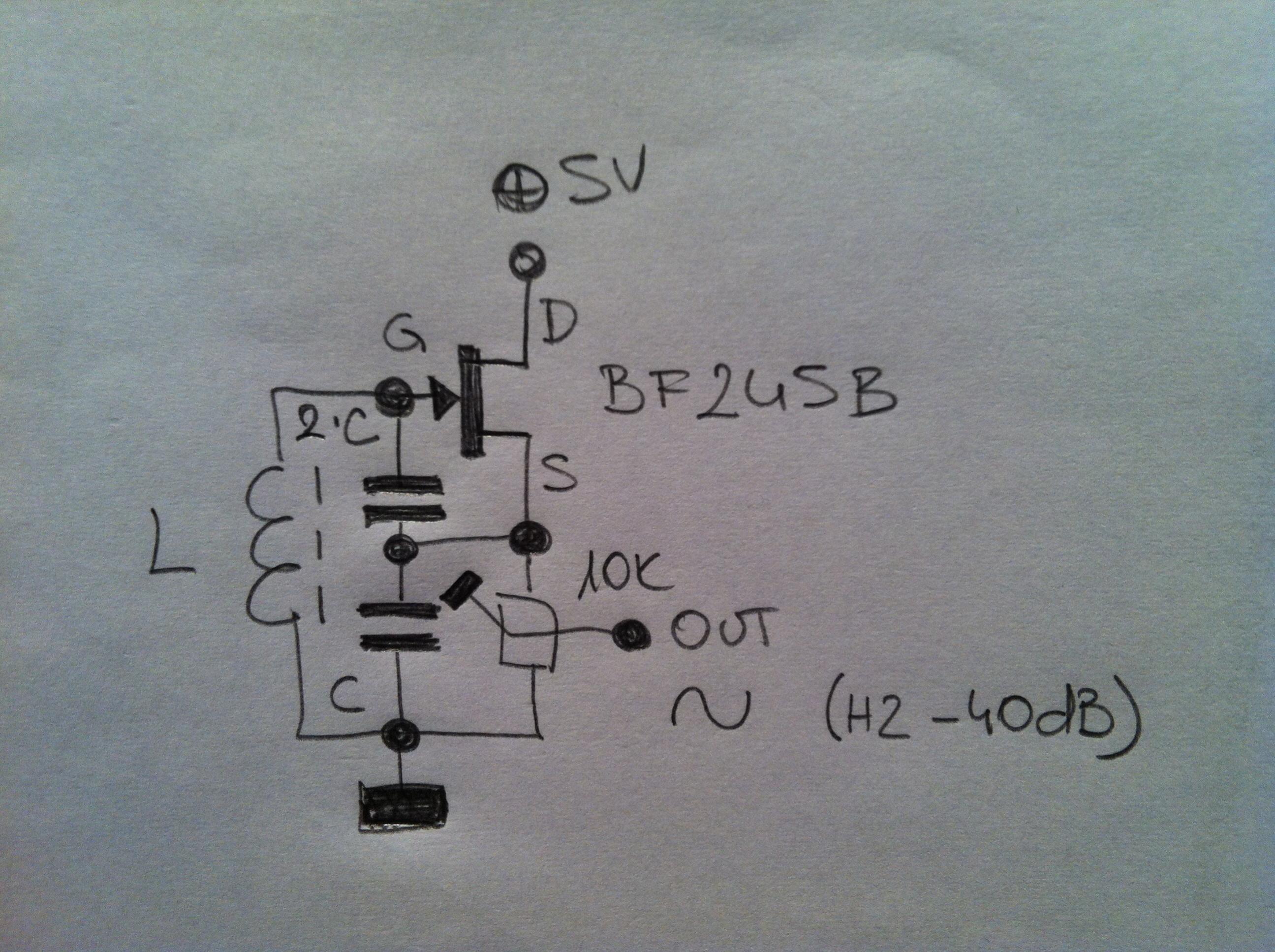

You need something like this. 😉
For low Zout add THS4031 buffer.![]()
Looking at the original circuit, I think the intended frequency is about 1 Hz, which is somewhat unpractical for an LC oscillator.
No problem to get very stable 4,7 mH, 10 mH, ... 100 mH inductors these days.
No L saturation possible at gate current levels, very stable oscillator, H2 can be -50 dB when 2*C is trimmed.
OK, but how about the quality factor at 1 Hz? I would expect that the DC resistance ruins that, unless you have a really big core.
No problem 1 Hz, anyway this oscillator is more or less intended for fixed frequencies or switchable variants.
Perhaps the change in bias voltage is causing your amplifier to become unstable. It may be starting to oscillate on one of the peaks of the triangular waveform.
Marcel - You rock! I knew I went to the right forum.... ended up with an .047uF to keep amplitude (turns out it is a tradeoff). No more slap! (at the risk of being booted, it's for a tube amp - all I'm gonna say...). Needed some pure solid-state geekdom. Thanks again!

A capacitor will filter harmonics but will change the amplitude with frequency...did you say tradeoff?
