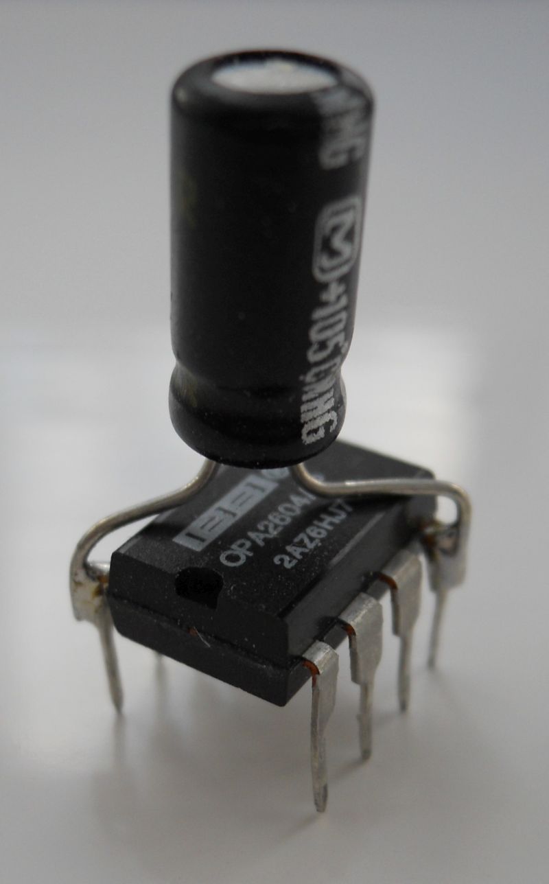

The cap size isn't all that critical and a 'lossy' electrolytic generally works very well.
Cap type and size is more of an issue when there is a definite pre-existing problem to be fixed (such as spiky rails from a switching supply) rather than simply adding something to maintain a low impedance.

Everyone has their own ideas on the caps and I would use a good commercial quality electrolytic.
An imaginary case... a noisy rail with lots of high frequency hash from an SMPS. Adding a well meaning high quality 0.1uf (say a ceramic) could in some circumstances cause the noise to be 'altered' or even increased as the cap interacts with the inductance of the series PCB print. The 0.1uf in series with a 1 ohm might be better in that case.
As a general rule I find the 'lossy' electrolytic tightly coupled (electrically) to the opamp works really well.
