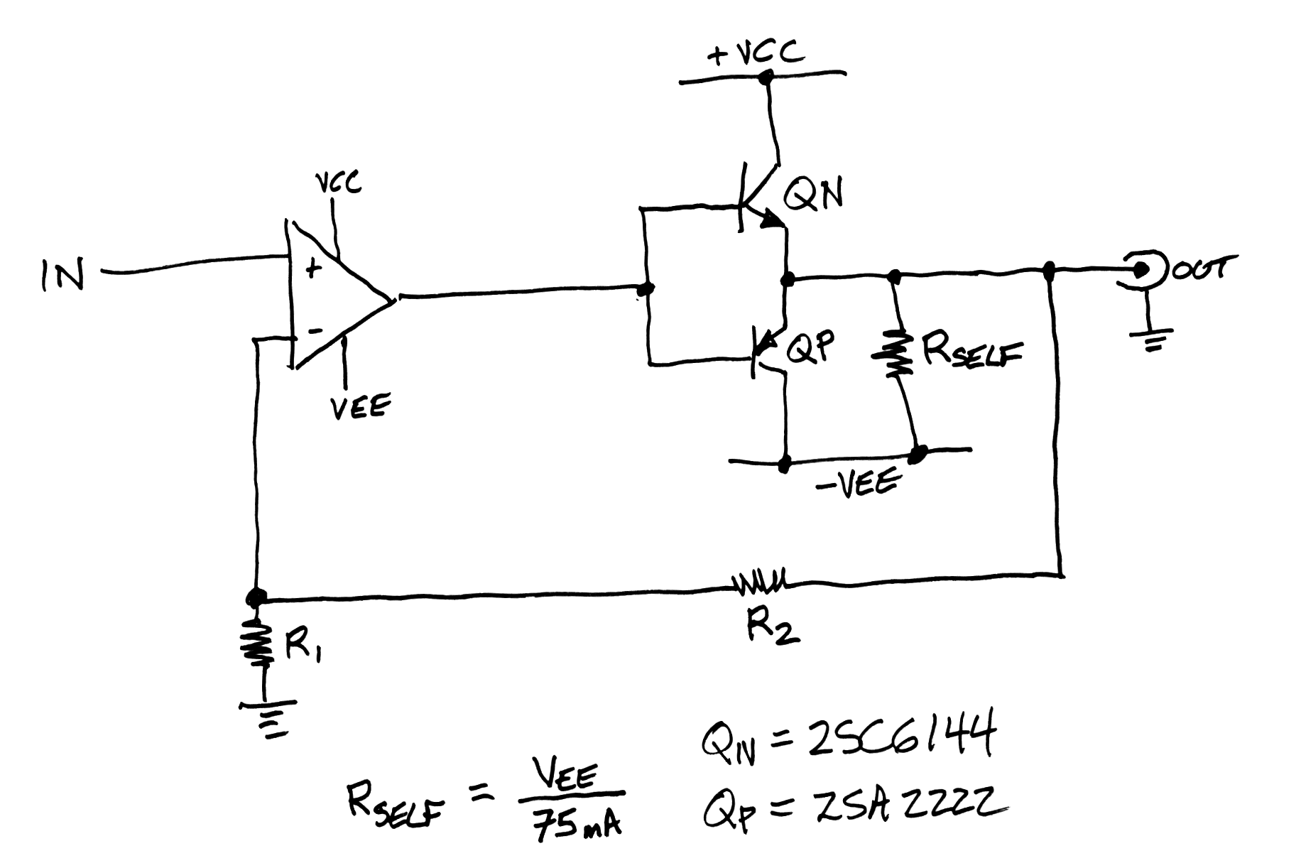

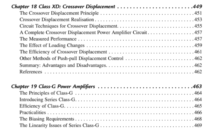

Maybe you might want to try Douglas Self's "Crossover Displacement" idea.
He builds a Class-B power amplifier, but then forces a medium sized DC bias current to flow in the output stage, by simply connecting a current sink between the output and the minus supply. This runs the output stage in Class-A for small and medium-sized output currents (currents less than the DC sink). The output crossover, where NPN stops conducting and PNP starts conducting, is displaced. It's not at zero current, it's at DC_bias current. Self argues that this is less audible than crossover at zero. It's in his Audio Power Amplifier book, take a look.

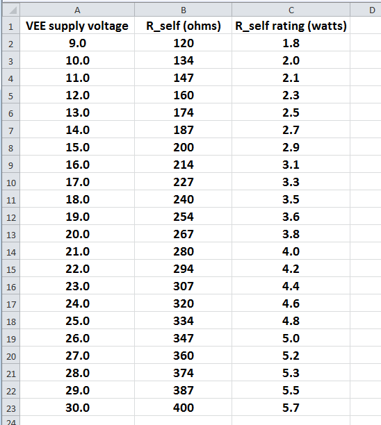

A simplistic implementation is shown below. The arithmetic is also attached.
_
_
Very interesting, where Can I read about it in more detail? Douglas Self Audio Power Amplifier?
I have Douglas Self Small Signal Audio Design, great book.

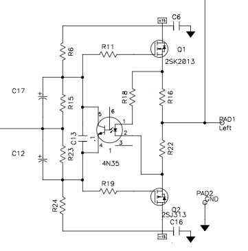

I've made a very good 'phone circuit similar to that, but with a MOSFET instead. Base it on the old Siliconix current sink app circuit. See here- http://www.diyaudio.com/forums/chip-amps/163224-designing-super-low-distortion-headphone-amp.html
Is this the circuit you're referring to?
If so, what controls the offset at the outputs? Looks like the large 1M shunt resistor would make the impedance of the inputs mismatched resulting in a lot of offset.
Nice simple circuit. Thanks Mark for sharing it.
Is it best to mount both transistors on the same heatsink for thermal stability?
What value would you use for R2 if using the ADA4627-1?

The circuit you show is usable but by no means good, as it still has heavy gm variation over output swing. Basically the 100R (R2) fills in for the "dead zone".
If the 100R were not there at all, the dead zone would be in full effect, forcing the opamp output to slew rapidly from about -0.6 V to +0.6 V (or vice versa) each time the closed-loop output transitions through 0 V. This results in crossover distortion that doesn't really go away even at very low amplitudes.
With the resistor in, the opamp itself takes over for small output currents (<~6 mA peak), in which case the circuit acts like the buffer stage isn't even there. You'd be losing some loop gain as a result of the voltage divider involving 100R and the load, but it would be OK. At higher levels, the opamp still has to deliver no more than about +/- 6 mA (at which point the drop over the 100R becomes large enough for one of the transistors to turn on), which is an acceptable but by no means negligible load.
Do yourself a favour and implement some (semi-)proper biasing for the transistors. Two 1N4148 small-signal diodes in parallel with a 10 µF electrolytic across the bases and about a 2k2-3k3 resistor to either the negative or the positive rail would go a looooong way, while biasing the opamp output into Class A to boot. I'd use emitter resistors of like 1-4.7 ohms for an AB output headphone amp; adjust bias levels with a series resistor between the two diodes. (Common BD139/140s are a bit on the slow side and should really get some half-decent bias current. You may not want to spare as much as 30 mA, but 10 mA would be well spent. Aim for about 13 mV across each emitter resistor, i.e. 13 mA for 1 ohm or 6 mA for 2.2 ohms.)
While it's not terribly critical, the bias diodes are best placed directly at their respective transistors to exploit heat conduction through the legs (this is why I said any series resistor should go between the diodes); some further thermal coupling by establishing contact between the cases may be beneficial as well.
