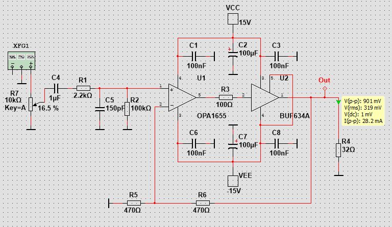

The schematic is attached.

- Start with the datasheet schematic - the good engineers at TI know what they're doing.
- I wanted to dabble with Crossfeed, too. I made some separate boards for trying those.
- Install some sockets to allow flexibility to play with swapping gain resistors and bandwidth resistors.

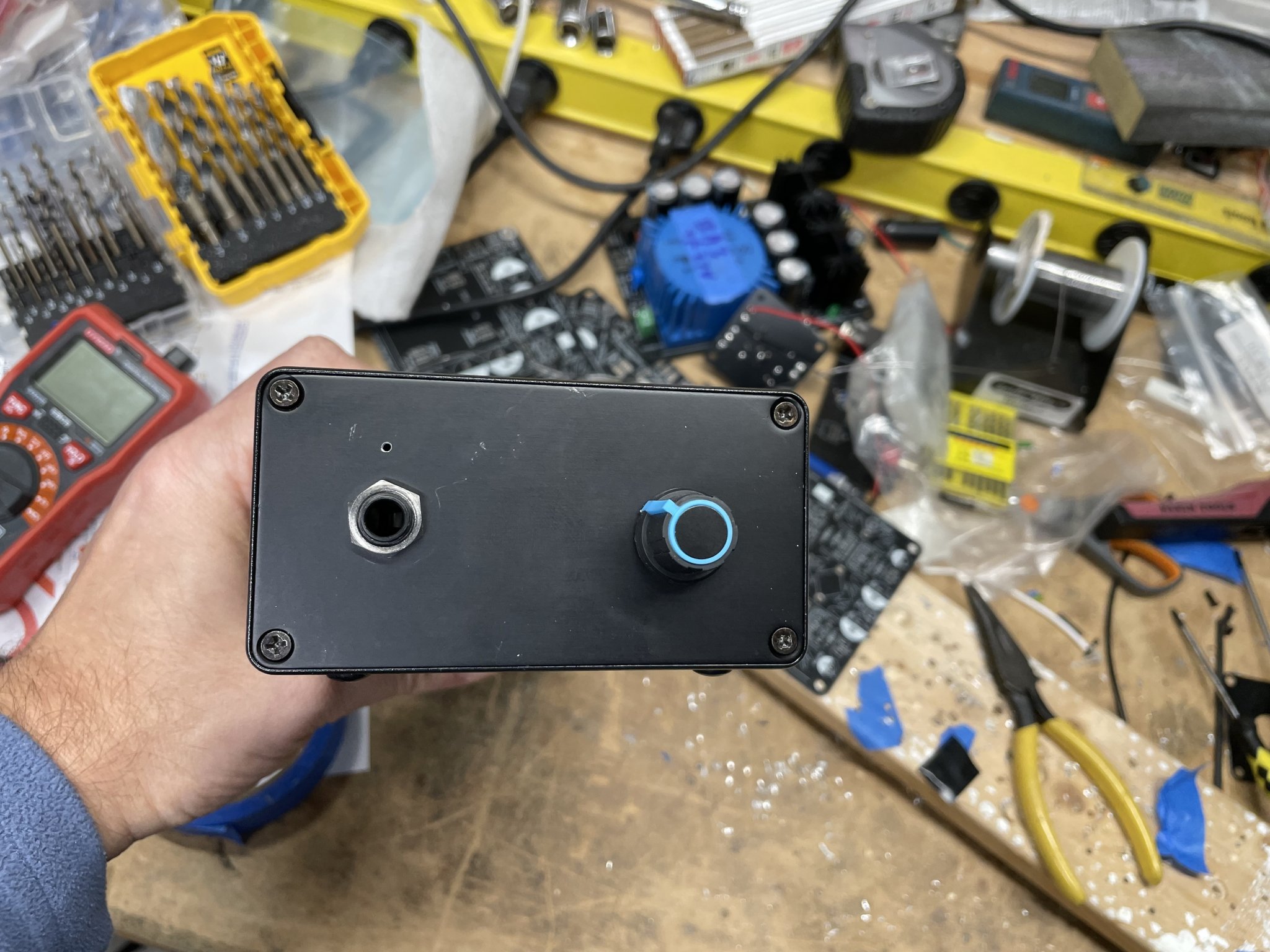

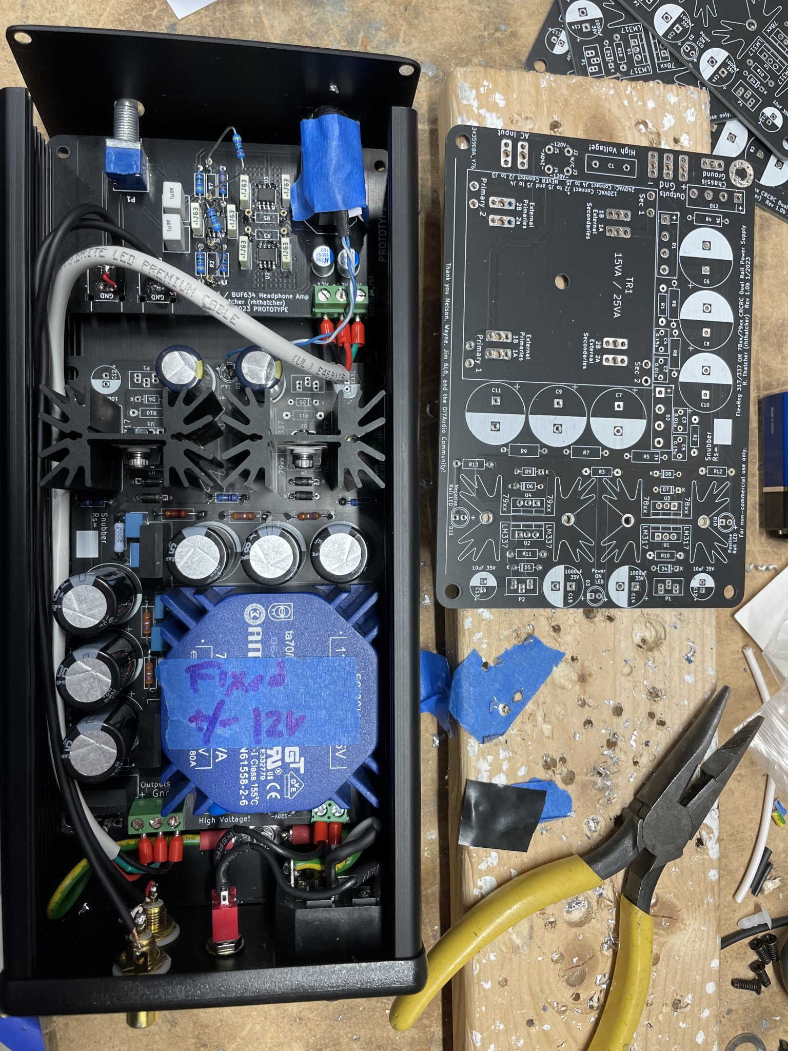

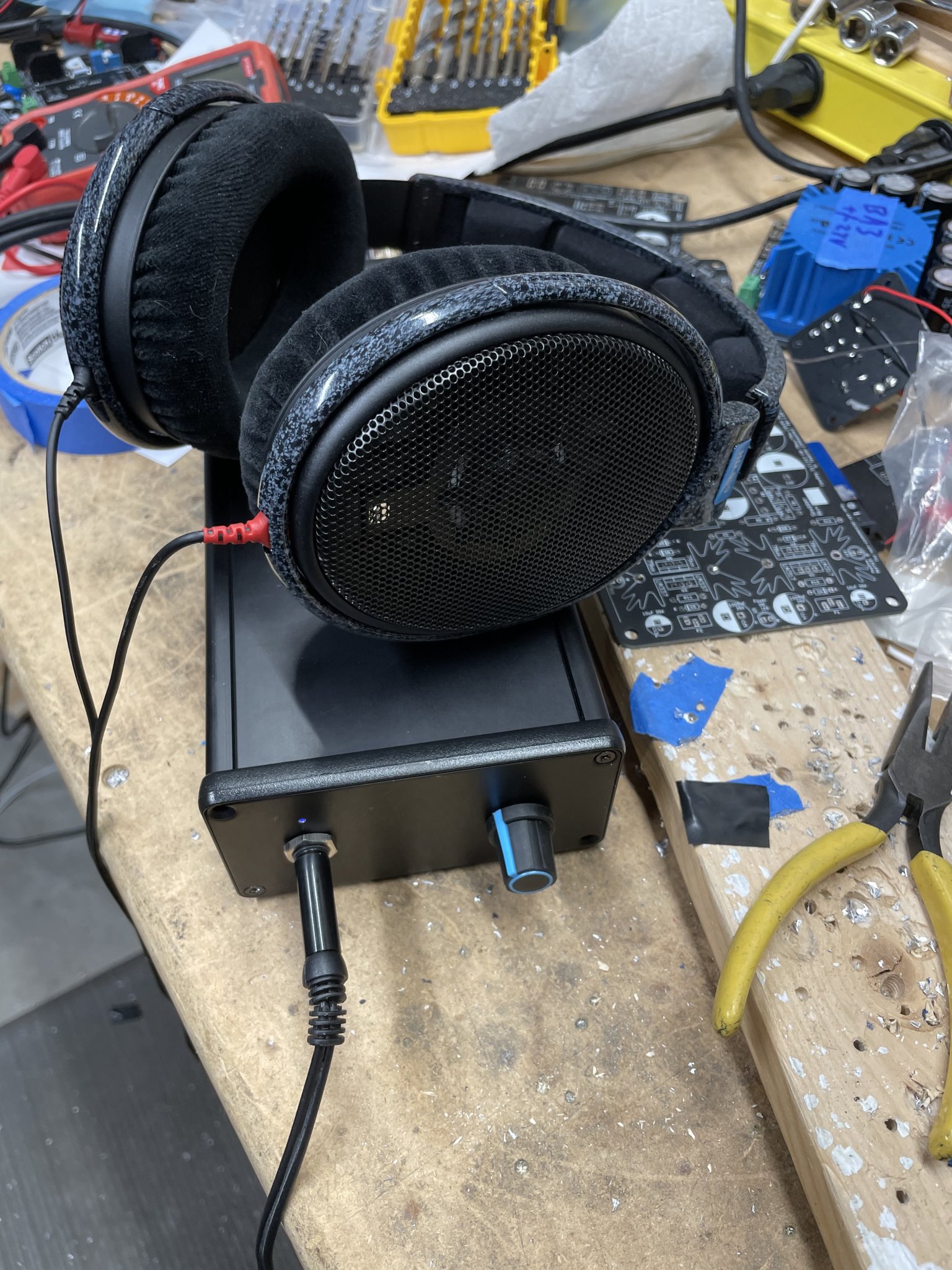

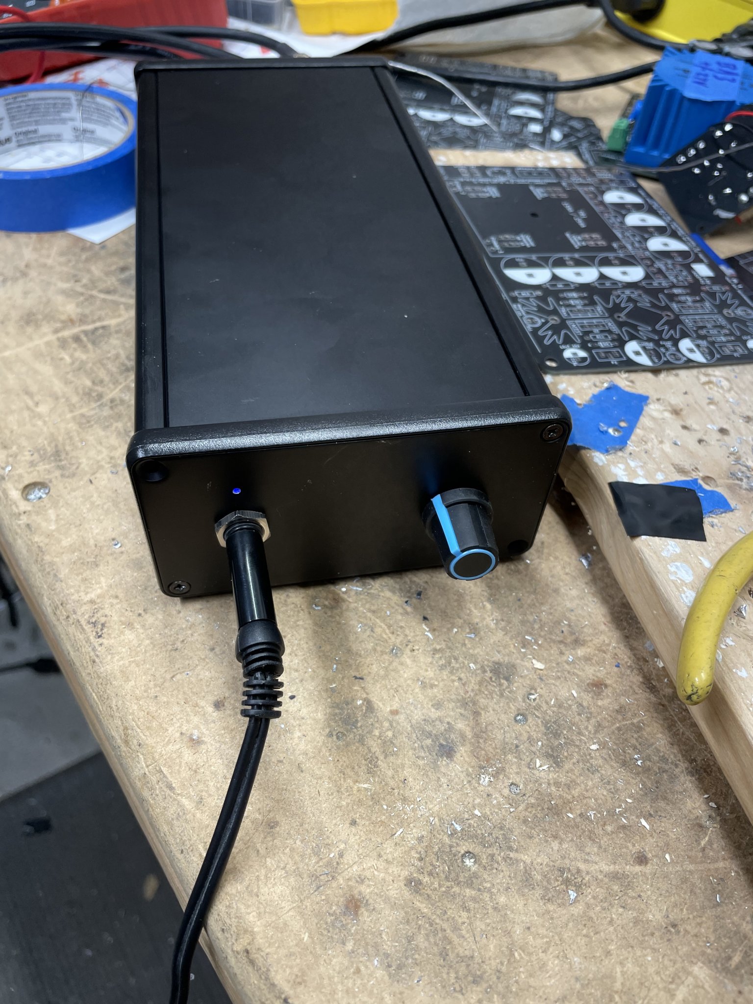

Update #2: I put this into a Hammond chassis with a FlexReg power supply board set for +/- 12v. What’s a FlexReg? I’m glad you asked. It’s a new board I did that has an on board transformer, CRCRC pre filter and then regulators and caps. It’s a FlexReg because you can choose fixed regulators (e.g. 7812 & 7912) or variable 317/337. I’ll make a separate thread for this board. For the record, the sound is quite nice on my Sennheisers.
Update #3: I’ll include a bare FlexReg board with the amp kit.

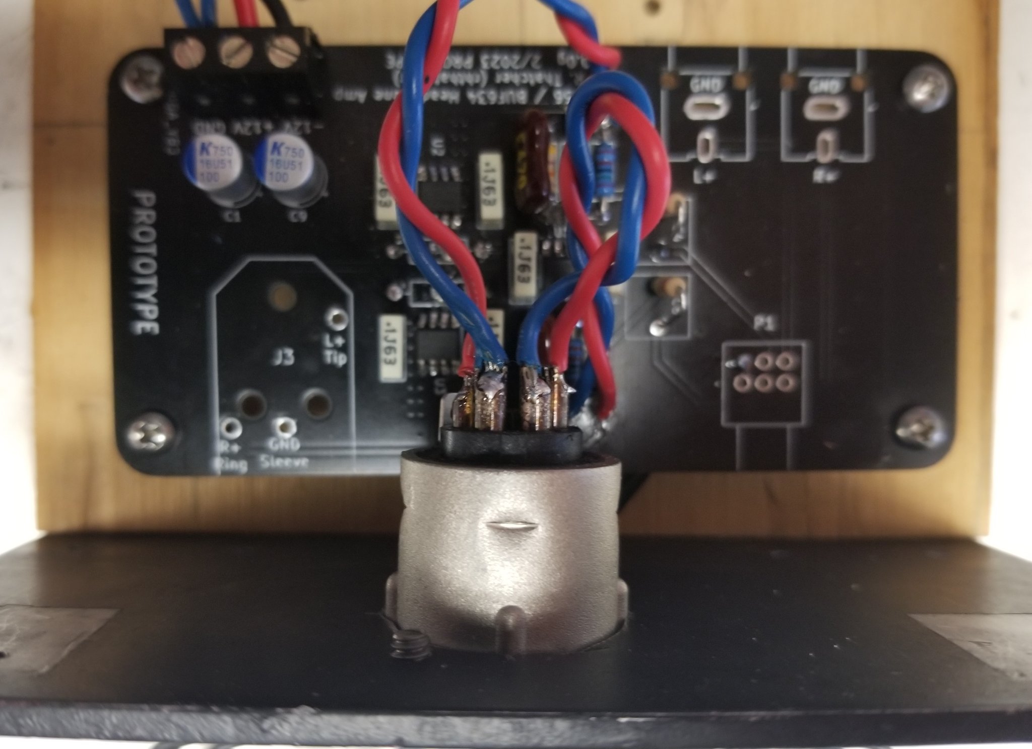

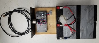

Greetings all,
to satisfy Randy's stipulation:
Modifications:
As you will be able to ascertain from the attache pictures, I have made several modifications. These are not necessary, they reflect my associated equipment, environment, and/or building practices.
1. I have made provision for adding resistors between the output of the OPA1656 and the input of the BUF634A. Although the specification sheet notes that such resistors are not necessary for stability when the BUF634A is operated in the wide-band mode, which I am using, eventually I may decide to limit the band-width and thus current drawn and perhaps have stability issues. And, it is always better to have an option than not.
The modification was not difficult, the soldering mask does not appear to be of high quality, so it was easy to use X-acto knife, scrape the mask and cut the traces. I am using surface mount resistors which come in 0 Ohms.
2. I have omitted the RCA connectors and the potentiometer. Regarding the RCA I have not yet decided on the final mechanical assembly (what you see in the picture is my test fixture); furthermore, I do not like RCA, so I will probably use different connectors. Regarding the potentiometer, my source is digital and so is volume and balance control.
3. I have further omitted the coupling capacitors (C4, C8) since mu source is already AC coupled. Instead I used the footprint for installing resistors, which with an added capacitor in parallel with R4, R6 comprise an RF filter at about 1.2 MHz. I often listen in an RF lab, therefore, I consider such a filter mandatory.
4. I have also omitted the output connector (J3) because my headphones are wired for balanced operation, hence the XLR connector.
Build:
The kit I received contained all the necessary components, which are through-hole with the exception of the OPA1656 and the BUF634A, but these were already soldered on the board. All the parts fit perfectly (even the ones I omitted, I tried, see the OCD below), there is no need to adjust anything for fit.
However, I have matched all the resistors in the left and the right channel as well as the capacitors for the filter on a bridge, even accounting for the divider due to the filter resistor. It is completely unnecessary, but OCD is OCD.
Sound:
I will not describe the sound. First, our vocabulary is not well suited for describing the sound, consequently, the terms used are undefined and such arbitrary. E.g., what is "fast bass", "thin highs", etc?
Suffice to say that I am satisfied with the sound, which is not a surprise since I used to have an amplifier based on this architecture, a PCB of which has been destroyed by modifications, when I was experimenting with it.
Lastly, I want to express my gratitude to Randy for providing such a kit.
