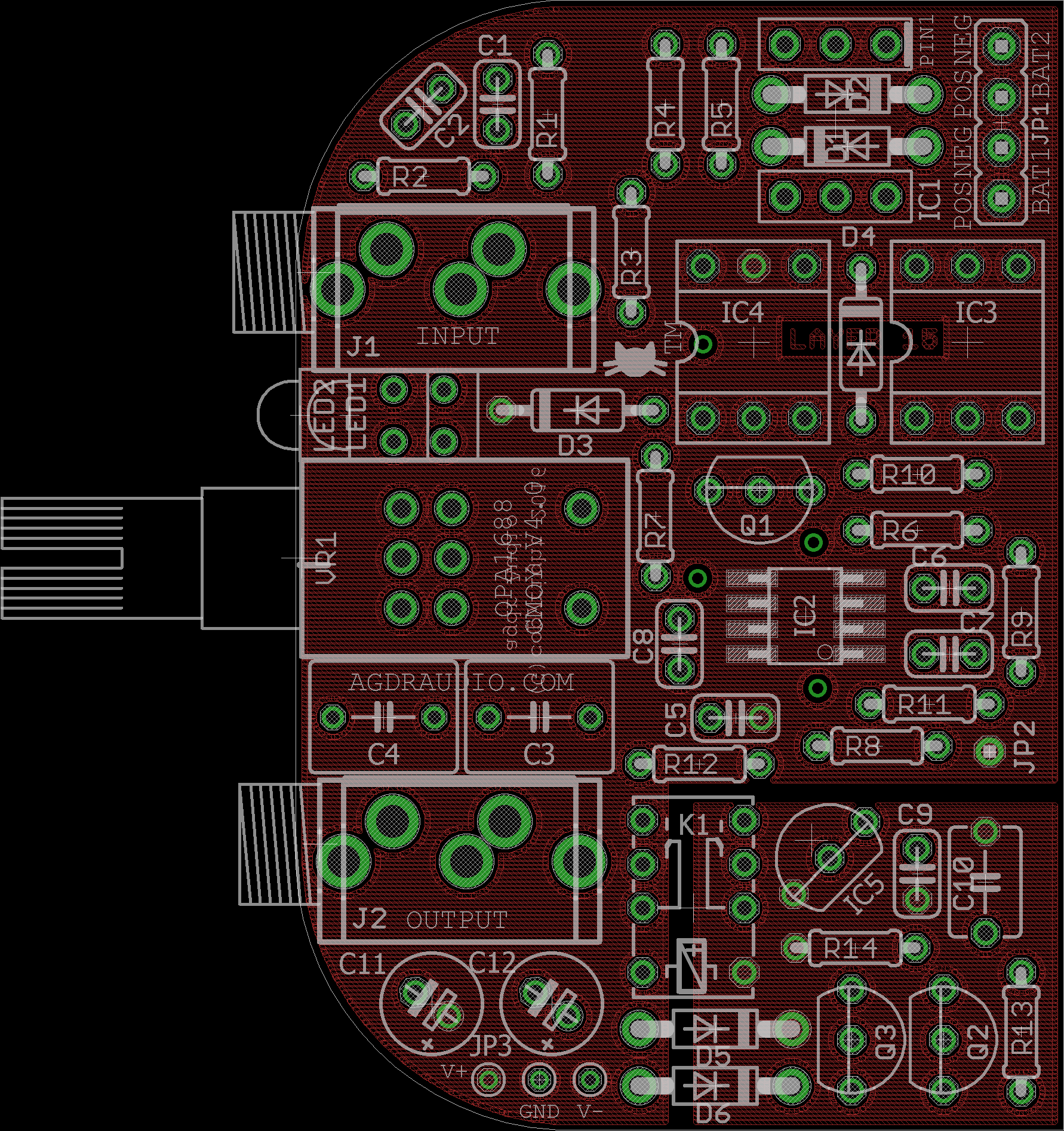

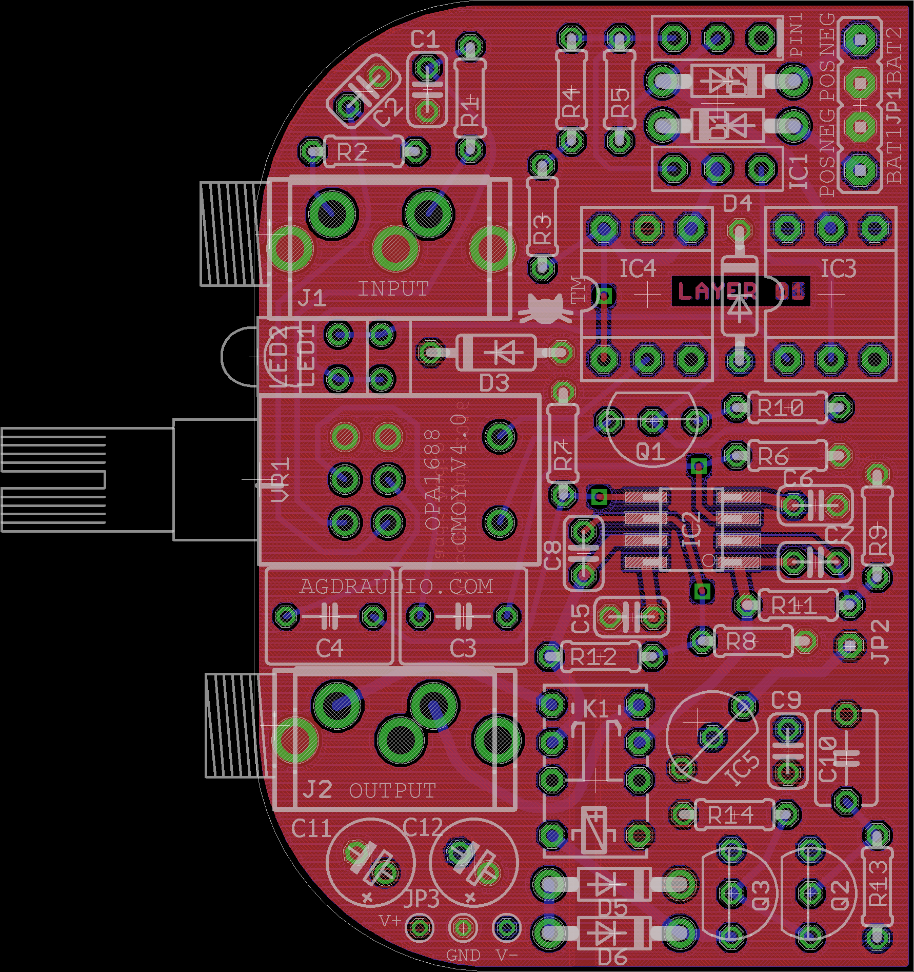

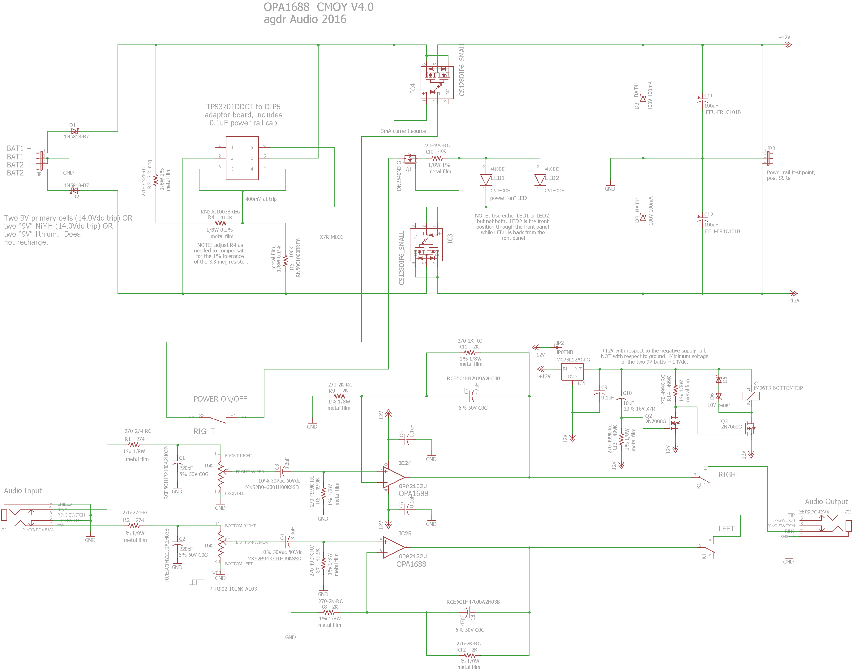

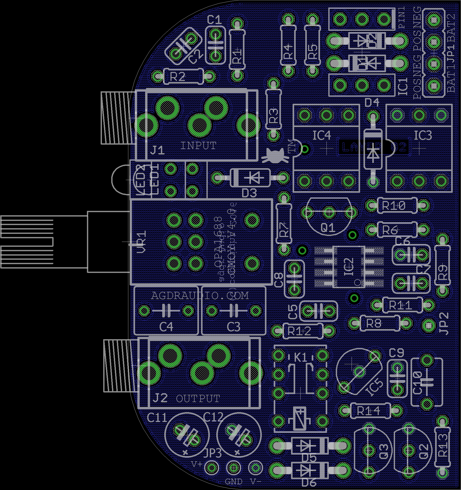

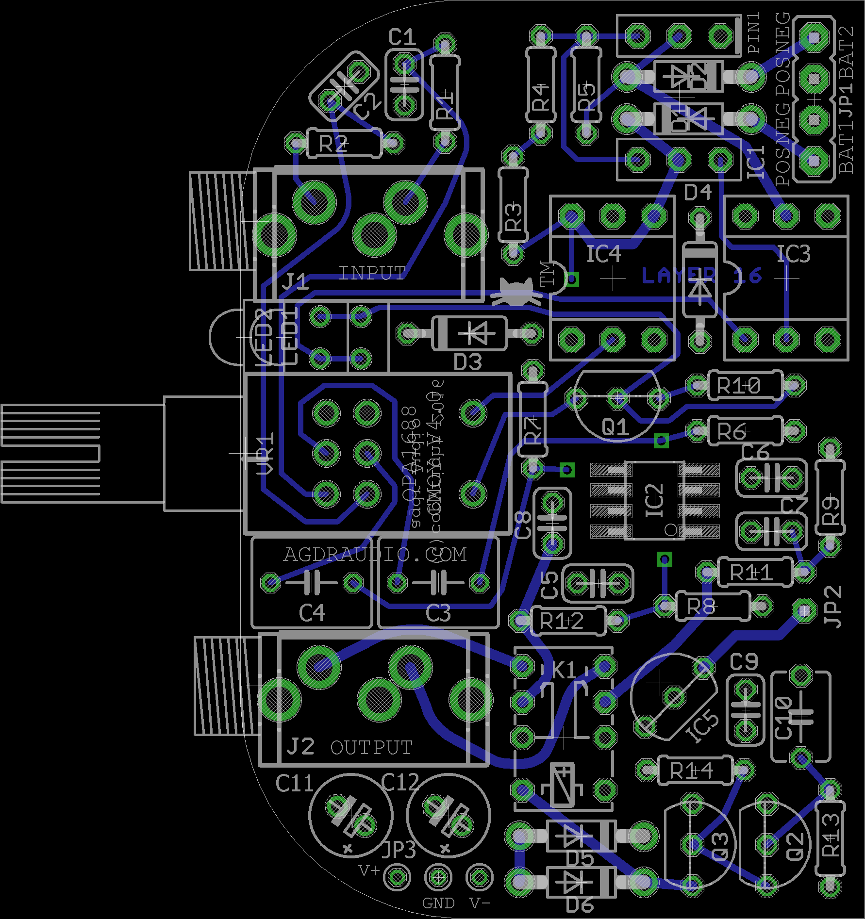

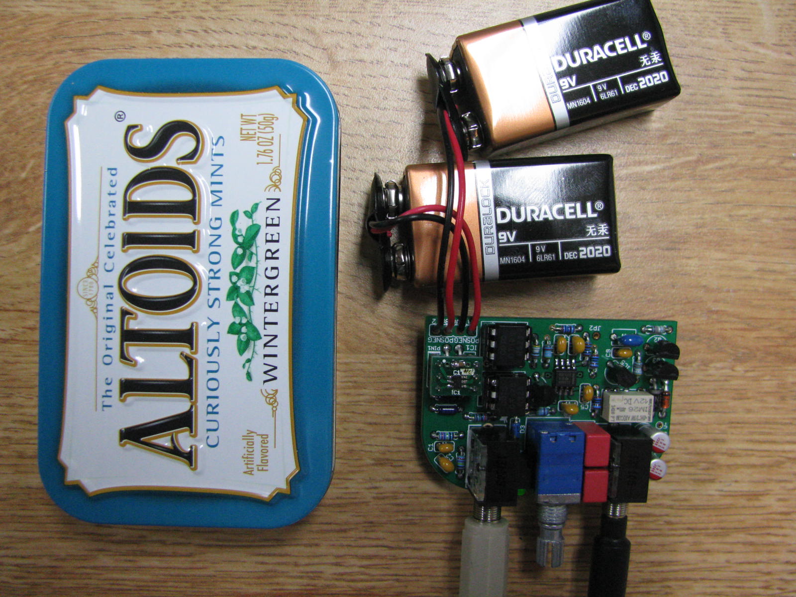

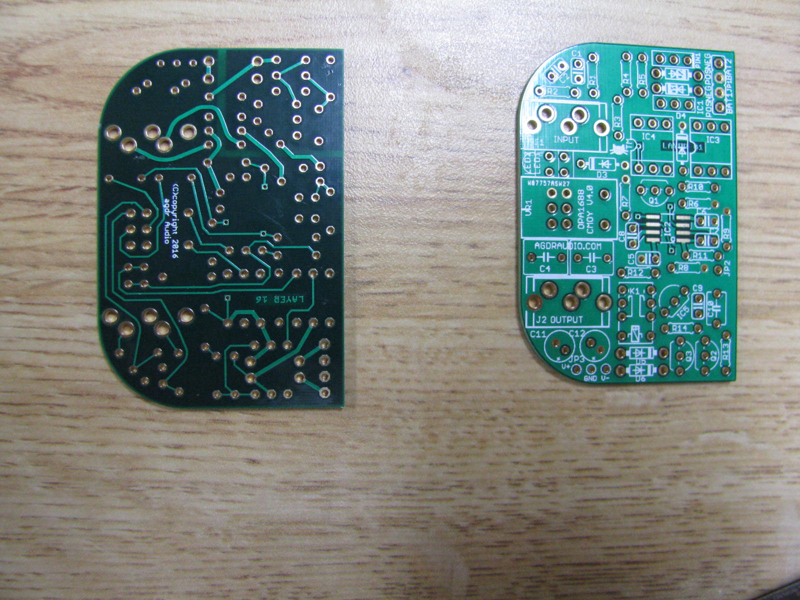

Ever wanted to build a CMOY using modern parts?
This project uses johnc124's (TI's) new OPA1688 dual channel headphone driver IC that can source/sink up to 75mA per channel at extremely low THD+N levels, while consuming just 1.6mA idle current per side. FET input and just 0.25mV (250uV!) DC output offset. I've just received the 4th version of the 4-layer board back from fabrication. I'll list those at-cost in the vendor forum in a few days if anyone is interesting in building one up.
The project is intended to be a "mini NwAvGuy O2 headamp" as much as it is a CMOY. To that end it uses two 9V batteries with a *real* ground. No virtual grounds here, no rail splitter chips. And just as with the O2 Headamp to make that work a power management circuit has to be used to cut off the batteries if one battery "disappears" or if both batteries simply get discharged. Surprisingly easy for that to happen with broken wires, intermittant battery snaps, a shorted cell or in the case of lithium "9V" rechargeable cells the on-cell protection circuit doing a low battery cutoff. If one battery suddenly disconnects a large amount of DC would appear at the amplifier output without a protection circuit like this.
I've updated NwAvGuy's O2 Headamp's Power Management circuit with some really cool new parts, the CT128 optical-mosfet solid state relay from Coto Technology (Mouser #816-CT128). The part has an "on" resistance of just 0.05 ohms! That is AC-wired. Here they are DC-wired which further reduces the resistance to a ridiculously-low 0.0125 ohms. Not a typo, 0.025 ohms per SSR mosfet. AC-wired they are in series, but DC-wired they are in parallel. By way of comparison the mosfets used in the NwAvGuy O2 Headamp have "on" resistances of around 0.5 ohms each, 40 times higher.
Even better, since these SSR's are opto-mosfet parts the internal LEDs are strung in series with a current source and the power switch (on the pot), guaranteeing that the positive and negative power rails go up/down at exactly the same time. In the O2 the mosfets were powered separately by comparators leading to time lags between on/off of the pair, resulting in one power rail up while the other was down for an instant (= a DC output transient in the O2 Headamp causing on/off thumps). In this amplifier the SSR LED string grounds by a single comparator, which in turn cuts off if the total battery voltage drops below 14Vdc (7V per battery), exactly like the O2's PM circuit.
And speaking of comparators... this CMOY uses the brand new TI TPS3701DDCT. Look it up, it is an amazing part. Internal 400mV reference, hysteresis, and just 8uA of idle current meaning it would take 30,000 hours to run down a lithium 9V cell. That is part in the photos on the small adaptor board near the battery wires. Originally I had the part on the back of the board, but given the size I found it best to put it on a DIP6 adaptor board. I have the adaptor boards and connection pins at cost, but I'm also having a run of professionally assembled adapter boards done too. With the DIP6 adaptor every part on this CMOY is through-hole for easy assembly, except the OPA1688 chip itself which is a SOIC-8 SMD.
This Super CMOY has other good stuff from the O2 Headamp, including the input RF filter and blocking capacitors to keep any source DC out of the headphones. Preserves that nice 0.25mV or less DC output offset. With the 3.3uF film caps specified the resulting low-end corner frequency is just 0.9Hz (the low end of the frequency response), below the audible range. The amp has battery polarity protection diodes and diode reverse rail clamps.
And of course it includes a headphone relay - same circuit I've used on the O2 Booster Board - to insure zero turn-on or turn-off thumps. Works great. In the first couple of fabricated version of this amp I didn't have the relay, just the OPA1688 output directly. The chip does produce some small on/off thumps by itself without the relay circuit. One of the revisions used two more of the opto-mos SSRs on an adaptor board for the muting relay, which worked perfectly, but in the end I didn't have the board space.

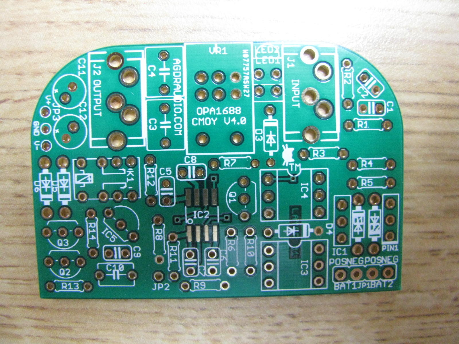

The board mounts upside-down in an Altoids tin, sitting on the 3.5mm jack cases and screwed onto the front of the mint tin with the 3.5mm jack nuts and the pot nut. Adydula here on the forum built up the previous V3.0 and did his usual fantastic job of centering and cutting the holes! I'm using a paper punch - goes right through the thin mint tin metal - then enlarging it from there.

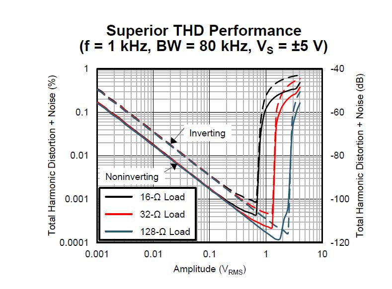

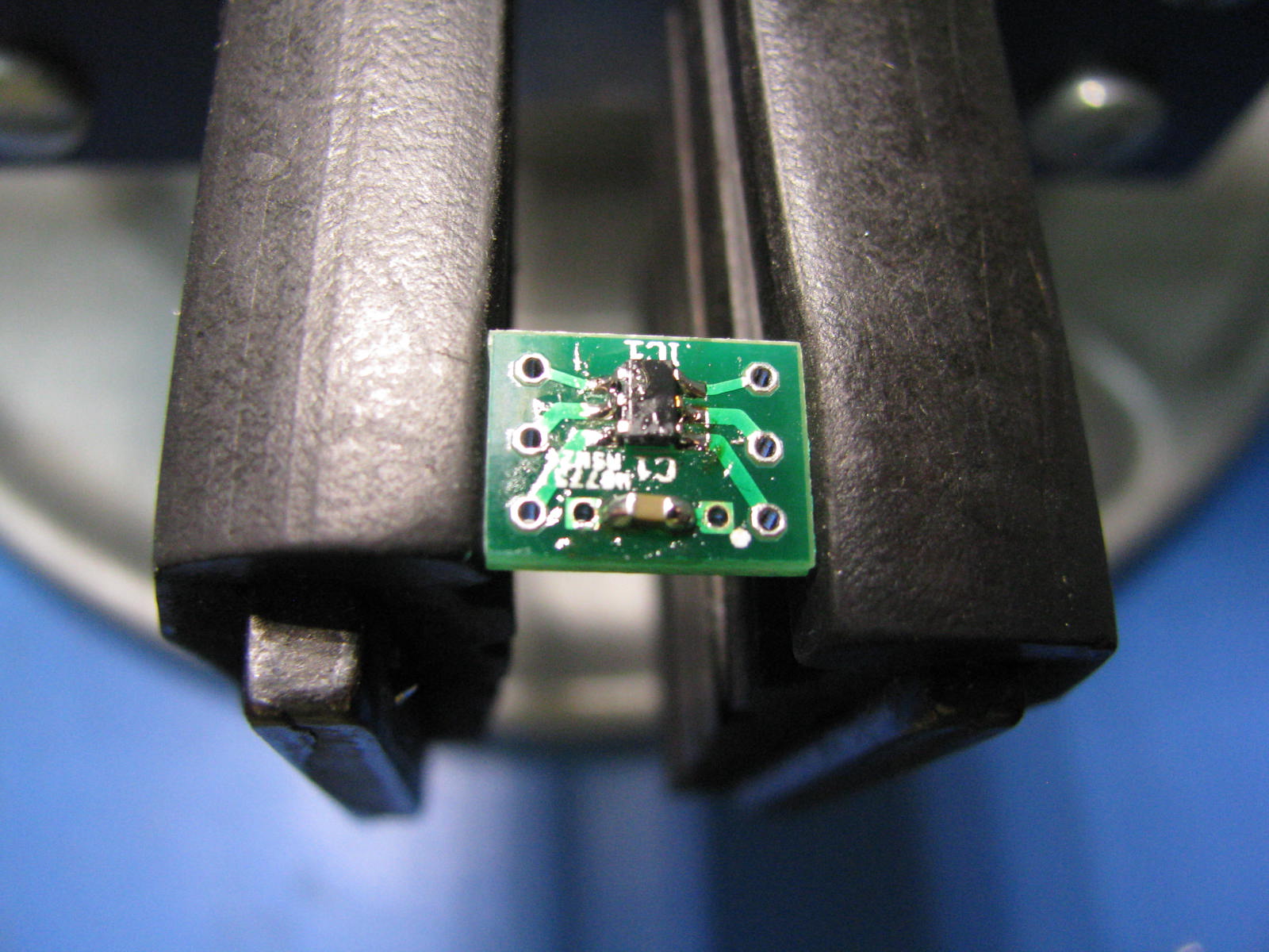

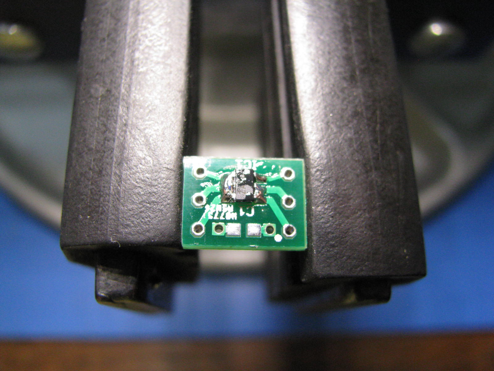

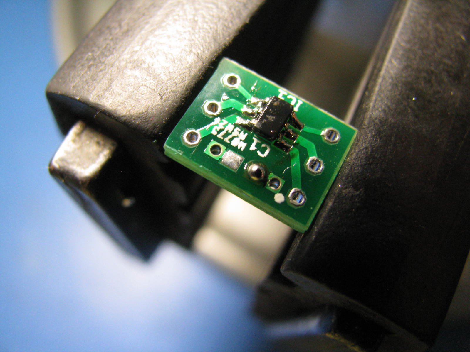

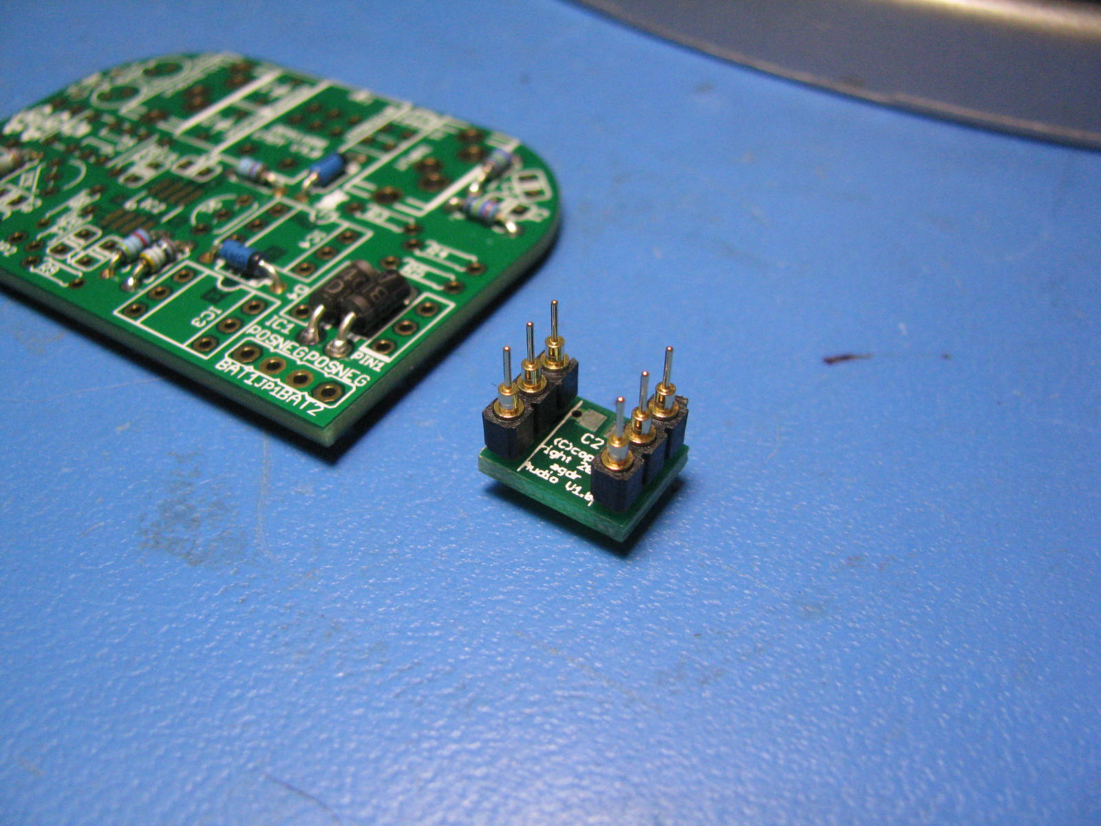

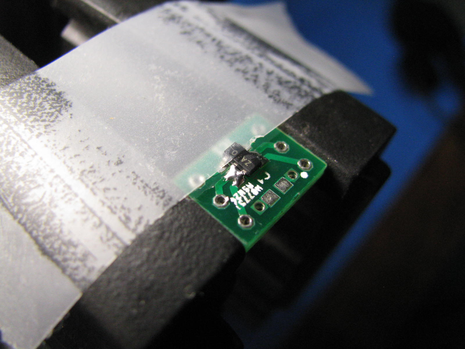

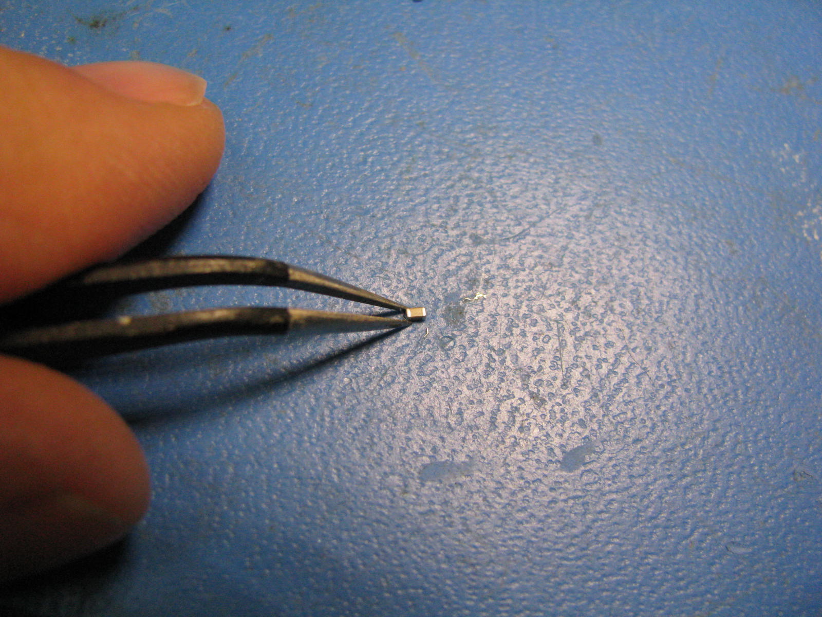

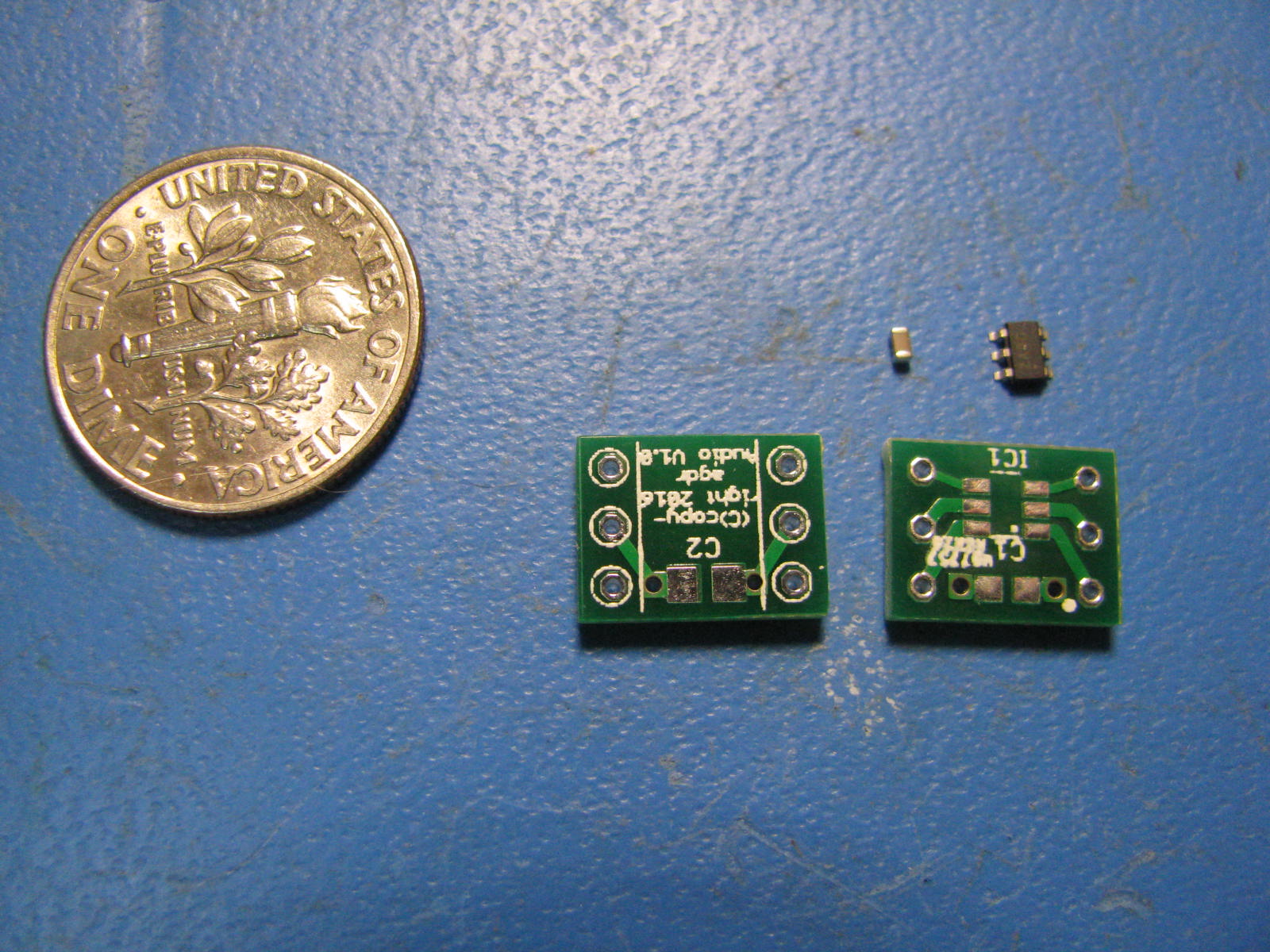

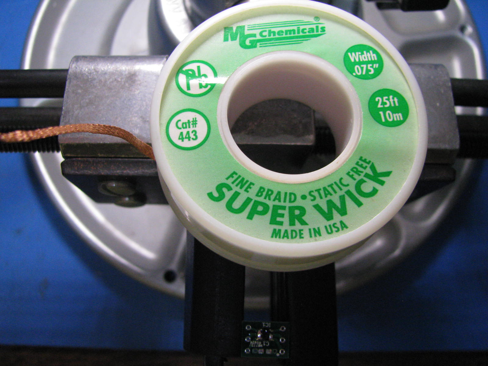

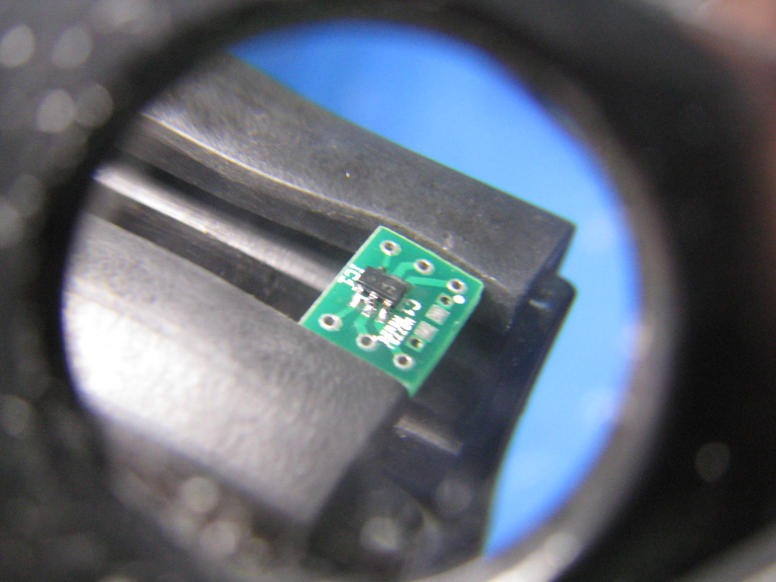

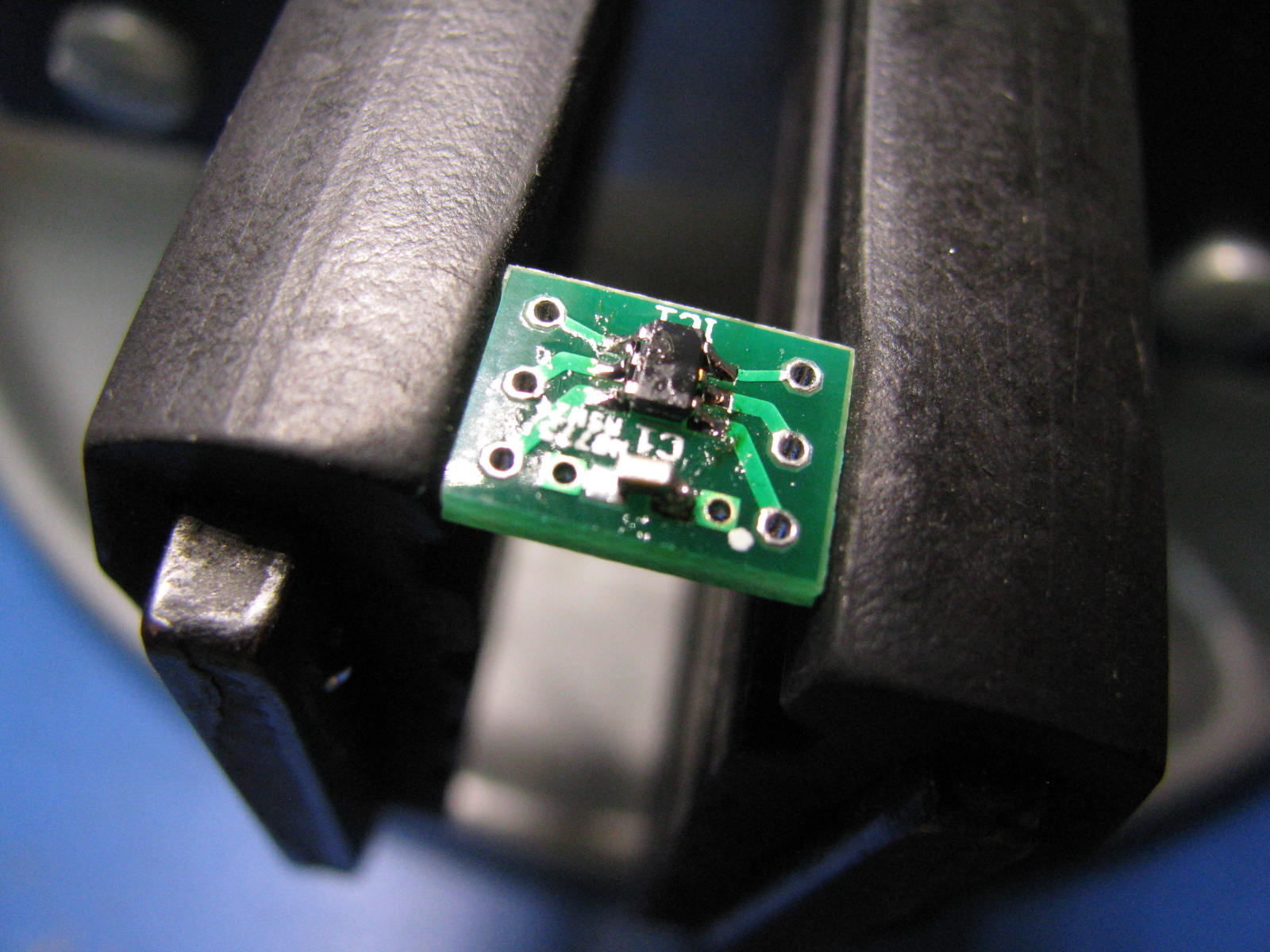

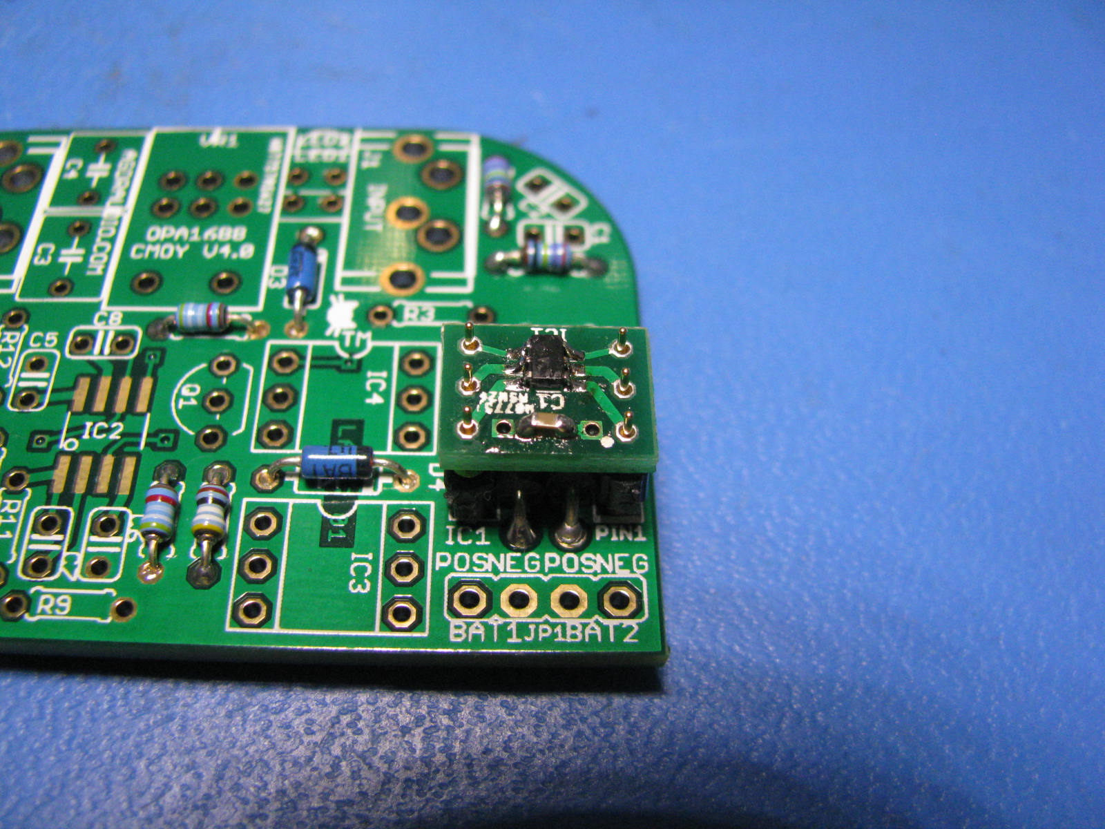

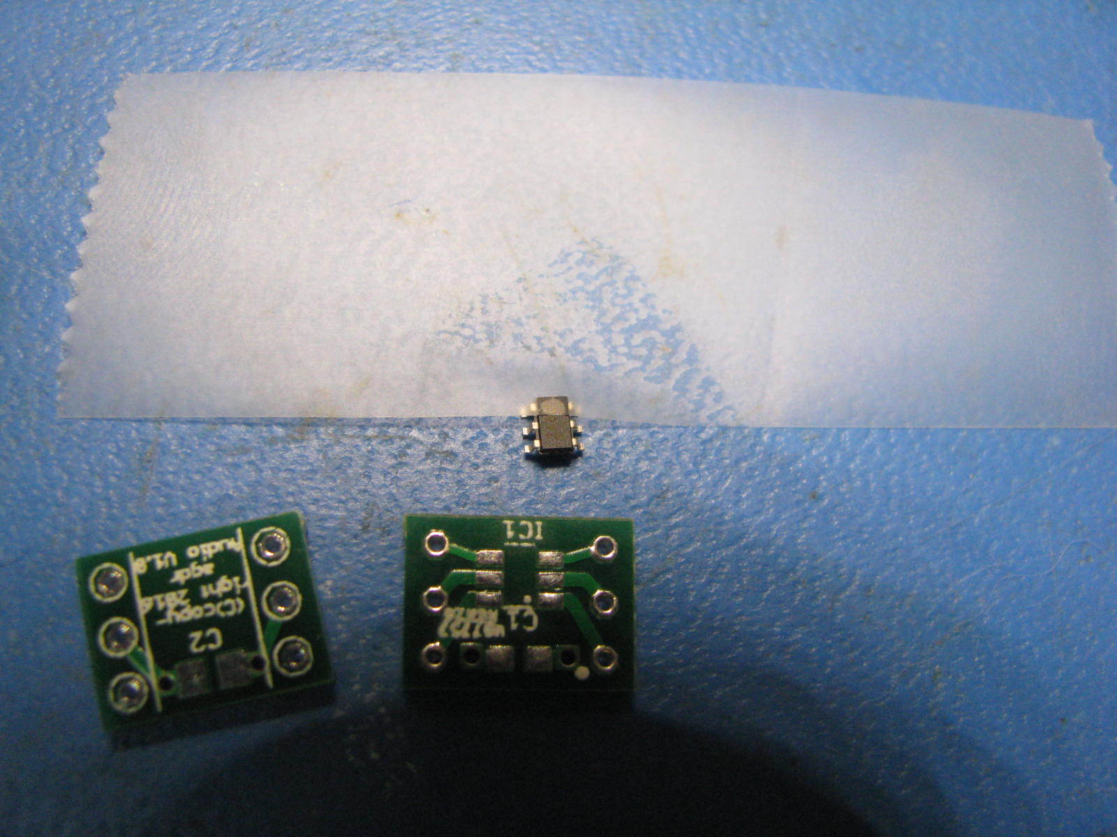

One of the alternate parts choices concerns that TPS3701DDCT comparator adaptor board. Again the story there is that chip is **tiny**, a SOT-23-6, but also unique. I've scoured the parts listings for any equivalent that is bigger but there just isn't anything. It is a brand new chip. So... the SOT-23-6 to DIP-6 adaptor board is there to make the thing bigger. Much easier to deal with a DIP-6 package than the tiny SMD SOT-23-6.
The adapter board is something I designed. I tried an off-the-shelf (Aries) adaptor board from Mouser, but it was very wide, wasting space, and used the typical square (non-pluggable) 0.1 center header pins. The one I've made here not only has the chip, but a 0603 sized 0.01uF 100V (the TPS3701 chip can handle 36V) X7R decoupling capacitor which the chip requires. On the back is an unused 0803 pad in parallel with the top 0603 in case someone wants to mess with adding a larger cap in parallel with the 0.1uF. I've created this board to be useful in general, for other stuff. Those pluggable pins can plug into a standard DIP-6 IC socket, although the CMOY board holes are sized for them directly to save board space.
So you have two choices. You can get the bare adaptor board from me, which comes with the two sets of 3 connection pins at-cost which is $2, and do your own soldering if you feel comfortable with SOT-23-6 parts and the 0603 sized cap. Or the other way is I'll have some pre-soldered and assembled adapter boards available at-cost for $8.50. Pins and parts are already on, just solder it into the 6 DIP holes on the CMOY board and away you go.
HINT: A huge thanks goes out to Adydula here for coming up with an absolutely inspired way to solder that tiny TPS chip, if you should want to do it yourself. Use scotch tape! Works great. I tried picking it up by the sides with tweezers at first, like I do with all SOIC chips, and the tiny chip would just fly off the tweezers 9 times out of 10. I'll bet I have a couple of dozen of those chips in the rug and on the cat by now. But with the tape all is solved. Stick a strip of tape over the top two or so pins, then stick it down over the adapter board, which should be on an anti-static mat for this. Re-stick the tape as needed to line up the 6 leads with the pads, then solder the four free leads. Remove the tape and solder the remaining two leads. Then solder up the 0603 the usual way, but putting solder on one pad, stick in one end of the part, then solder the other end. Then solder up the two rows of connection pins. Best to insert both rows in both the adaptor board and into the CMOY on the other end to get it all lined up.

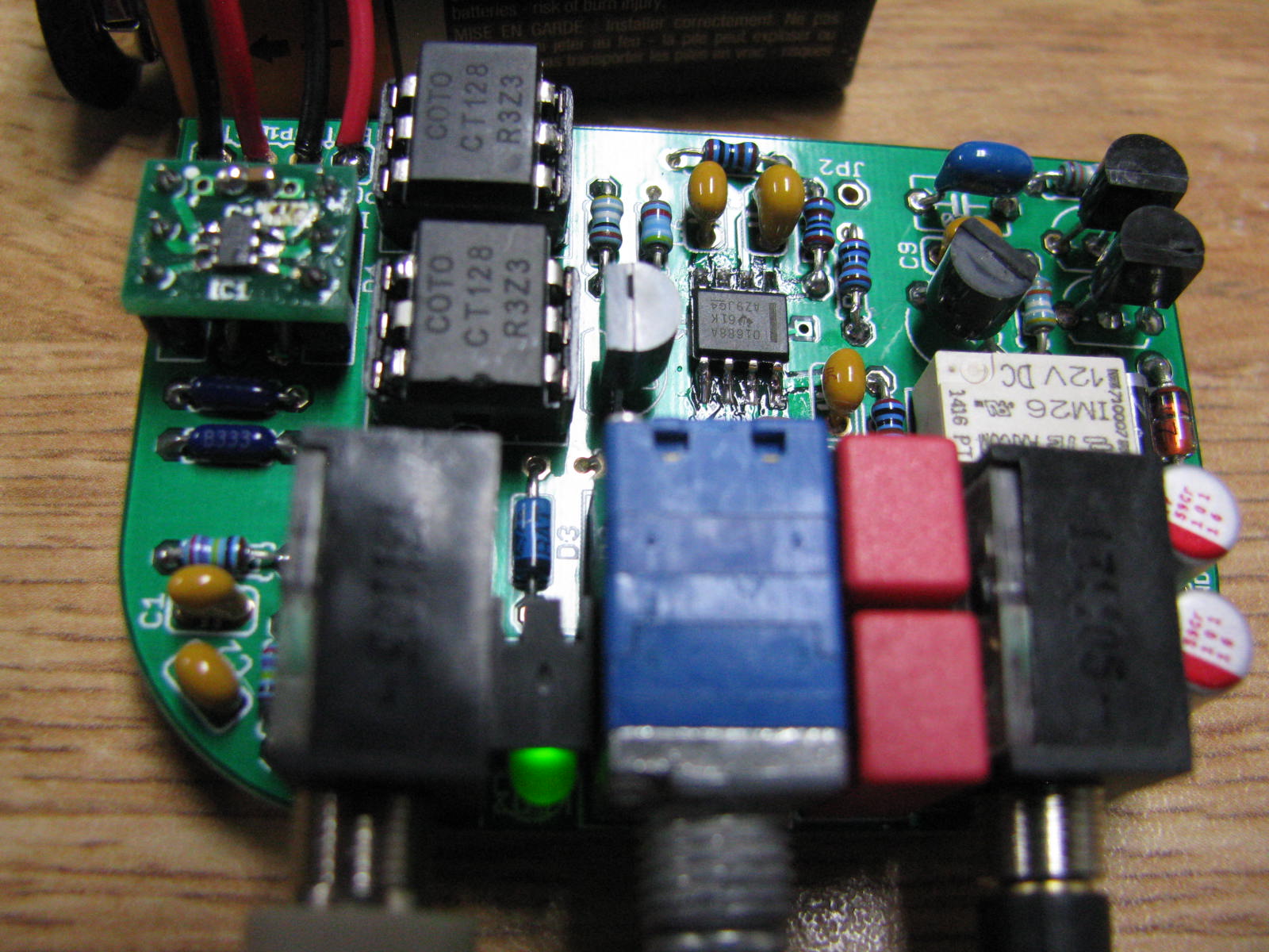

Another choice on the BOM is the Solid State Relays. I highly recommend the COTO CT128 parts - fantasticlly low on resistance - but I have also listed an alternate less expensive SSR part that has a slightly higher Ron of 0.0625 ohms when DC wired.

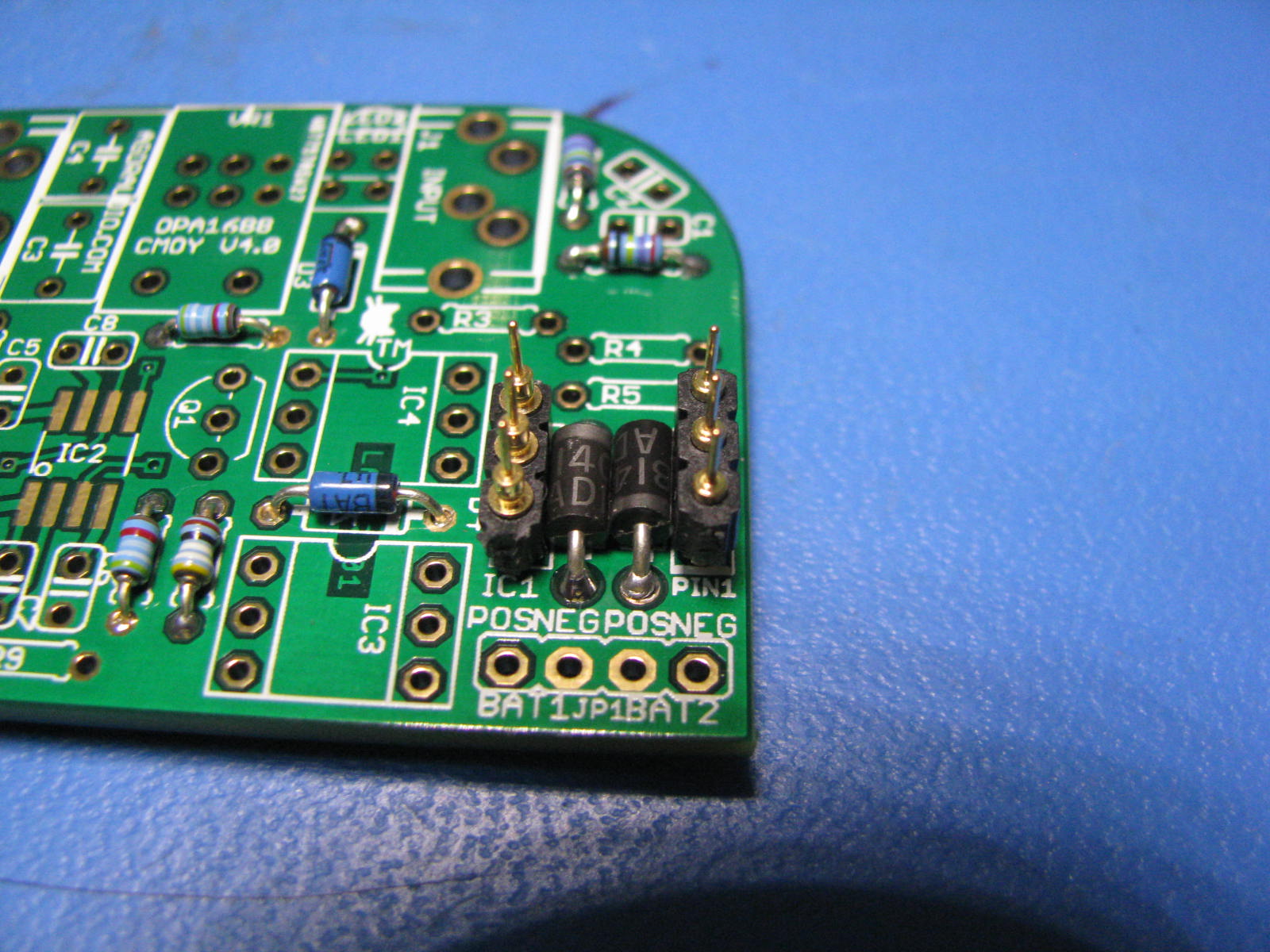

I'm still working on build instructions, but in general solder all the low-height parts first, like resistors, diodes, and the OPA1688 chip. Then solder the medium height parts like ICs (DIP and TO-92), transistors, LEDs, etc. Finally solder the tall parts like the pot and 3.5mm jacks. Make sure you solder the two 1N5818 diodes that go under the TPS3701 adapter board first, before you solder the TPS3701 adapter board on. Also note the LED just fits between the pot and the input jack. Solder the pot first, then the LED, then the input jack. The "power on" LED has two optional positions. Forward it will stick through the panel, in back it won't but you can make a small panel hole to let the light come through.
And, as always, I **highly** recommend doing all your soldering on a grounded anti-static mat, with grounded wrist strap, and ideally a grounded soldering iron tip. There are anti-stat mat and wrist strap kits for cheap out on eBay.

Nice find on the Coto relays. I've been looking at very similar units from Toshiba or Omron, but those cost way more. That power management circuit also looks impressive. I was looking at fiddling with li-ion packs from RC supply places as a power source, and needed something to prevent undervoltage and imbalance. My attempt would need 4 comparators and a bunch of other bits though, and I'm not even sure it would work! I've been dragging my feet over that because of the cost, but I might have a play with the Coto ones.
On that note, the TPS3701 is another nice find. I've been looking at comparators, but TI has that filed under power management. How did you manage to come across it?
And thanks for pointing out those Tenergy 9V cells. A complete package is actually cheaper than the Maha NiMH!

I was looking at the datasheet today yet again and the graph below on the first page just stuck out as a thing of beauty, after a few years now of designing headphone amps! Just look at those *real world* headphone resistances: 16R, 32R & 128R. The typical historical op-amps used in CMOYs have maximum datasheet loads of 2K or more for whatever THD+N numbers are listed, and usually maximum load capacitance of 100pF. They are designed for line-level gain stages, not driving headphones. The OPA1688 is the real thing for driving real-world headphone loads, including the 500pF cable/headphone capacitance. Keep in mind the graph is done with +/-5Vdc power rails too! In this CMOY we have 6.26Vdc - 11Vdc depending on battery type and battery charge levels.

* photo 4181 shows the relative sizes of the parts vs. a US dime. Top and bottom of the adapter board, the TPS3701DDCT chip, and the 0.1uF 100V X7R 0603 MLCC chip (Mouser #81-GCM188R72A104KA4D). The blue background is a grounded anti-static mat.
Note the two pin 1 dots on the top (rightmost board in the photo) of the adapter board! There is a small one for the chip near the lower right pad in this photo, then a larger one for the pin 1 connection pin in the lower right corner of the board.
Remember that C2 on the bottom isn't used, at least for the OPA1688 CMOY project here. Those 0805 pads are in parallel with the 0603 capacitor on the top of the board, just for generality if someone wanted to add a larger decoupling cap in parallel.
* 4184 & 4185 show Adydula's tape trick in action. A piece of tape is placed over the top couple of pins, leaving the bottom 2 - 4 pins exposed. Then the chip is picked up with the tape and the tape used to center the chip over the adapter board pads. It only took me 1 additional repositioning this time to get a perfect pin to pad alignment. The first time I did this it took me about 8 un-sticks and re-sticks of the tape on the vise to get the hang of it. As with all surface mount parts havng the chip pins *perfectly* align with the pads is a key trick to making the soldering go well. Don't hesitate to re-position the chip as many times as you need to get those leads centered on the pads. I'm not using any additonal flux on the SMD pads here, as I've seen various videos do on the internet. I've never found the need for it. The flux in the solder I'm using has always been sufficient.
* 4188 shows the results of the soldering effort outside of the taped area. Yep, both sides solder bridged. Don't worry about it a bit. You will get that nearly every time due to the close spacing of the chip leads. We will easily take care of it with some solder wick later on.
* 4190 shows the results with the tape removed and the remaining 2 leads under the tape soldered. Lol, now all 3 leads on the left are bridged. Lets take care of that...

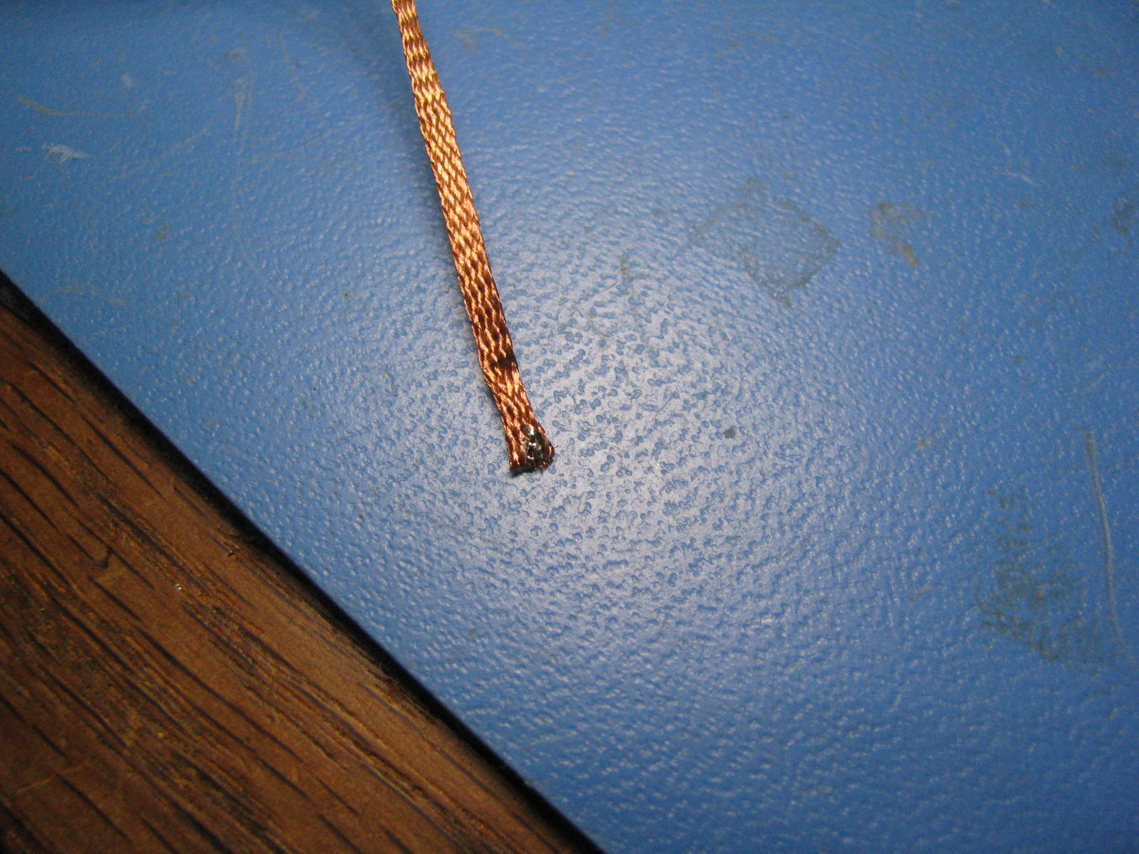

*... 4191, 4192, 4193, and 4194 show the solder wick I'm using and the results from putting the end over all 3 bridged leads and briefly heating with the soldering iron. As 4192 shows it really isn't a lot that has to come off. Then repeat with the other side and 4194 shows the now perfectly soldered-up chip.
* photo 4194 above shows something else too. I've put a blob of solder on one of the 0603 capacitor pads. 4195 shows the cap being picked up by the tweezers and 4196 is the result of heating that blob and sticking in one end of the capacitor. After I took this photo I used my finger nail (also using a grounded wrist strap here) to push down on the cap while re-heating the end to get it to lie flat on the board.

* 4198 shows the other end of the cap soldered, allowed to cool a bit, then back to the first end to touch it up.
* 4207 shows the connection pin strips for the adapter board placed in their holes on the CMOY board to get things lined up. They are not soldered in yet here. One end of these pins has the plastic bar closer than the other end, and the other end has the short extension piece. In this photo I've place the two strips in both ways to show the difference.
The leftmost strip in this photo is in the "wrong" way, with the plastic bar down toward the CMOY board and the extension pin area sticking up. The rightmost strip is in the "correct" way, with the extension pins down toward the CMOY board. Notice that the adaptor board just fits over the two SB140 schottky diodes used for battery polarity protection. One item in the build instructions is the importance of getting those diodes centered as much as possible over their PC outline. Solder one end of a diode first, check for alignment, then re-heat that one and and move the diode as needed before soldering the other end. The diodes should touch each other as shown to leave maximum space for the adaptor board pins.
BTW the pluggable connection pins are Mill-Max 342-10-164-00-591000 (Mouser #575-6415691 for a strip of 64 that can be cut as needed. I supply them with the adapter board though.
* 4208 now has the adapter board set down over the connection pins. Neither end of either connection pin strip is soldered yet. An important thing to note in this photo is the "pin 1" lettering on the CMOY board near the bottom right connection pin hole for IC1 (IC1 on the CMOY board is the TPS3701 adapter board). That lines up with the pin 1 dot on the adaptor board. An even easier way to check orientation is just make sure the 0603 capacitor on the top of the adapter board is toward the battery wire holes on the CMOY board.
* 4209 shows the adaptor board end of the pins soldered now.
* 4218 and 4219 show the completed adaptor board lifted off the CMOY board. The side shot 4219 shows the extension pin end of the connection pins vs. the other end a bit more clearly. I would recommend getting the entire rest of the CMOY board soldered up first before soldering in the adapator board, just to lessen any chance of damage.
