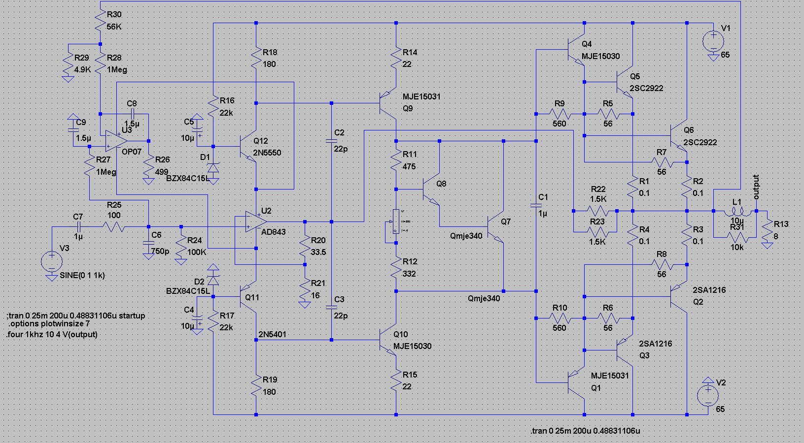

Opamp suggestion for DC-servo in an Alexander amp

opa-277? very low offset, Iq < 1 mA , Ib quite small.
elfa. 73-387-59

Servo amp: Low quiescent current is important as you
want the main op-amp to modulate as much of the current
in the current mirrors as possible. That's why the OP97 was
chosen.
Main op-amp: The SSM2131 was SSM's "improved" version
of the NE5534, designed for high end pro audio equipment.
If I were to build one of these, I'd consider an OPA627 or
AD8610, etc.

I have also build this amplifier a year ago with six pairs of IRFP240
and IRFP9240.
The driver transistors are ultra fast BF758 and BF762 they have bean used in tv as uhf amplifiers, i think they are discontinued.
I have used OPA604AP from Buur Brown as gain stage instead
of SSM2131.
I did not use DC servo beacose offset was always beatwin +/-
30 to 50mV.You have to place trim pot beatwin pins 1,5 for offset triming.
i dont know why peaple say that amp oscilates, its very stable
i also didnt use zobel network its not nesesery this is high bandwith amp,and you dont want to put low pas filter in the output.
you also must take care of grounding of the driver board,i did
had a problem with input left open it is very sensitive beacose
input capacitor(750pF) is a filter which make this amp goes to
1MHz.
The amp is unbelivably fast(transient reasponse) if you put some
CD with acustic gitar or piano or some pasage with some good solo drums it realy scare you.
The amp reali have total control of the speakers, if you never heard amp with high bandwith and high slew rate(250V/us)then you peaple dont know what you are mising.

Ik heb deze gebouwd met ring emitters en een super emittervolger, opa604 en opa07 servo, heb de rc tijd vergoot ivm aantasting bas. Ik gebruikte geen current mirror icm bjt ipv mosfets.
Ik heb nog steeds geen betere gehoort ook geenb buizen, impuls muziek als gitaar, er is geen betere.
I have build these with ring emitters and a super emittor follower opa 604 and opa 07 servo, have increase the rc time becausem it did affect the bas. I did not use the current mirrors because of the bjt and there current driving, not voltages.
I do not now is this also protected by patent because it is quite changed for a part.
