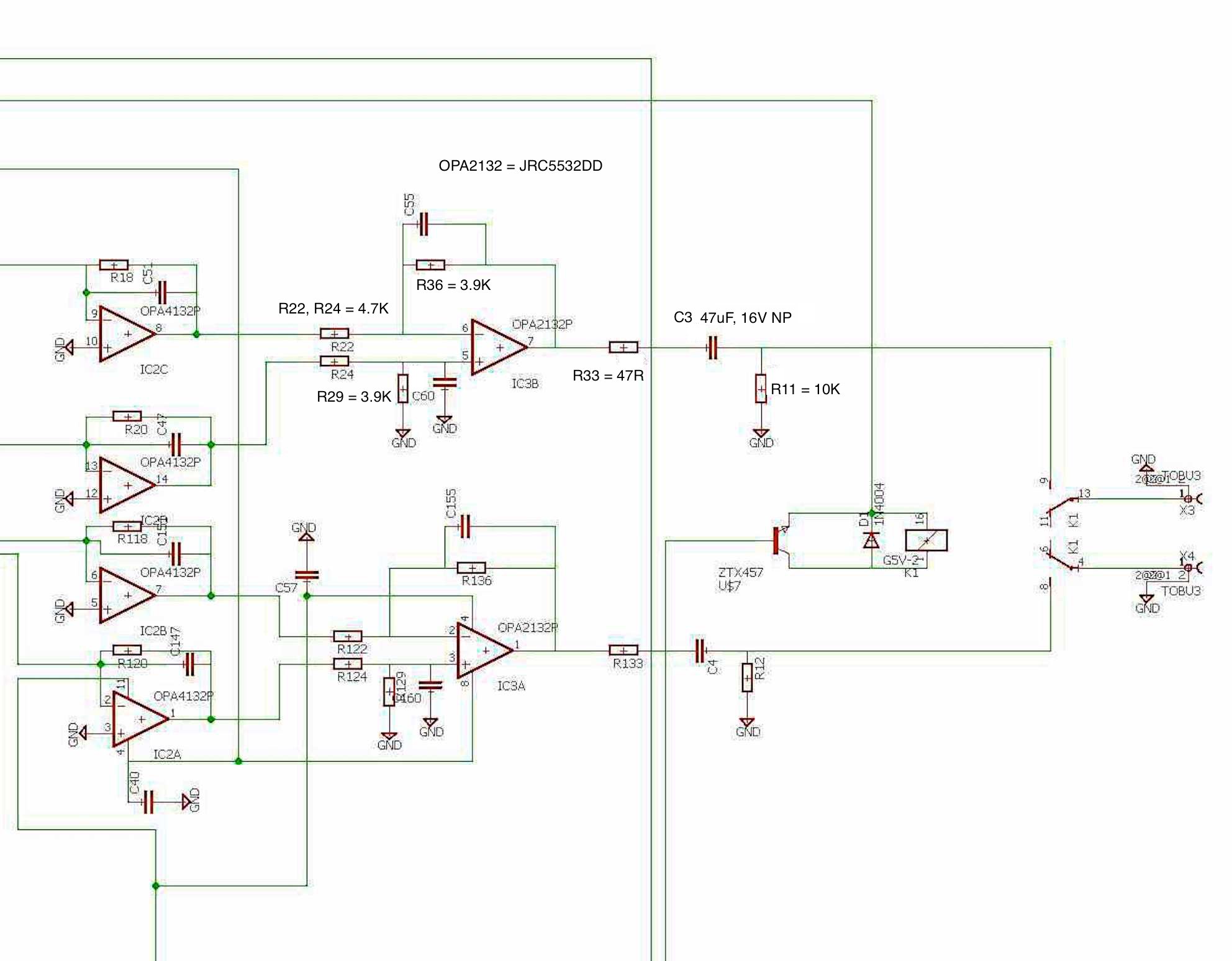

Andy, what is the configuration of the op-amp output stage you’re referring to?
Is it inverting or non-inverting?
Does it feature gain, and if so, how much?
Is it driven by an active reconstruction filter, or a passive?
I see three opamps per channel (one quad and one dual for two channels). Did you replace all of them at the same time?
I only took out the NE5532 and fitted a DIP socket in its place. Didn't touch the rest except for removing the 47uF output cap.

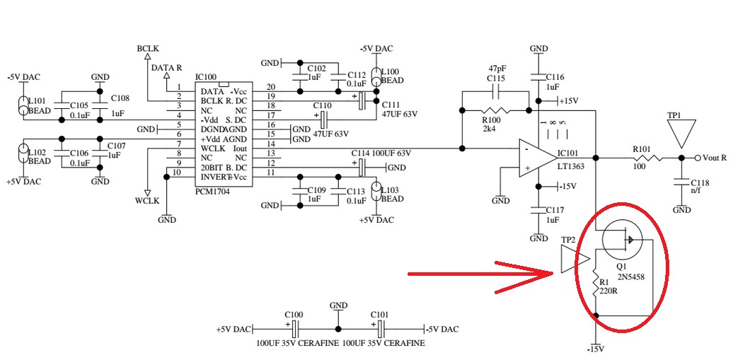

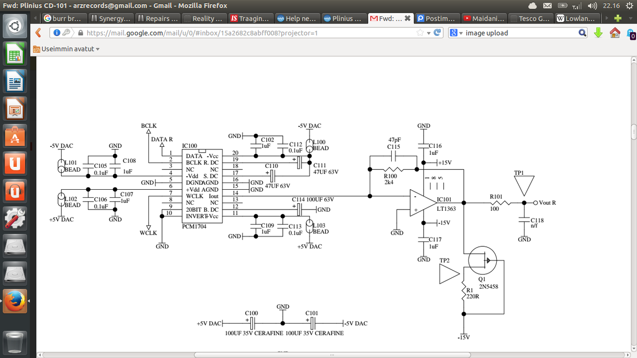

Just for fun, here’s the portion of the schematic from the Plinius CD-101 CD-player, showing an LT-1363 op-amp being utilized as an active I/V (transimpedance) amplifier. Which is in the same device family as the LT-1361, and the LT-1364 which you have listed. The CD-101 was well regarded by reviewers back in the late 2000s.
Is this constant current source put there in order to force the op-amp to work more in class A?
