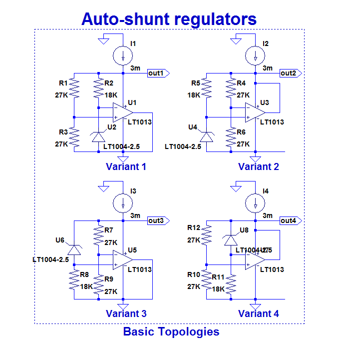

The principle is to tie the output to one of the supply rails, and operate the output stage in single-ended, Class A mode.
This can be done in a number of ways, as this sheet demonstrates:
attachment.php
The input circuitry is basically a bridge, having one (or more) non-linear element.
The examples use a voltage reference, but any element having a concave V/I characteristic like a junction could also be used.
If the non-linear element has a convex characteristic, one of the resistors has to be swapped for the non-linear element, but the mode of operation remains the same.
These circuits are incestuous to a high degree: not only does the opamp regulate its own supply, but this supply also biases the reference.
This could cause self-starting issues, but it also means that the whole circuit operates in a complete stasis, yielding an extreme degree of accuracy and performance.

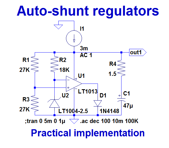

Of course, these simplified examples are too brutal to work in reality: one of the problem is the direct connection of the output to a supply rail: for example, even when its output is supposed to be in a saturated low state, an opamp does not like having it directly and externally shorted to the - rail: it might misbehave, consume lots of current, etc.
Then, there is the issue of bypassing: a supply should be bypassed, but connecting a decoupling cap between the rails will result in capacitive loading, something opamps do not like.
Therefore, a practical circuit needs some adaptations:
attachment.php

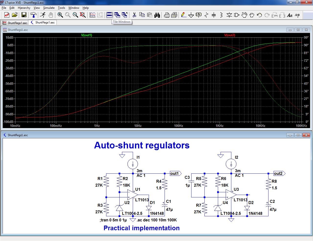

A diode is added in the output to allow it some breathing space, and a low-impedance RC network is used as a bypass.
I will discuss these choices later.

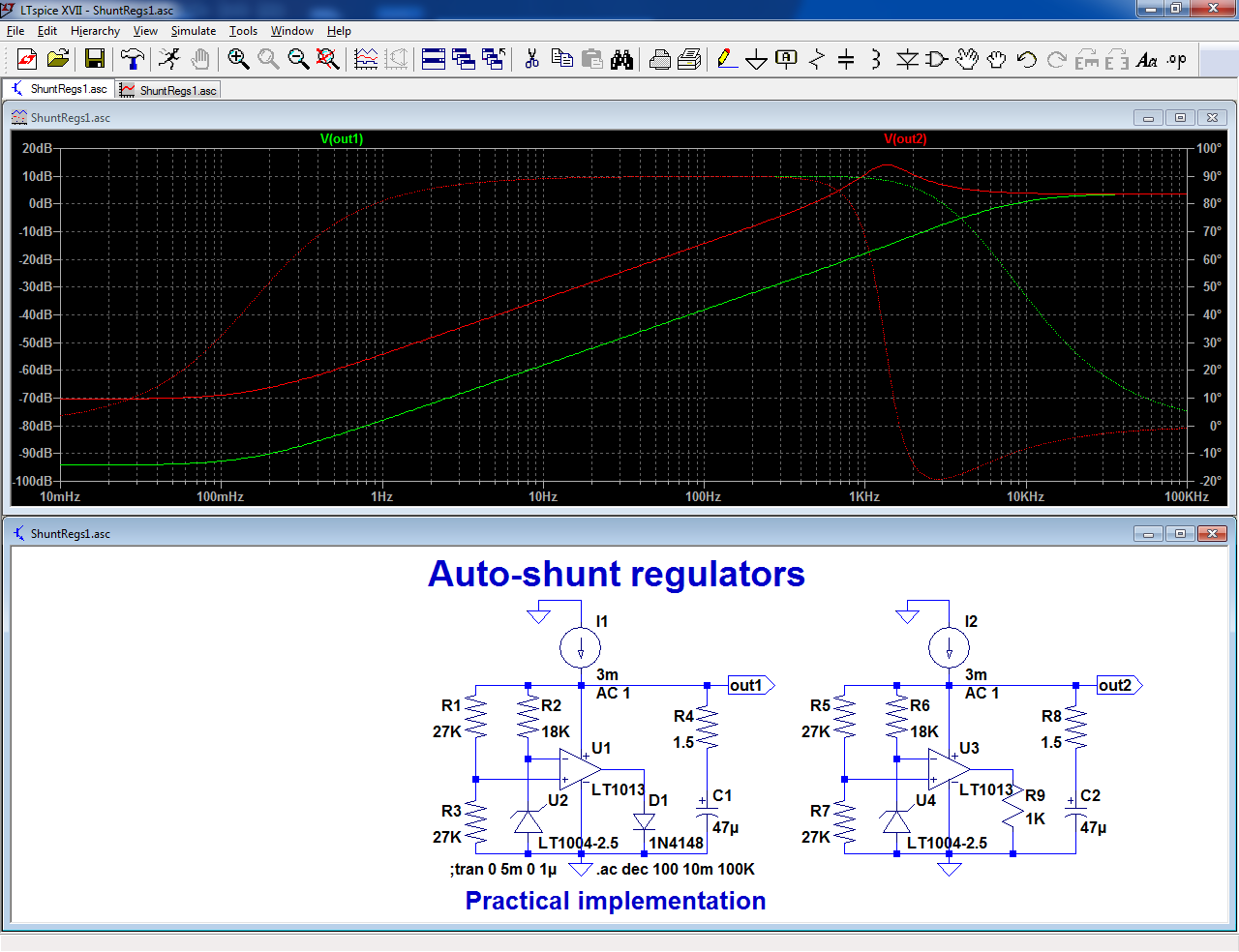

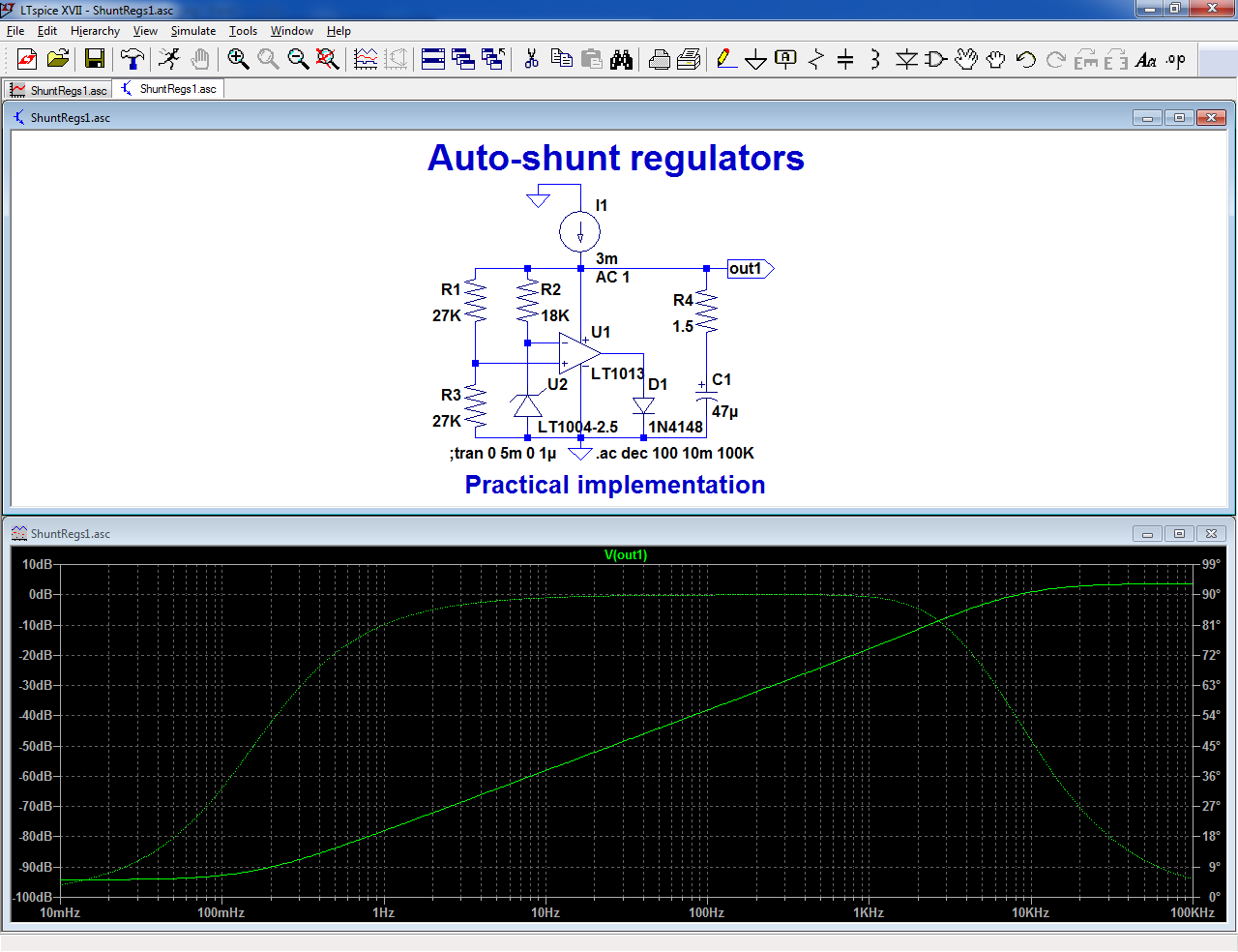

This picture shows the performance of the example circuit (impedance):
attachment.php
The -94dB at LF/DC is equivalent to a ~20µΩ impedance, which is unusual for such a simple circuit biased at only 3mA.
The rest of the curve follows the GBW characteristic of the opamp, up to the resonance frequency at ~10kHz, determined by the opamp and the 47µF bypass cap.
Beyond 10kHz, the impedance assumes the value of the 1.5Ω damping resistor

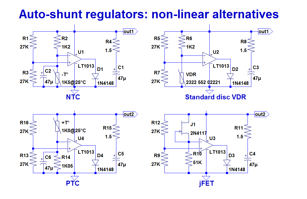

I mentioned in the introductory post that any non-linear element (or combination thereof) can be used.
Here is a selection of concave and convex non-linear elements, beyond the too obvious forward-biased diode, LED, shunt ref, zener, etc:
attachment.php

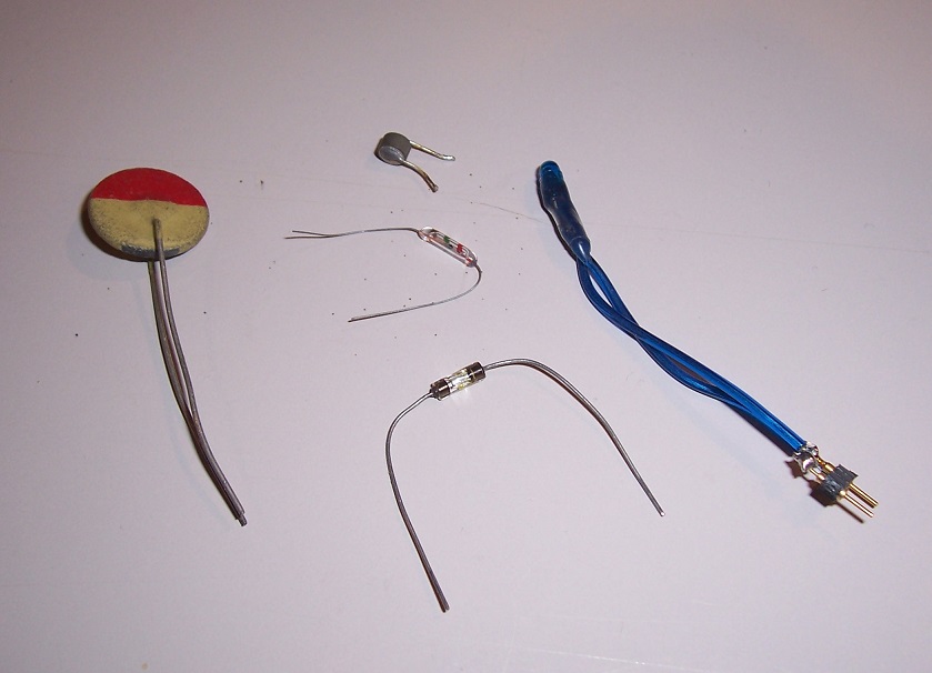

It is perfectly possible to use NTC's, PTC's, old-style VDR's, etc.
All of these examples are dimensioned for a 5V output
Note that a tungsten light bulb makes an excellent PTC.
Here is a selection of examples including such components, including a tiny 2.5V 20mA light bulb:
attachment.php
When the non-linear element has a significant time-constant compared to the opamp, it is necessary to include some kind of frequency compensation: that is the role of the 47µF in the schematics, used with thermal elements.
Here is the circuit with a glass NTC:
attachment.php
The VDR circuit has been shown above:
attachment.php

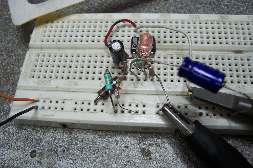

Many options are usable to allow the output to work properly, and they include resistors, LEDs, zener, etc.

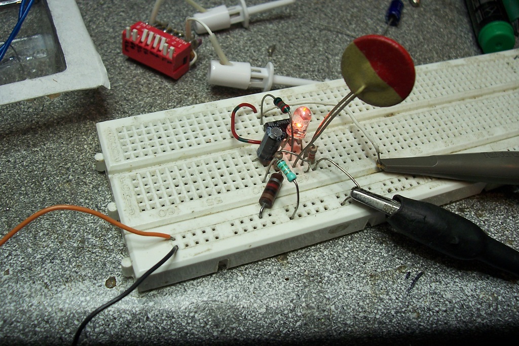

In my breadboard prototype I have used a LED, because it also allows a visual health-check of the good operation: it visualizes the shunt current.

To illustrate this point, here is a comparison between the diode and resistor versions:
attachment.php
The performances are down by more than 20dB.

However, if one of the rails doesn't work, the other will generally be OK: there are 4 variants to chose from.

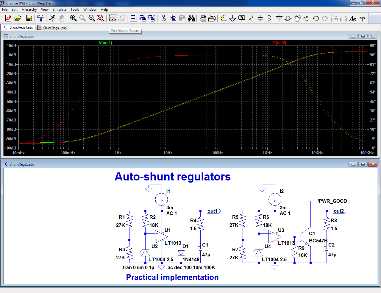

If the output junction is the B-E of a transistor, its collector will deliver a convenient /PWR_GOOD signal when the circuit begins to regulate:
attachment.php

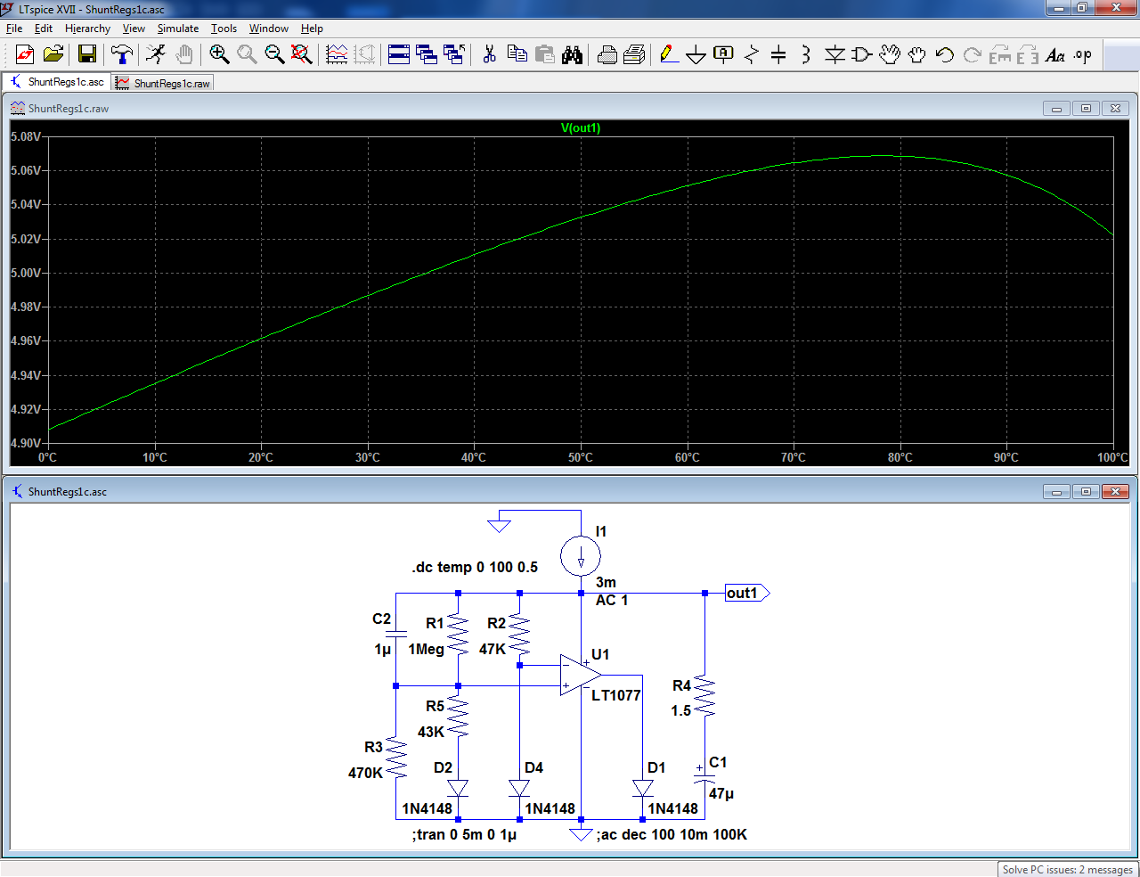

Here is another example: it is a bandgap regulator/reference on a shoestring, using only two ordinary diodes and operating at a micropower level, drawing around 140µA:
attachment.php
It is only made possible thanks to the bridge configuration, reaching the exact equilibrium for a 5V output and a zero tempco.
Of course, with gold-doped diodes, you are not going to extrapolate this circuit into nA levels, but with more ideal diodes like 1N646 or transistor junctions, it could be possible.
