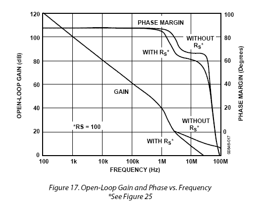

You can make it "stable", but it is not the best way how to use the AD797.
True enough, and it might not be my first choice for a unity gain buffer, though it can be forced to do the job. IMO, the 797 has a great data sheet, and op amp "rollers" would be wise to read it carefully. It ain't necessarily plug & play with a lot of other parts, unless you mod the circuit accordingly, which sort of makes my original point.
PMA said:
The AD797 is UNSTABLE at unity gain.
Sorry PMA, but according to my extensive experience with this chip - what you are saying is simply not true.
AD797 is absolutely stable at unity gain - I've built numerous circuits with it and there was no sign of instability at all.
I don't wish any further argument on this subject - I'm talking out of experience, not waving with the paper.
