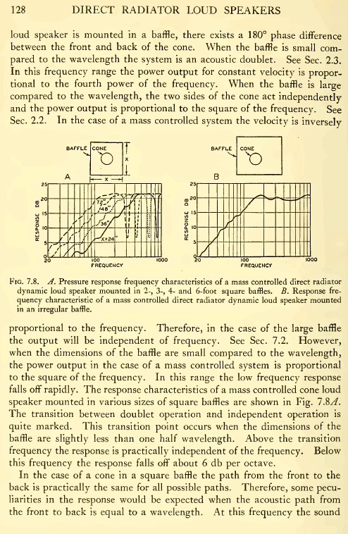

Acoustical Engineering by Harry Olson
https://www.amazon.com/Acoustical-engineering-Harry-Ferdinand-Olson/dp/B0007E672Y

As JM says, ALL domestic speakers 1928-1963 were open-back baffles. This is an effective speaker (if you don't need deep bass), and potentially more sound power in the room since both sides of the cone contribute over most of the audio band; the dipole/cardioid pattern gives more "throw".
So Olson's writings are relevant, if maybe too dense and insightless for most readers.

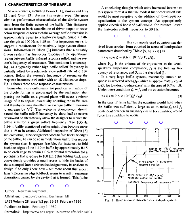

There was another great paper in the 1970s. Cats at EV derived the flat/bent baffle in terms of the new T/S thinking. They found a niche using large numbers of large very cheap drivers. My memory says D.B.Keele was an author but it is not cited on his website. You could contact him and see if he remembers the paper.

Newman.
Dipole Radiator Systems
Author: Newman, Raymond J.
Journal of the Audio Engineering Society
RA. J.. Newman, "Dipole Radiator Systems," J. Audio Eng. Soc., vol. 28, no. 1/2, pp. 35-39, (1980 January/February.).
AES E-Library >> Dipole Radiator Systems
Highly recommended; however costs $33 if you do not have AES access. (You can avoid >$30 of mistakes by reading this before building.)
