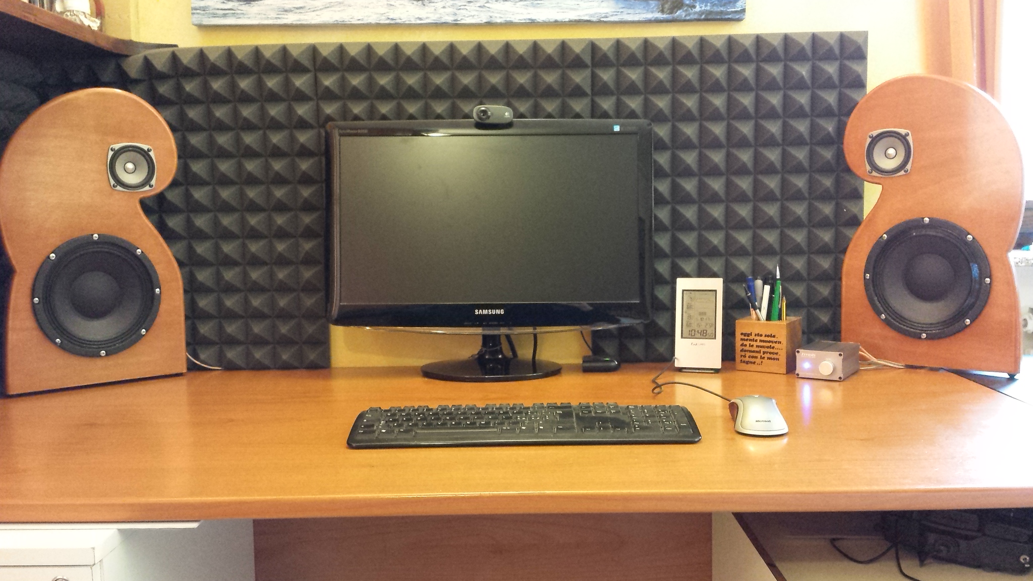

Wondering about open baffle from the last couple of months, I finally decided to give them a try, so I bought a pair of Fostex FF85wk and put inside a rectangular baffle 20" height and 12" wide, very close to the golden rectangle
As soon as I connected the two raw test article to my Trends Audio 10.1, it became immediately clear to me that I love the open baffle sound vs boxed speakers, in this case further enhanced by the coherence of the little fullrange
Bass, below 200Hz, was compromised of course, but the rest of the spectrum was soooo clear, sweet, open and detailed, only sound stage and imaging suffered a bit, I thought due the wide baffle
So I decided to try different baffle shapes and test how the edge diffraction affects imaging and sound signature
First I simply moved the fostex off center in the same rectangular baffle, using the Fibonacci sequence to determine the exact offset from one side edge, then the upper and finally the other side.
Things audibly improved, a bit

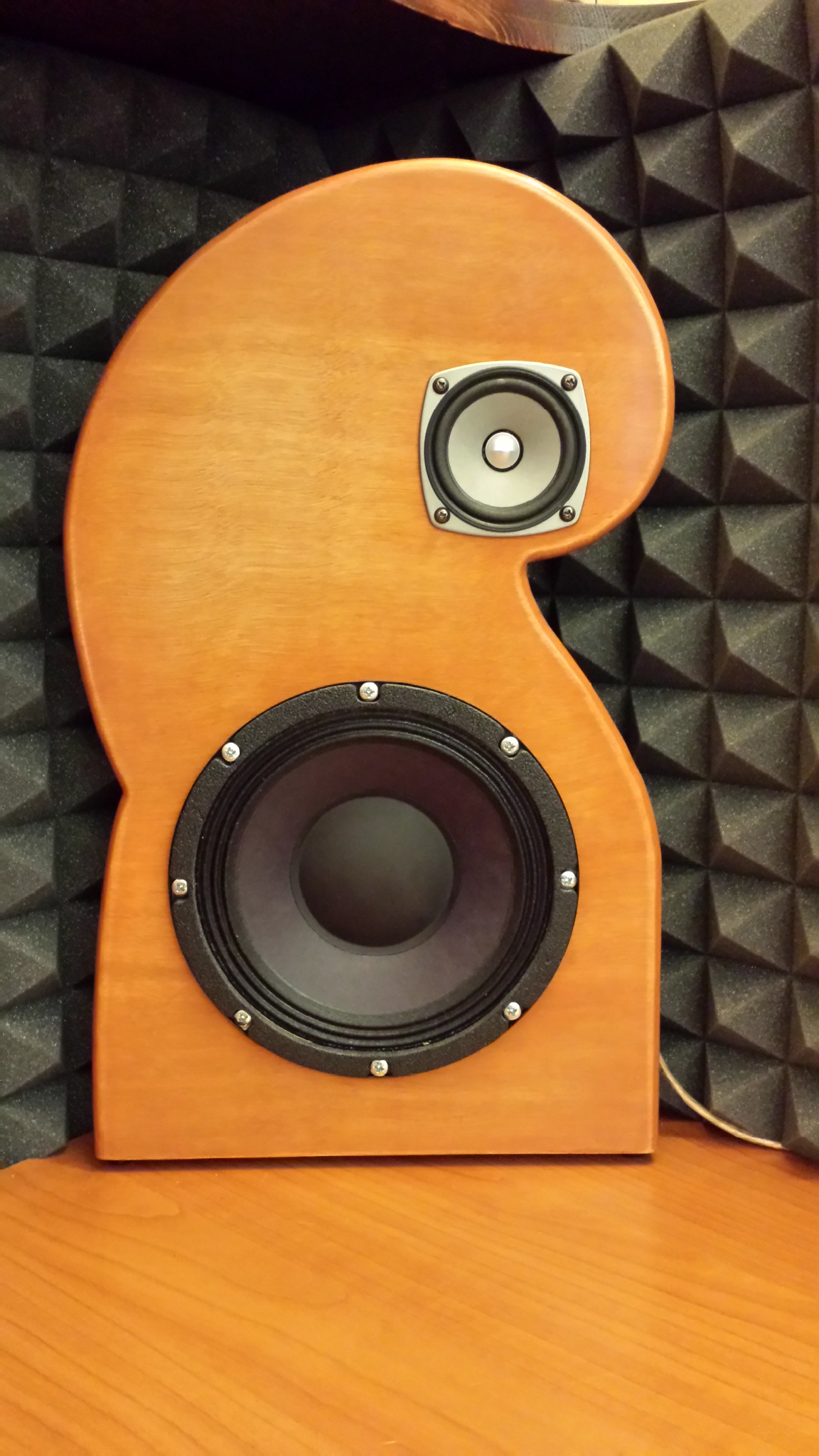

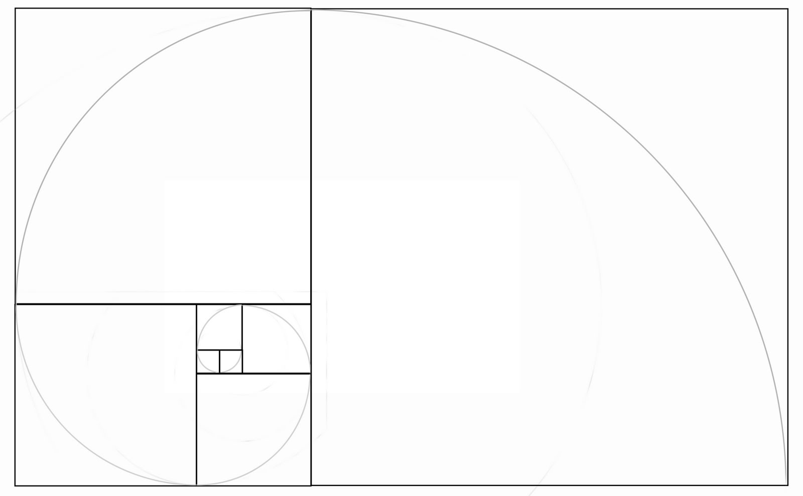

Then I cut the upper half of the baffle following the Fibonacci spiral shape, the same golden spiral present in nature in many life form, with the fostex in the spiral center
attachment.php
Bingo!!
Things improved further, this time a lot !!!
Imaging improved dramatically, but also sound signature changed for the better, all traces of peak and dip along the spectrum due to edge difraction disappeared completely

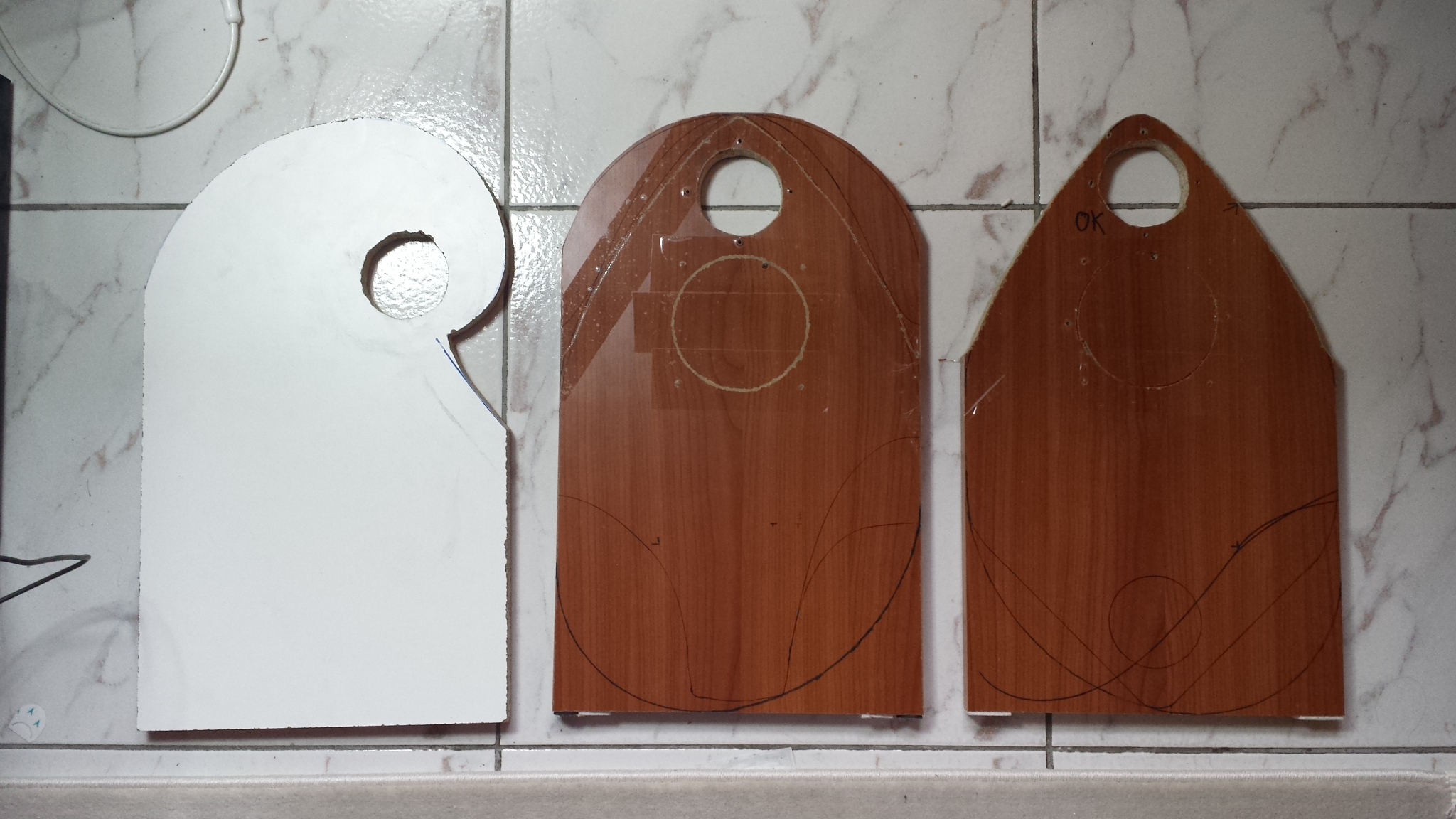

To make sure it wasn't a placebo, I compared the spiral to other two shapes
First the same 12"x20" rectangle with the upper edge rounded, with the fostex placed centered in the baffle but off the circle center: this sounded reasonably good, but not as good as the spiral and less focused
Second, I cut away other material, narrowing the baffle to a bullet shape: imaging improved, but the lower mids became thinner, unbalancing the frequency response to the upper mids
attachment.php
Tried again the golden spiral, yeah, that one sound right in every aspect, I stay with it

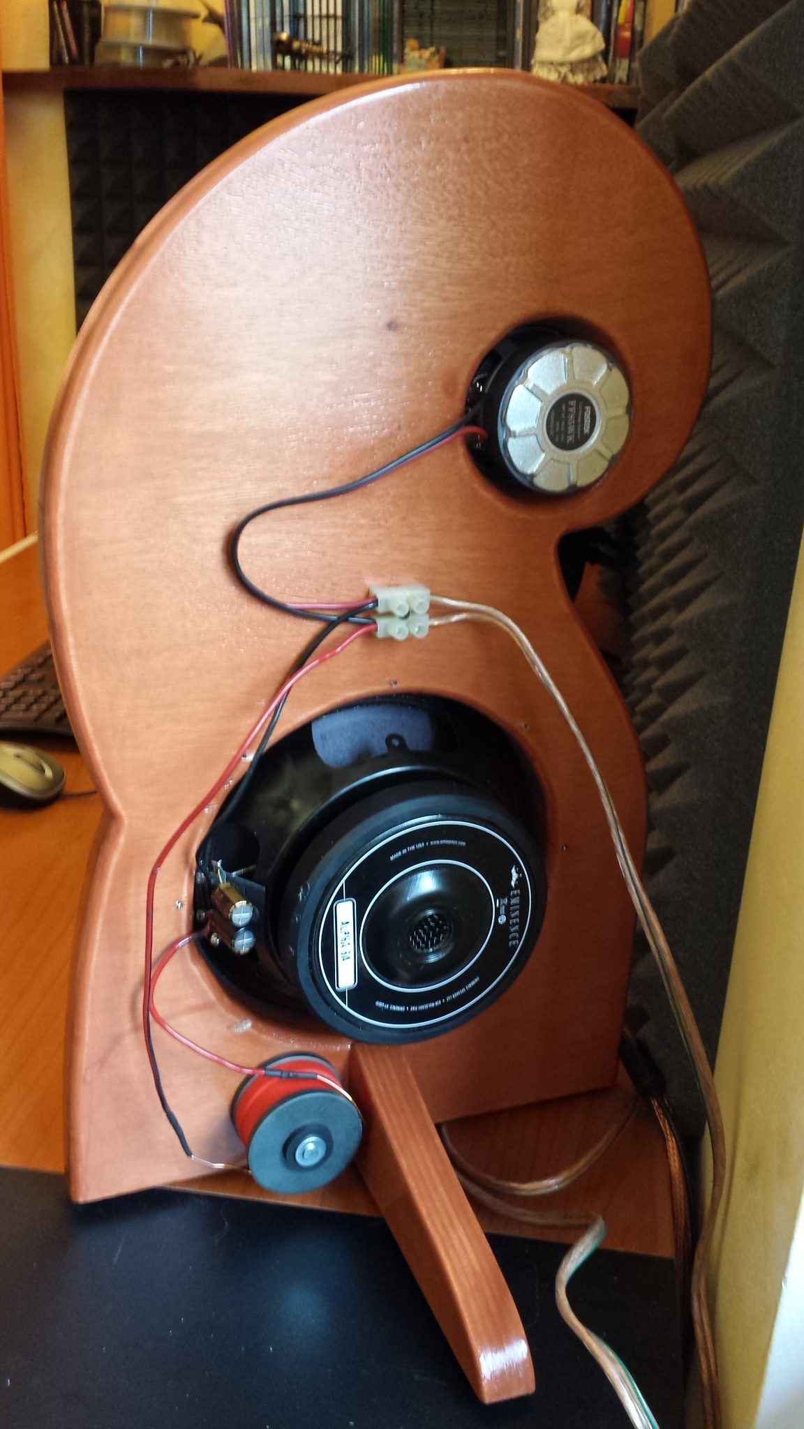

Next step was to add the right weight to the bass, so I added an Eminence Alpha 8a, cut at 150Hz with a passive second order LC filter
The eminence proved to be the right partner for the little fostex, giving to these loudspeakers the right balance all over the spectrum; bass will be never shaking or kicking, but wonderfully crisp and natural, without any boominess tipical of boxed speakers
That's it, we have the Nautilus
attachment.php
attachment.php
attachment.php
Probably would be better biamped with an active crossover, but for the moment I'm happy with the result

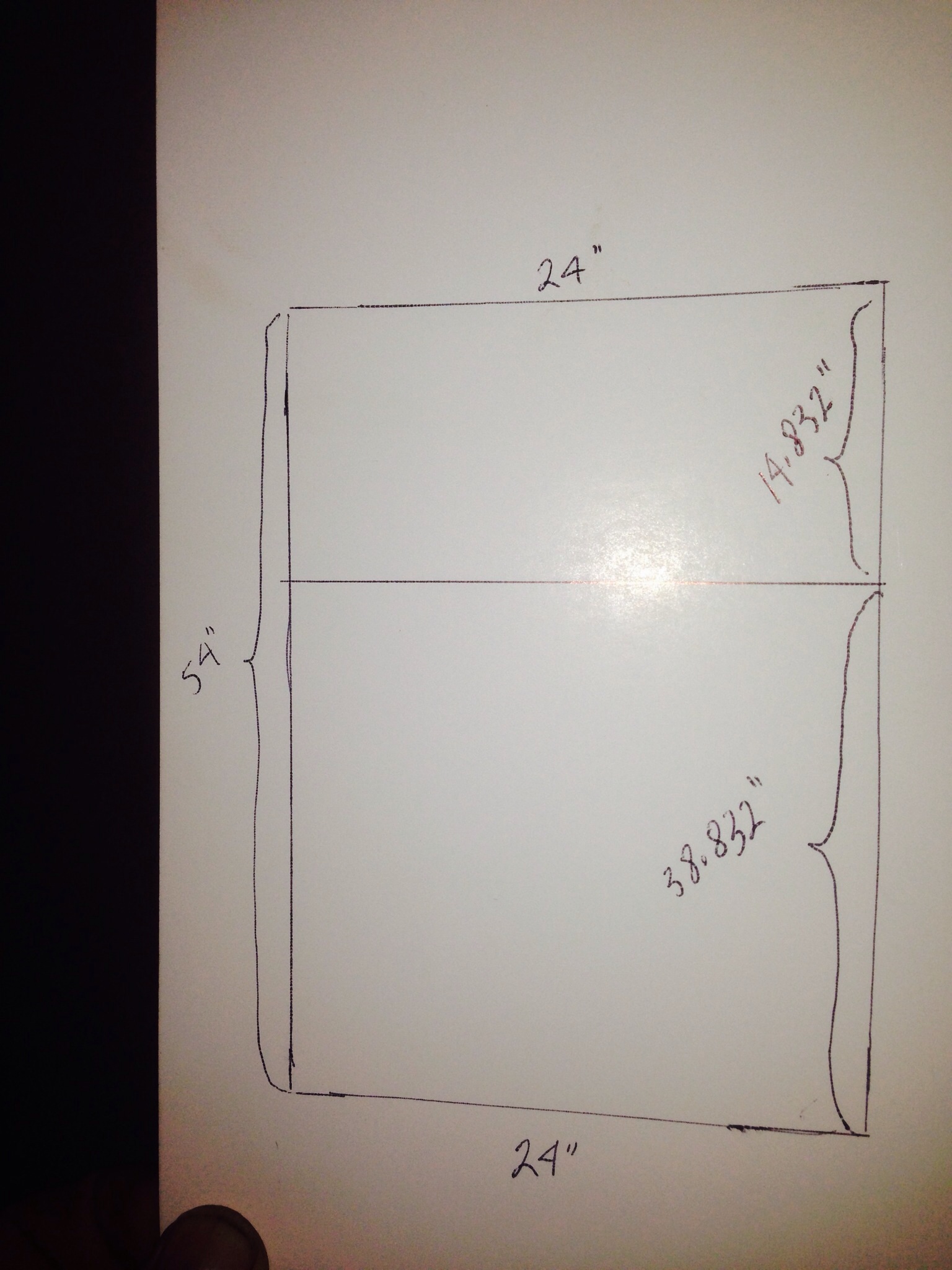

Can't load photo at this time. But if you start with a 24" wide baffle measurement, multiply it by 1.618. This is 38.832.
Multiply 24 x0.618. This is 14.832.
So there are two golden ratio rectangles, 24x14.832", and 24x38.832".
When these are stacked long axis of the big one with the short axis of the small one, a 24x 53.664 panel is created.
With the addition of 5 1/4" "wings behind the sides of the baffle, this is very close to a 1-4-9 ratio of depth to width to height of my horned open baffle.
Sorry I'm not able to send a diagram or photo.
Most people like the looks of this panel ratio.
And it wastes very little from a 4x8 plywood sheet, with the off cuts well suited to supply the base, top wing, and nice brace for the woofer motor.

What is the significance of the Fibonacci spiral shape you mention? How far down in frequency do you think this effects your design?
Honestly, the Fibonacci sequence and then the golden spiral were just an enlightenment without any scientific basis.
I was just thinking about how to reduce the edge diffraction, and to me an asymmetric shape with a curvature that spread continuosly the distance from speaker to edge (and hence wavelenght) would have been the right solution, and suddenly golden spiral came to mind.
Why not? It was just a bet, and to my ears was the right one
Moreover, why we continue to stick to squared loudspeakers (boxed or open baffled) when I can recall no one music instrument with squared shape?
Unfortunately I can't provide any measurement, I just can tell you that is the most musical piece of wood with speaker that I've ever heard, just try yourself, is quite easy and I'd like to know more opinions
