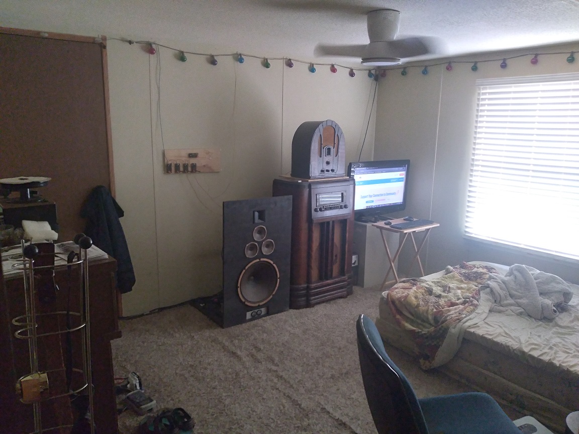

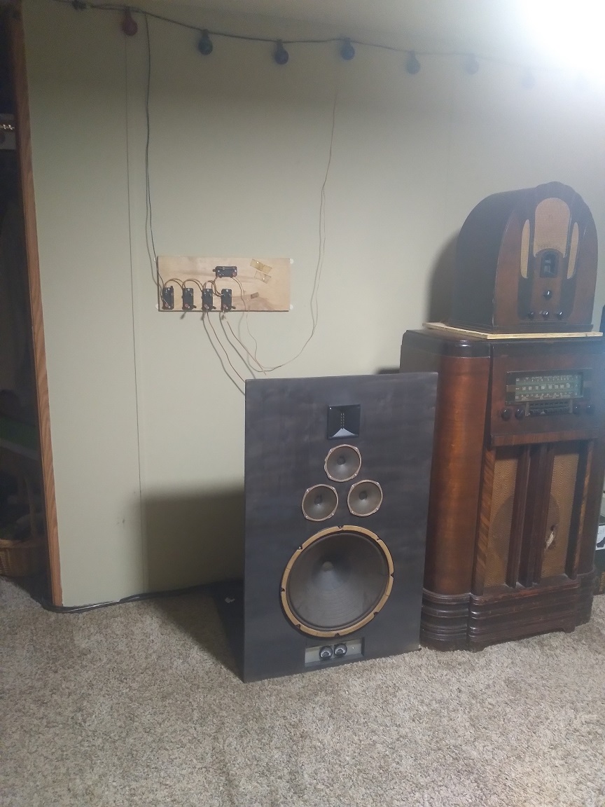

Here's the speaker location. I have enough room on the left to add a 2' wing to the speaker. What's nice is if I find the wing alone doesn't work it will be wide enough to where I can mount a 15" woofer to it.

I'm sure the console being right next to the speaker affects the sound some, however when I moved the speaker farther away from the console, the bass didn't sound quite as good.

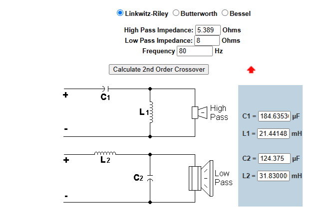

Here's what it would be for an 8 ohm woofer.
The 4 ohm woofer is this.
The inductors do get expensive that large.
I'd prefer keeping this all tube, however the Magnavox AMP-142 does a good job of heating up the room by itself. Another tube amp would make it even worse. So even though I have a Heathkit A9C amplifier to restore I might not use it, although if I did I'd be able to use a passive RC crossover fed by the preamp I have and have the ability to adjust the level of either the main speaker or woofer to balance them with each other.
That said do I really need to cross the woofer over so low?
If I choose a 150Hz crossover frequency the components are a more reasonable size and cost.
Either way I'm going to try just extending the baffle width first.

I'll post photos of the rest of the room when I get home. Perhaps moving the speaker elsewheres in the room and/or moving other stuff around will reduce or eliminate the issue.

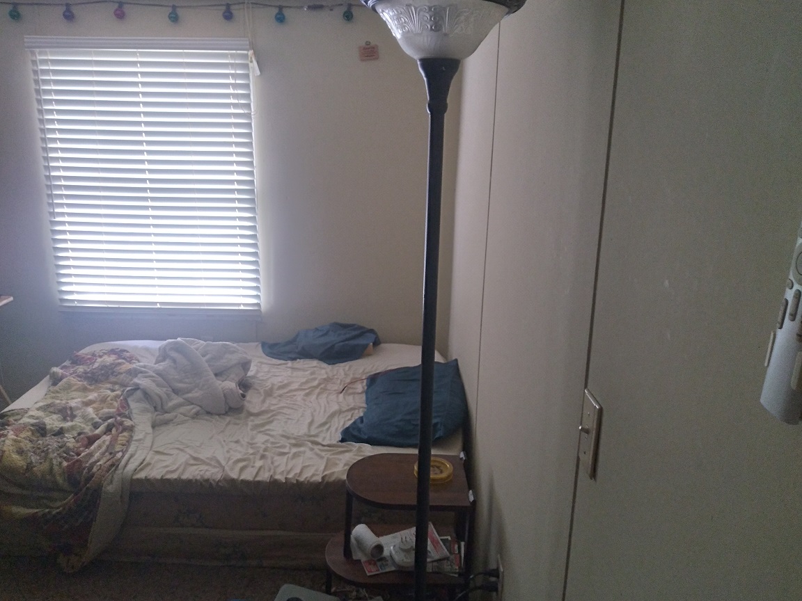

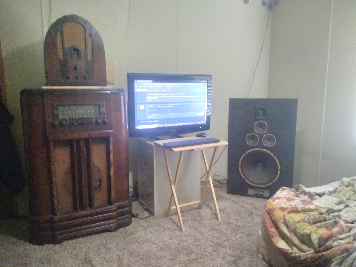

Here's photos of the room.
Where the chest of drawers is I cannot put the speaker as a bedroom is on the other side of the wall.
Only place I can think of is to move the console to right at the edge of the door, move the TV down right to the edge of the console and place the speaker in the corner at an angle
