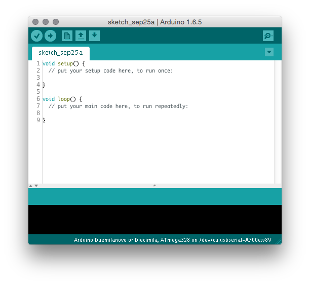

Hey Ernst,
you don't really 'run' Arduino sketches in the IDE, you edit them in the IDE and then run them on the Arduino.
You can 'compile' within the IDE by clicking the 'check-mark' button (called "Verify") and send to the Arduino via the 'arrow' button ("Upload") right next to it in the upper left corner of the editor window.
Does the sketch compile (verify) without errors?
If not, what errors does the IDE report?
Sebastian.

Hi Sebastian, what I did was as follows : I clicked on Ians program let's say and then the code appeared in the IDE window. Then I tried to verify and load up. Verifying failed.
I'm checking the error codes and come back later. Thanks for help [emoji3] Cheers Ernst
