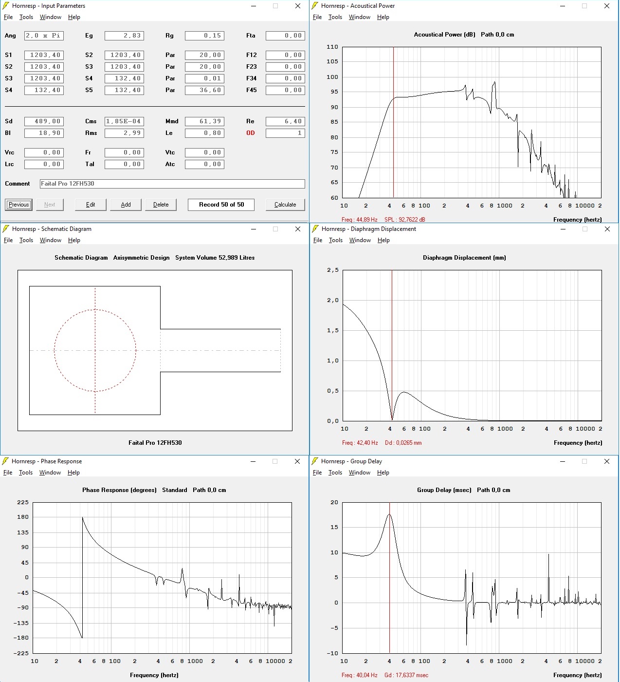

I tried to reproduce your result for the Faital 12FH530 in a bass reflex box. I could not reproduce your result using AJ Horn. No matter what I tried, a 59 L box would give a nasty response peak at the low end. I can get it flat with a volume of 30 L or so, with a -3dB frequency of about 52 Hz. Quite a difference to your result. Hmm.

It is not so easy to use bass reflex as "Type of design", I am not familiar with AJ horn, but hornresp and MJK's excel sheets are good, use horn simulation software, do not use bass reflex software. It is a slot port design.
If you want I can try and get an Akabak simulation going to verify, but I got so consistent results from hornresp that I stopped verifying, it may take some time to do this, have not used it for some years.
And I like to have the combined phase from port and driver together, it is hard to get good (PROPER!) results with bass reflex software.

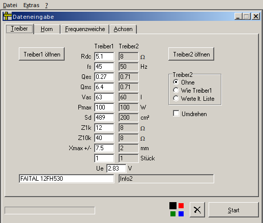

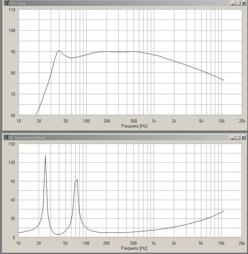

Do you mind posting the data you entered into AJ horn? Maybe the dimensions are different?
AJ Horn does the "generalised transmission line approach". It links the different box units by their acoustic impedances to model the system. It is not the "classical bass reflex equation" program. I attached my inputs and the outputs (SPL at 1m, sum of driver + port, free space).
The box input screen may look a bit funky when your brain is wired to bass reflex. It works by linking the driver to a box with a volume of 59 L, and this box is then linked to a tube (44cm² cross section, 10cm long). The tube looks like a "horn" on the input screen, but it really is the bass reflex port.

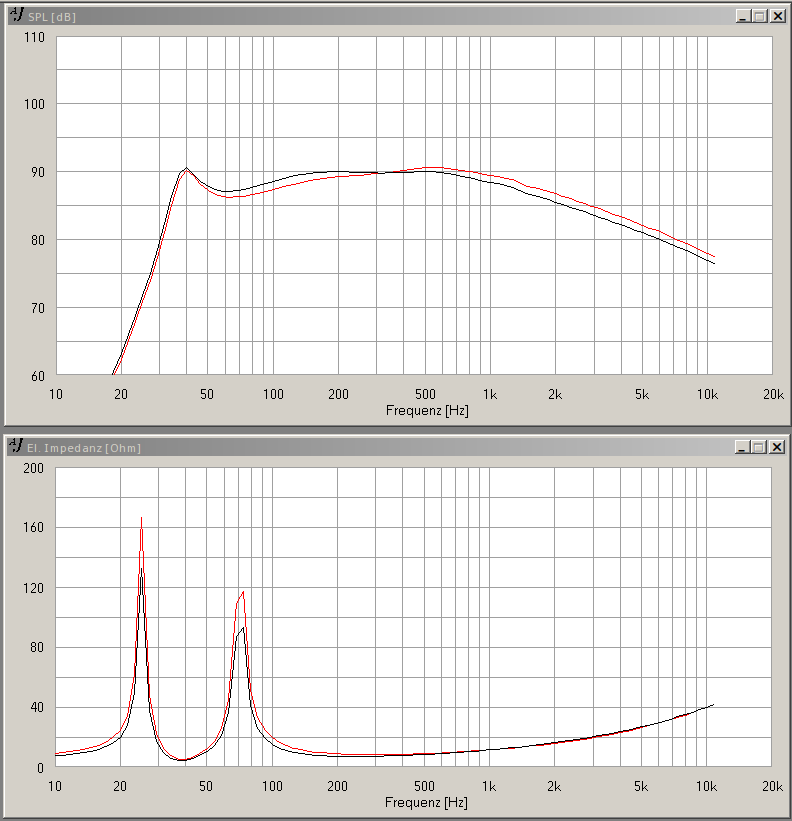

OH!
I am sorry, there is a peak at the low end, my sim was wrong.
I had somehow written 6,4ohm dc resistance instead of 5,1ohm.
I will revise the simulation.
I just tried AJ Horn with 5.1 Ohm (correct, black curve) and 6.4 Ohm (wrong value, red curve). The difference is not very large. I believe the difference between our simulations is somewhere else.
If you could provide your 5.1 Ohm simulation I will ask the developer of AJ Horn about his opinion on this.

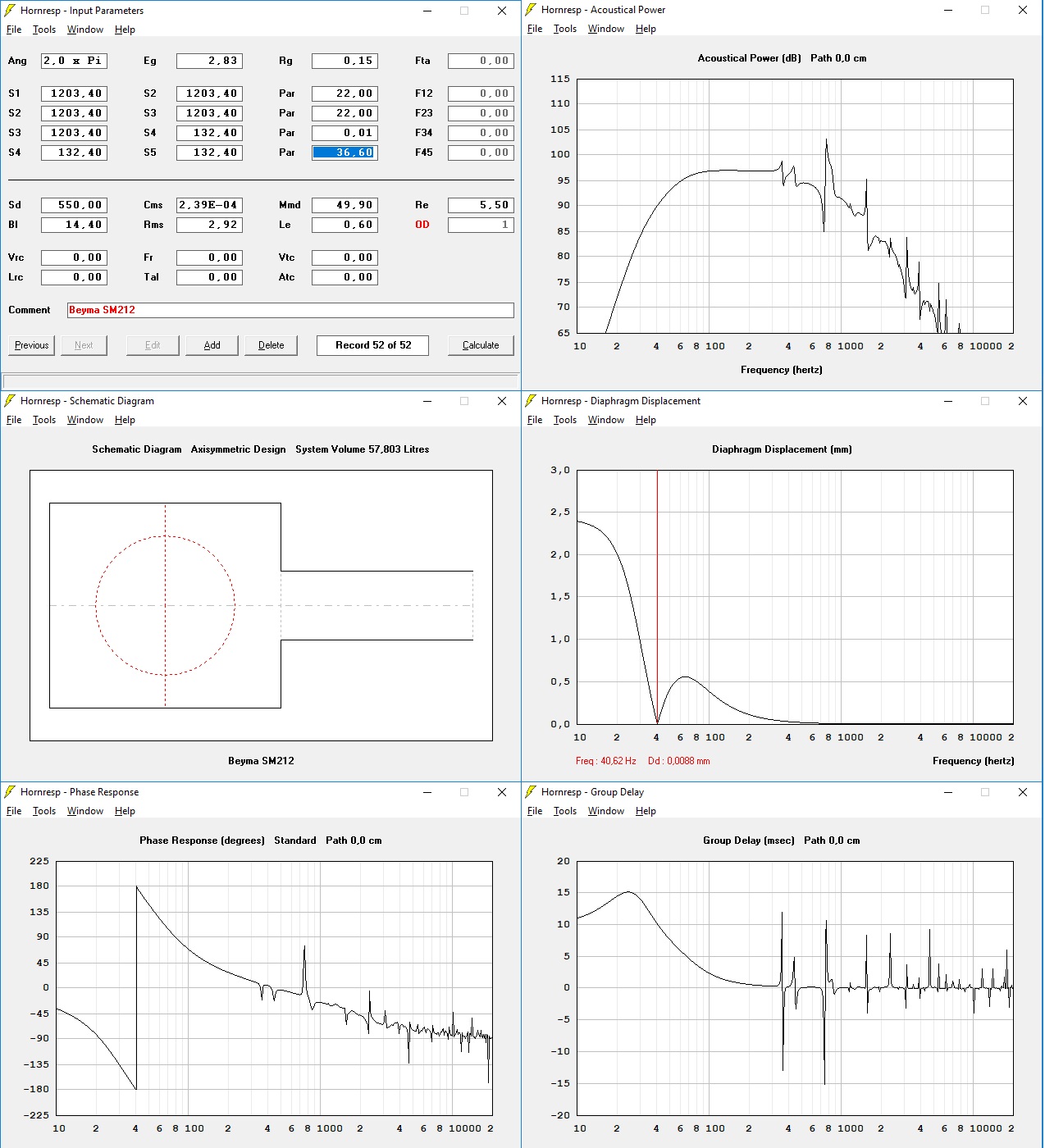

mbrennwa:
The port I used for simulation is over 36cm long, not 10cm. And it's 33,1cm wide (divider in the middle for bracing) * 4cm tall, so 132,4cm2. It is not only tuning frequency that is important, but how the port behaves at tuning frequency.
Anyway. Using a Beyma SM212 the results are much better, group delay can be lowered to a very nice value. 400hz and maybe even up to 700hz should be just fine, if you can place some damping material on the right locations.

mbrennwa:
Oh man... thanks for pointing out this stupid mistake. I guess there was a reason for my earlier comment that I am not very good with those simulation tools. I will try again this evening.
Hahah! No worries, I had a *facepalm* moment myself when I noticed I had put the wrong parameter in hornresp. :-D
Can we call it even?
Regarding port loading:
Yes, there's more to it. Important to keep group delay as low as possible (completely ignored in commercial designs), often a port will cause lots of phase wrap at resonance, have to be mindful of that in the design.
Also think about the distances between the driver membrane and the internal sides of the enclosure and what frequency modes can be excited, it is easier to use dampening material to reduce high frequencies than low frequencies, just like with filters.
