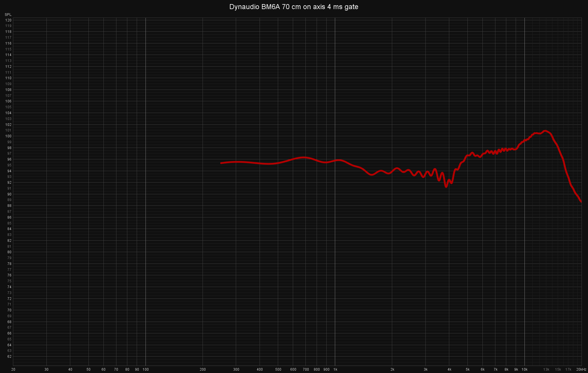

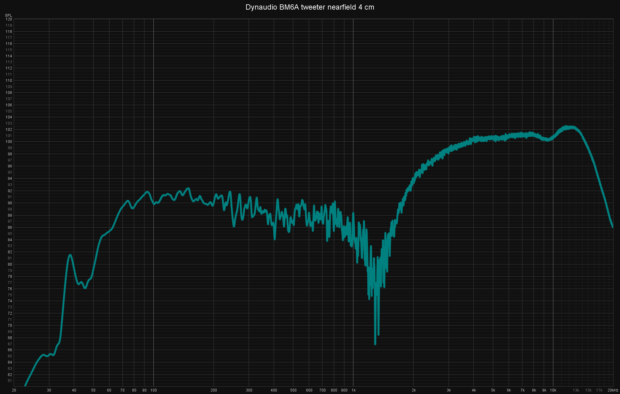

Excellent point!Are you sure you are not repairing what is not broken? There is Dynaudio BM6A in a studio nearby, about 20 years old and well within specs.View attachment 1130290 View attachment 1130291
I happened upon several posts here and there by the usual "experts" to the effect that Ferrofluid does degrade tweeters with time. Since my tweeters were purchased 23 years ago(and may have been on the shelf for a year or two), I was doing research and posting for advice on prospects for service or replacement, while there are still "NOS" parts available. I just did not expect the pushback which I received.
Naturally, I would prefer to "leave well enough alone"... I'm currently listening to some nice jazz with Lpads at "+1dB" they're nice to 65yo ears!
Thanks for the objective info and reassurance!
I think I may still try to obtain another single unit as insurance in case of unexpected damage, such as a dome poked by grandkids.
