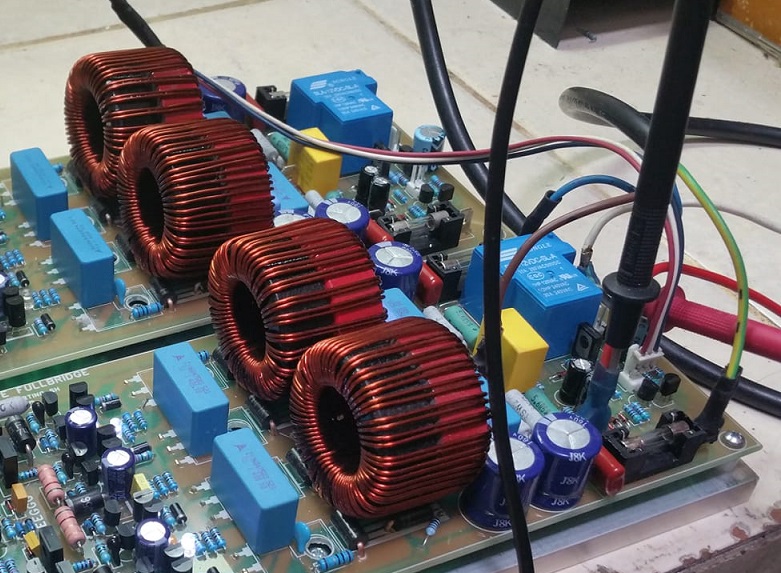

Its FAKE output power,
look attachment picture output filter - This is real
class D Amp Fullbridge 3000 - 4000 W RMS 4 Ohm working in lifeperformace
and look output Filter look from sinbosen its look like toys ....1500W can be possibile
Fullbridge you can get with Class D about 1500 - 2000W 8 OHM RMS
and 3000 - 4000 W 4 OHM RMS = 7000 - 10000 W Marketing peak Power
burst mode this are the limits.
Class D need 270 - 320 KHZ switching Frequency for class AB Sound Quality
At about 120 - 130 V DC is finished with Class D also with Fullbridge.
Some manufacturer have Class D design with low Switching Frequency you get will high output power with poor compressed sound
Good designed Class AB / H / TD amp will kick quickly
poor sounding class D amp in Trash
It will sound terrible and you will hear it in life performance
sinbosen states in it´s technical data 100V/at 1% distortion. So you can expect about 1200 W at 4 ohms´ at best.
The other amp is ridiculous, maybe real 250 watt. Look at the cap´s, they store the energy for peaks. The round black can´s.
sinbosen has quite some, the other? The output power is always told with a little lie, but some tell big ones.
