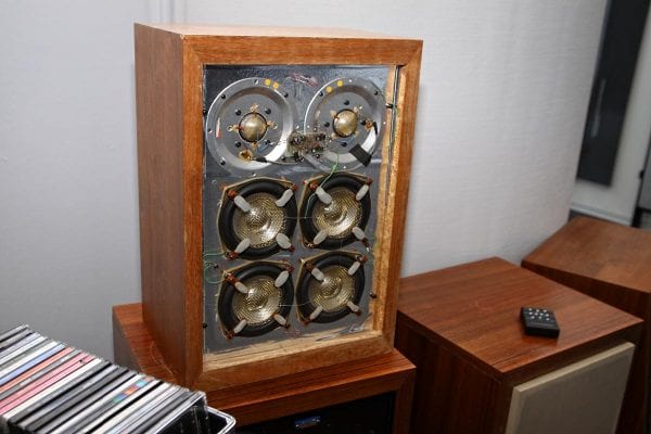

As far as i know, Backes&Müller (Germany) had several speakers with cone movement control via capacity sensing. Inside their first model ->BM5 (or Monitor 5) on every transducer, in subsequent models only within the (Super-)Tweeters (Models BM6, BM12, etc.).

I believe B&M also used an optical system, consisting of a conical pin connected to the cone, and a light detecting circuit (light source and a LDR). The pin moved in and out the light detecting circuit, blocking more or less light. The position of the cone thus could be read. Differentiating this gave the cone speed. IIRC.
