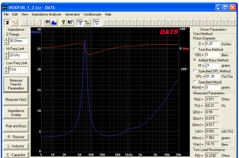

The SB 5 woofers are the same as my Control 5. My surrounds suffered foam rot so I replaced them with new ones.
The T/S below is with the new surrounds. I don't knowhow close it is to the originals but it should not be far off.

Well, a max flat BR is ~63.64 L/48.3 Hz, so four is a fairly impressive ~254.55 L/8.99 ft^3 net before bracing, material thickness is factored in. Stuck in a corner will somewhat compensate for low Xmax.i wonder if what i could come out with something different with these drivers? ... i am thinking of ported for these drivers
