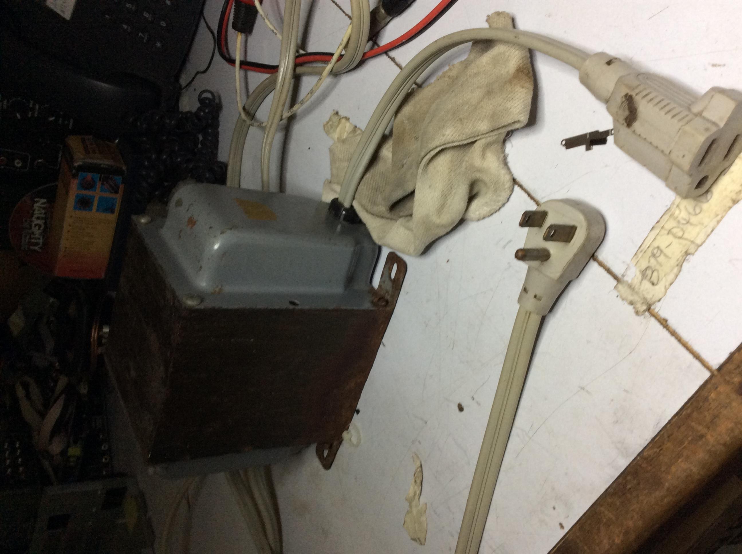

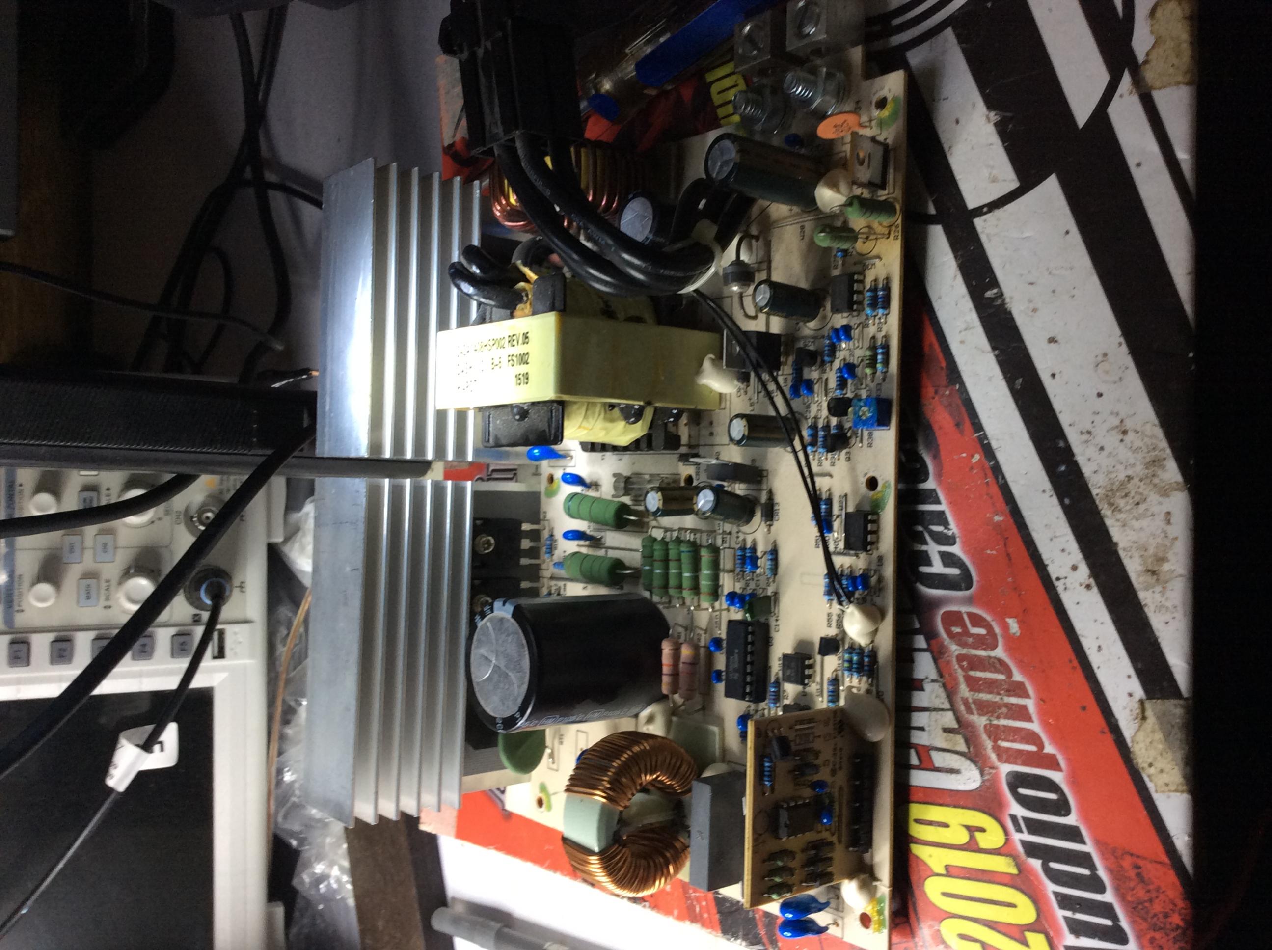

I’m attempting to work on a PowerMax RV 80amp charger I need to use the Oscope on the pwm circuit but as it’s a mains power device what’s the best (safest) way to make measurements without blowing up components or the grounding practices that’s with probing mains voltage circuitry.
I have an isolation transformer can I plug the device under test in the IT or both the test equipment and DUT or just the scope.
Regardless of the isolated transformer, is it likely to still short the device or test equipment?

The only safe way is to use high voltage differential probes,
or a battery powered insulated scope, that does not connect to the mains.
Otherwise, very unsafe. Floating a scope is a very bad idea.

Absolutely not, you need an isolated differential probe for that.
All scopes are ground referenced, unless they run on batteries.
You cannot use any combination of unbalanced probes with a grounded scope for your purposes.
You can't fool around with mains voltage, this is extremely dangerous.

What nigelwright said: use a normal **grounded** scope, normal high voltage probes, and float the offline power supply instead.
Attack the root cause, not the symptoms.
And in case you don´t (yet) see it: the main problem is not shorting or blowing anything but killing you.

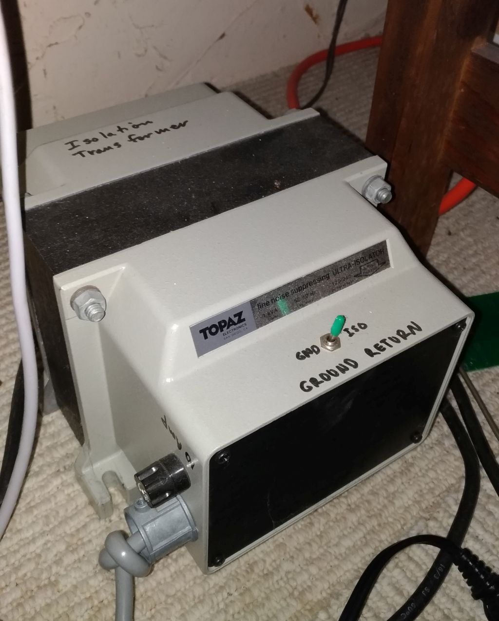

You can use an isolation transformer to "float" the scope. Be aware that almost all scopes that are powered from the AC line, connect the scope probe ground clip to AC power ground. You also must disconnect the scope safety ground from the isolation transformer output safety ground (if it has one).
Back in the day it was the norm when working on HV equipment to float scopes. Be sure the isolation transformer chosen can handle any potential differential voltage.
Be aware you have created a very dangerous safety issue. If you accidentally touch any nearby equipment or anything metal connected to AC "ground" or neutral you are in big trouble.
