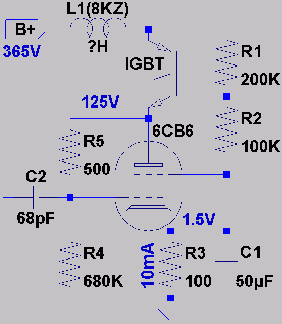

poweramp:
http://files.geekysuavo.org/golem/sec5-poweramp.png
thoughts:
1.) this is probably where i'll need the most changes...
2.) there must be a better way to create a lower anode voltage (127V) than a simple resistor divider. will the 4.7k resistor really dissipate 11.7W???
this will be a guitar amplifier, so i'm nowhere near the requirements of hi-fi, and since it's a first project, i really want to know if anything's going to just fry on me. 🙂

A couple of suggestions Brad. Rewire the B+ standby switch out of the high voltage location it is in now and place it between the center tap of the power xfmer HV winding and chassis ground. This will add a safety factor.
The 6CB6 is not an audio output tube. If you are tyrying to re-use a 7 pin socket get a 6AQ5. That is good for much more power and will solve the B+ dropping resistor issue you have since it will run on the main B+ rail from your power supply. As a bonus the 6AQ5 has the same characteristics as the famous 6V6 loved for musical instrument amps for it's tone.
Neat idea. Are you going to put a 5 inch stage monitor speaker in the hole where the scope tube used to go? Parts Express has one for around $15 that ought to work well for guitar.
thanks for the HT switching suggestion. 🙂 the case wiring in the oscilloscope was a nightmare, and i wanted to start from scratch, so i built my own wooden chassis. that speaker idea would've been pretty sweet though! 🙁
as for the 6AQ5 suggestion: since the max Va(dc) of the tube is 250V, doesn't that still mean i need a quiescent anode voltage less than 250V? (hence some kind of divider circuit?) i don't need a high output power or anything, and i'd heard that the 6CB6 was a good general-purpose pentode which could be wired for low-power audio output, so i chose it... here are the other available tubes from the 'scope:

Gee, you are right that the plate voltage is still a bit low on the 6AQ5. I just pulled that out of my head from distant memory. If you aren't trying to re-use a 7 pin socket available in the original scope cabinet (a shame) your choices for an output tube are huge for a non-critical SE application like this. What do you have access to? For example. Almost any octal base TV horizontal output tube could serve well, in fact it doesn't have to be octal if you have a socket for it. Common octals were 6BQ5, 6DQ6, 6BG6. These usually have plate cap connections.
Most TV sweep tubes will need a resistive voltage divider to supply reduced Grid 2 (screen) voltage while the plate will handle your full B+ voltage available with ease.
Other tubes just off the top of my head would include 6L6, 6V6, 6W6, 6Y6, 6K6, 807, 2E26, 6146. 9 pin miniature include 6BQ5, 6CL6.
You could wire both internal triodes in parallel on any number of twin triodes. 6SN7GTB is common and would handle the job and the high voltage giving you a couple of watts.

sec5-poweramp : Consider running the plate and screen at
full B+. Just drop the excess voltage across a bigger cathode
resistance. Tap into that big cathode resistance at some mid
point where you still get the right grid bias.
I agree with previous posts that your existing 6CB6 may not
be optimal. Seems silly wasting half B+ just to accommodate it.
Or you could strap 6CB6 as a Triode, and abuse a FET as the
top half of a pentode-like Cascode. Capping the plate voltage
at some reasonable level for the 6CB6.

Oh. Or better yet, drive the grid of that FET 1/3 voltage seen at
its drain / OPTransformer junction. And the 6CB6's plate will see
"normal" load variances, just at 1/3rd voltage intensity...
That should present a less sandified impedance to the OPT.
And allow full pull down, low as whatever 6CB6 can conduct...
Here, FET may augment (and triple) whatever voltage drop
as seen by the Pentode's plate. It needn't make any signal
processing decisions of its own. The current is still decided
by the 6CB6, and the 6CB6's plate is not entirely isolated
from seeing a fair (1/3) share of the real world load.
My explanation was getting a bit confusing without a picture...
I suggest Triode strapping might be more appropriate in this
application. As whatever Plate impedance will appear tripled
(along with voltage) at the Drain. Strapped Pentode, might
be too much impedance at the Drain to match your 8K OPT.
Time OUT
Hey guys! Stop trying to consfuse the poor kid trying to cobble together his first tube amp while grasping basics of tube circutiry. Your IGBT, etc. ideas would confuse tube circuit veterans!
Brad, go beg, borrow or buy a 6L6GC. It will look really boss, sound amazing and you will not hurt it with 450 volts B+ or less.
His early schematics already show a great depth of understanding.
I never picked up any feelings of a need to dumb things down for
this guy.
I'm just showing one possible way to adapt his existing pentode.
If utilizing as much of what he already had was a desirable goal?
In the specific case of such a weak pentode as the one he had,
perhaps the simplest of all possible ways.
An IGBT is no more complicated than any other top device one
might use to implement a cascode. Tolerates a LOT of voltage,
easy to drive, and no need to supply with an elevated heater.
Full plastic jacket, mount it just about anywhere...
What exactly makes folks run scared when they see one? Or
is it just the concept of a linearized cascode that freaks you?
Not any stranger concept than conventional UL. Whatever...
That said, 6L6 is a very straightforward solution, if mechanically
incompatible. I'd kinda lean toward the 6CU5 for a 7 pin socket,
though alone it wouldn't really solve his voltage problem.
this guy.
