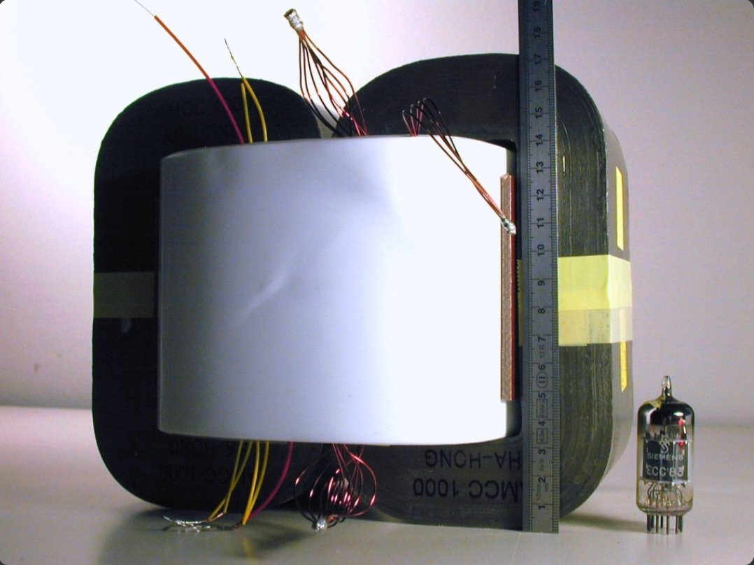

Of course, one can always go to the extremes of tube madness, as in the amorphous double-C core of the S-833 OPTs Monolith Magnetics made for my amps. The OPTs weigh 60lbs each.
Attached is a picture Monolith sent during construction, with an ECC83 tube for comparison.
