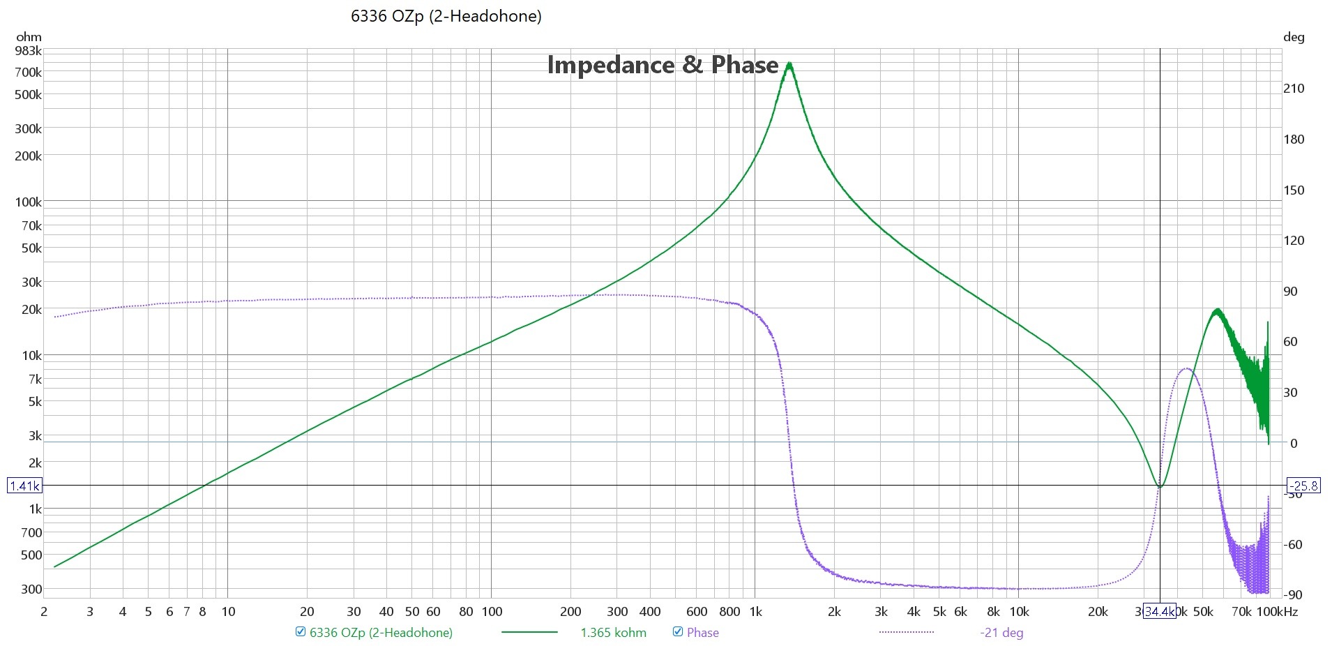

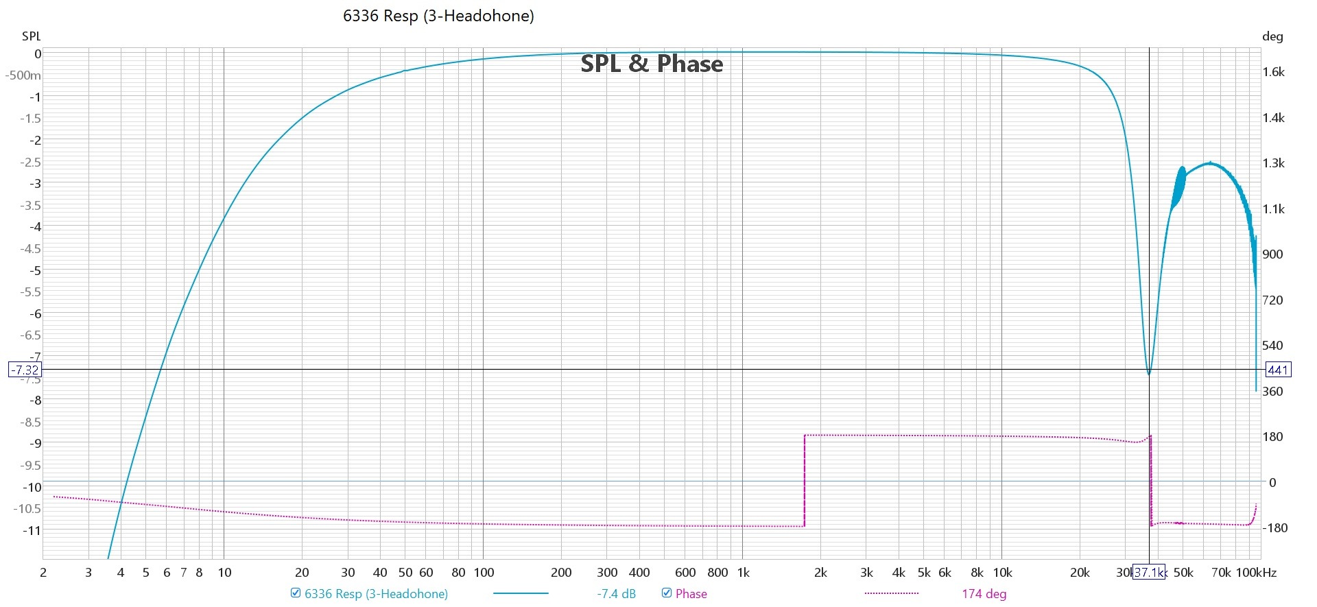

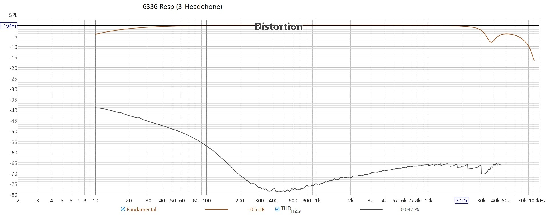

Hi everyone,

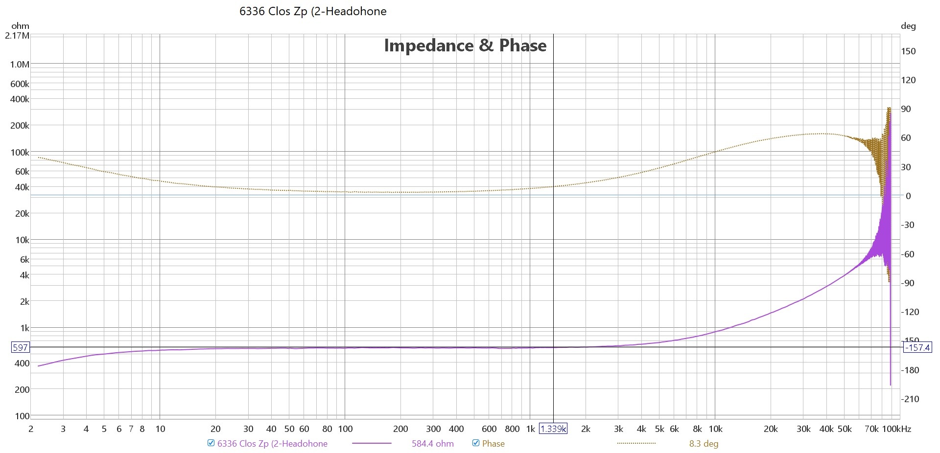

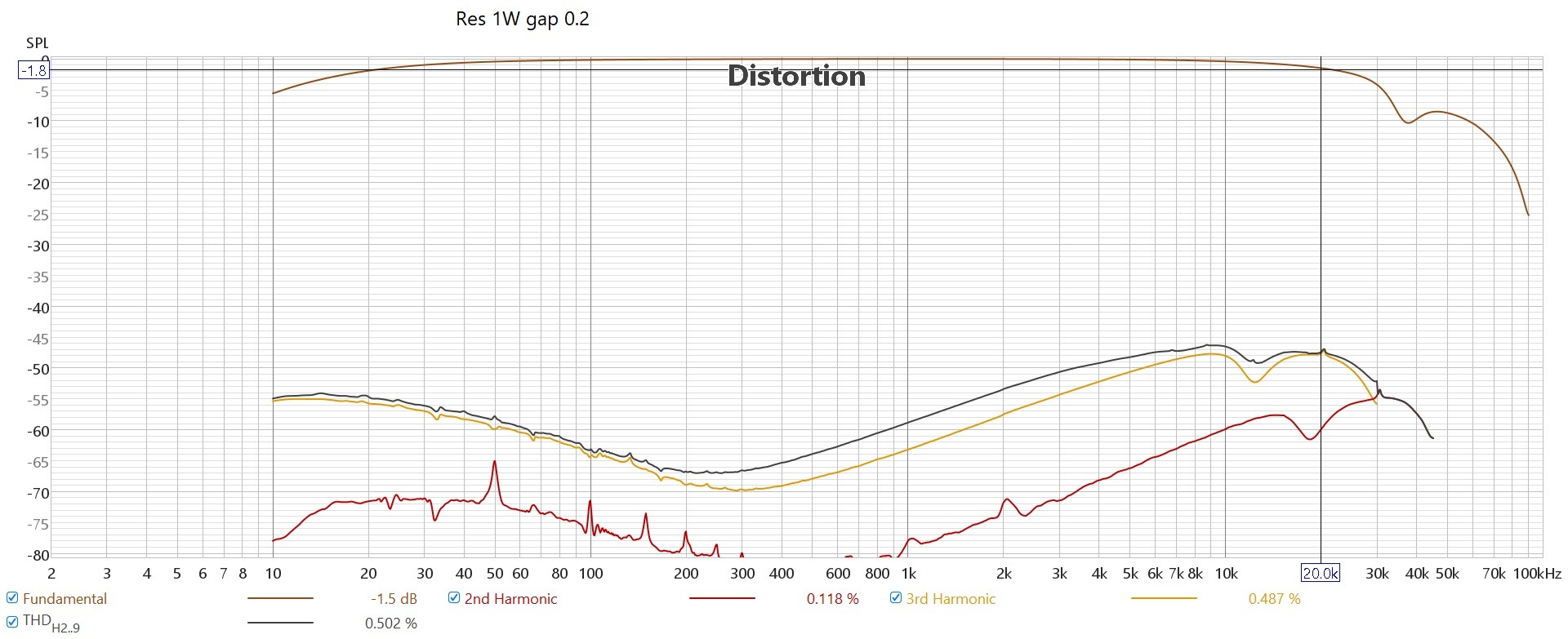

I recently wound a OPT for 6336 SET amp with 2.5K:8ohm impedance ratio and 10W max output power, pretty similar to 300B. Yesterday I did some testing on this OPT and everything was exactly as the design, except one thing; Hi F resonance (I mean the series resonance of Leakage Inductance and Shunt Capacitance), was at around 34KHz which is lower than my previous builds.
So here is my question; what negative effects can this cause? (bearing in mind that there is no negative feedback in this amp). I know that it can cause Hi F roll off and you can see F response at 20Khz rolled off at about -0.3dB, but is it that important? What is the other side effects that I'm not aware of?
I attached some images from my measurements:
Hi everyone,

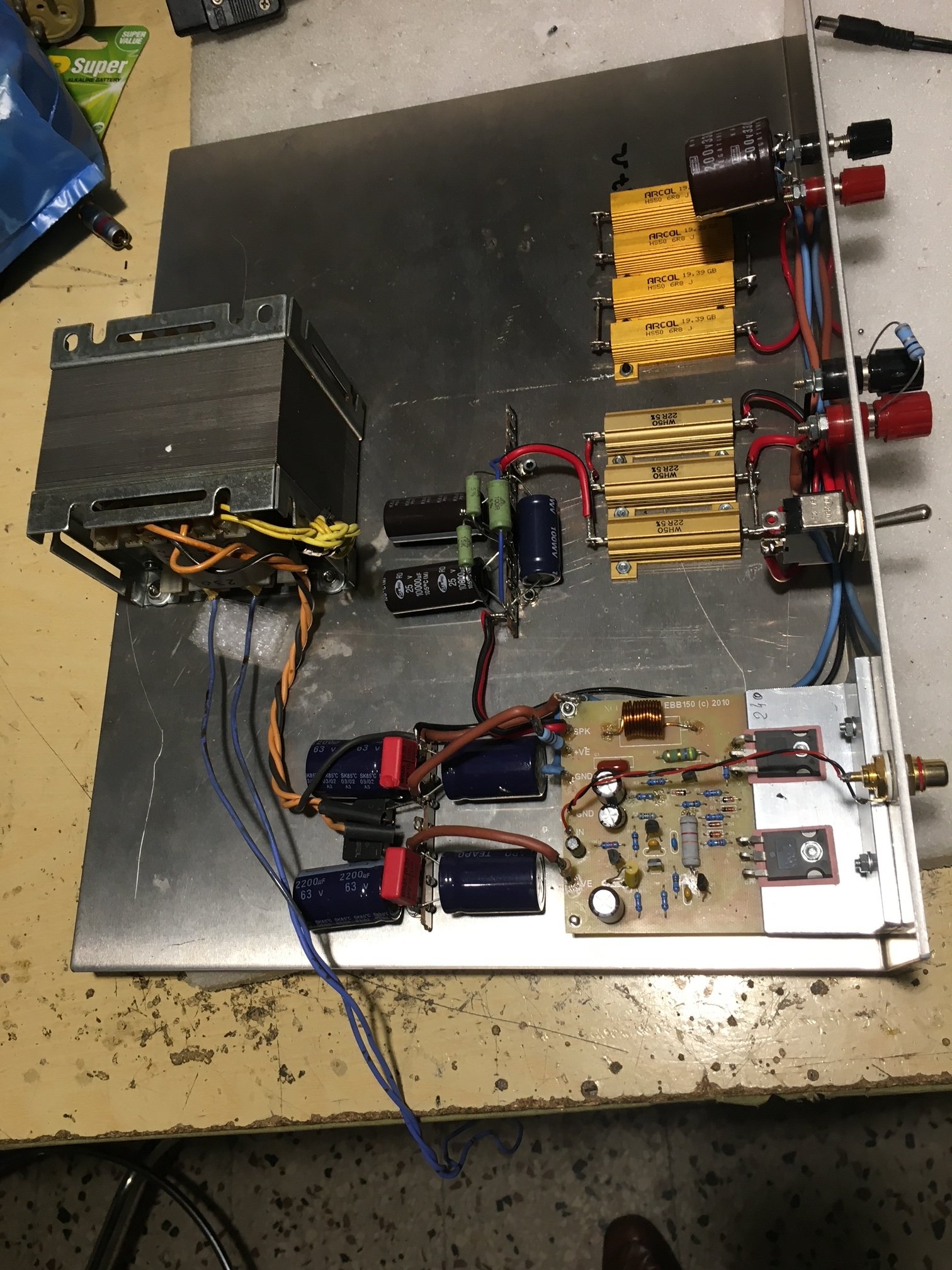

It is ReW software?
Walter

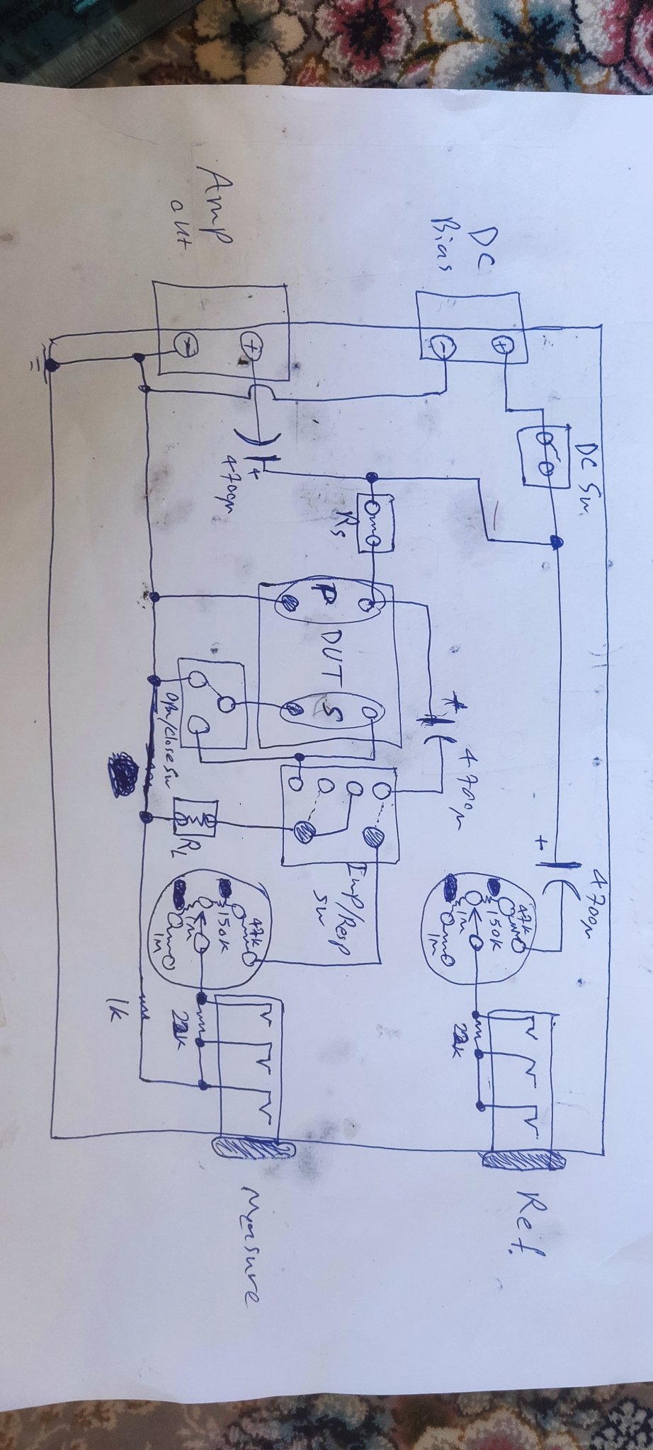

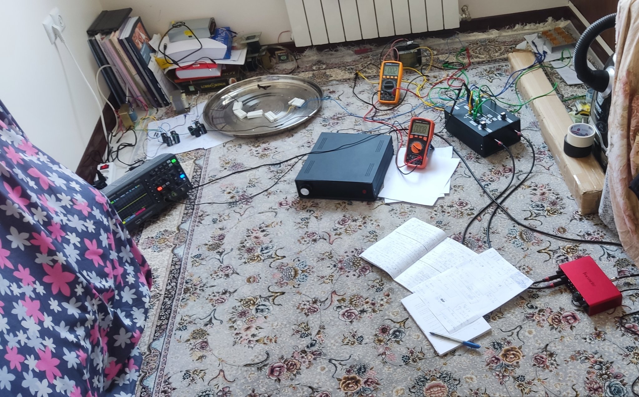

Hi Walt, yes I use REW with a jig which I built to measure both impedance and F Response of OPTs. I use Focusrite 2i2's headphones output for measuring Primary impedance, and for measuring F Response and Distortion I use reverse method using a 300W class AB amp and a DC source.
Here is a picture of my setup:
Reactions: waltube
I tested a lot of methods for measuring OPTs and finally I settled on this arrangement which I found it gives the most accurate results:
1. Primary impedance (both with open secondary and shorted secondary): Forward method using soundcard's headphones output.
2. Frequency response: Reverse method using a low distortion class AB SS amp with 1W of power and also max power on secondary winding.(Secondary Voltage = √(P out * R seris))
Also a DC current source should feed secondary winding and it should be equal to: Rated primary DC current * Turn ratio.
3. Low Frequency distortion(THD): same as frequency response with full output power.
4. High frequency distortion: same as frequency response except that DC current should not be present.
Reactions: DATIR and waltube
Can you clarify if the primary had rated idle DC current in any of your measurements? That would sort of seem to be a major comment to make about any testing, along with the signal voltage used (especially for impedance where low frequency inductance value is quite dependent on voltage as well as DC current).
You can enable component modelling for the impedance measurement, and that allows the inductance (or capacitance) to be calculated by REW at a suitable cursor location on the plot.

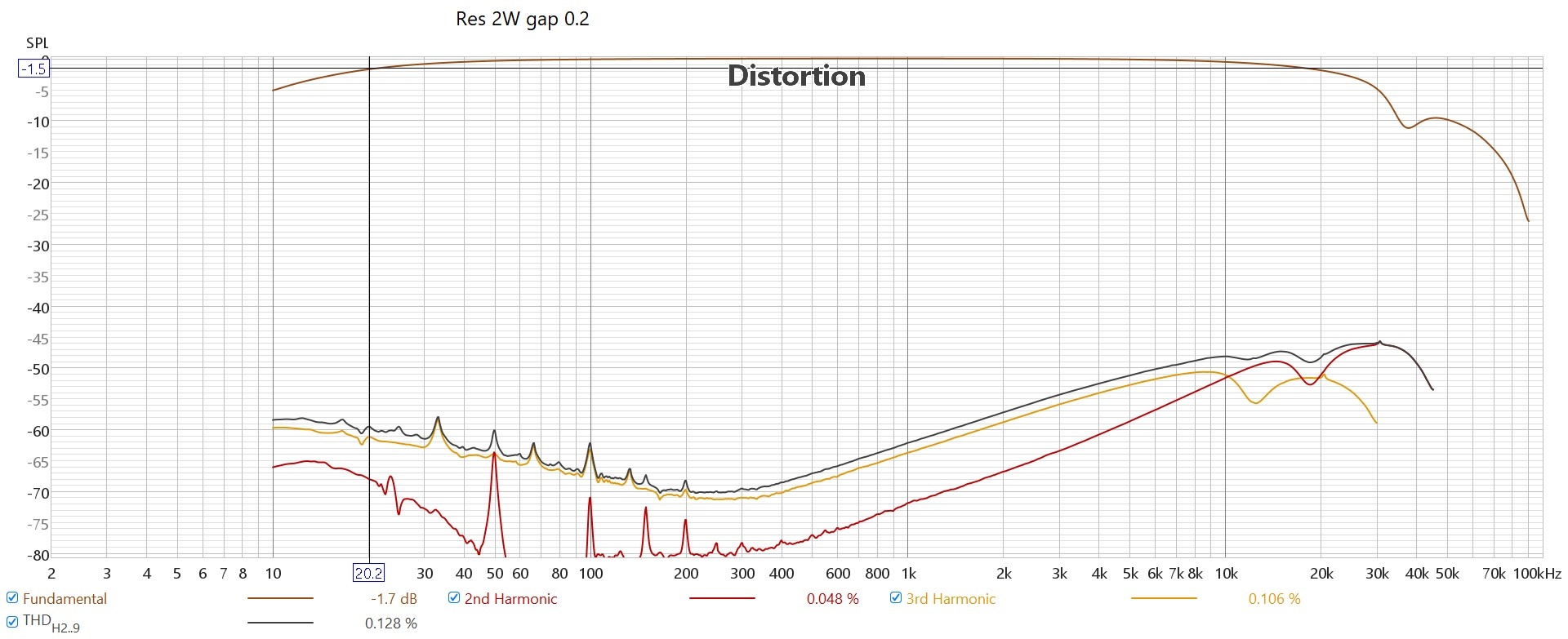

Perhaps better to show a distortion plot with just 2nd and 3rd harmonic levels, given you are wanting to show influence out towards the 34kHz resonance.
How does this OPT's primary shunt capacitance value (mid-band at circa 4-10kHz) compare to your previous builds, as well as the resonant frequency (and hence leakage inductance, given that REW may calculate a suspect value between 34kHz and 56kHz) ?
Are you planning to bandwidth limit the input signal to your amp, so that signal level above say 20kHz is being increasingly attenuated?
Also, the resonance centre frequency is usually defined at 0-deg impedance phase shift, rather than min impedance.
Ciao, Tim

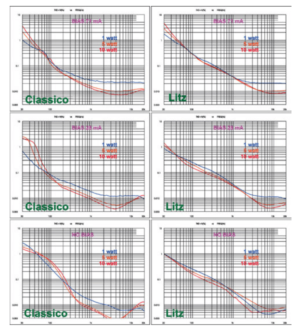

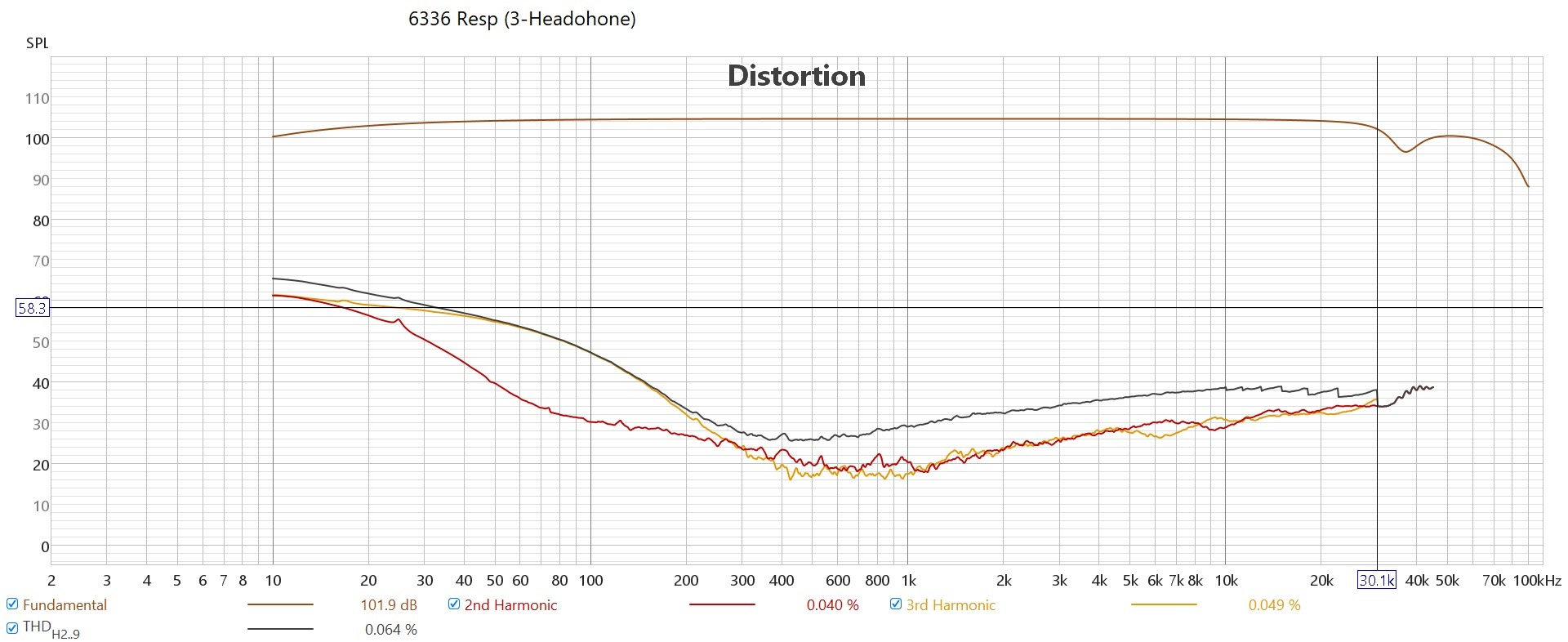

These are diagram of one OT with different dc idle current and power
Also no dc of bias.
Reverse mode but dc on primary side
Idle current is 71 and 28 mA
Another aspect is the response with entire circuit; some changes on resonace will happen but this is a good start point
Reactions: sajadho1988
Hi, I used 1.67A on secondary which equals to 0.1A on primary (my rated value for design), for testing F response and also THD. Primary inductance has been measured using Focusrite Headphone out and 0.7 excitation voltage and also I measured it with 5 to 25V from the SS amp without much difference in any point except that Low F which impedance got a little bit higher with higher excitation voltage, The impedance measurements I posted is from the Headphone Out.
Yes I saw it in other article you wrote about Willamson transformers. With 0.7V excitation voltage, Primary inductance measured 25H at 20Hz, 24.2H at 30Hz, 22.8H at 50Hz, and 29.5H at 1KHz before the parallel resonance. It is interesting that other excitation voltages from 5 to 25V also gave me the same results.
As for the Capacitance, my measurements showed 1nF at 10kHz and 1.2nF at 20KHz.
Also L Leakage was measured around 10mH at around 1KHz which I guess is a little bit high I guess, I used 4P:3S arrangement for this design and I used perfectly layered wiring as always, maybe the reason is that all the secondary windings arranged in series instead of parallel, I'm not sure..
Both LL and Csh measured higher in this build compared to my previous builds. I normally get around nominal Z value in mH for LL which should be 2.5H in this case and I'm not sure why it turned out so high? As for capacitance I expected this number in my design because of the wide window of double C-core I used for this.

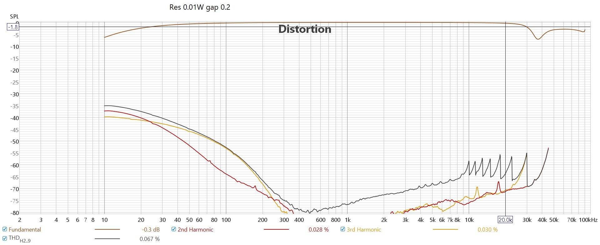

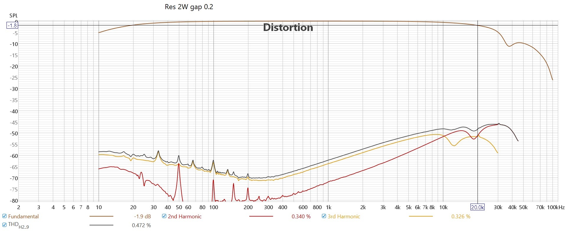

I will attach them in the bottom:
Also no dc of bias.
DC bias is a very important aspect in measuring F Response and Distortion of SE transformers as described by Patrick Turner in this article:Link
in figure 12 of this article he described the reverse method and DC bias.
The issue with adding DC bias to primary is that you need a very high impedance DC current source so it won't load down the primary, but if you use equivalent DC current on secondary you will need only around 48V DC voltage source and enough resistance to provide the current.
In the following I will attach my testing jig layout if you're interested:

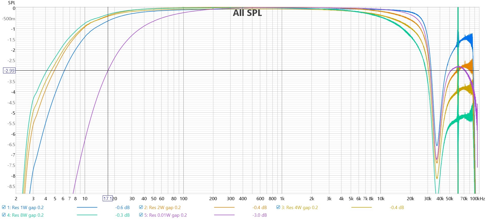

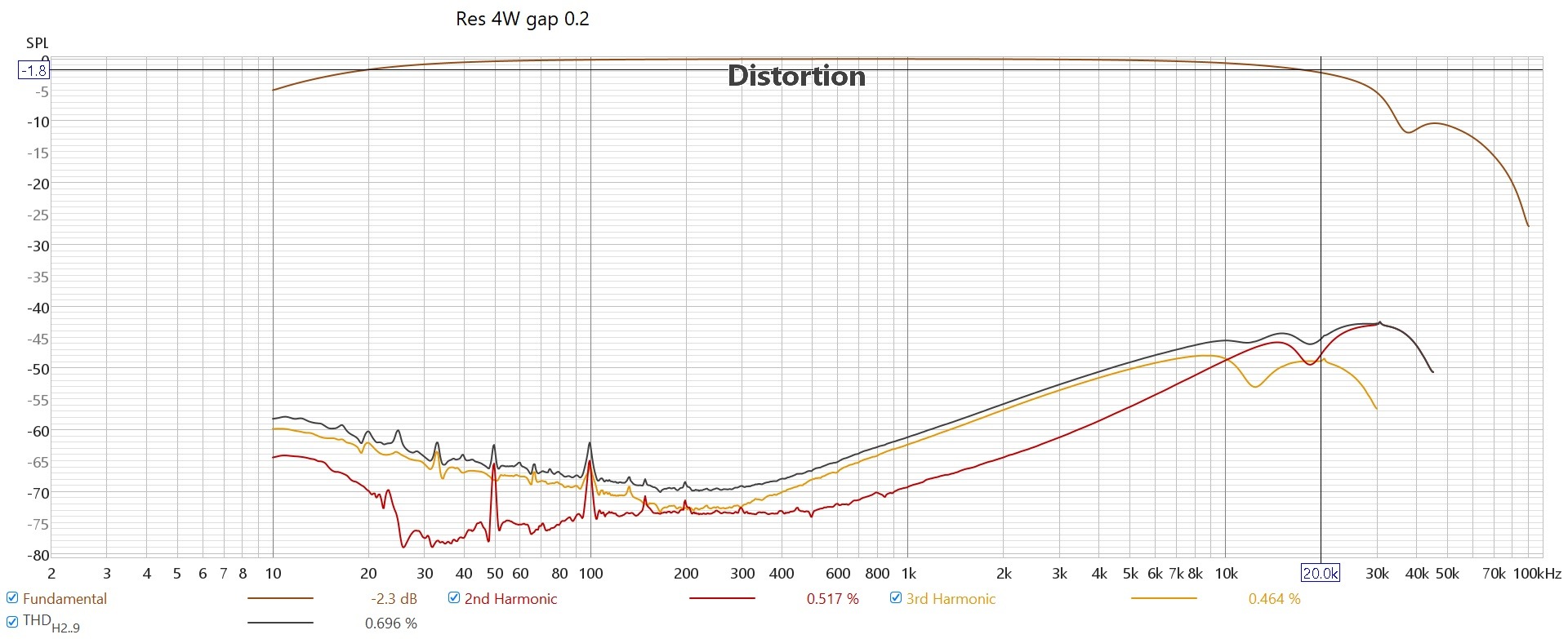

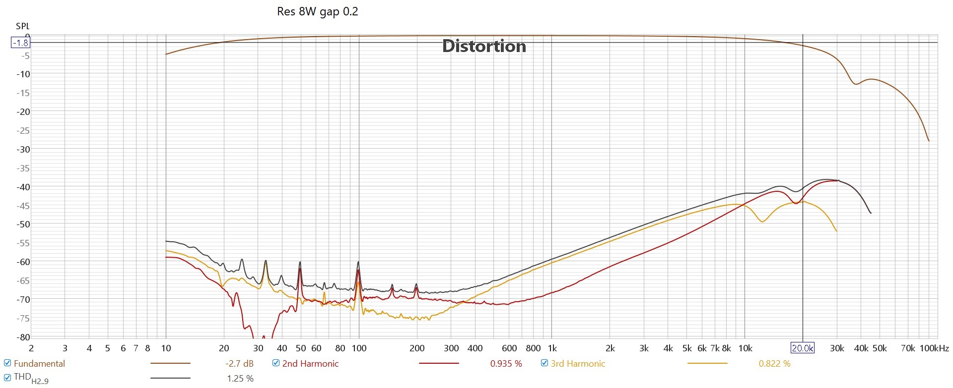

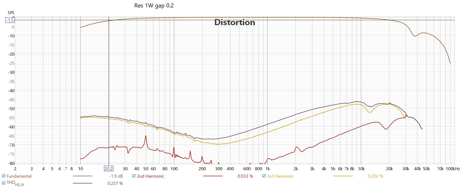

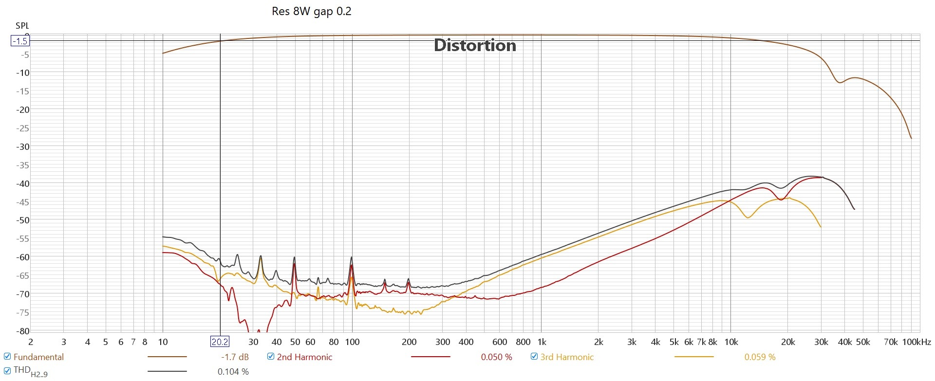

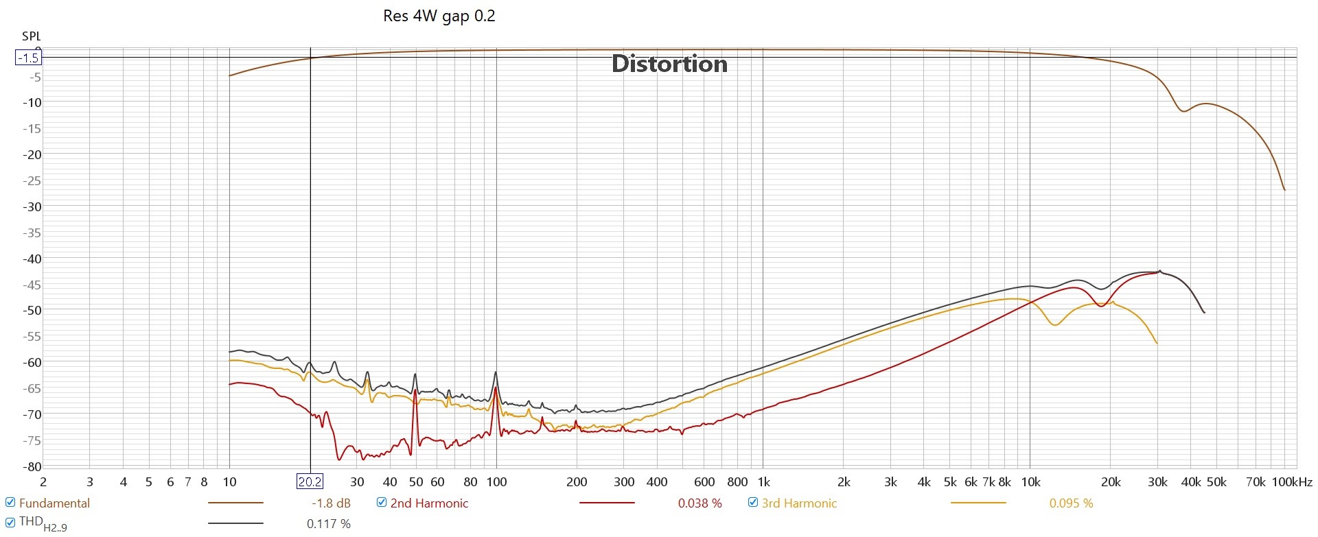

Here is something that you might be interested in ; I did some F response measurements using different output power levels (0.01W, 1W, 2W, 4W, 8W):
As the output power increases, Low F response gets better which I guess is due to higher core permeability resulted from higher excitation voltage. Another thing is that Hi F response gets worse with increasing the power, which I can't find any reason related to the transformer, what's your opinion on this one?
Also here is THD measurements on different Power levels:
As you can see Low F distortion gets lower with increasing the power which is odd to me! Also high F distortion gets bigger with increasing the power, and the reason to this one is also unknown to me...

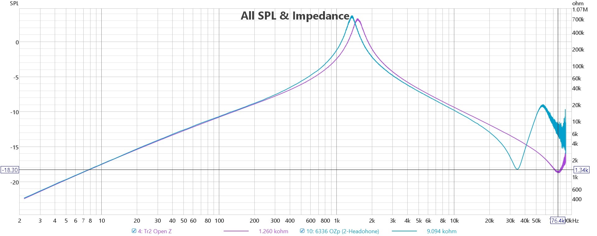

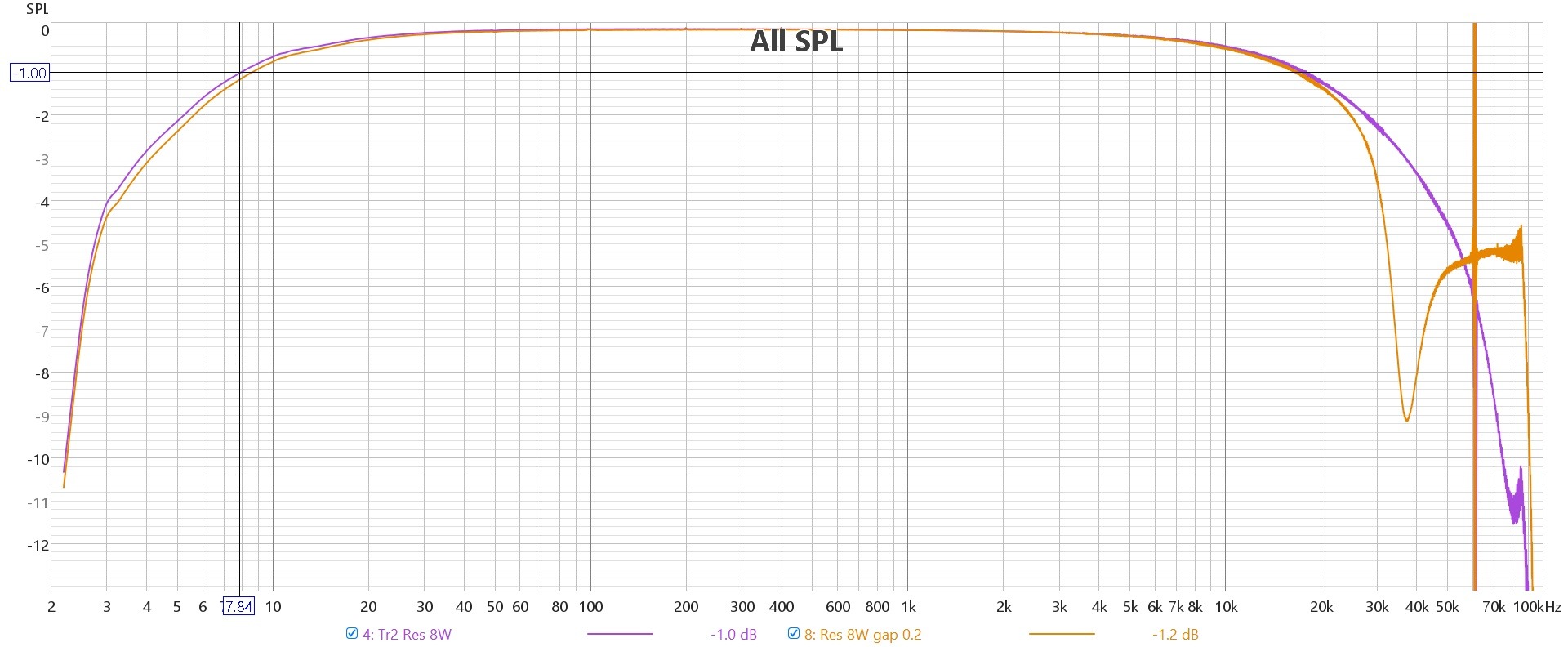

Hi again, I found something interesting; I wound another bobbin for this transformer with everything exactly the same, but another winding arrangement. This time I put all the secondary windings in parallel and the high frequency resonance changed dramatically from 37KHz to 72KHz!
The original arrangement was like this: 4P - S - 6P - S - 6P - S -4P (with secondary windings all in series).
The new one is with the same number of turns, but the arrangement is like this: S - 6P - S - 8P - S - 6P - S (with all of the secondary windings in parallel).
Here is the primary impedance comparison of the two transformers: (the purple graph is for the parallel arrangement)
And here is frequency response comparison at full output power with DC bias: (the purple graph is for the parallel arrangement)
