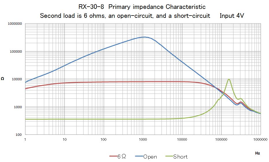

This is not correct and is quite common mistake. Transformers do have a finite impedance when unloaded. The ideal transformer would have infinite and frequency independent inductance (and thus impedance) but real transformers don't.Usually the descriptions tell the reader that a transformer is an impedance changing device, and the windings don't have an intrinsic impedance of their own. It's only when a load is connected to the secondary that the primary then has a defined impedance. We are told that if we connect an 8 ohm load to the secondary, the primary will then exhibit an impedance equal to 8 times the impedance ratio.
In the attached picture you can see the primary impedance when the the secondary is open (blue), loaded with 6R (red) and shorted (green). The shorted secondary test is usually done to determine the self resonance which is that peak appearing at high frequency.

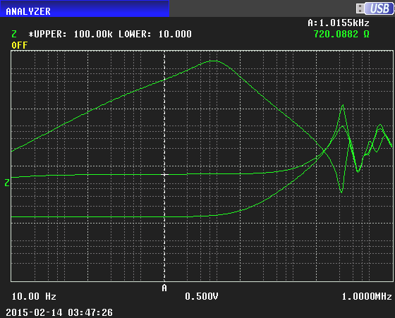

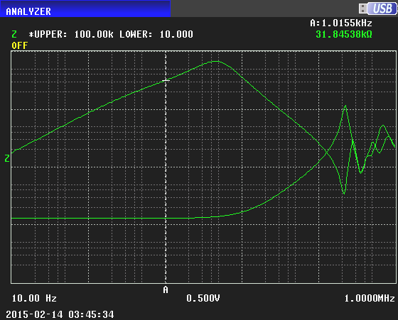

Much can be learned from impedance plots of transformer windings.
Here is a plot of the primary impedance (magnitude) of an Edcor WSM600/600 transformer with the secondary open and then shorted. This is a line transformer with a 1 to 1 turns ratio, rated for 600 ohm impedances. The plot is logarithmic in both x and y directions, with 10 Hz at the left (the marker A at about 1 kHz), 1 MHz at the right, 10 ohms at the bottom, and 100k ohms at the top:
The upper curve is the impedance with the secondary open circuited, and the lower curve is with the secondary shorted.
The important thing to recognize right away is that no matter what load (excluding capacitors) is connected to the secondary, the reflected primary impedance curve must be below the upper curve in the above image, and above the lower curve.
It is the parasitics, core losses, copper losses, distributed capacitance, finite inductance, etc., that result in the boundaries represented by the upper and lower curves in the impedance plot above.
Here's another impedance sweep, with the rated 600 ohm load connected to the secondary. The middle curve is the impedance reflected to the primary. We see that the reflected impedance at 1 kHz is about 720 ohms, which is reasonably close to the desired 600 ohms:
I'll have some more to say about this transformer.
