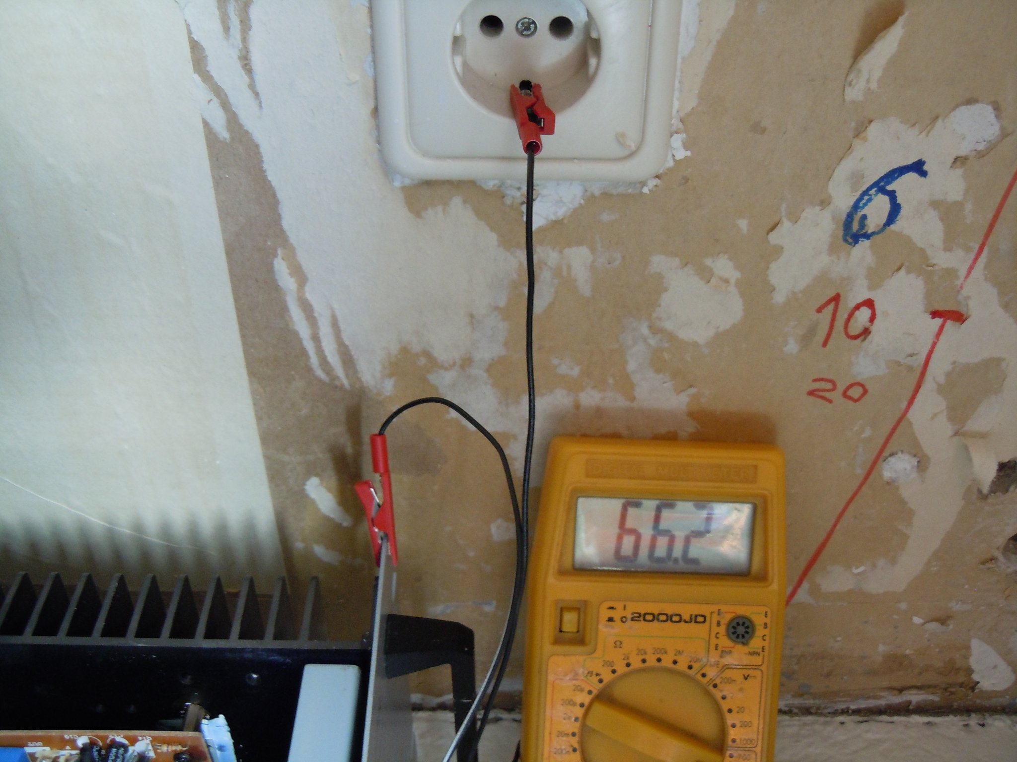

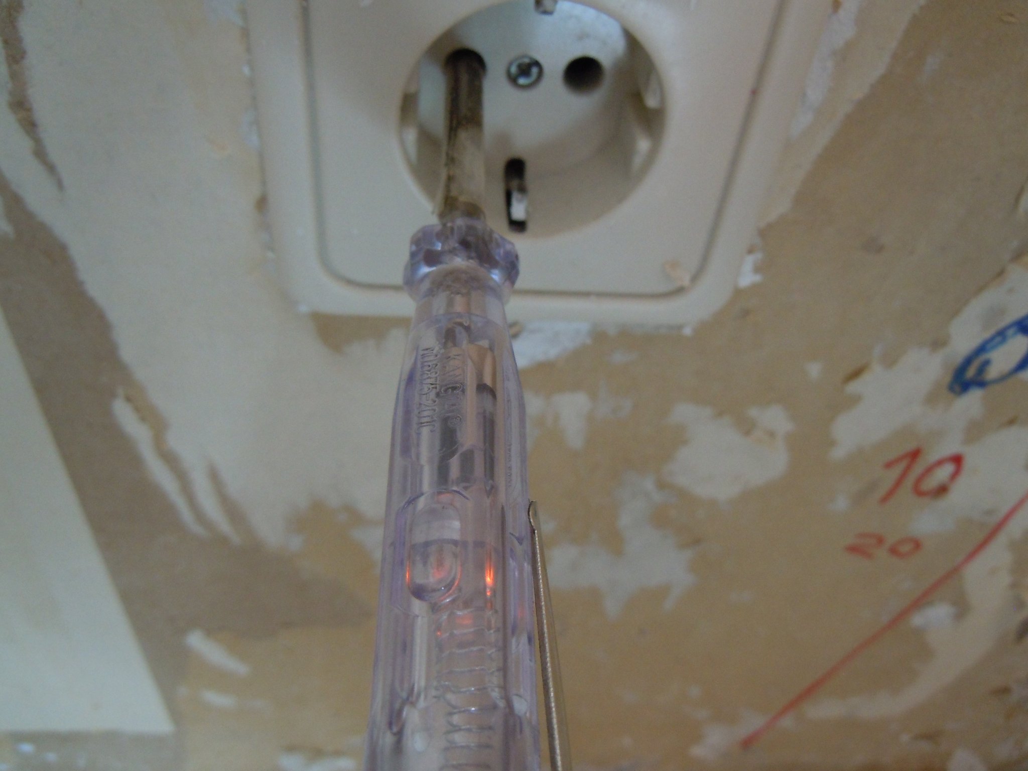

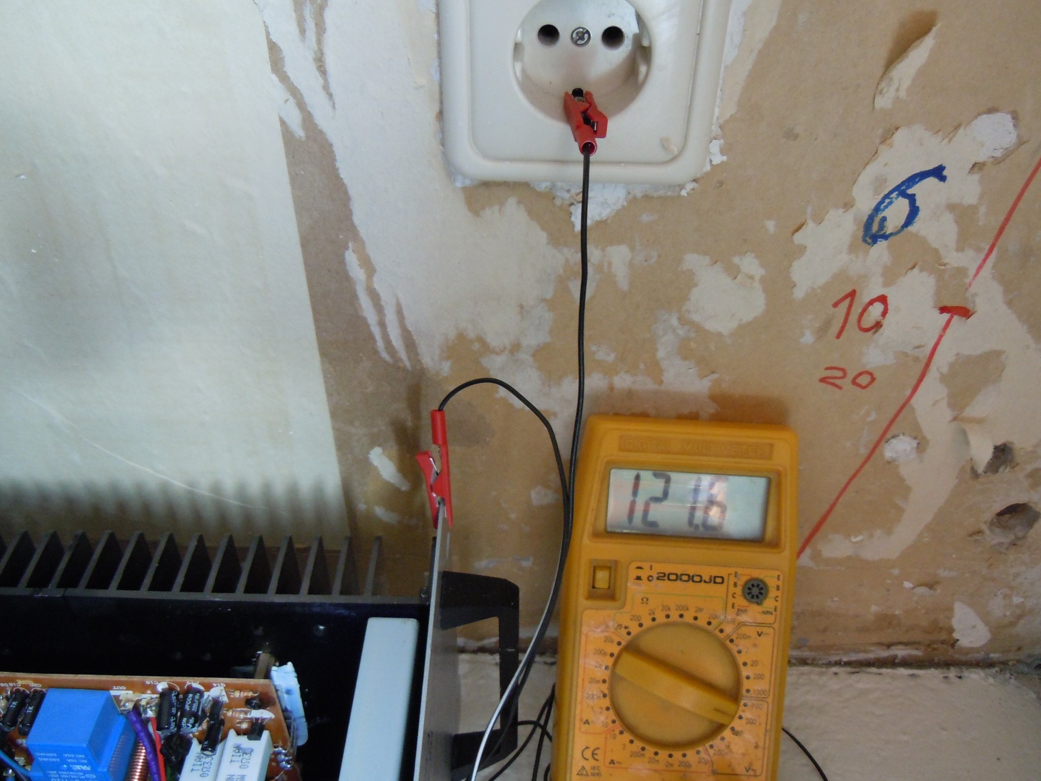

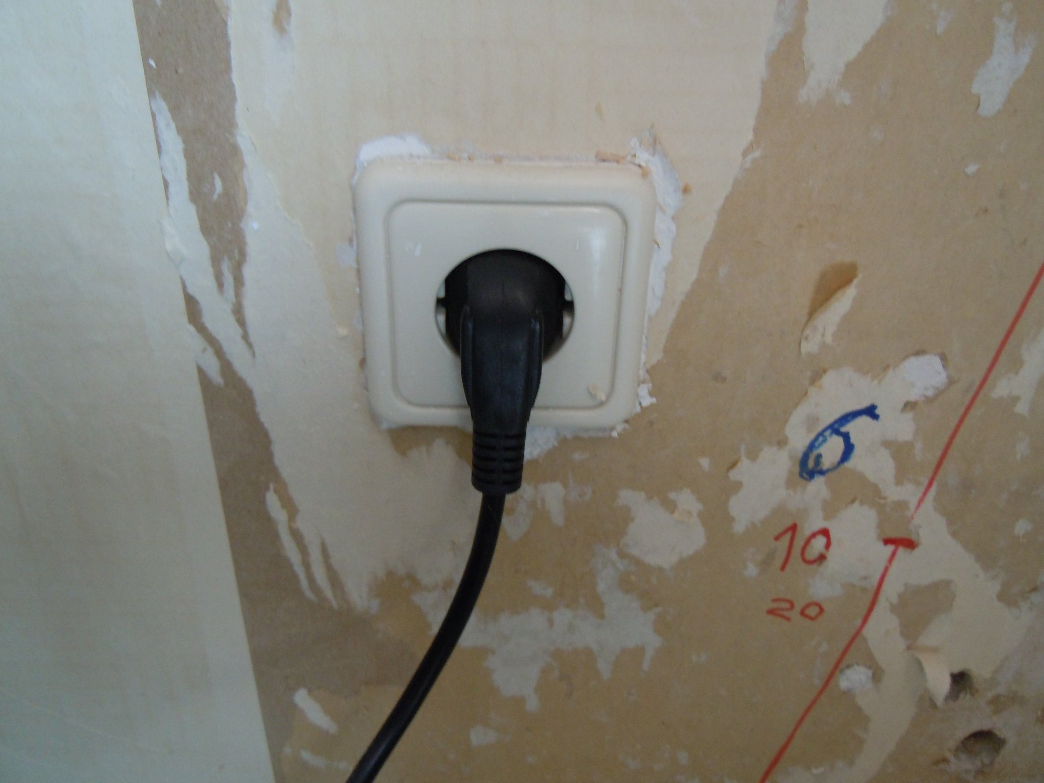

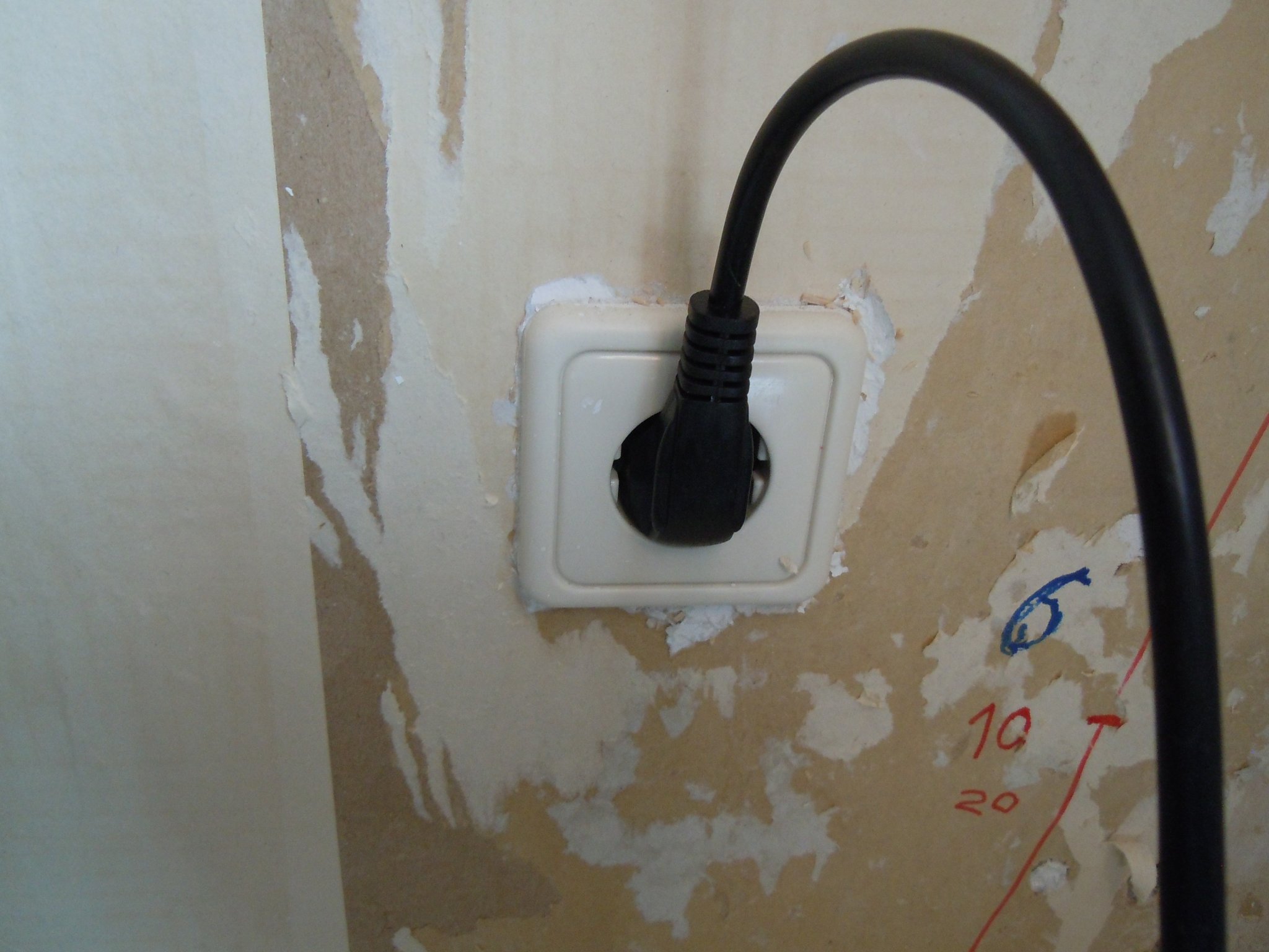

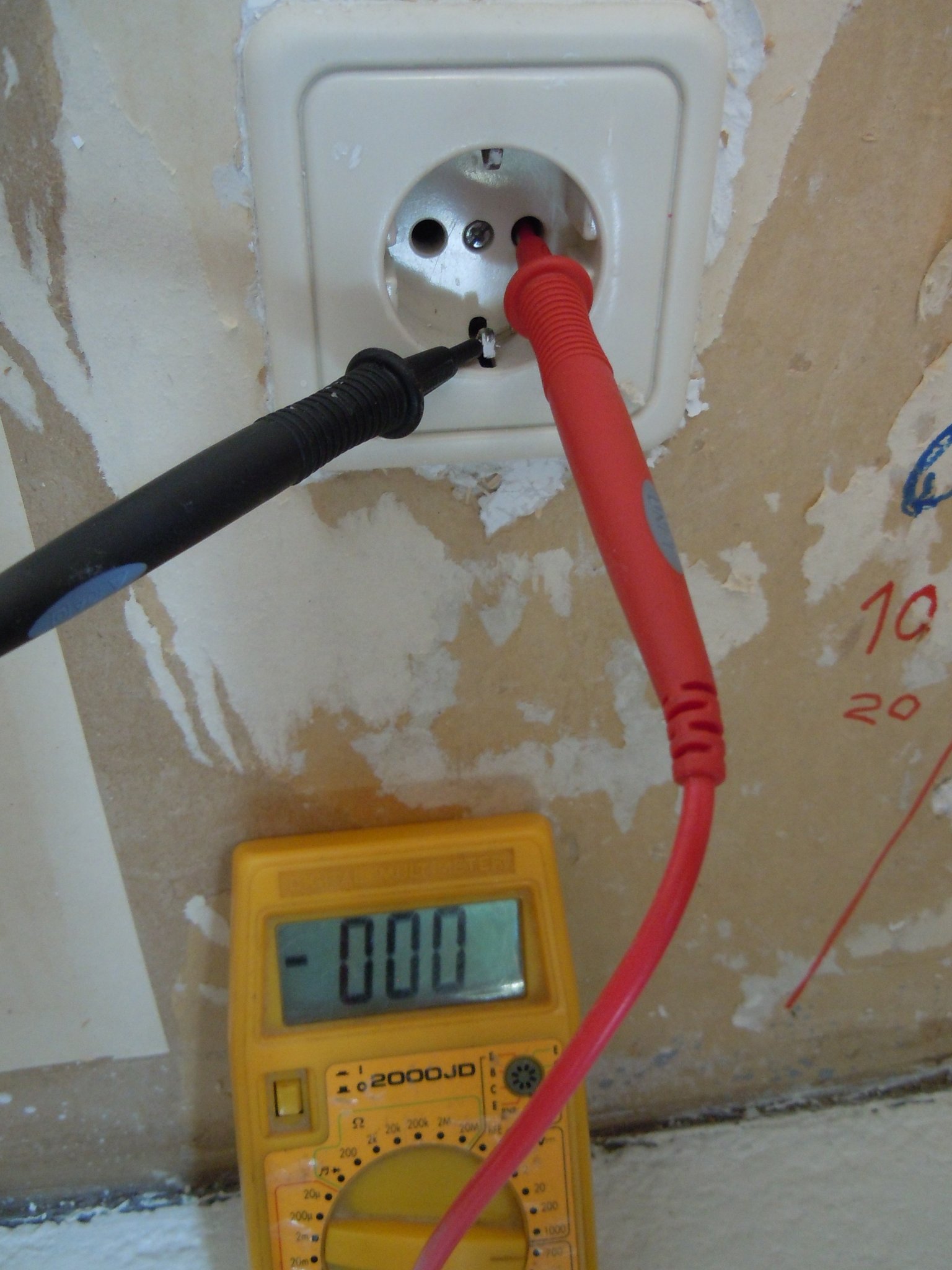

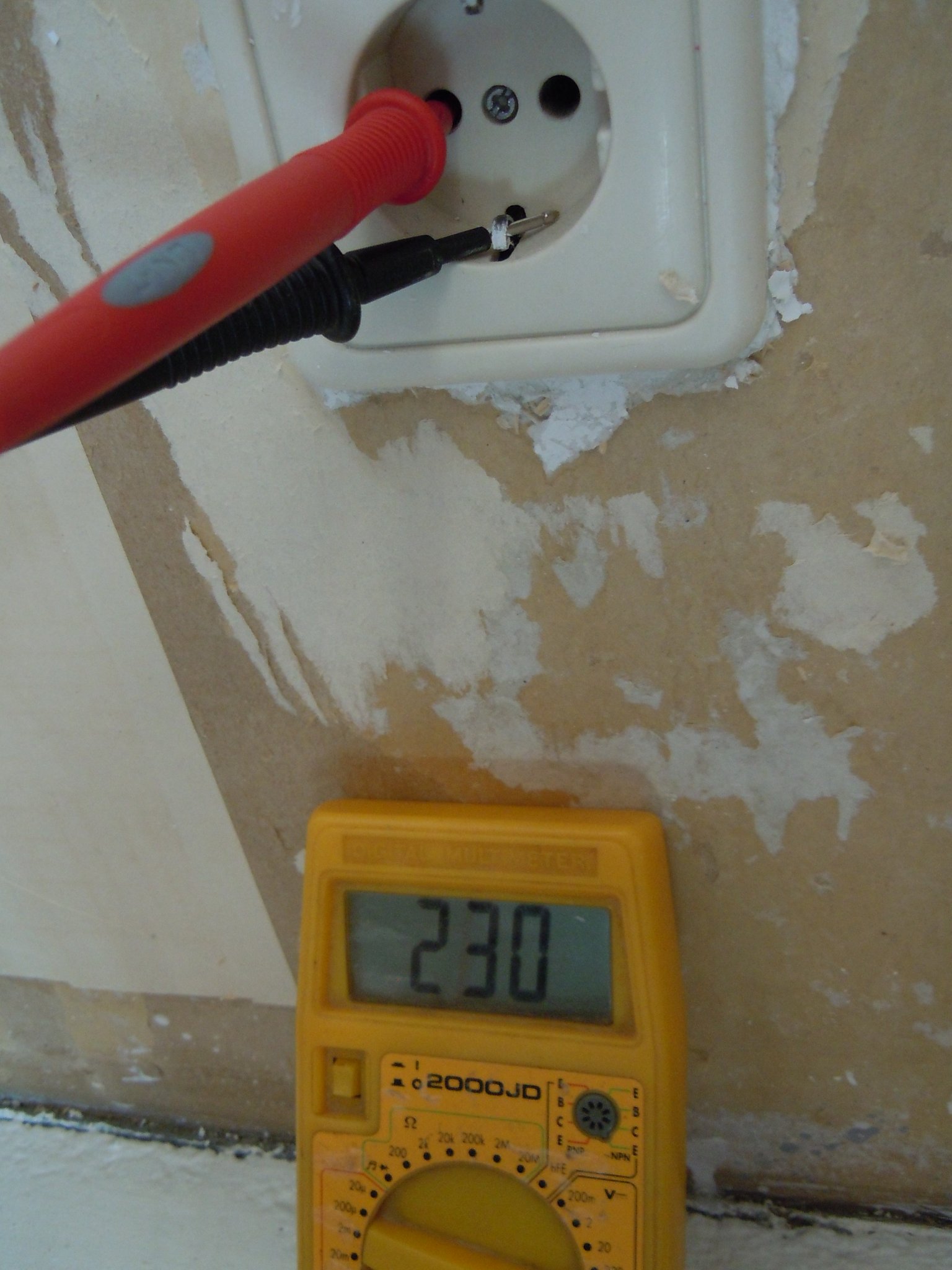

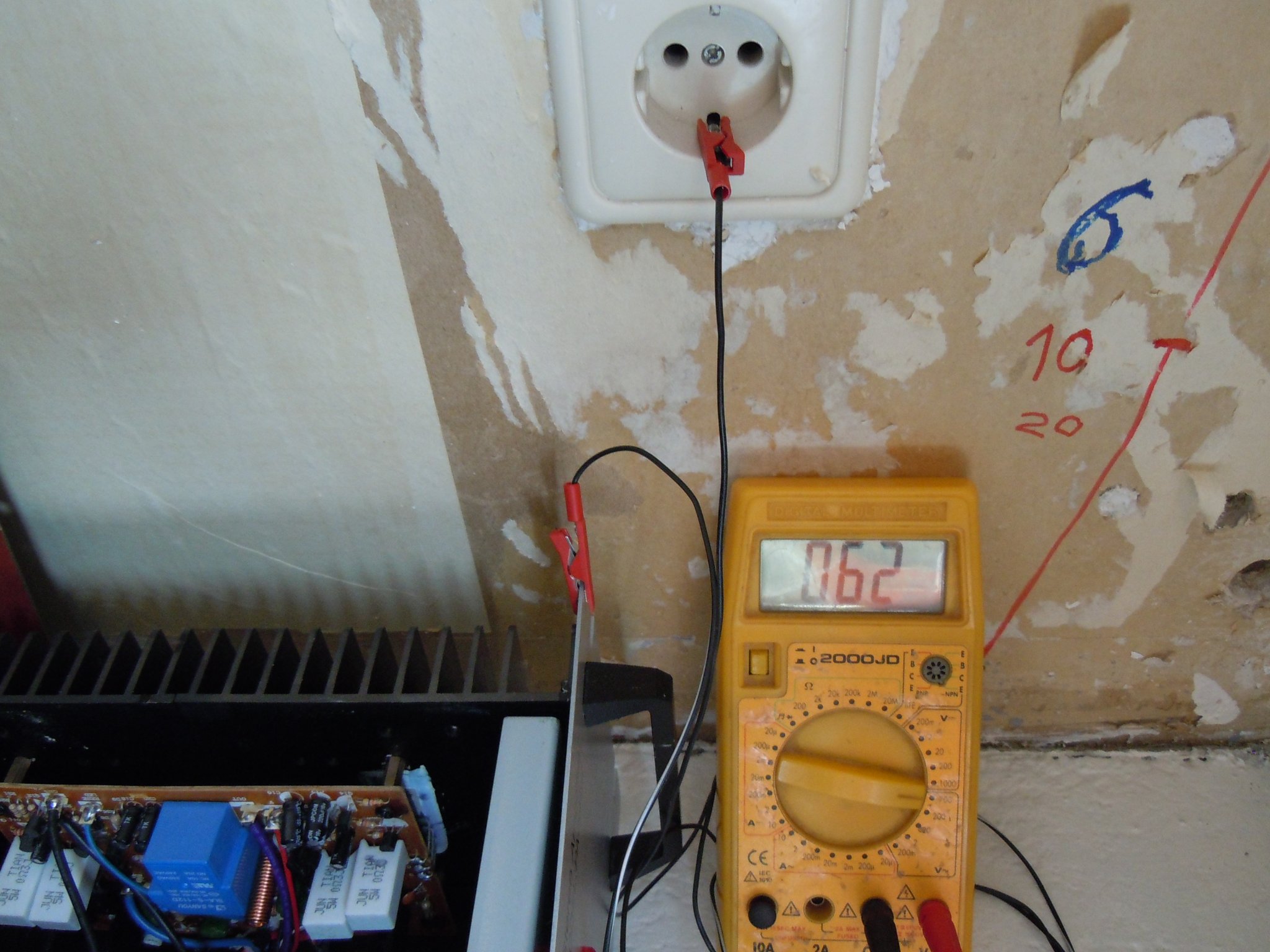

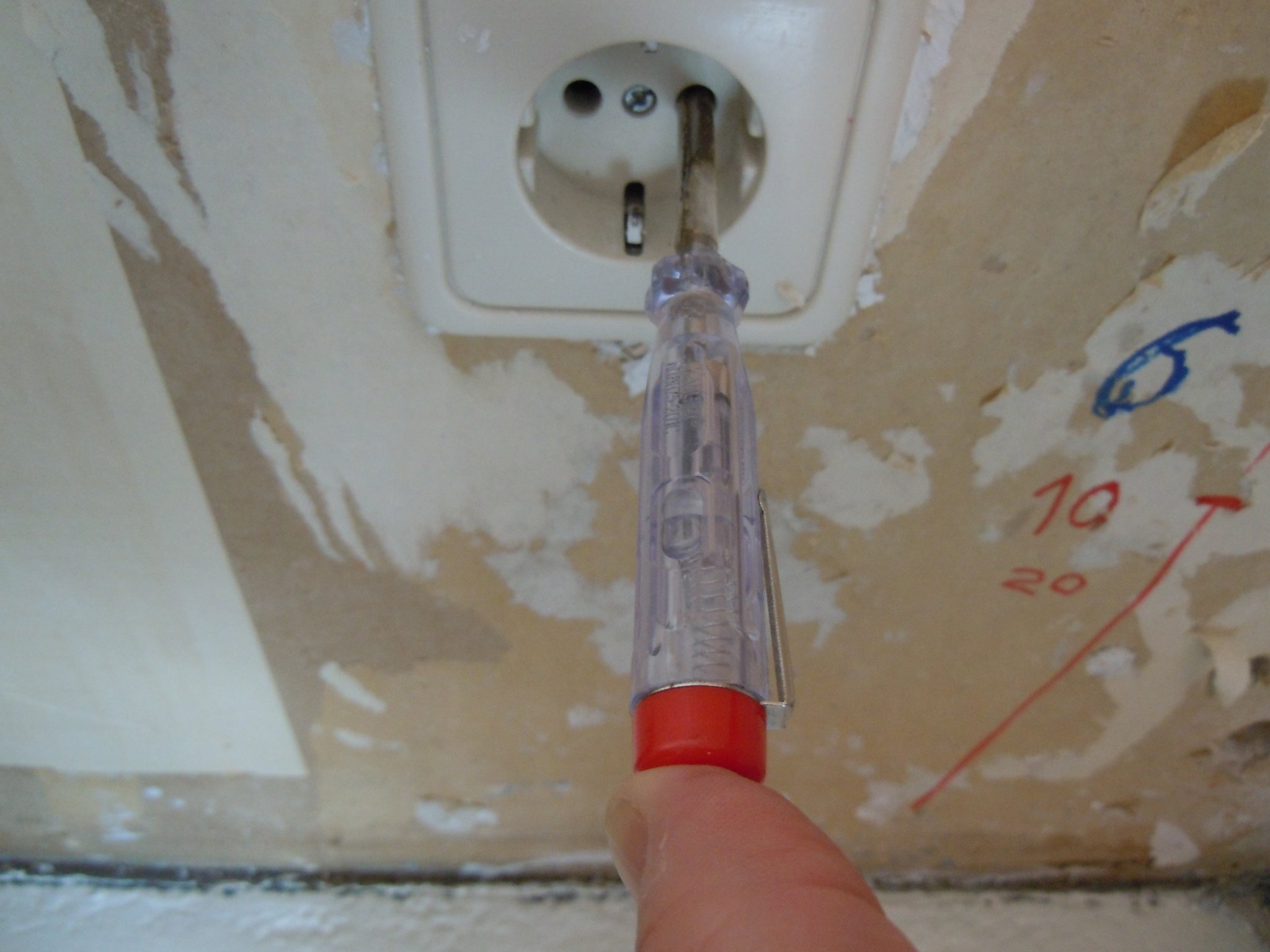

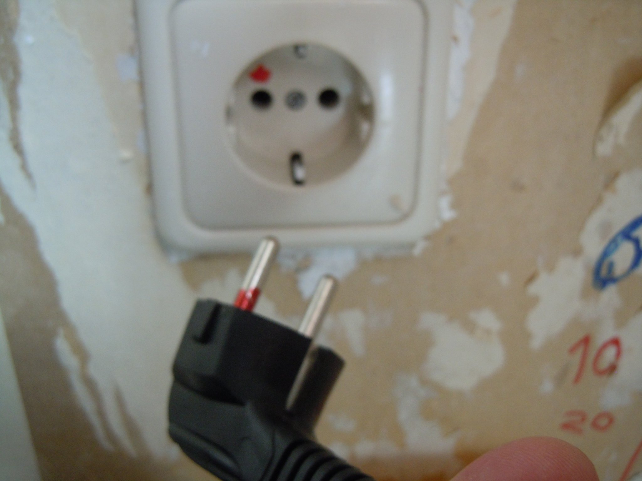

And here is the beginner's guide:
In many European countries, the socket outlet has 3 connections: the earthing visible on the outside, and the actual power conductors. In most cases, only one of these is live, the voltage-free one is the "neutral" conductor. This can be measured using an AC meter or a "phase tester" (e.g. some screwdrivers). And depending on how the device is connected here (2 possible positions of the mains plug), it
a) builds up an electromagnetic field of varying strength (measurable by AC meter - connect between housing and earth, but remove here the earth connection of the device), here 61 VAC wihout power, 122 VAC and 66 VAC with power, and
b) it sounds different.
I leave it up to you to test and listen! The difference should be clearly audible - it corresponds roughly to the comparison between ONE psu and channel separated psu: "dual-mono psu"-)
I also advise to mark the phases on the sockets and plugs.

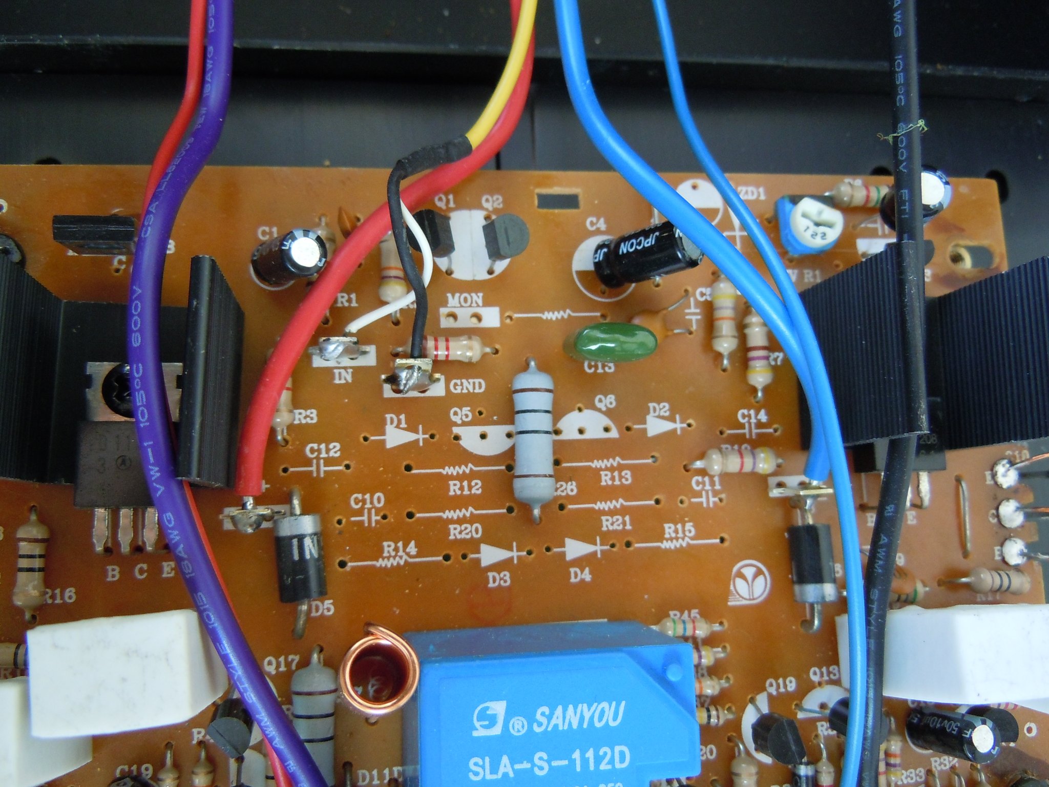

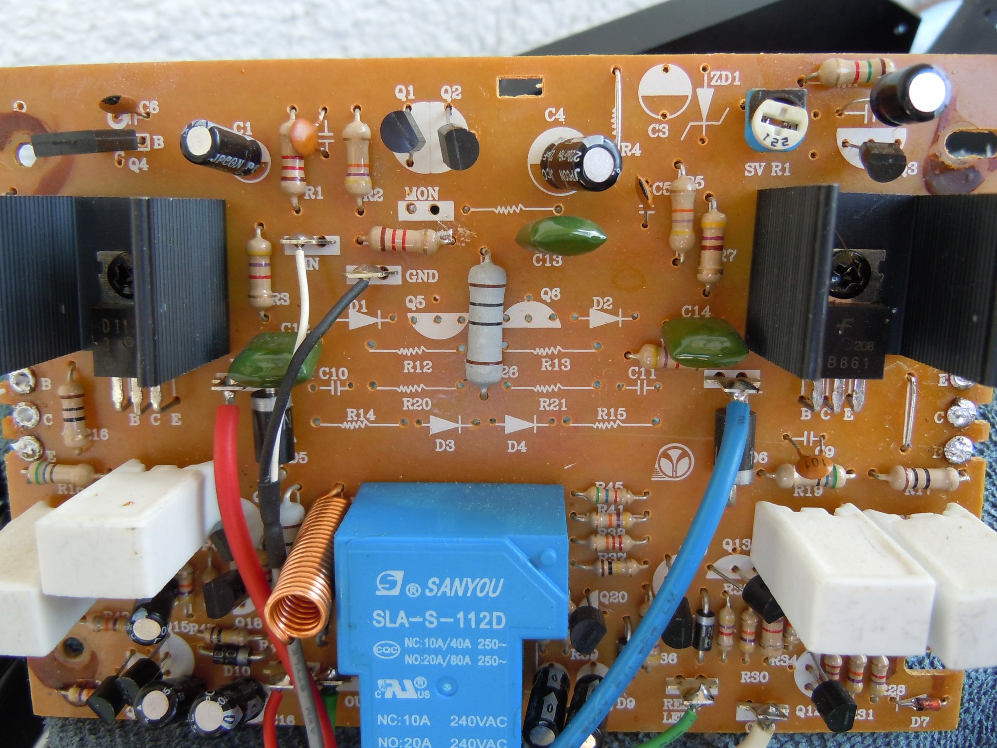

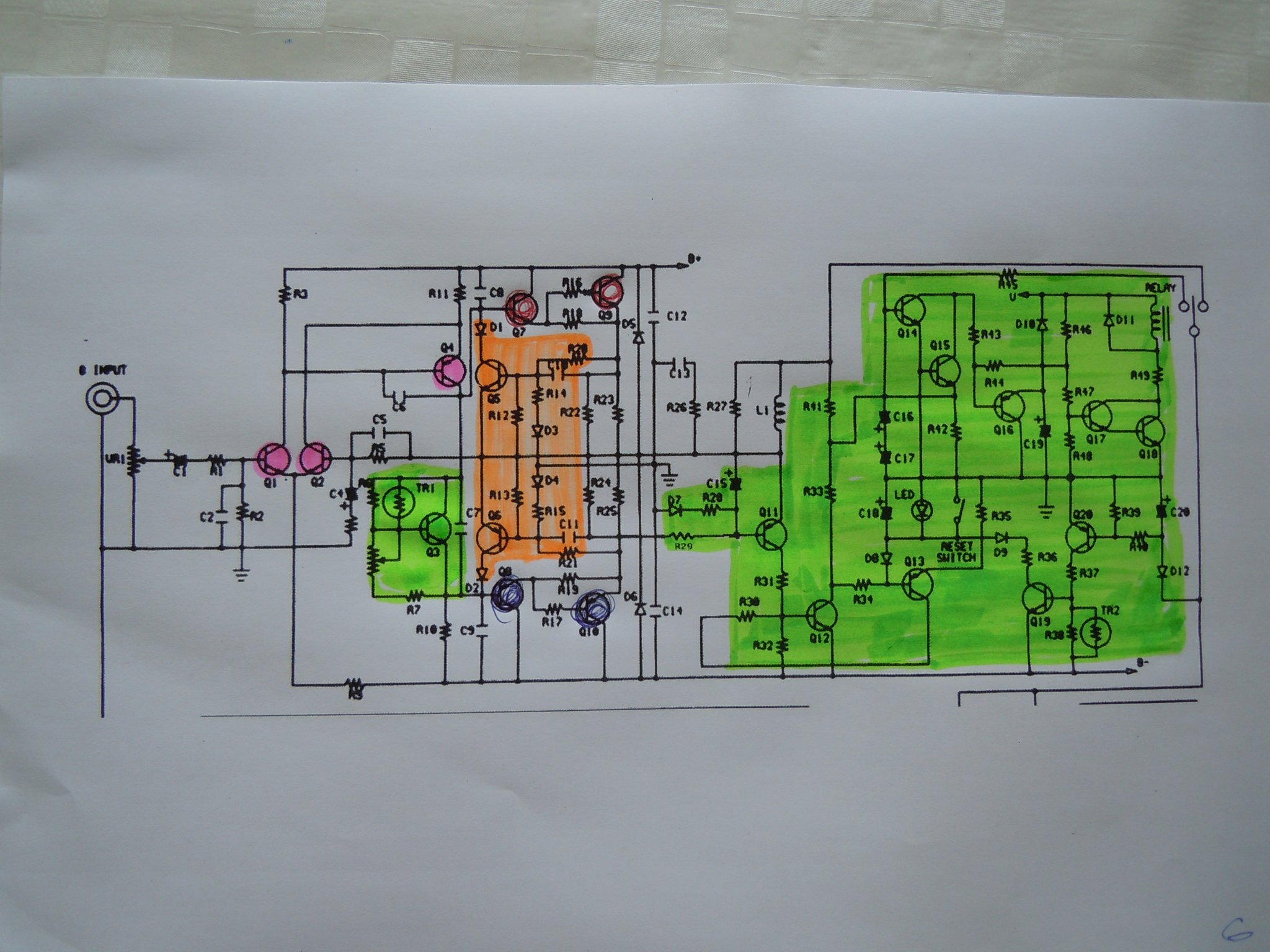

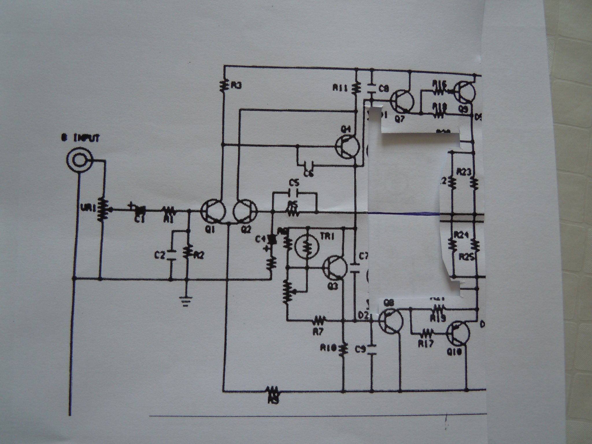

Here is a quick overview of the circuit
I have copied and marked the circuit:
Preamp: 2 stages, 3 transistors pink,
Power amp 2 stages pp follower: 4 transistors: 2 red positive half-waves, 2 blue negative half-waves,
the green box on the left is the bias control. You can see that the signal for the negative half-wave has to pass through, i.e. it is modulated by a component network - "nonlinear" too. A bypass capacitor with a low cut-off frequency < 20 Hz, which also sounds as neutral and clear as possible, must be used here. If you have such a half-wave unsymmetric pp circuit, you can do the same. Here C7. I replaced with KS-A 220 uF, 6 V meanwhile.
The orange box is a current limiter, which will be removed.
The large green box on the right is the protection circuit and switch-on delay.
I cut out the pure amplifier: fantastically simple circuit;-)

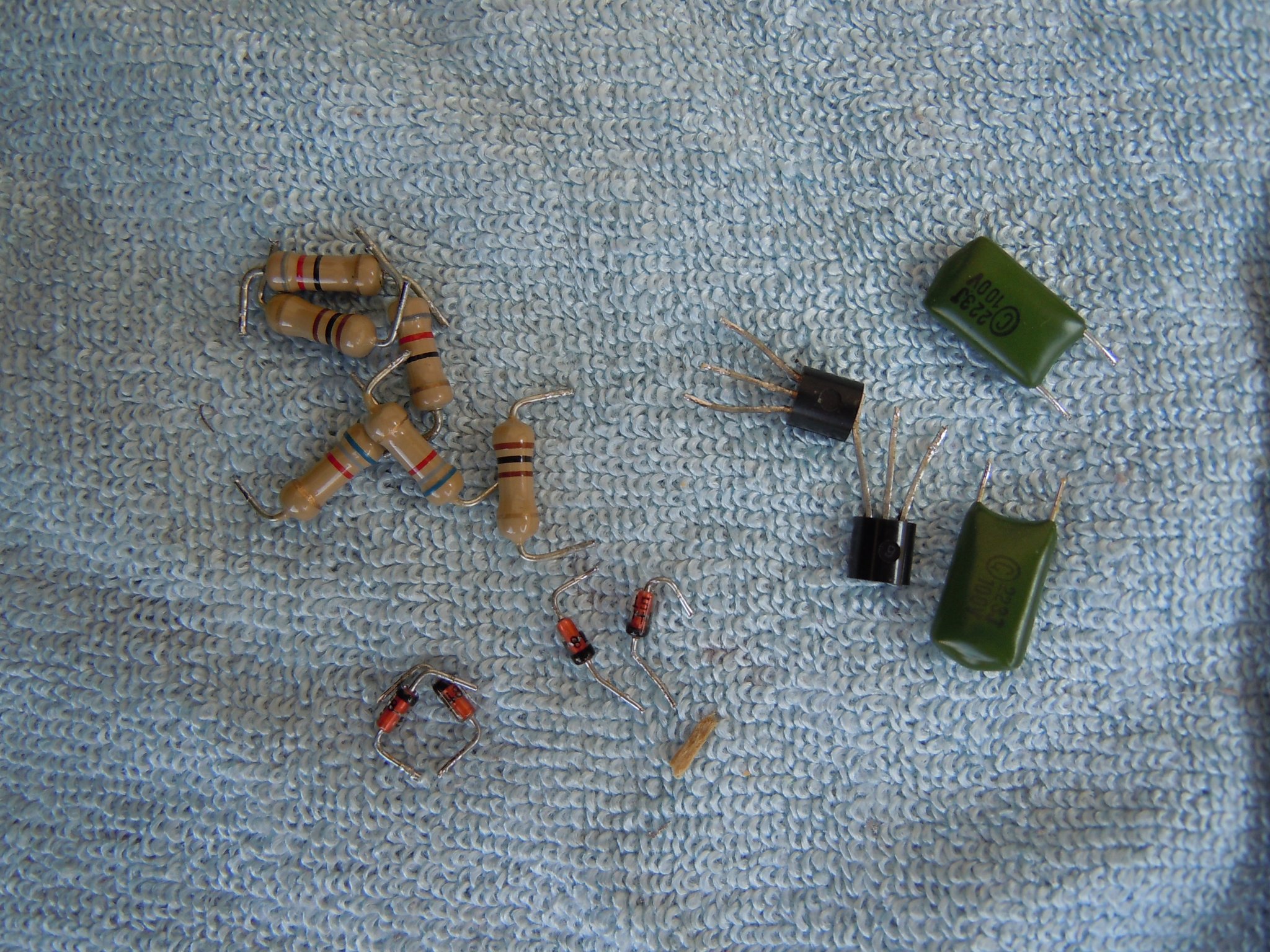

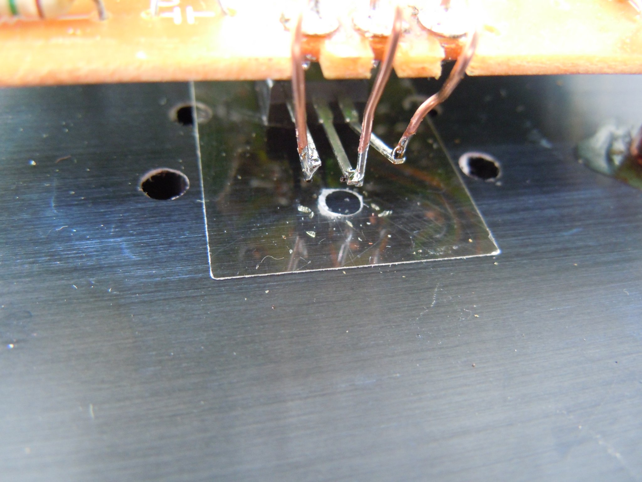

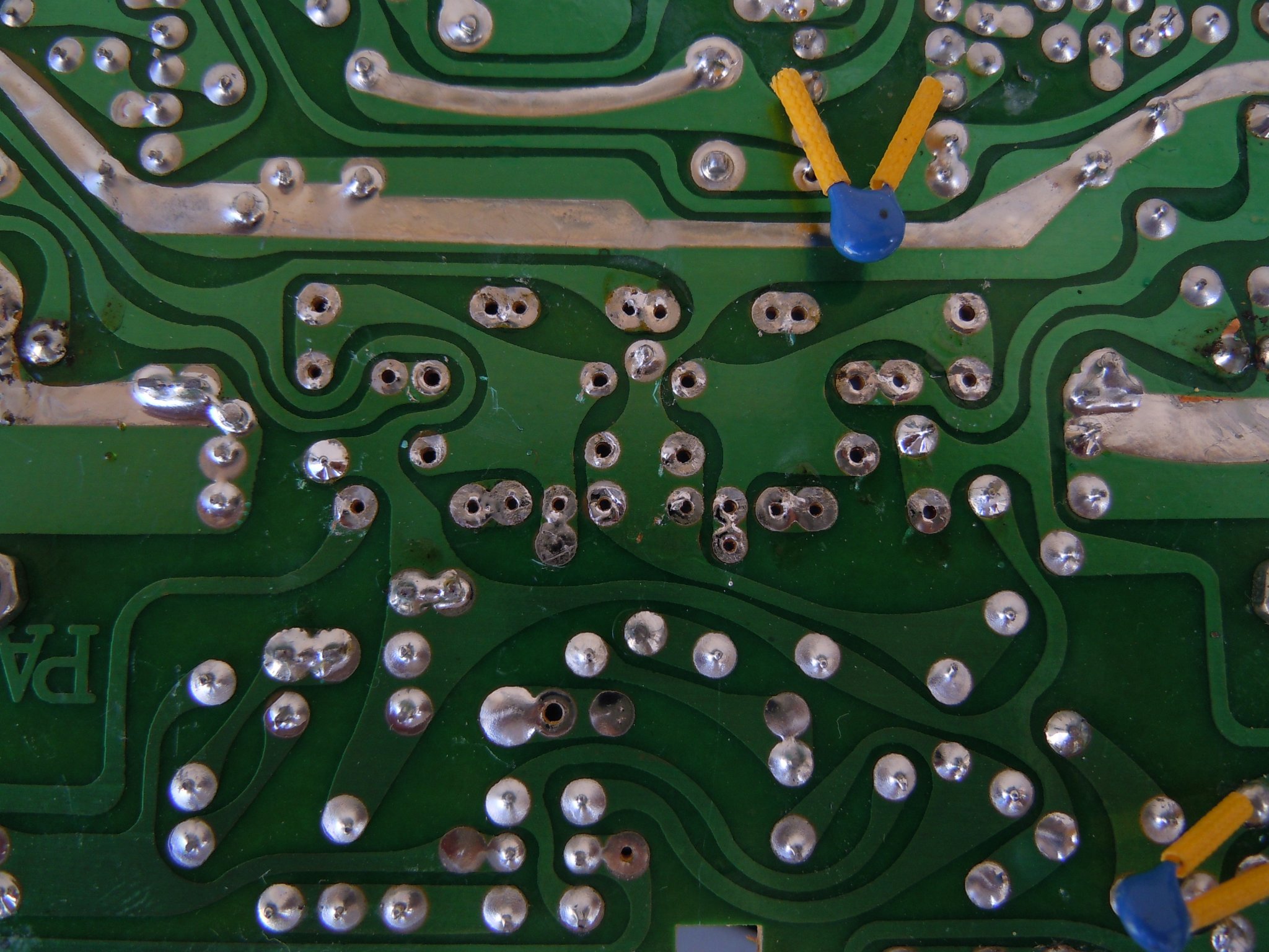

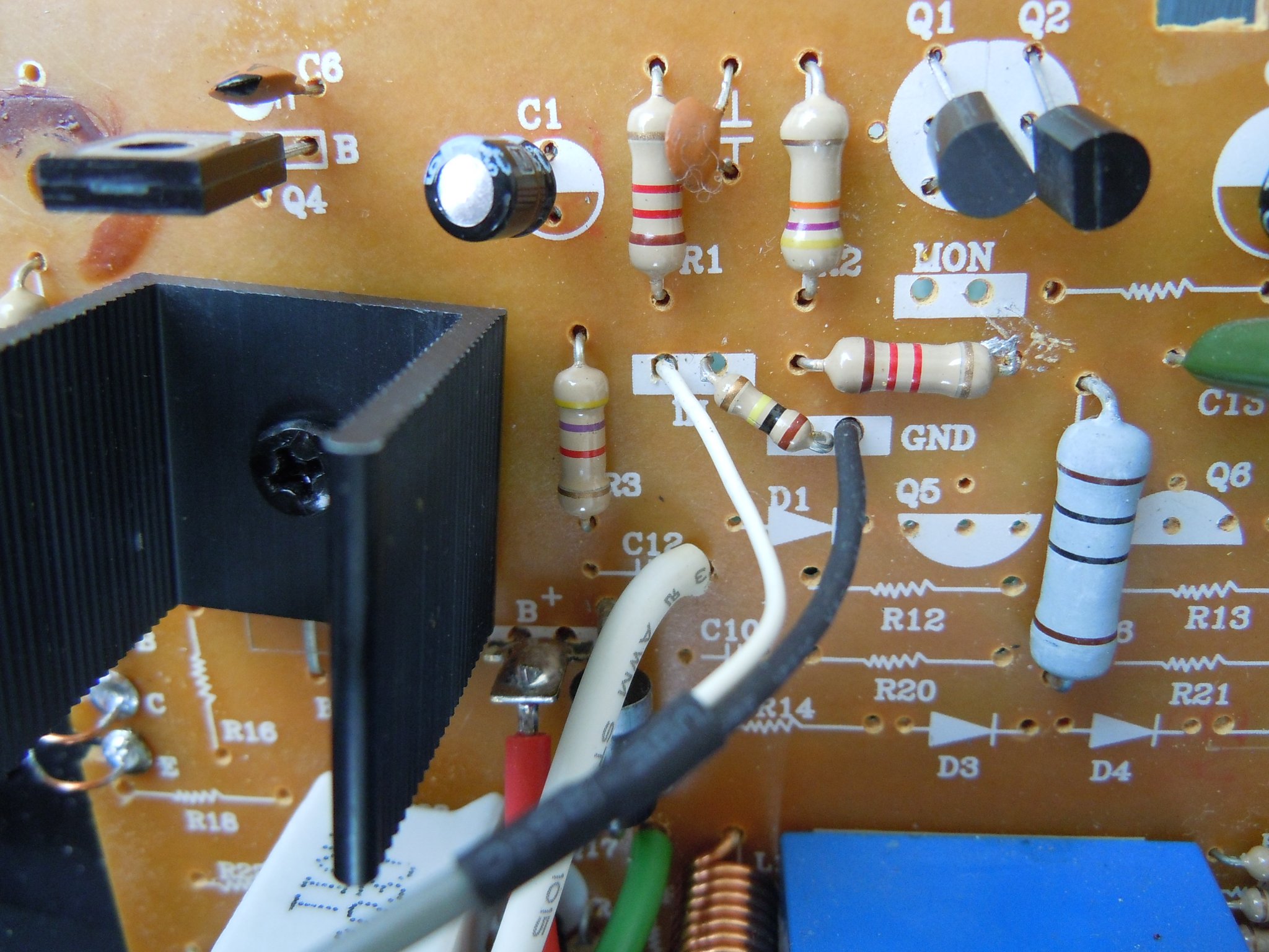

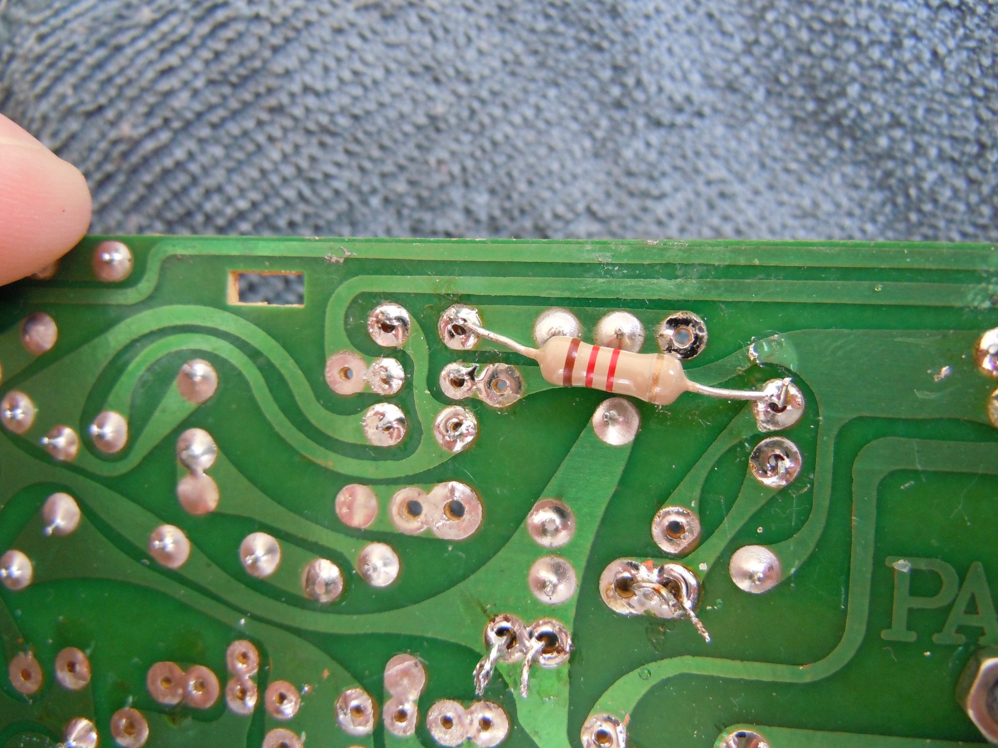

I quickly found time to do something:
First of all, I set up the amplifier with 4-fold shielding and grounding so that I, frequency and electro being, can listen for a longer period - and the neighbours too;-)
I have removed the current limiter: the sound afterwards is more full-bodied, stripped down, less hiss, less noise, more fluid. These current limiters can also be found in many other Amps: Naim, for example, or Obelisk - I have the 300 (Titan). The same disease - our developers obviously don't even listen to what they are fiddling with!
In the next step C 12, C 14 removed: further de-stressed, the bodyness and contour increase, cleaner.
Then R 23 and R 25 are removed, so that the emitter resistors are 0.3 ohm instead of 0.15 ohm: this also sounds more pleasant, the dullness and flatness of the end transistors especially is reduced: the speakers do not get the gray and flat sound impressed on them.
I recommend soldering short wires to the board to avoid bending the legs of the end transistors due to frequent board movement - see picture.
Now the thing is finally in a range that is listenable and really fun: clean gliding through sound images, e.g.:

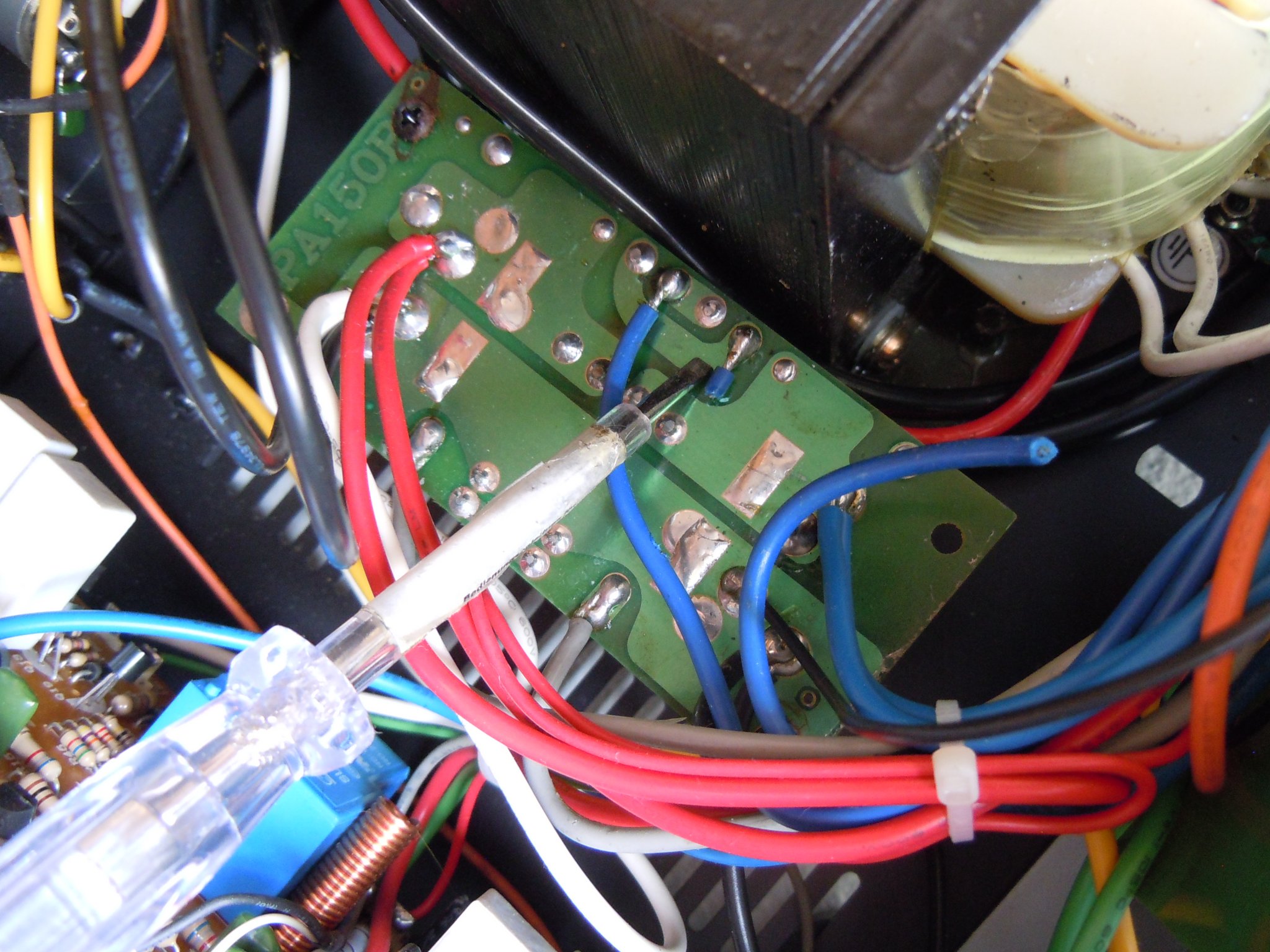

One thing I also did at the beginning: disconnect one of the two secondary windings of the trafo. To start with, I recommend unsoldering it, then listening to it, soldering it back on, listening to it, and so on until you are sure which sounds better, i.e. cleaner.
If this amplifier had channel-separated power supplies, I would instruct you to connect them, listen, disconnect, listen, reconnect, listen until you know which sounds cleaner;-) But this great device already saves us that;-)
Screwdriver points to one of the two windings, which are here blue cables on the circuit board.
The three steps alone: correct phasing of the mains plug, removal of the current limiters and this secondary winding story elevates the device into a range that shows how open and free it sounds when only about 10 components are working as a SE voltage amplifier and only about 10 components for a push-pull power amplifier. There is not much modulation per parts, the sound is not dense or dark or technical. This is a far from what you can buy - regardless of price;-)

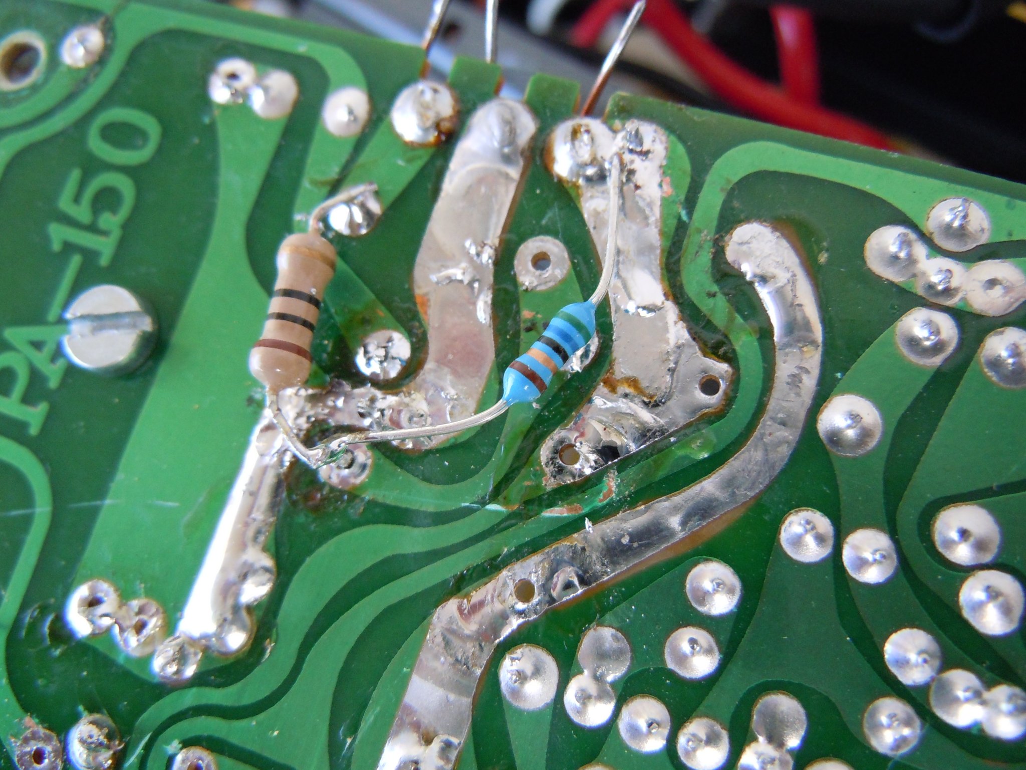

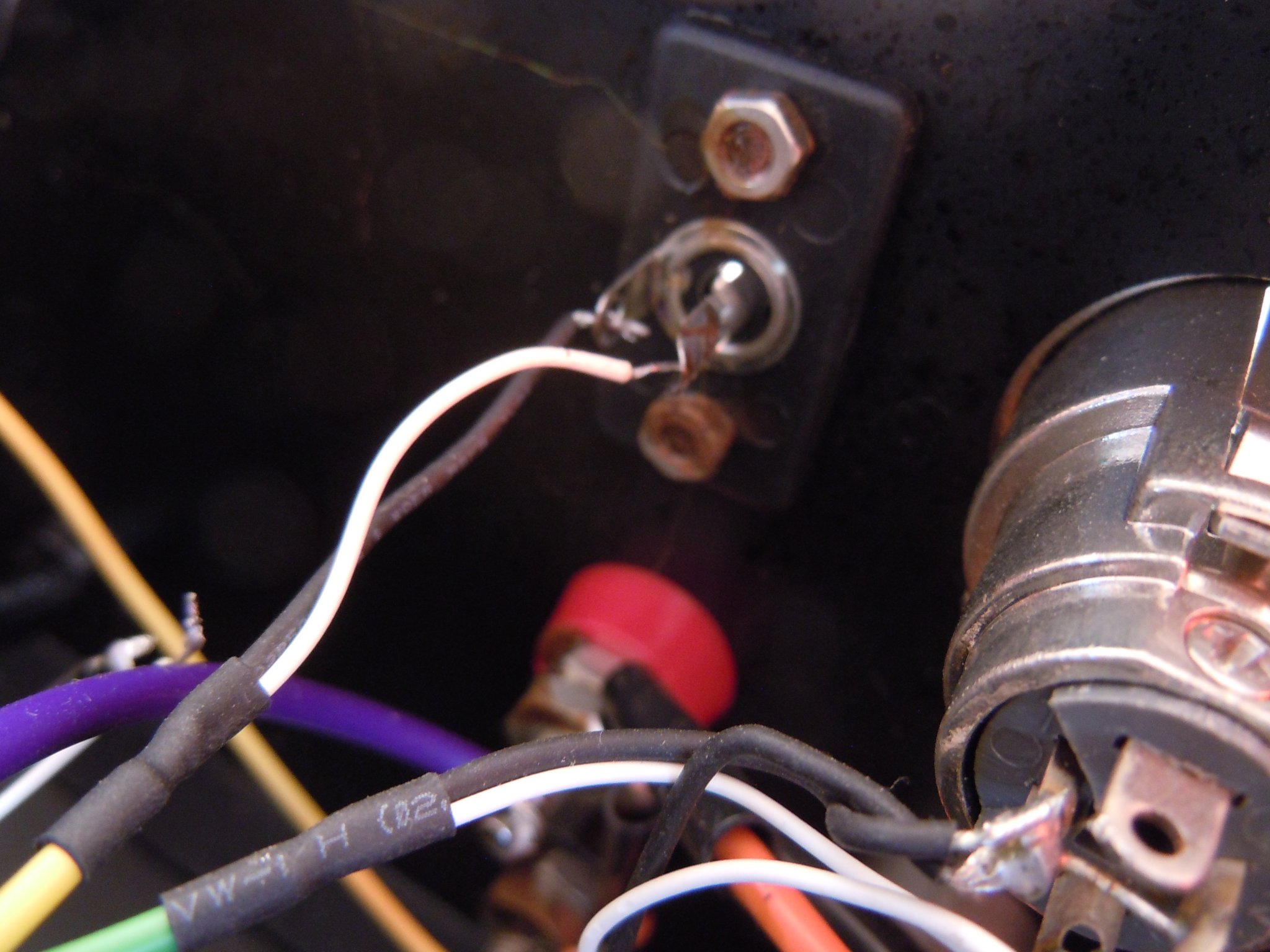

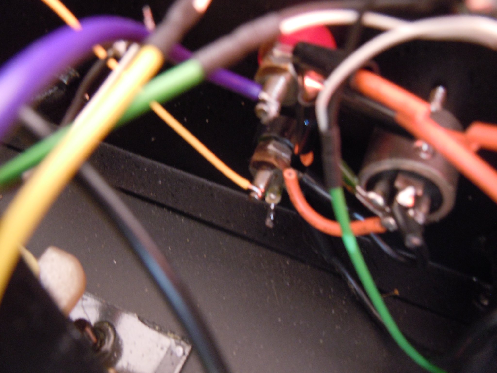

I did three little things today while I was waiting for a parcel.
I soldered the output cables directly to the speaker sockets. They originally run via the headphone socket and another jack socket. That robs cleanliness. Nobody needs it. Solder the cables directly to the sockets, not to any solder lugs, which then run over the nuts...-)
Then I bridged the pots. I replaced the first one with a 100 kOhm. Simply run the input cable directly from the input sockets to the amplifier board. This also brings a lot of cleanliness, silence and shine.
I have replaced the bias transistor, Q3. Use the best-sounding, cleanest one you have. Even those with tomatoes in their ears do hear the difference;-)
By the way: these thin tin RCA sockets sound finer and wider than the vast majority of thick gold-plated Cicnh sockets. These only make crash. However, there is a fine veil in the sound with the thin things.

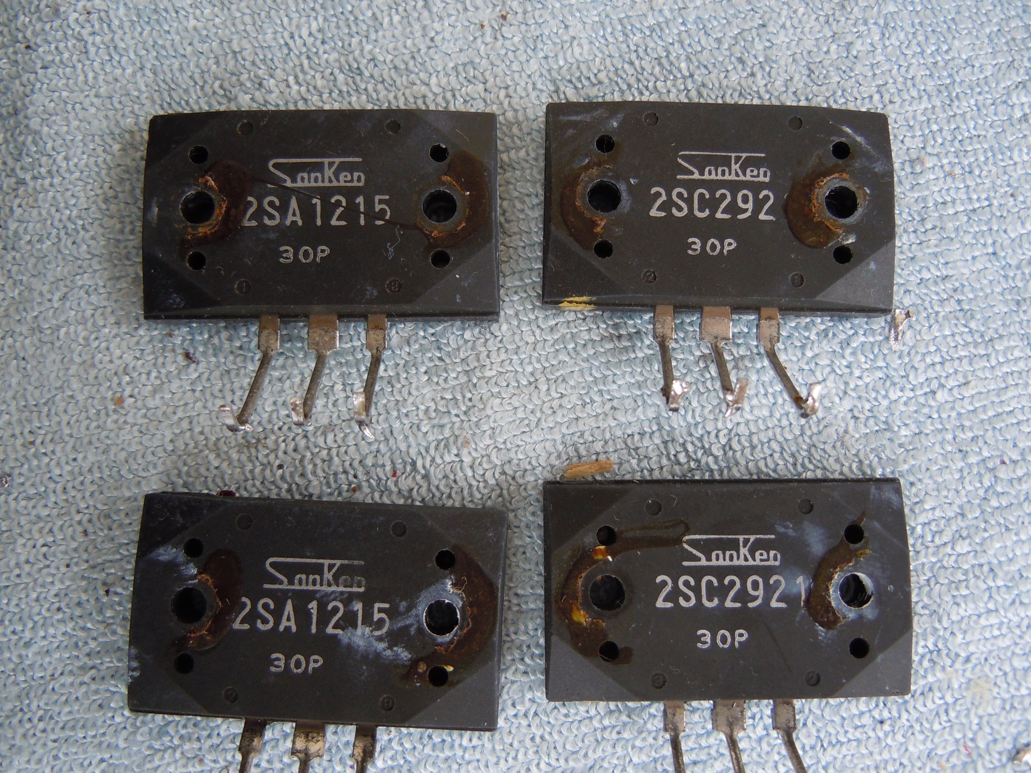

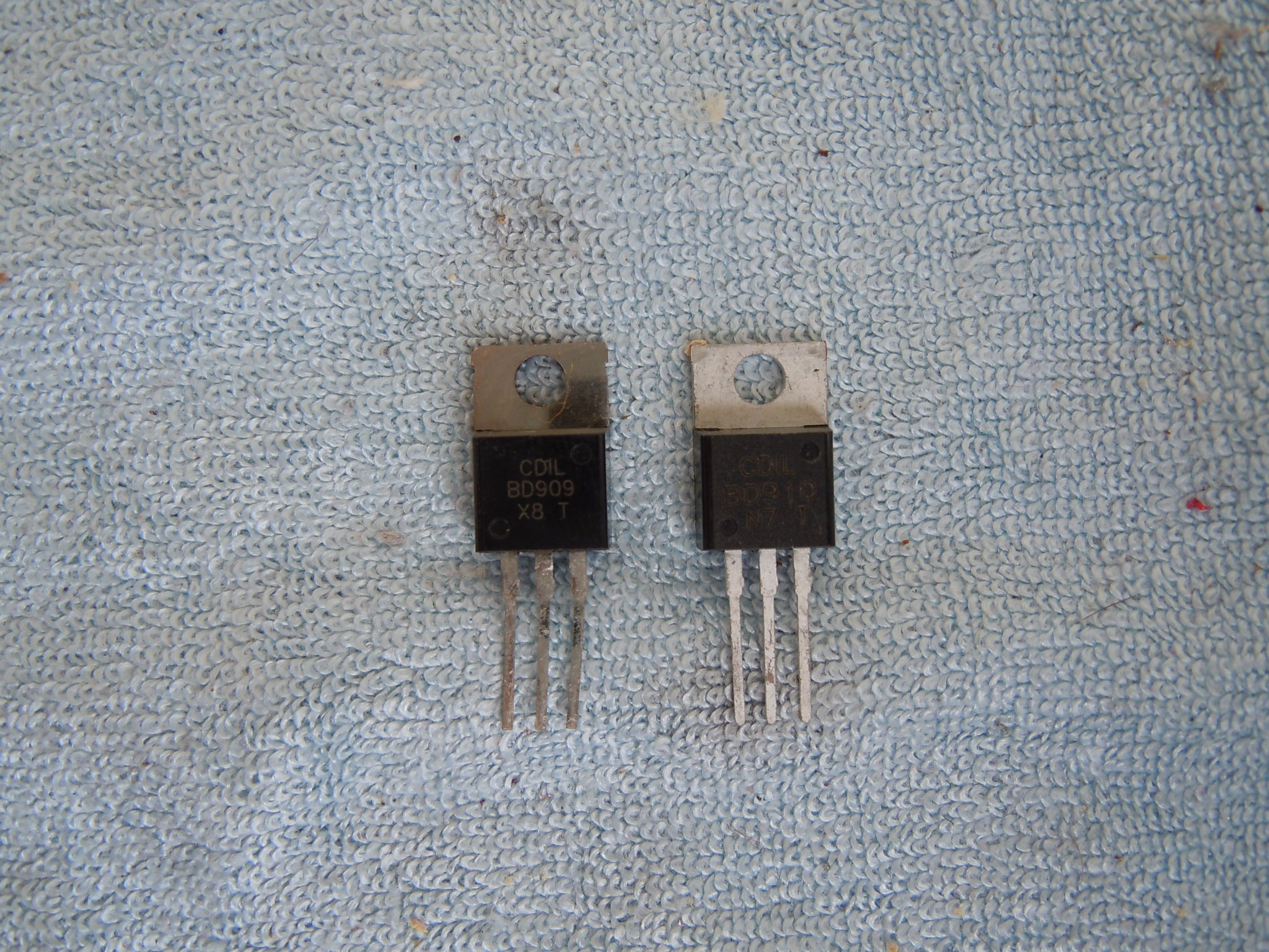

I have done a little more to it:

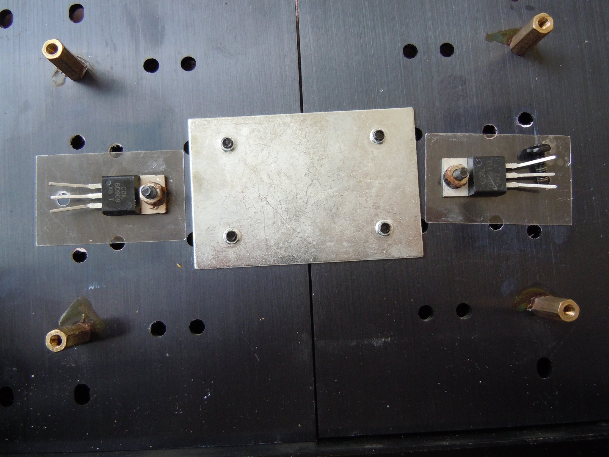

- I have installed a pair of BD909/BD910 for the time being. The original, 2SA1215, 2SC2921, fat MT-200-casings sound terrible, regardless of whether Sanken is only written on or is also inside. The sound is, despite the definitely different sounding BDs (see photo), equally raven-black, liquid, the bass rolls, the bass-drum stands with contour in the room shown, the instruments virtually shine. The sound seems a little smaller at first, but this is due to the greater cleanliness, the lack of hiss and the absence of noise.
All that remains now is to remove unnecessary transitions, such as soldering lugs, and to replace the original wires with single-core copper cables - I use diameter 0.8 mm for this device. And later a look at the diodes and electrolytic capacitors. That's all you need to do to get the tears rolling with clarity, groove, tempo and fluidity: 1A home audio amp;-)
If you want a little more width and relaxation, and also a higher load potential for long, loud events, you should use two BDs in parallel.
