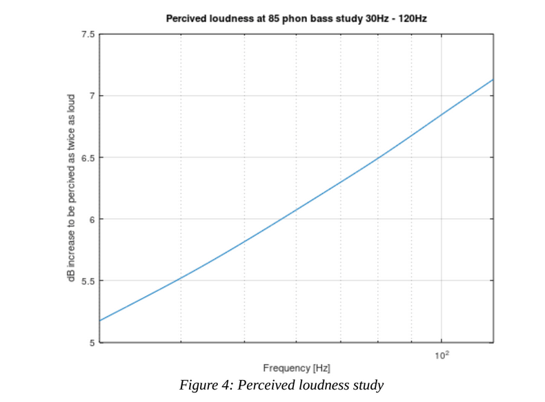

Port design is quite important for a compact sub, I have had great results following the attached paper. I designed a 60Hz tuned 12" compact monitor speaker using a continously radiused port made using CNC cut stacked wooden rings and it kicks unbelivably with no hint of port noise. Compared to simlar straight port speakers its remarkable. Unfortunatly I don't have any measured data but the paper is full of it.
To me 3dB is actualy quite a lot to leave on the table, at bass frequencies less dB increase is required to have a double percived volume than at higher freqs. I actualy worked this out from the equal loudness curves when deciding on a subwoofer upgrade for myself:
