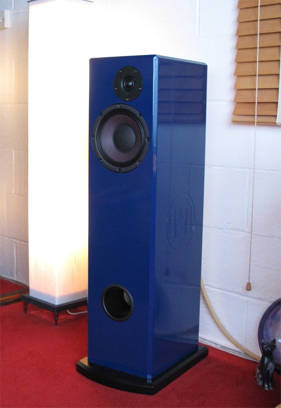

Here's some examples:
https://diy.midwestaudio.club/discussion/1219/my-shop-kit
Painted Tarkus
https://www.deviantart.com/bolland83/art/Tarkus-speakers-342131596
https://techtalk.parts-express.com/...53366-bolland83-s-faux-wood-technique-for-mdf
https://zelfbouwaudio.nl/forum/viewtopic.php?f=59&t=15285
Derek Walton (old site) Pi One Towers
https://web.archive.org/web/20071029171747/http://iol.ie/~waltonaudio/pione.html
