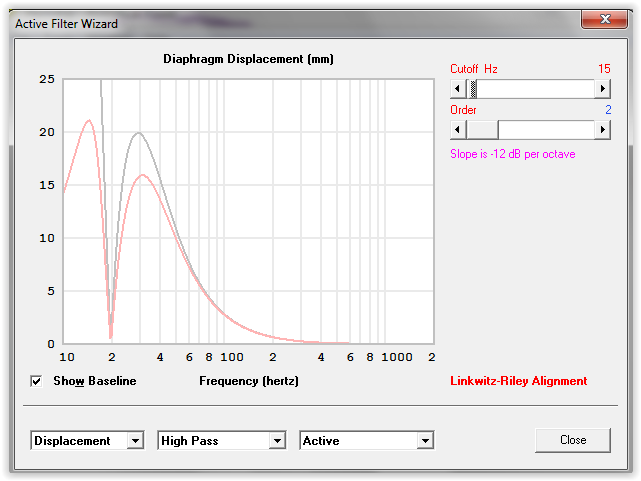

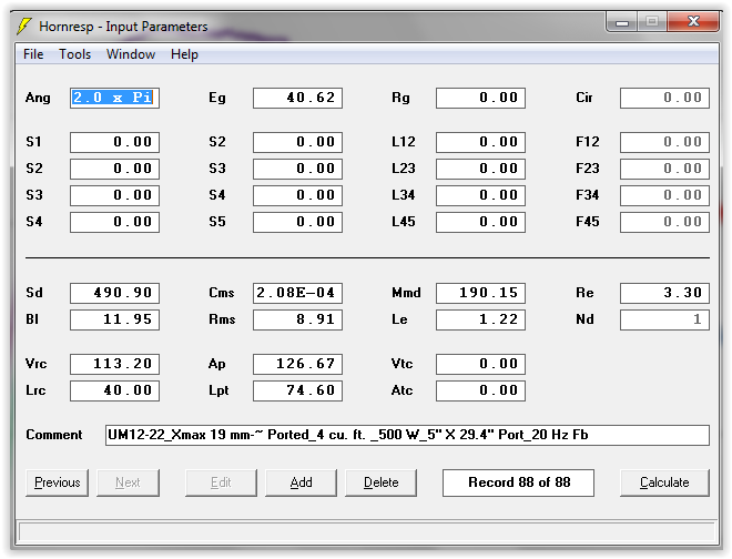

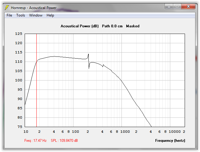

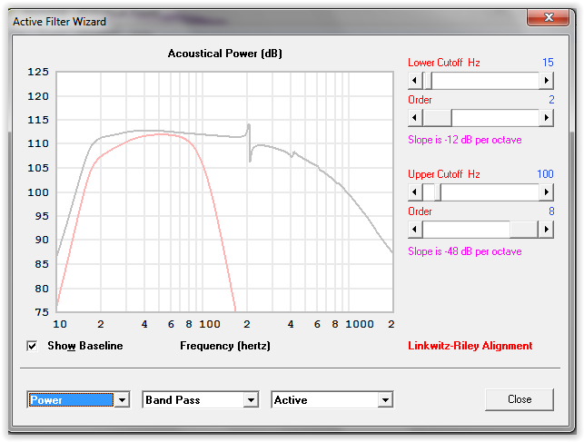

For anyone interested in a middle of the road enclosure for the Ultimax 12-22 here is a ported 4 cu. ft. box.
4 ft. internal after braces and the volume taken up by the speaker.
A 5" diameter port, 29.4" long and a little stuffing glued to the walls.
This port may require a 90 to fit in the box, a shelf port may be better.
I'll let the sim do the talking.
This should be a good sounding, middle of the road sub that is easy to build.
It does require a High Pass filter, and a low pass wouldn't hurt.
I strongly suggest anyone wanting to build a sub to learn Hornresponse.
This is DIY after all.
Dave
