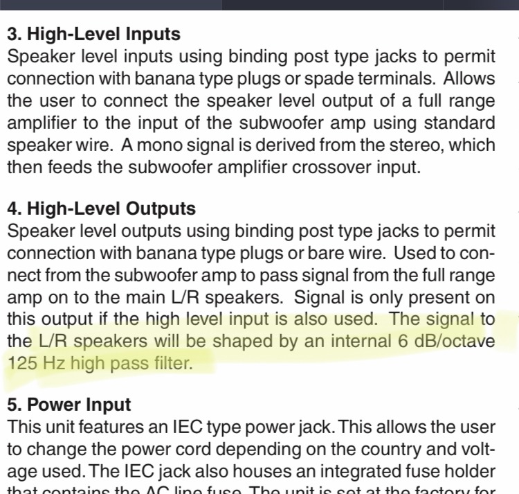

Are you sure that plate amplifier has a high pass filter for your main speakers? I had a read and came away with the understanding that it does a pass through, not HPF for your mains.
To me, having that high pass filter or your mains is essential to really getting the full benefit of having a sub in a system. So I would not compromise on that, even thouh it will probably make things more complicated and reduce your options.

Yeah agreed re: HPF. Thanks for point it out. I had assumed the ‘freq’ Knob was a sort of variable 2-way XO…!
According the user manual, the high level ‘through’ has a HPF at 125Hz, -6dB/octave.
So that would mean I’d be crossing over pretty high for a sub, but all the more reason to build 2 for a stereo image, right? I have a supportive family!

That 125Hz at 6dB rolloff for your majns is i guess better than nothing. You will need external amplification for your mains. Given you are not crosding to tiny speakers i think you will be ok.

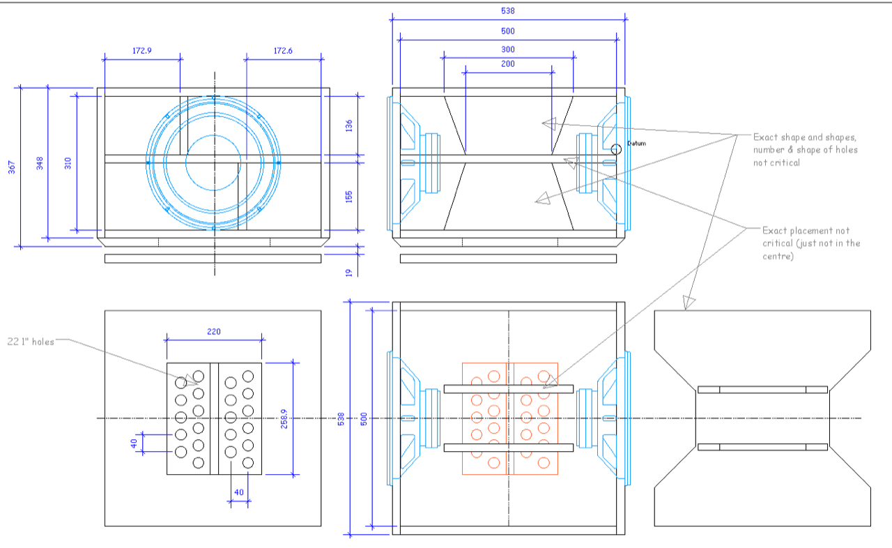

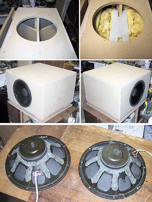

I have some of those old philips 12 inch drivers in my shed. If i am right they were used in an old ETI kit. They should work a treat for you.
I would definitely go one per side. 😉

Philips 12" drivers were from an old pair of monitors from a television studio. Sealed in quite a small enclosure (approx 40-40L) with a strange array of tweeters and mids. Sounded okay but i want to DIY something nicer sounding and looking
