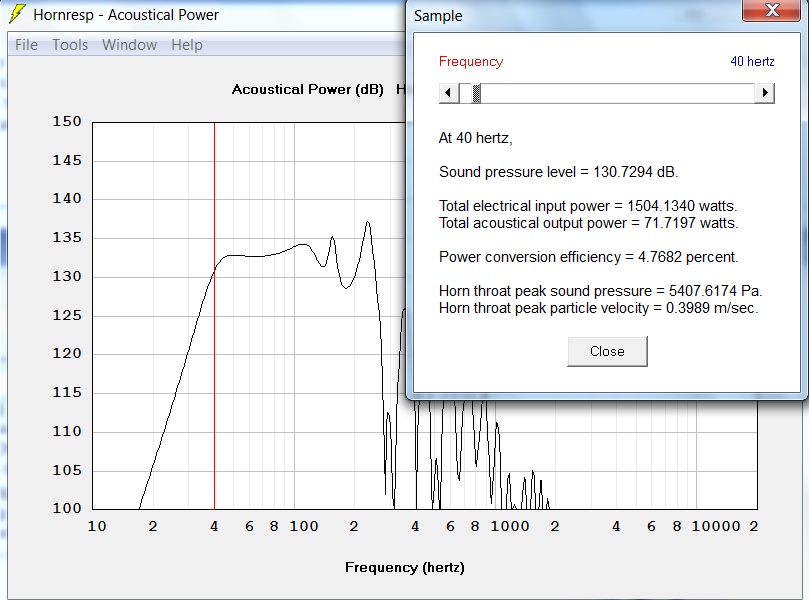

The PAL12 is 100db (99.7204) @ 40hz and my opinion wipes the floor with the THAM12 and worth every inch of the additional size. Far better cab for dance/dnb/etc. Not sure if this would be PA use or not for you but the Infinity 1260w sims nearly identical and can be had for $60USD, 1/3 of the cost of a LAB12.

You made me realize I had different THAM15 designs saved in HR and FYI the design I used above was Don Snyder's from post 19 http://www.diyaudio.com/forums/subwoofers/175658-tham15-compact-15-tapped-horn-2.html#post2440483
IMO Don's design just rocks with the PA385 ($200). It has to be one of the best application of Hoffman's law I've some across.

Note that design also does not include any cone compensation. Try setting Vtc to 4.5L and Atc to Sd - that should give a better idea of what to expect from that design.
