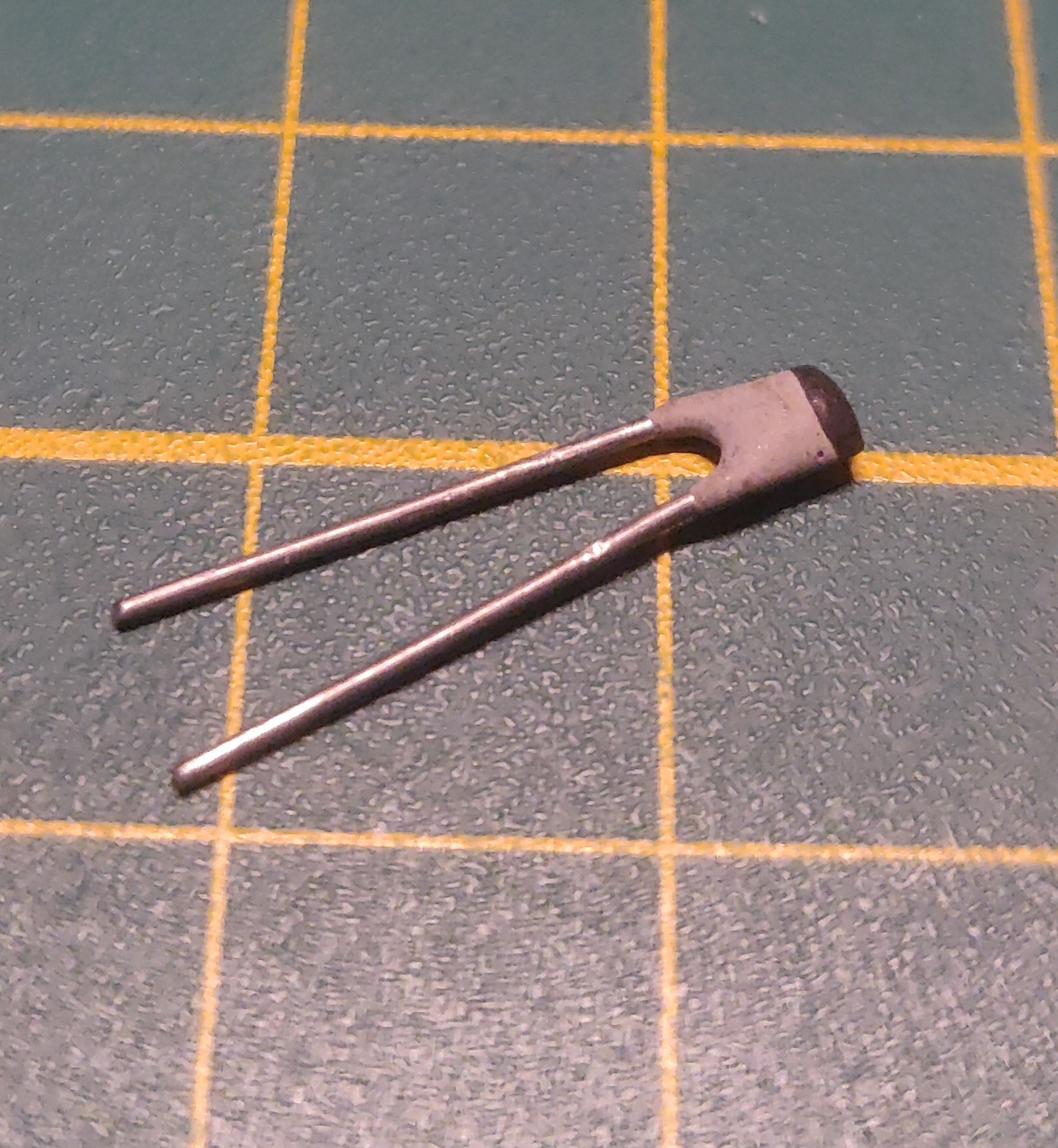

I used this type, very old:Do you know what kind of ceramic capacitors those were? Unlike class 1, class 2 and class 3 ceramic capacitors can distort like hell when there is a substantial signal voltage drop across them.
I used 1nF at the input to ground in a headphone amplifier made of bipolar transistors (the 3HPA) to solve the problem of a scratchy volume pot. That it did but in exchange the amplifier sounded really terrible. You are probably right! 👍

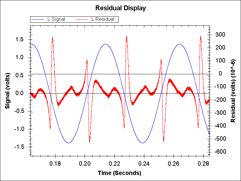

Its worse than you imagine, high-K dielectrics seem to have cross-over distortion... Undeniable if you plot the residual, so even small voltages cause high levels of distortion.
@widea The photo looks like a single-layer NP0 capacitor from Philips. Philips always made the class 1 capacitors grey, I don't think any other company did that. The black stripe indicates NP0, which already implies it is class 1. They are actually very good, but I've never seen one with a value above 120 pF.
I therefore guess your 1 nF capacitor was tan coloured and had a yellow or green stripe (or no stripe at all if it wasn't from Philips). Those are class 2 (a.k.a. high K or high epsilon_R).
