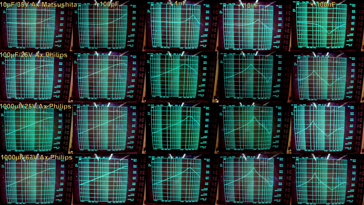

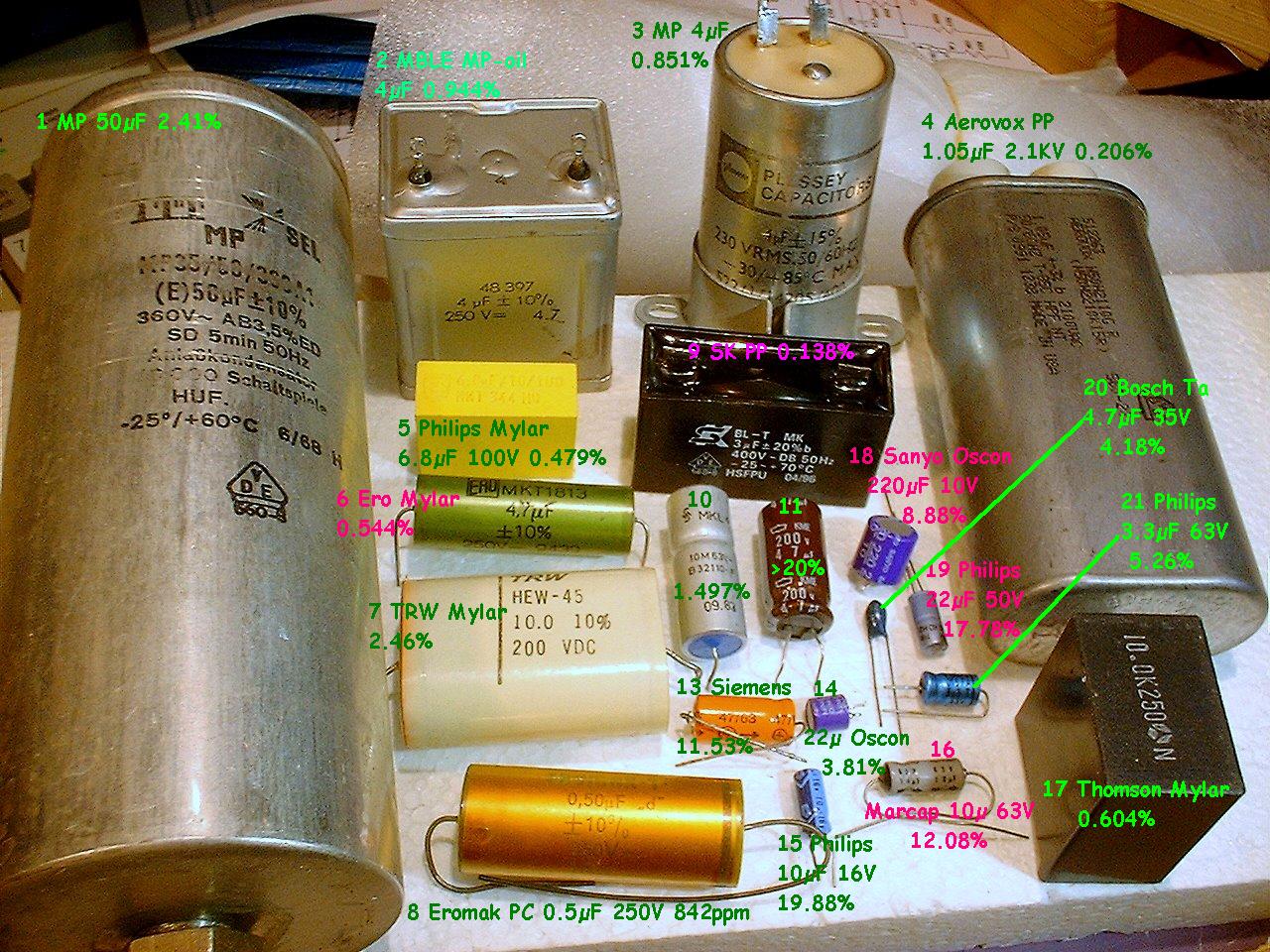

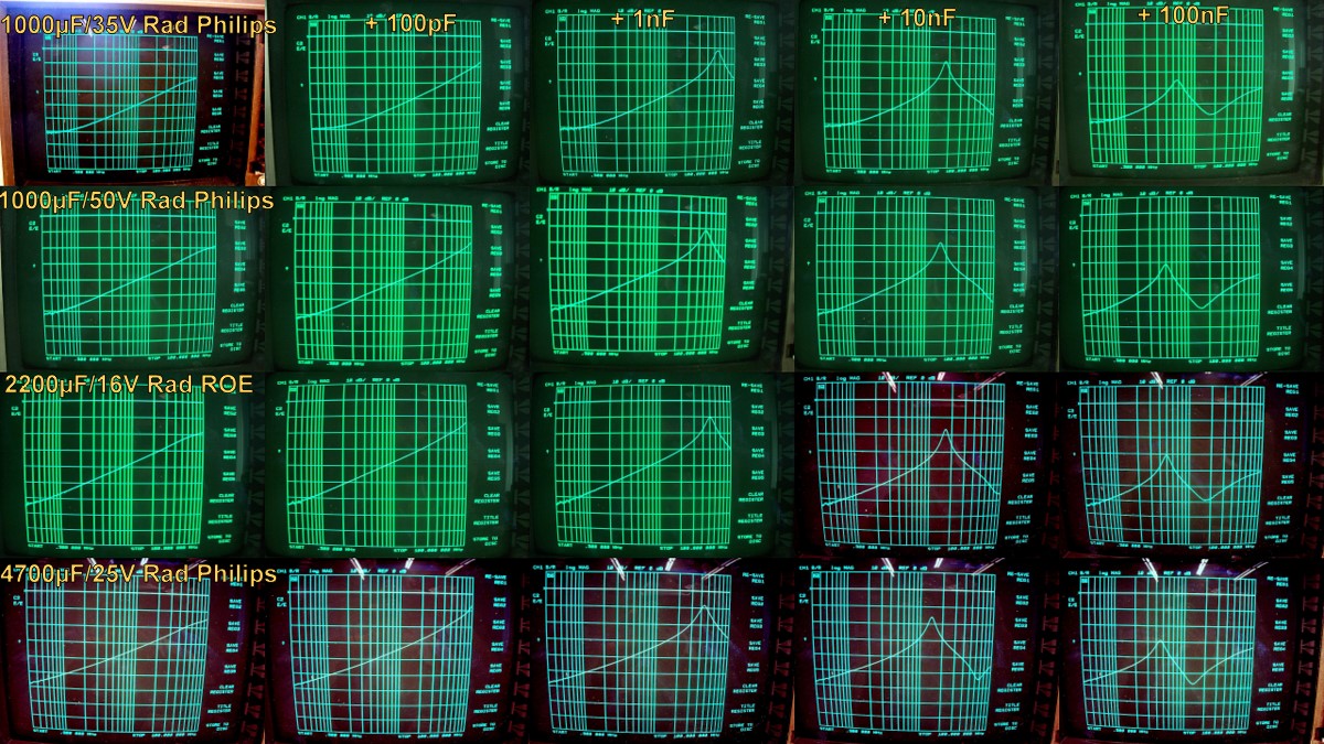

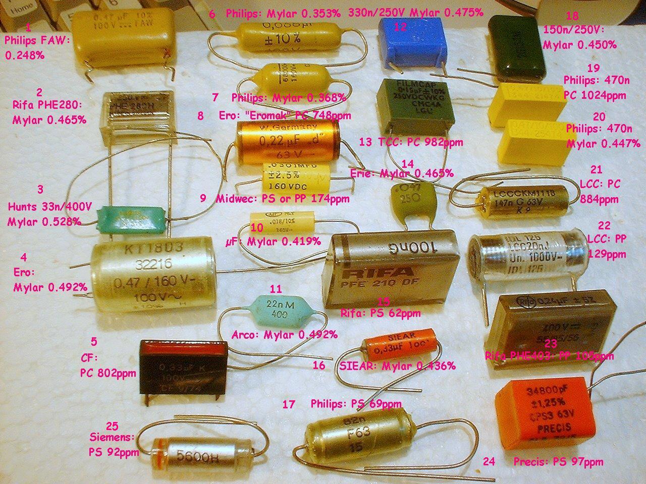

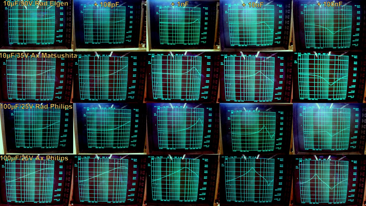

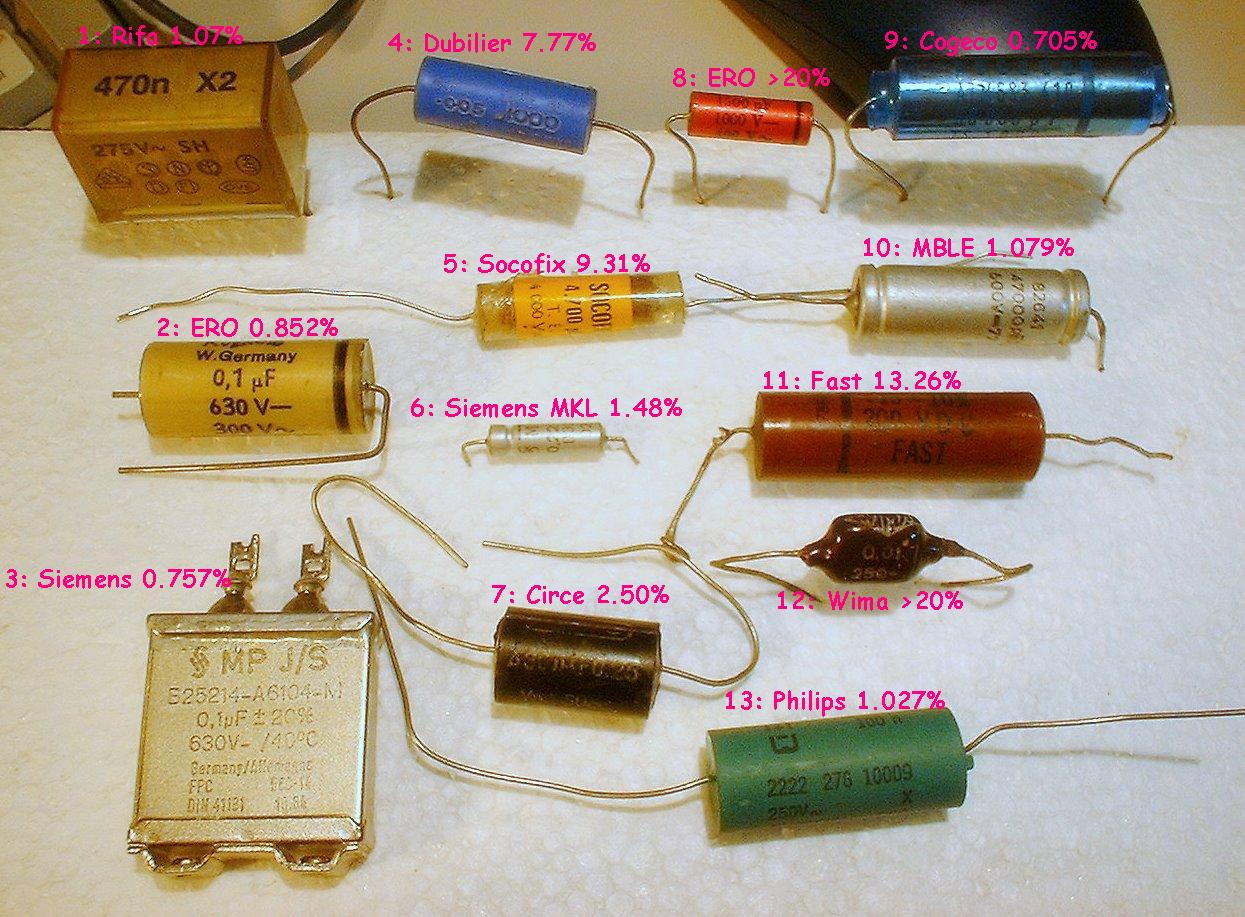

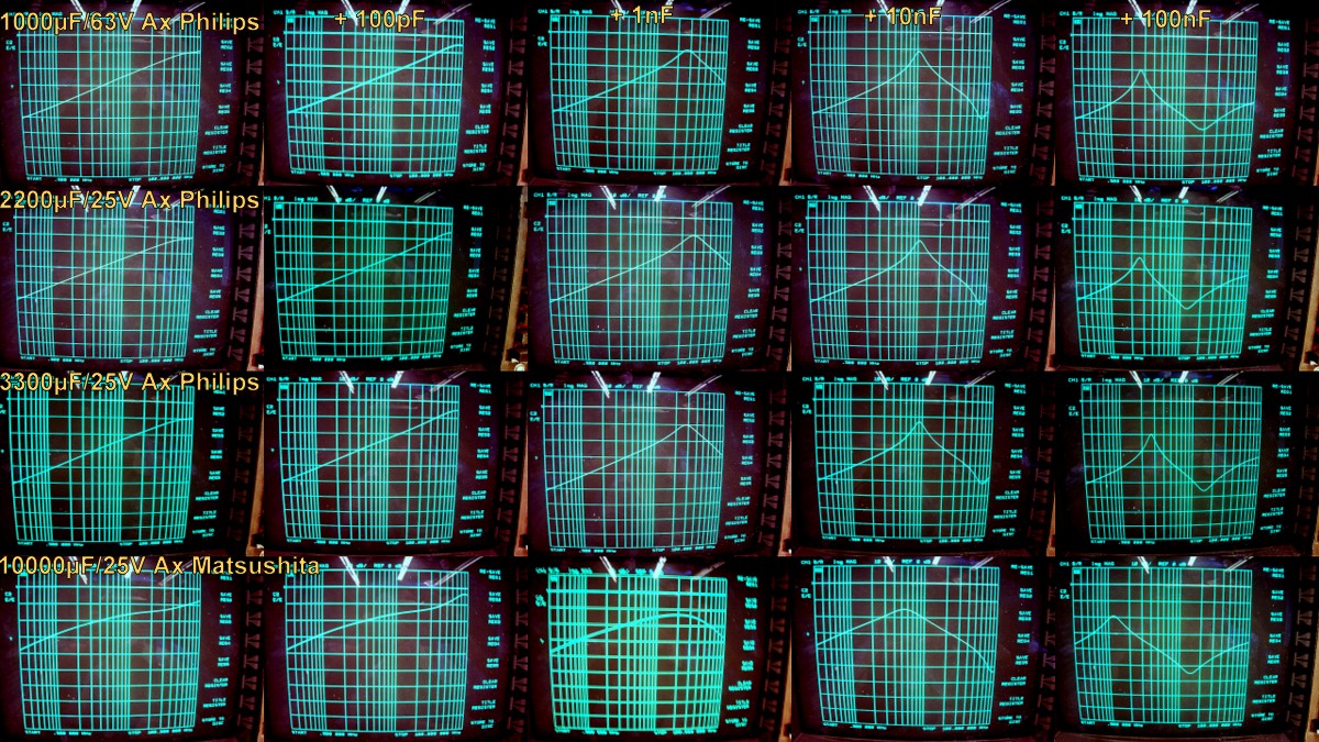

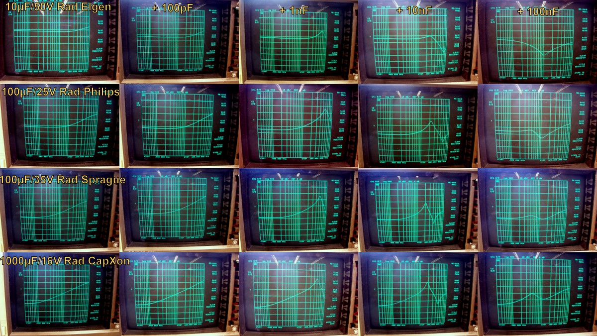

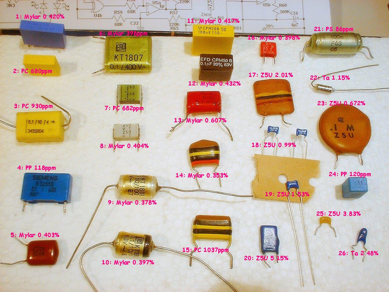

Here are a few measurement examples:
I see 5 thumbnails in post13.
All open to show the details written beside each capacitor.
What are the % values indicating?

Percentages and ppm's are the loss factor (tan δ)What are the % values indicating??
Losses by themselves aren't non-linear, but they are a "vehicle" for non-linearities: although possible theoretically, I have practically never seen a very low-loss cap presenting a significant non-linearity.
This doesn't imply that all lossy caps are non-linear, but it is normally one of the preconditions.
Losses are also an important indicator of other "quality" parameters: for example, DA (which BTW is a linear phenomenon) is incorporated in the loss figure, and deviation from the intrinsic dielectric value: for example, PET taken in isolation has around 0.3~ 0.35%.
If you find a PET cap having losses much larger than 0.4~0.5%, this means that its construction is supoptimal or that it has aged in a less than graceful way.
A very useful diagnostic tool: this can be seen on some paper caps, which are known to have a problematic ageing, and have gone through the roof

I compared a $0.50 Panasonic EF-series polypropylene cap to a $2 Solen polypropylene to a $20 Silver-in-Oil Mundorf. I measured the impedance of the cap with an HP4194A impedance analyzer and worked out the ESR and ESL with the "equivalent circuits" function of the instrument. The Mundorf lost on all accounts (lower SRF -> higher ESL; higher ESR). The Panasonic won (lowest ESR and highest SRF). The Solen was slightly worse than the Panasonic but not by much. I suspect the difference was caused by the difference in lead length as the Solen was an axial type and the Panasonic a radial type.
