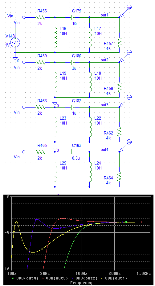

The best value for the plate choke may be "infinity". But infinite chokes are infinitely out of stock.
The next path to try is Filter Theory. You have a source resistance, a shunt choke, a series capacitor, a loaded choke (transformer and speaker). If you pick these values poorly you get a saggy or peaky response. Do it well and you have a 3rd-order high-pass with Q to your taste.
The Dead Men figured this all on slide-rule. From books.
I have done similar simulations to those in PRR's post. As a practical matter, I size the parafeed cap to be
C = 2*L/(R*R)
L is plate choke inductance, R is output transformer primary impedance. This keeps the load impedance seen by the tube both resistive and fairly constant down to the lowest practical frequency. Around that point, it's not too sensitive - anything from half to twice the calculated value is reasonable.
Assuming the amp is a SET, larger capacitance will extend the bass extension but present a low impedance load to the tube, limiting available power.
C = 2*L/(R*R)
