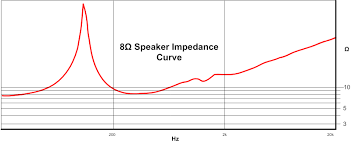

Yes, P = I x I x R. However, in case you don't know:
The calculation is complicated by the fact that an 8 ohm speaker does not actually have a constant resistance (or more correctly, impedance) of 8 ohm.
Instead, the impedance of a loudspeaker varies with frequency like in the attached graph.
8 ohm is simply the nominal value - usually to be found around 400 to 1,000 Hz.
