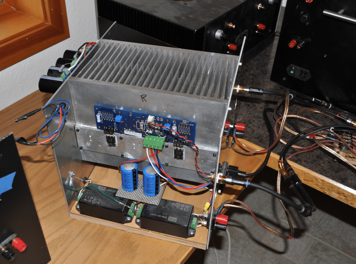

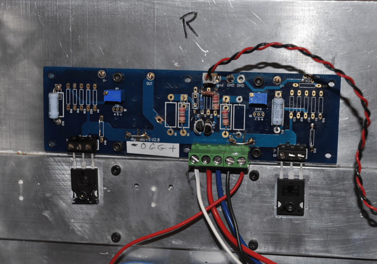

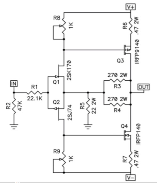

Based on the circuit shown by Papa at the BAF 2023, I have built the F5m using easily modified DIYAudio Store F5 boards from long ago. I installed the boards on my prototyping chassis configured to handle the FirstWatt standard +/-24V power and a subset of the Universal Mounting Spec heatsink holes.
Since my heatsinks are fairly large (7" tall Heatsink USA 10.080" wide C/W/3": approximately .80), I biased the output FETs at around 1.35A, giving a heatsink temperature rise of 23C.

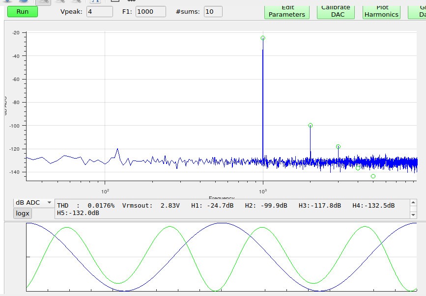

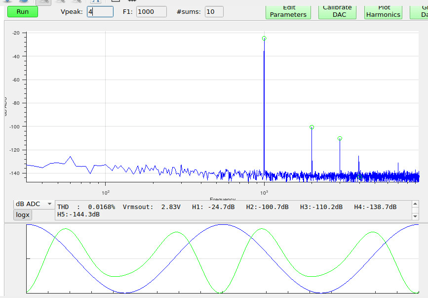

The distortion measurements are consistent with what Papa showed in the BAF 2023 video presentation.

I didn't mention the power supplies. The left channel, shown in the image of the provious post, is powered by 2 x Mean Well IRM-90-24ST power modules, with an simple RC output filter. The right channeel is powered from the "standard" 300VA +/-24 volt linear supply.
What is interesting is the noise floor with the Mean Well switching is 10dB lower that with the linear supply but both are good. There is no discernable noise with my ear to the speakers.
This suggests that the "cheapest" option for powering 2 channels of the F5m might be to use two higher output wattage, 24V switching supplies, such as the Mean Well LRS-150F-24 rather than the "standard" linear supply.
Shown below are the left and right channel distortion spectra at 1kHz, 1W, 8R load.
