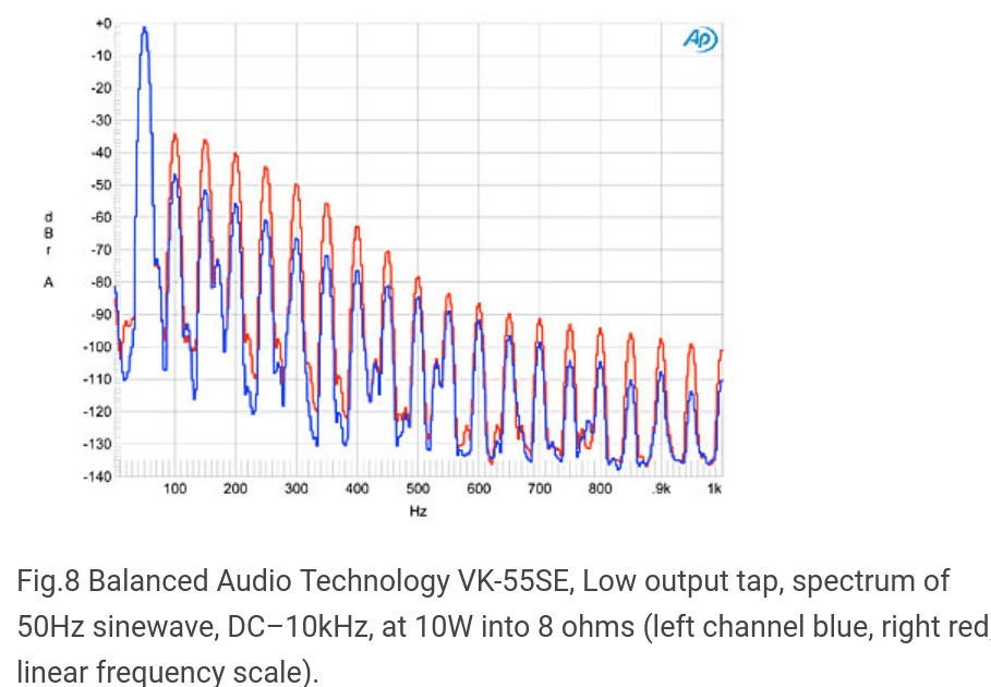

you had one set of THD Spectra with your previous system, and now have another, presumably much lower THD than with BAT amp
thought is that you prefer more Sugar - be it 2nd dominant or simply more THD, whatever dominant is
now, if preamp in case is having fixed 18db gain ( as written on site), you simply have too much signal conditioning now, combined with PL amp - severely attenuating after selector, then needlessly amplification after ......... whatever fancyshmanzy circuitry applied, too much fiddling with signal always results in signal energy loss
that's explanation why you're finding direct DAC connection better to your ears

in short - with excessive gain sum (existing preamp), you're "killing" the signal (whichever resulting THD Spectra), that's the main reason why direct DAC connection is sounding superior
having opportunity to try PL preamp, that's no brainer - try and decide do you need more Sugar*** (usually dominant 2nd) but whichever preamp you end with, take care of choosing one with adequate (minimal) gain
*** with PL gear you'll end up with low level THD; do you prefer higher levels, only you can decide; not matter of quality of chosen gear per se, it's matter of personal taste

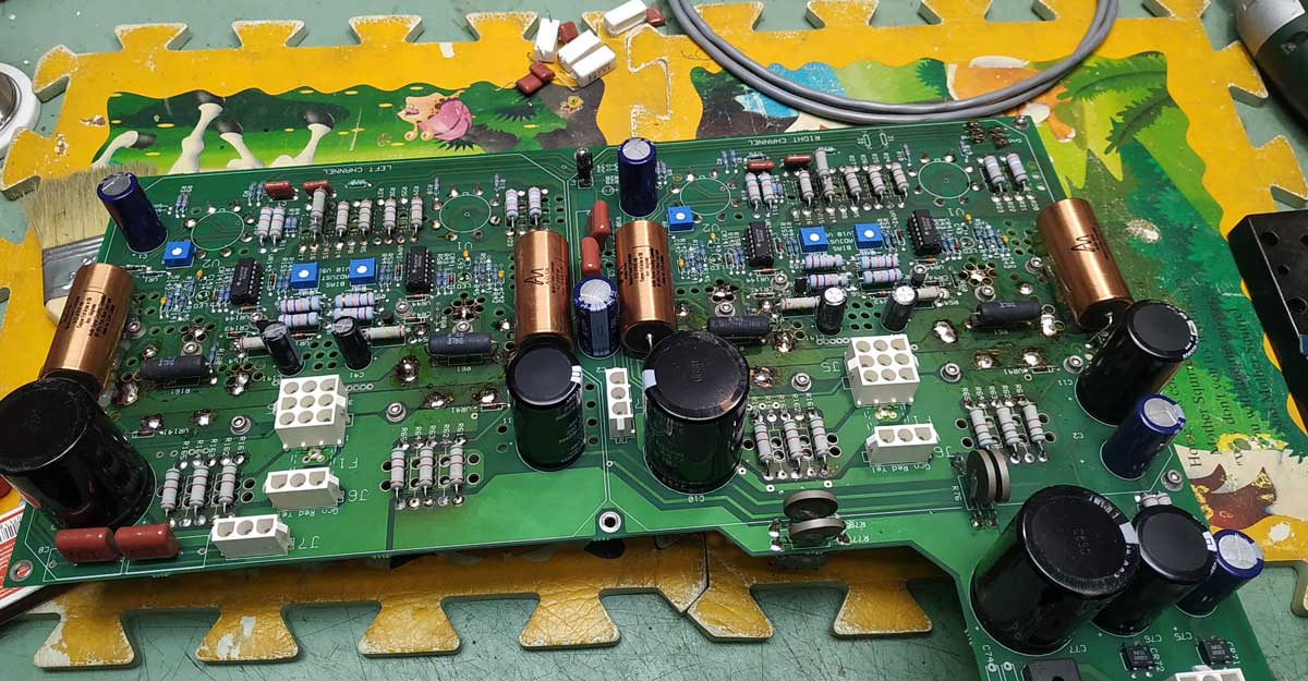

I've had a BAT system comprised of a VK-55SE tube amp
believe it or not - clever move ....... nice to have it for 3-5yrs of moderate use ..... after that, all possible horrors, due to routing/layout problems (currents/heat)
one 6C33C is taking 3A3@12V for heating; there are 4 of them, heaters fed through pcb traces ........... go figure!
edit: pic taken on my bench
