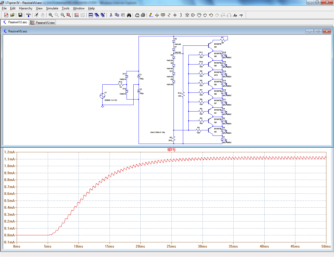

Has anybody build this passive led vu meter? I have been "inactive" in electronics for a while now, I need to fix or build something....I was considering to build this "passive" led vu meter, But again I will have to check if this circuit will affect the impedance seen by the amp at high volume. Six-LED Bar Power Indicator - RED - Page102
It adds a half-wave rectified load to the amplifier. This won't harm the amplifier, but unless the amp has quite a low output impedance it will add a little distortion to the sound. OK for uncritical PA use, but not for serious audio.

Trouble with a passive (led or meter) is you'll need it far far louder then you might think to get any LED's to light. Just rig up one LED/resistor/rectifier to see how it behaves.

Good to know Mooly! I just need the BZX79C2V7 2.7V 500mW Zener Diode to build at least the 2 watts range and see if it will be loud at that range to my taste. The problem is I can not find that Zener diode at Radio shack and I can not order from Mouser just one diode to test this circuit.
It looks to me like the zeners' function is only to clamp the voltage across the LEDs. You could try ~3 1N400x diodes as substitute.

Mooly...you were right!!! I build the circuit and I had to crank it up too high to light the diodes. I do not think I like the passive way at all. I guess I will have to look for a circuit using LM3915/16.

This circuit is a bit smarter: the first LED will begin to glow with an input voltage as low as 1V, ie 0.125W.Mooly...you were right!!! I build the circuit and I had to crank it up too high to light the diodes. I do not think I like the passive way at all.
Not quite what you can achieve with an external supply, but way better than the circuit you picked:
