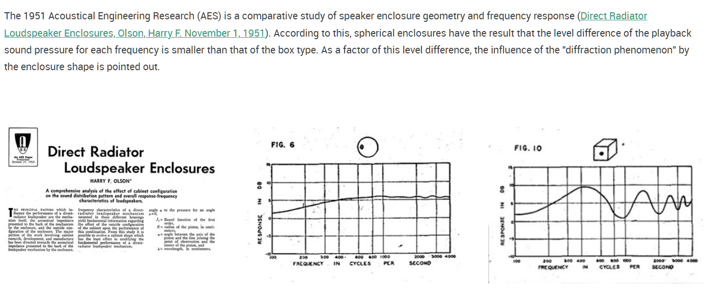

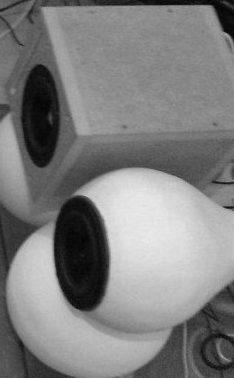

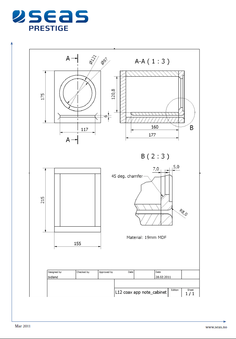

As an example of the baffle's impact, I once did a bookshelf speaker using the smaller SEAS coaxial in two enclosures of identical volume, where one was a standard box with a normal flat baffle, and the other enclosure was entirely spherical and comparatively narrow in the frontal plane. When contrasting the two, the difference was far more dramatic than ever expected: the spherical enclosure had dramatically less bass. Ports lengths were identical, but mounted in different manners by necessity. No PR.
From this experiment, it was surmised how critical the baffle/baffle step can be.
Many start by wanting substance in their baffle to make up the bass. After measuring and equalising the response to make the two the same, and seeing it can work either way, some then graduate to wanting that extra baffle support to instead prevent the midrange going behind the speaker.
"...equalising the response to make the two the same..."
Allen, sorry, to make two of what the same -- the response of two different speaker designs, and if so, what are the two designs?
You mention the smaller sphere having less bass. If you measured the standard box and the sphere and equalised them, they would become more similar. This is the idea behind baffle step compensation.

Ah, no, the sphere was not smaller than the box; the two enclosures were 100% identical in interior volume. Only the sphere, by nature of being a sphere behind a comparatively large driver, had much less of a baffle, or less of an effective baffle. Think of a tear drop. The rectilinear box had a larger flat plane as a baffle, and the sphere was just a narrow ball with a slim, immediately receding curved front around a driver. Not much of a baffle. It's not like the old Harry Olson diagrams for Bell Labs, if you're by chance familiar with them, that first tested spherical enclosure shapes back in the 1940s and 50s -- those front baffles were far larger relative to the driver. Here I'm talking about something like the Gallo Micro, or the SEAS small coaxial in an enclosure barely 2x that size. Small spherical baffles relative to the driver.You mention the smaller sphere having less bass. If you measured the standard box and the sphere and equalised them, they would become more similar. This is the idea behind baffle step compensation.
Another way to look at it is that you get the woofer to produce double the bass, it is similar to using two woofers.
By equalising, do you mean signal processing, pumping in more low frequency? This has some of its own disadvantages, of course, and is something I'd like to come onto after optimizing other elements.
Ah, yes I see. The point remains the same. Were you able to get good bass out of them after you found the best compensation EQ?
Not at all. I mean, yes, you can force more bass into the signal, but that's cheating. 🙂 We're talking about a dramatic difference, not minor. Which led me to PRs, as the compromise of pumping more low end signal or wiping out the upper end to balance it out, means dramatic loss in efficiency, loads of excursion required to get approximately the same effect, lower overall volume capability, and more. It's really too much compromise, hence why speakers are infrequently produced like this. And so began the foray into PRs used in such small spherical speakers, as another, alternative means of compensating. Then the portable small Bluetooth speaker revolution took off, with myriad types of small PRs never seen before, essentially demonstrating validity to this direction. I'm giving a long overview of the evolution over decades, but hopefully that helps.Ah, yes I see. The point remains the same. Were you able to get good bass out of them after you found the best compensation EQ?

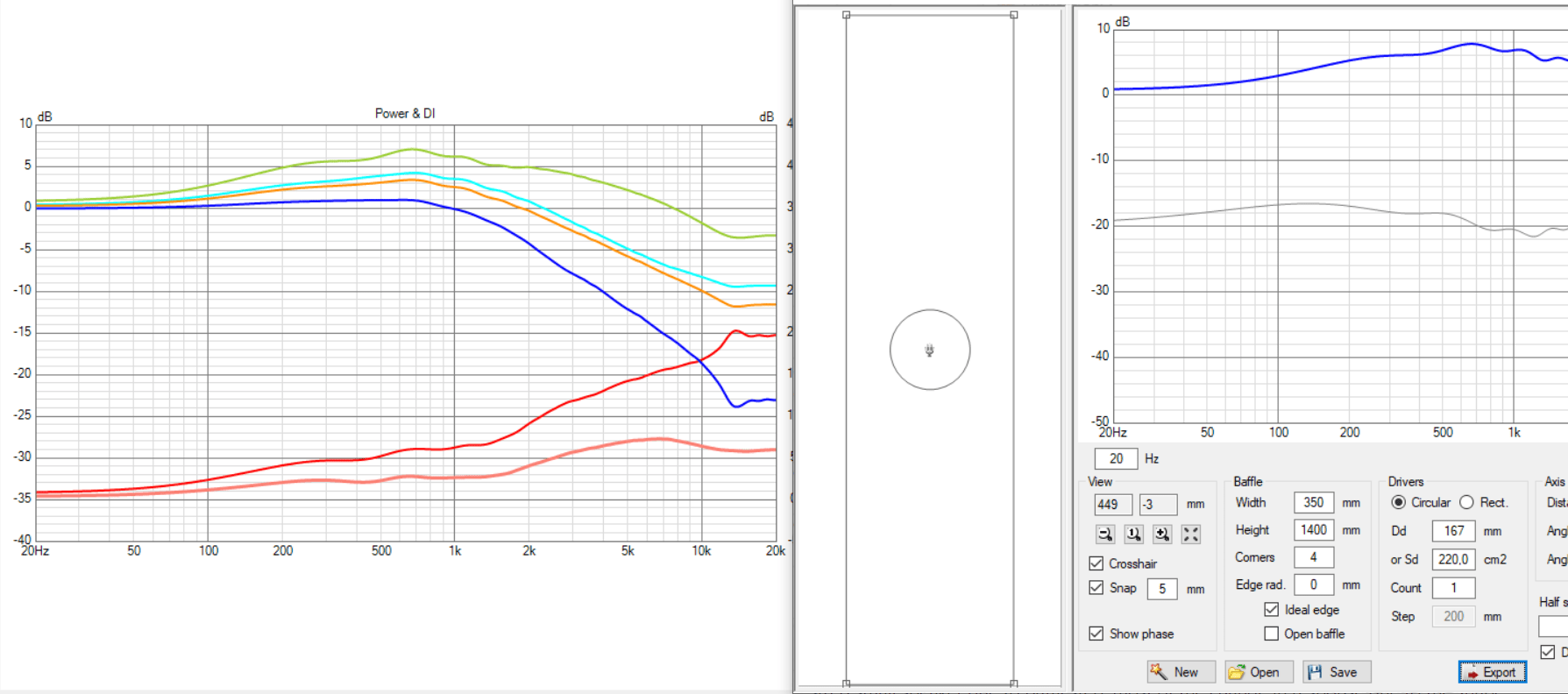

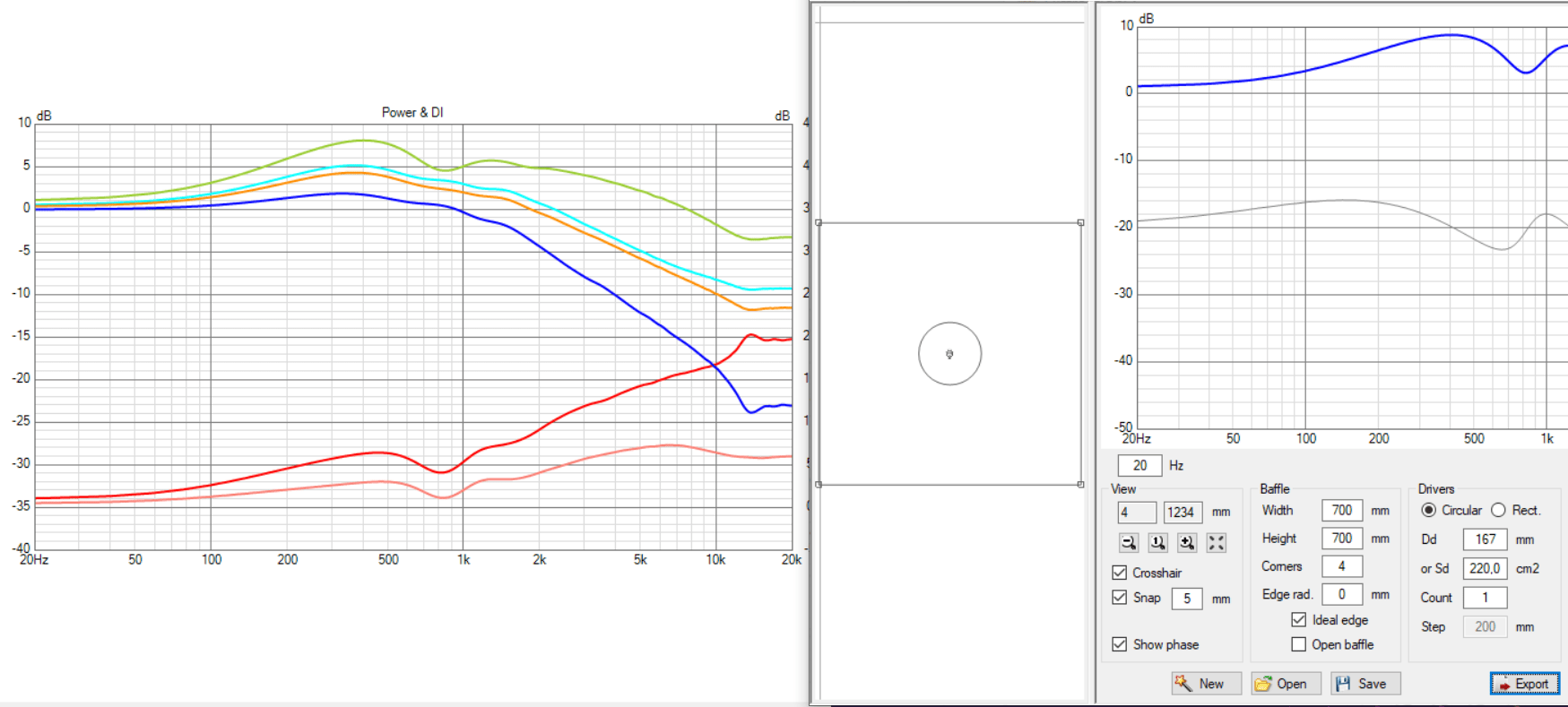

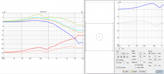

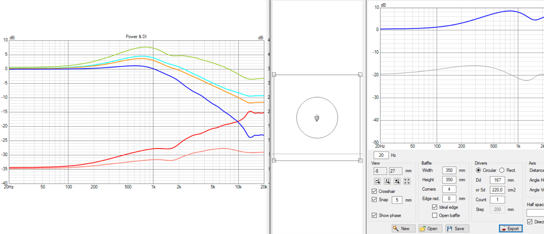

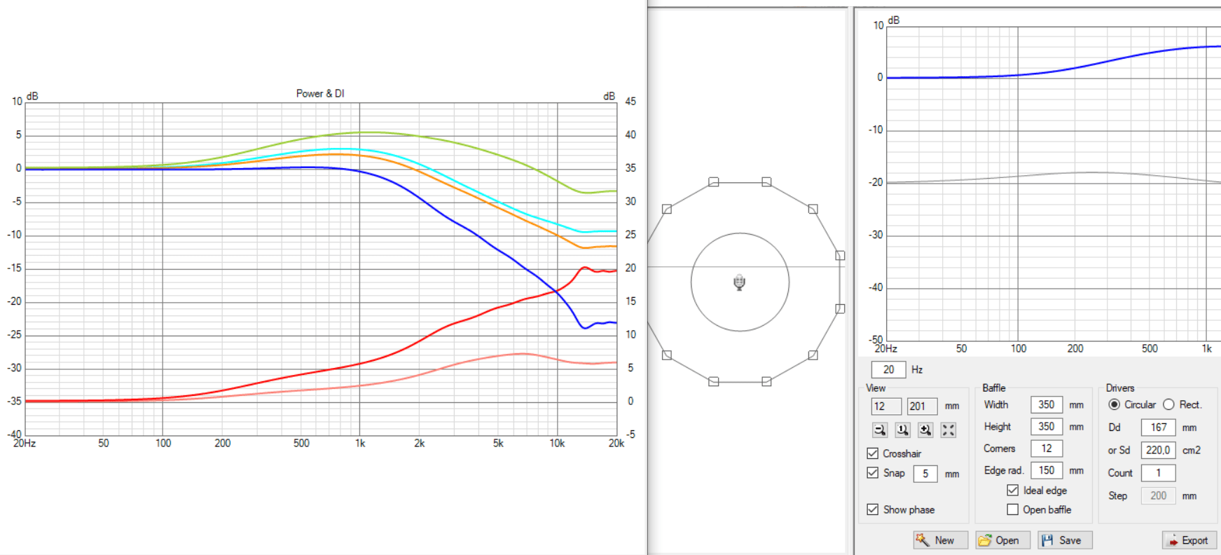

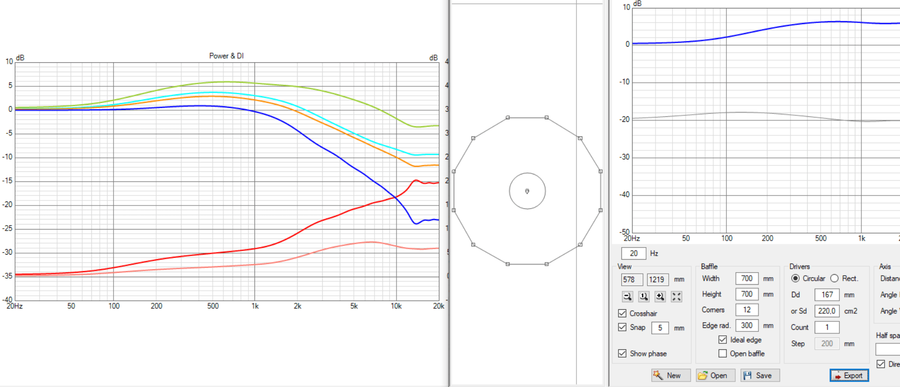

I'll augment the thought experiment with little ideal situation data. Flat piston on square baffle or roughly on a sphere. The size is about the same didn't mind the volume here. Attempt was to see if there is effect of baffle down to bass.
Its ~8" ideal driver on 35cm and 70cm square baffle without corner radius and 35cm and 70cm diameter circular baffle with big roundover approximating a sphere. Top most green line on the graph is listening window, so basically the on axis response. Blue is power response.
There is some effect lower than 4x wavelength, especially with square baffle, so the effect extends somewhat to bass with these baffle sizes. More over the sphere has less boost on bass, at least in the simulation, as lucadelcarlo suggests. This is about 1db difference and not sure if as audible as slight positional change in room though. Could be simulation thing as well. Still a bit of a surprise, never looked too closely into the bass region with diffraction sims and this makes the claim plausible in my view that sphere has less bass than similar size flat baffle.
While there might be audible effect to bass between two similar sized small speaker due to bafflestep, most of the change in response due to the shape happens due to edge diffraction and at mid range frequencies and these surely are audible being several more decibels difference, and to various directions. Here in these examples the main diffraction hump is around <1kHz and <500hz. To get the diffraction to very low frequency a huge baffle would be needed, <250Hz diffraction hump would happen ~140cm x 140cm baffle if continuing these sims.
Square baffle was selected to emphasize the diffraction hump. If baffle had different aspect ratio the bafflestep and diffraction gets "stretched" between the dimensions as well but it doesn't get lower than the longest dimension. Many people have +1m tall speakers which are quite narrow however. Here is 140cm tall, 35cm wide baffle for comparison. This is closer to 70cm sphere in response than the square, it has less effect on bass than square baffle with maximized diffraction.
Anyway, bass is about the easiest thing to tackle with any speaker system so I wouldn't discount the sphere, quite contrary. Just use enough big enough drivers and pour in some power and call it a day. Due to long wavelength there is very little audio quality problems other than getting enough, and distributed nicely in room. Room affects the response in bass much more than any baffle size that fits inside that room.

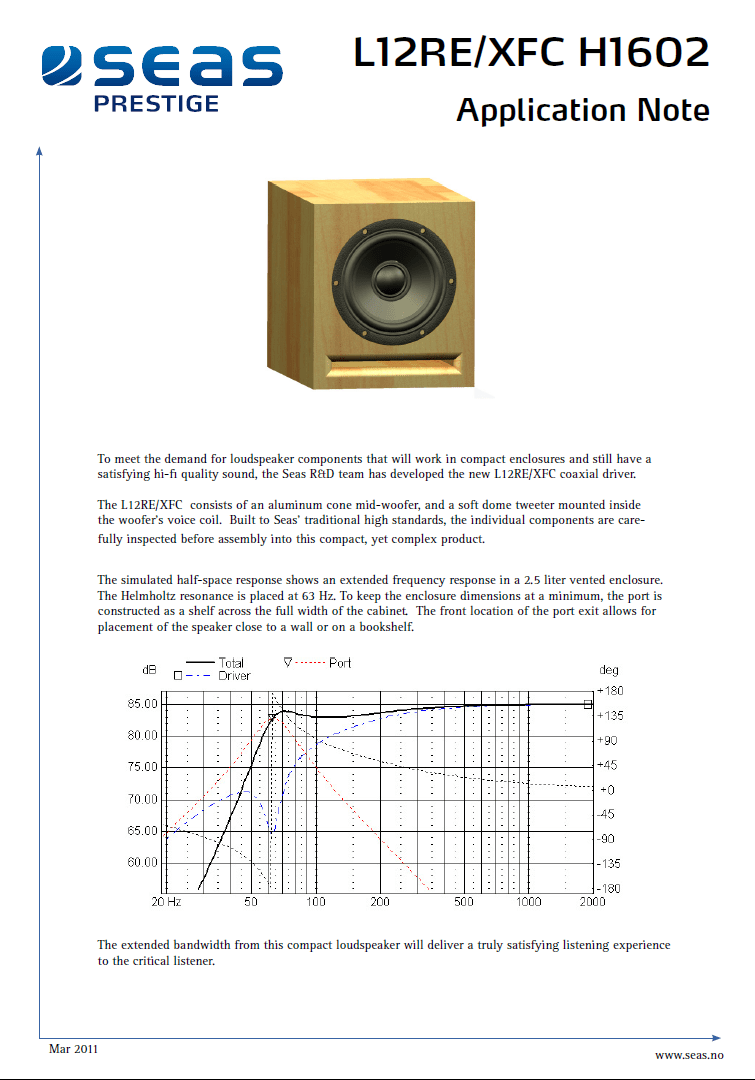

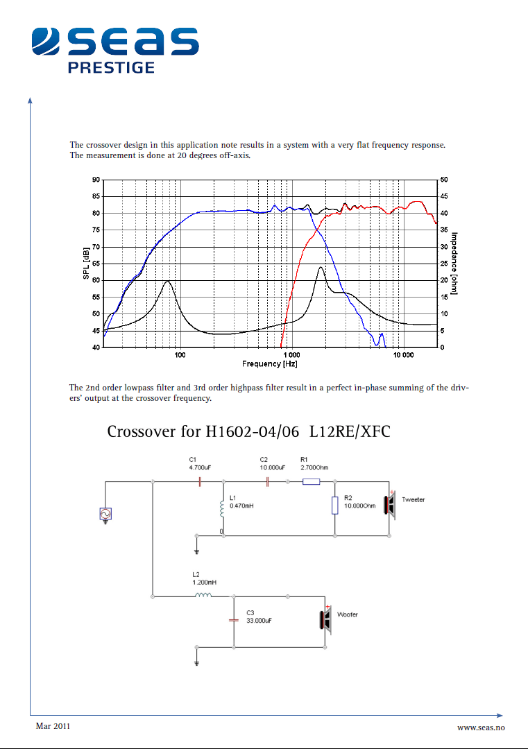

Thank you @tmuikku for that detailed response inclusive sims. Attached here is the application note from SEAS for the enclosure design that was used as reference, and constructed. Also, using the identical driver, is the spherical teardrop enclosure. The reference was built from 19mm-thick MDF as instructed, and its lengthy wood port consumes internal volume considerably, while the biomorphic enclosure is a very rigid material with a circular port tuned similarly. SEAS x-over design was implemented, but outside the enclosures. Both remaining internal volumes are matched. That the perceived sound from the listening position differs due to diffraction, baffle step, and factors in combination was audible, though, less so with the HF unit shut off. Describing it as less bass was shorthand; it seemed less full, as if something were lost in the mid-to-lower end. Photo shows them atop table and a base that wasn't a 2nd chamber or enclosure. Room: old English townhouse small living room, reflective, wood floors, open to hall and kitchen.
