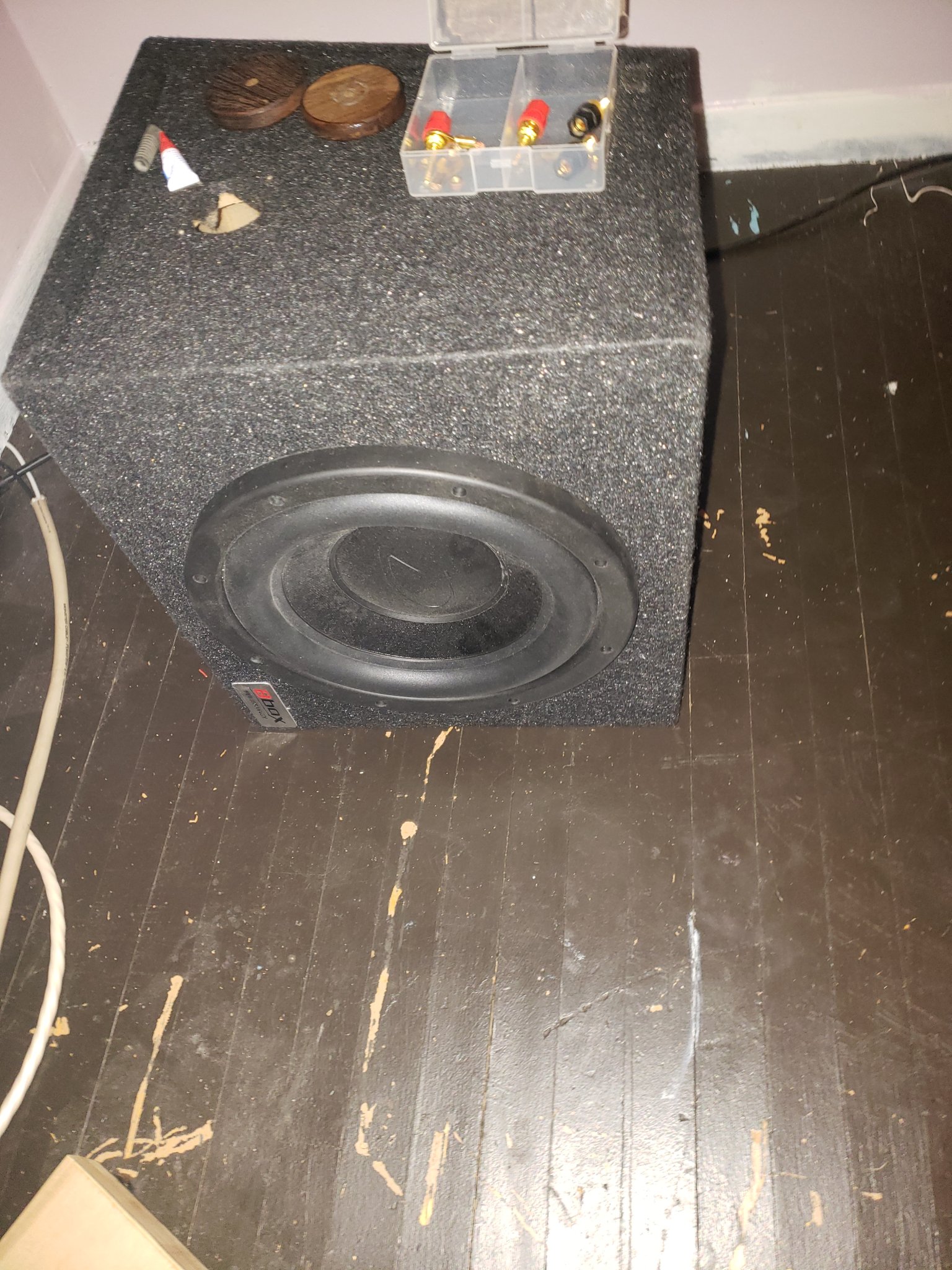

Including myself. As far as really enjoying them goes. My smallest box is 8x8x8 inches with pr. It can/does surprise everyone in the audio rhelm with u s.

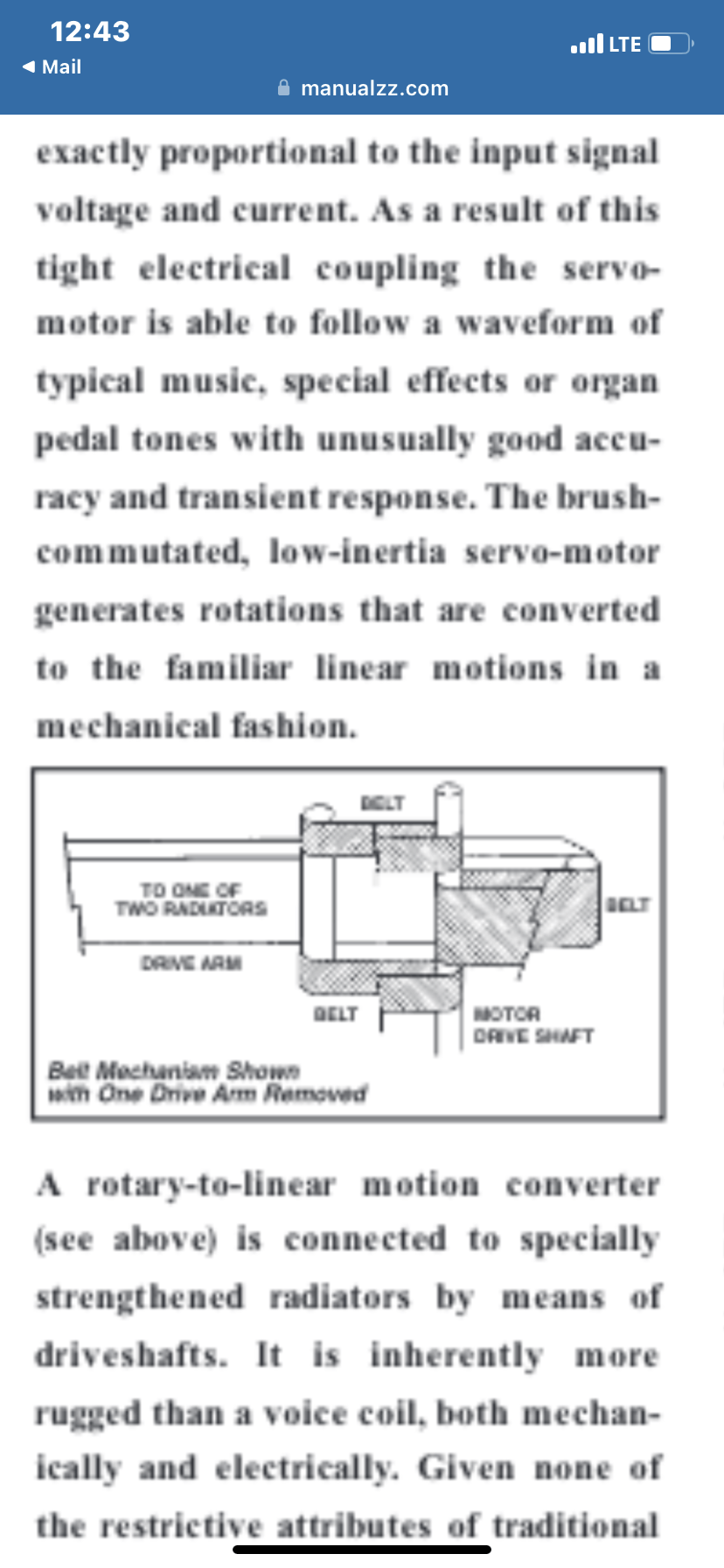

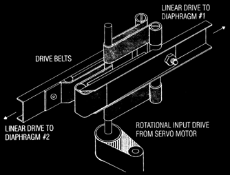

I'll let you decide 😉; consider the late/great servo driven Intersonics/DSL Servo-Drive Contrabass sub with its powerful, linear, mechanically driven dual 15" drivers pumping into a 10 ft^3 dual 18" PR @ 16 Hz/500 W and try to imagine how much it would rock back n' forth if all four radiators were on one baffle.........
Correction, it should of been 3 sides by 12" not 8".
BTW if anyone is shopping for subs that shine with small footprints with and without PR Dayton has a few in the lineups. I have an older one that ran a few versions then morphed into the ultimax.then theres another. You can't miss the dayton I'm referring to the magnet dwarfs all the others. Also said to work in tight boundaries. They might still make their highest offerings in the USA. So if your like me and prefer it for piece of mind your good.
I can vouch for their sub value. It pounds in such a small box and is livable as is. But I want to push it and do a rectangular sealed box, possibly with a PR and 1.00 FT. Minus about .20 or 25 for mybraces.

Mine started puking air through t he cheap terminal cup lol. Also a little more tuning (with rockwool) is in order.
In room sounds vg in the little wedge, with some xover only atm.

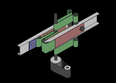

The problem with those is that the pads on the drive arm (not shown in that illustration) aren't perfectly elastic, so there's a bump as the motor rotates through the resting point. I assembled the rotary-to-linear converters for my kit Contrabass sometime before final assembly, and I could easily feel that. There's kind of a grumbling sound from the subs, which other reviews also mention. It wouldn't be noticeable in larger rooms or when the world is exploding on a movie soundtrack, but with something like a dub bassline it's pretty obvious.Wow! Thus is crazy cool
